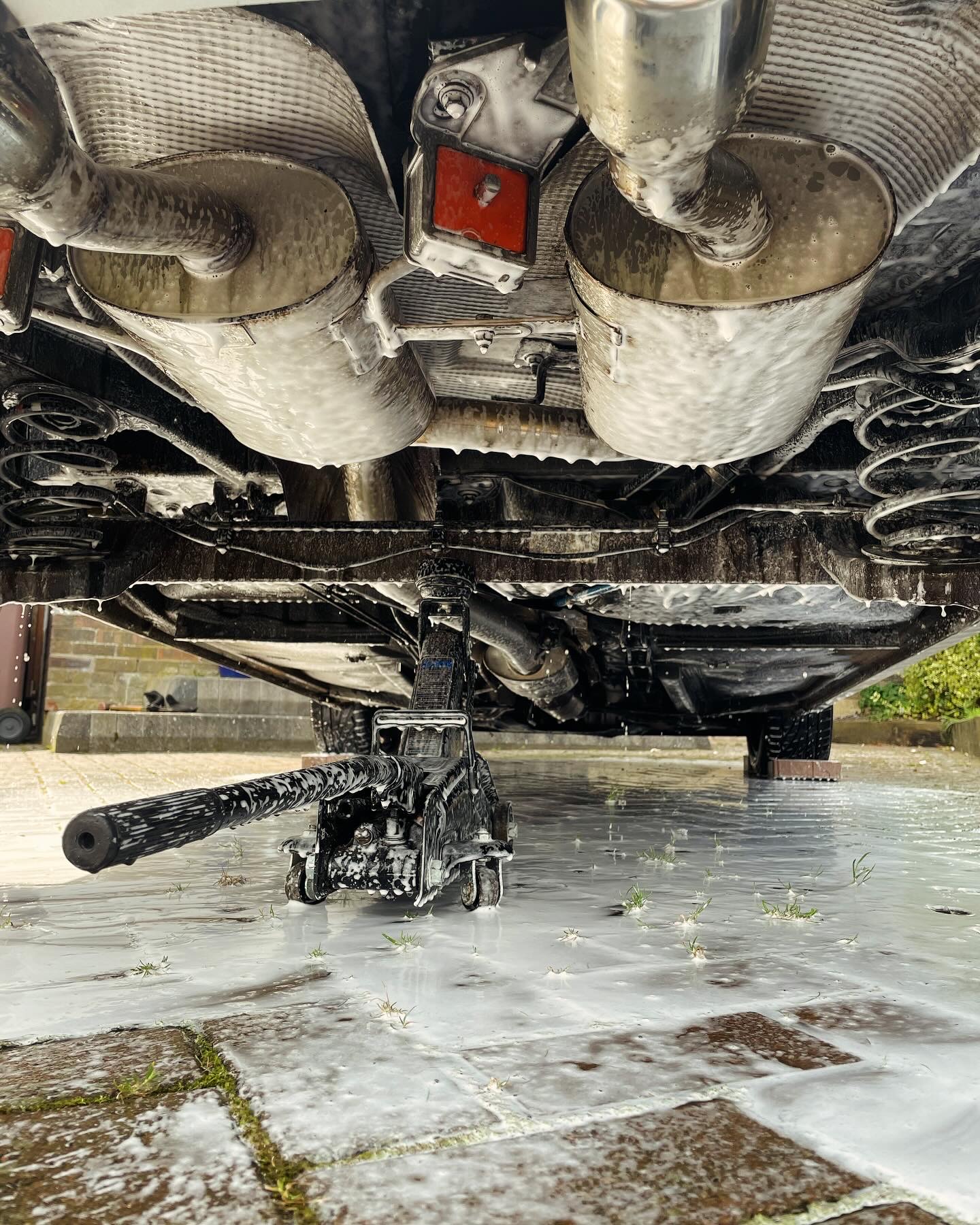

First job was to take out the non res section on the Miltek. It was just too boomey for me. Had to cut away the old clamp from the cat and get a new one from Kam racing. Fitting the resonated section was hard going, as it just wouldn’t push home into the rear box. After much swearing i removed the back box as well to find the sleeve on the rear box wasn’t 100% round- clamped up too tight methinks…. I ended up taking it to a local exhaust firm at Risby who kindly reformed it and supplied new clamps as well. Got it all fitted and my word it is so much more bearable inside!

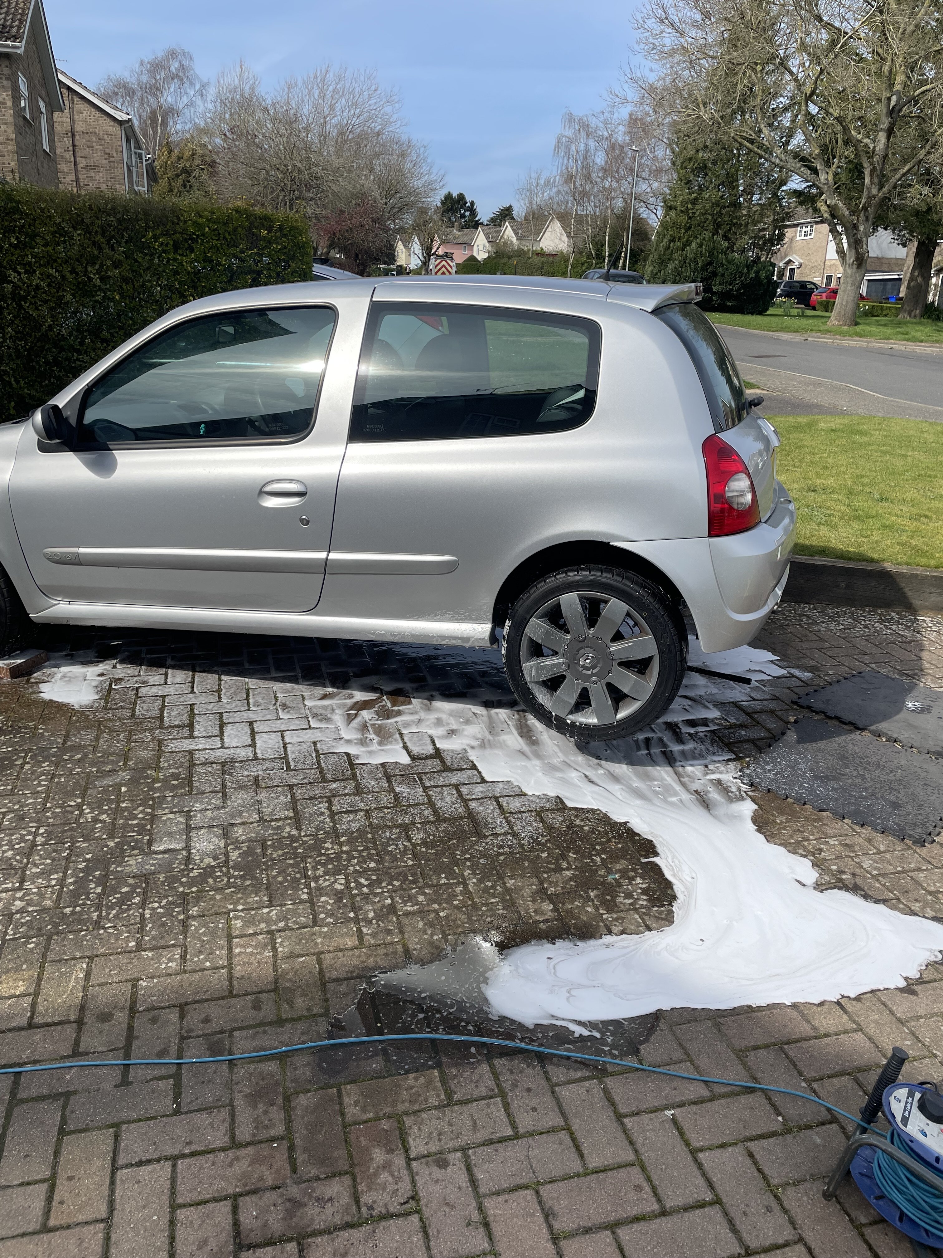

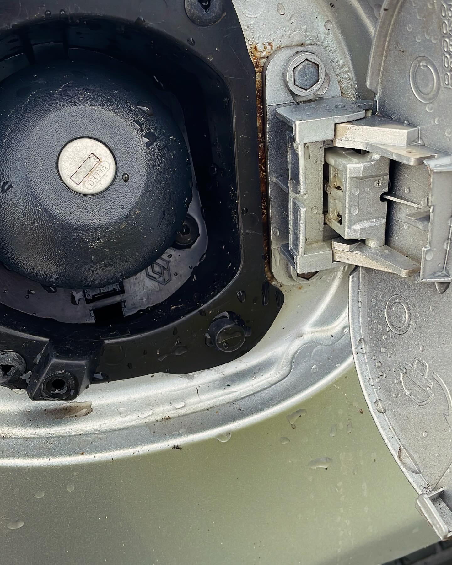

Underside has had a jetwash so i can see what im dealing with and a general inspection. Usual rust around the fuel cap but nothing concerning… for nearly 20 years old its pretty good!

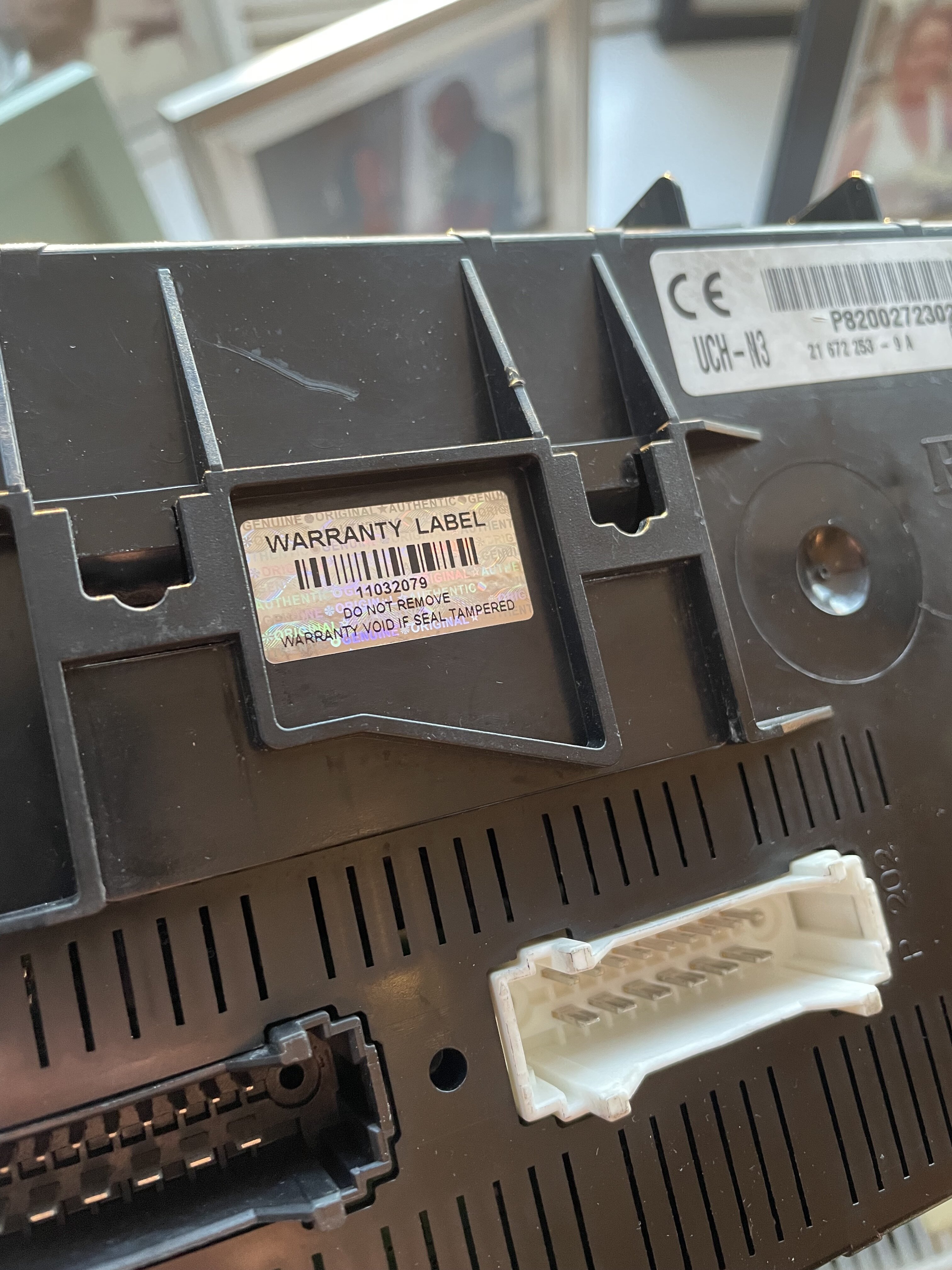

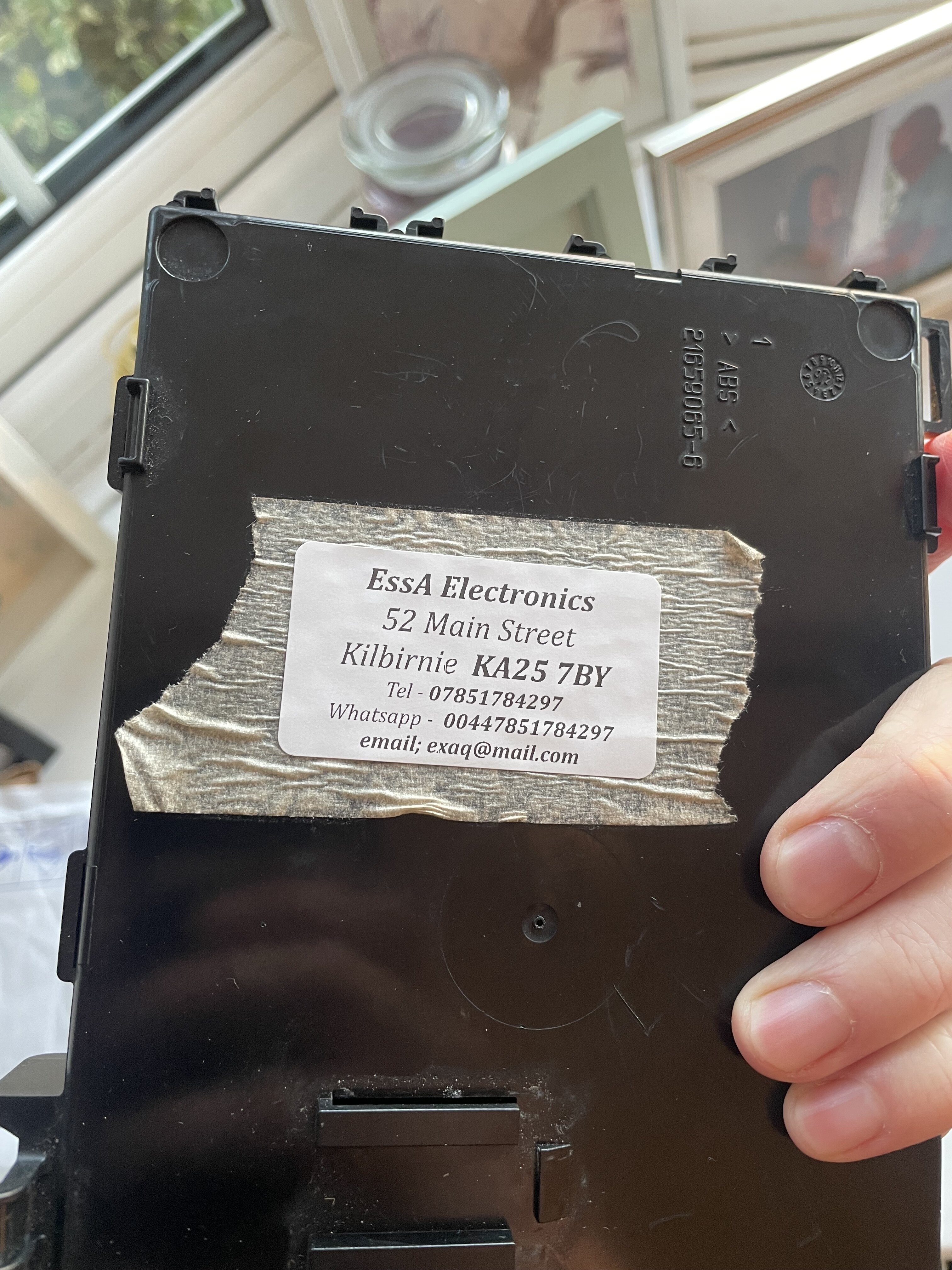

A little bit of progress this week. Since buying the 182, the hazards have never worked. I did post about this back in April, and most pointed to tge uch being at fault after i had replaced the switch and checked the fuse was ok. It was driving me mad as the indicators and everything else worked fine. So i sent the uch off for repair to Essa electronics (uch repair on ebay).
I found them to be more helpful than diesel pump repairs on the inital enquiry, and were about £10 cheaper overall. They were brilliant, and got back to me a day after i sent it off. All functions tested and….. no faults 😭….. so it must be the car somehow. Back it came and refitted, but properly this time. A previous owner had clearly had it out and just shoved it into position so at least that was sorted.
Once that was back in, i engaged the hazard switch and lay on my back swearing about french cars… and cursing myself for getting back into a bloody clio…. Amonst this my plan was to basically wiggle the loom about in various areas to see if they would start working. All if a sudden the relay was going and they started working! I traced it to what i believe is part of the alarm loom which had a partially severed earth. Very odd. Soldering upside down isn’t recommended. I did however succeed and i now have hazard lights!

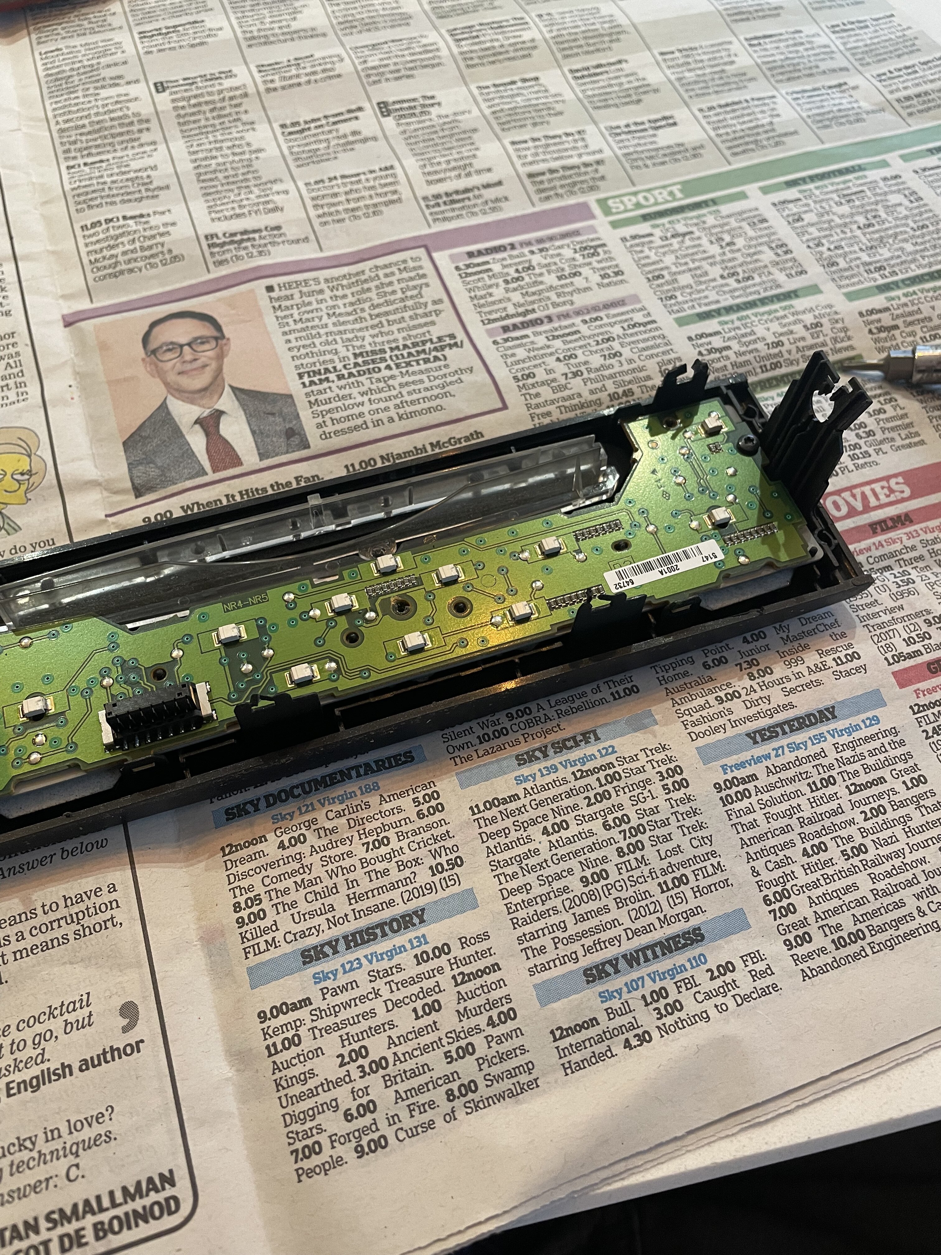

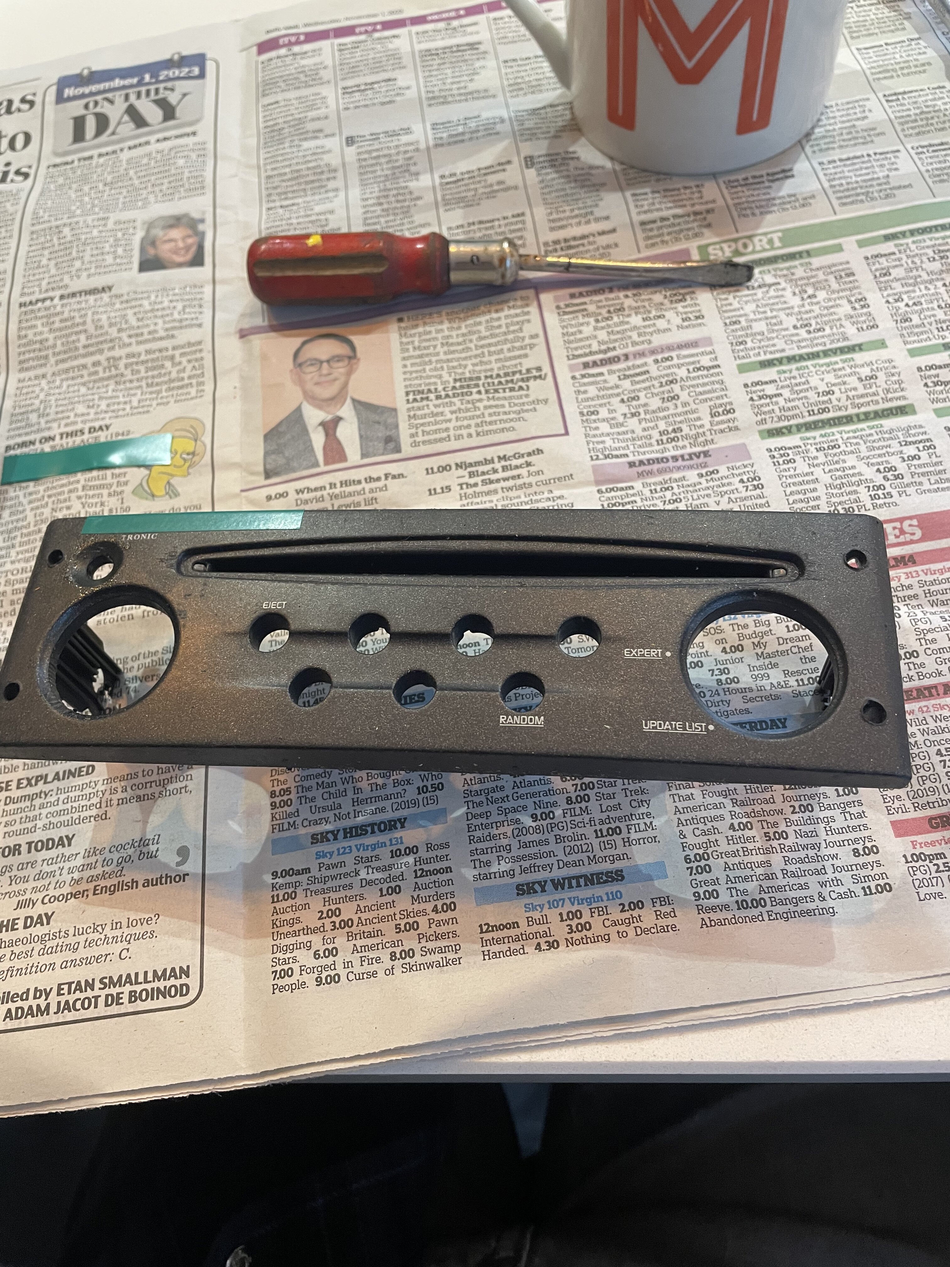

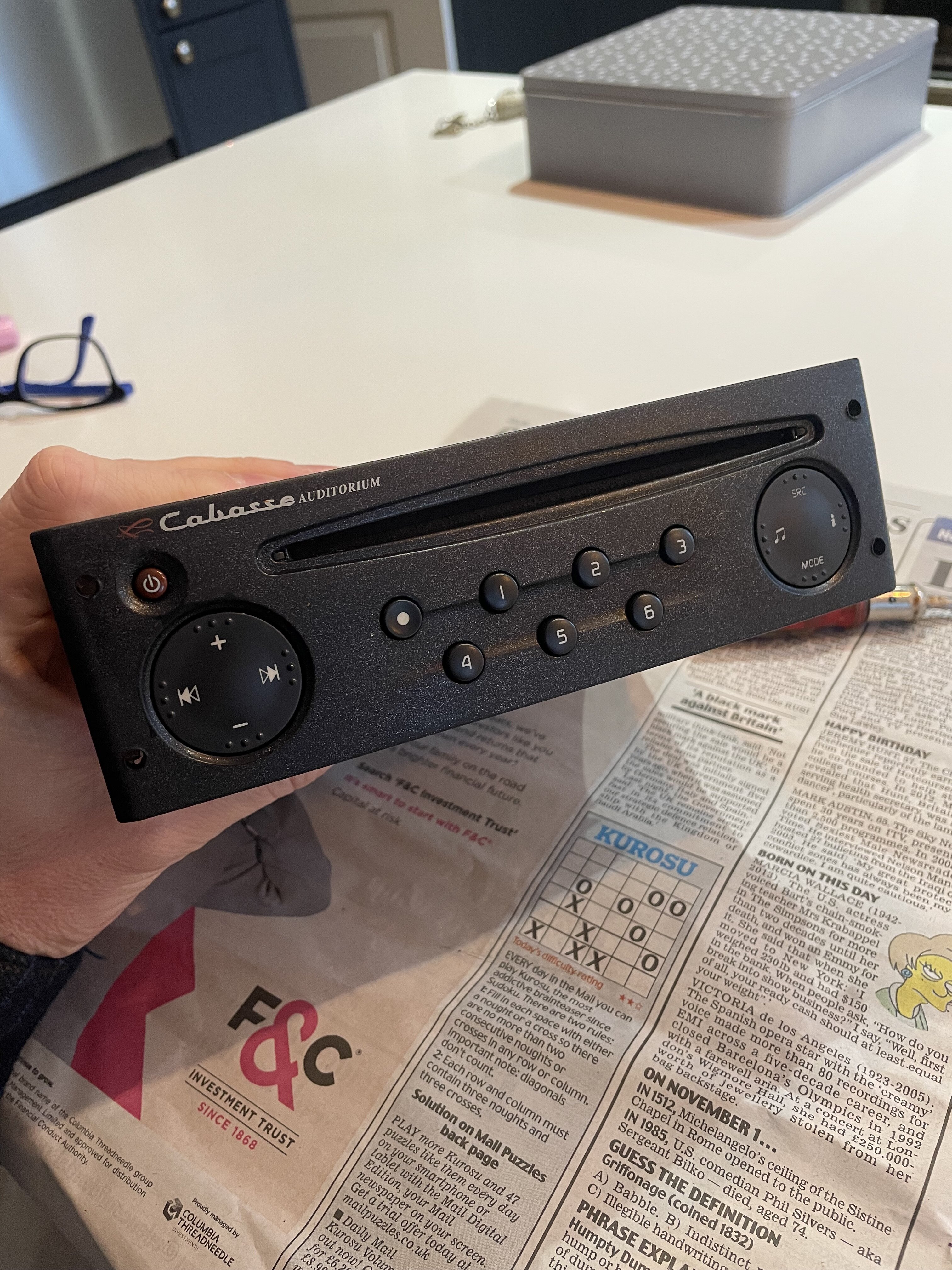

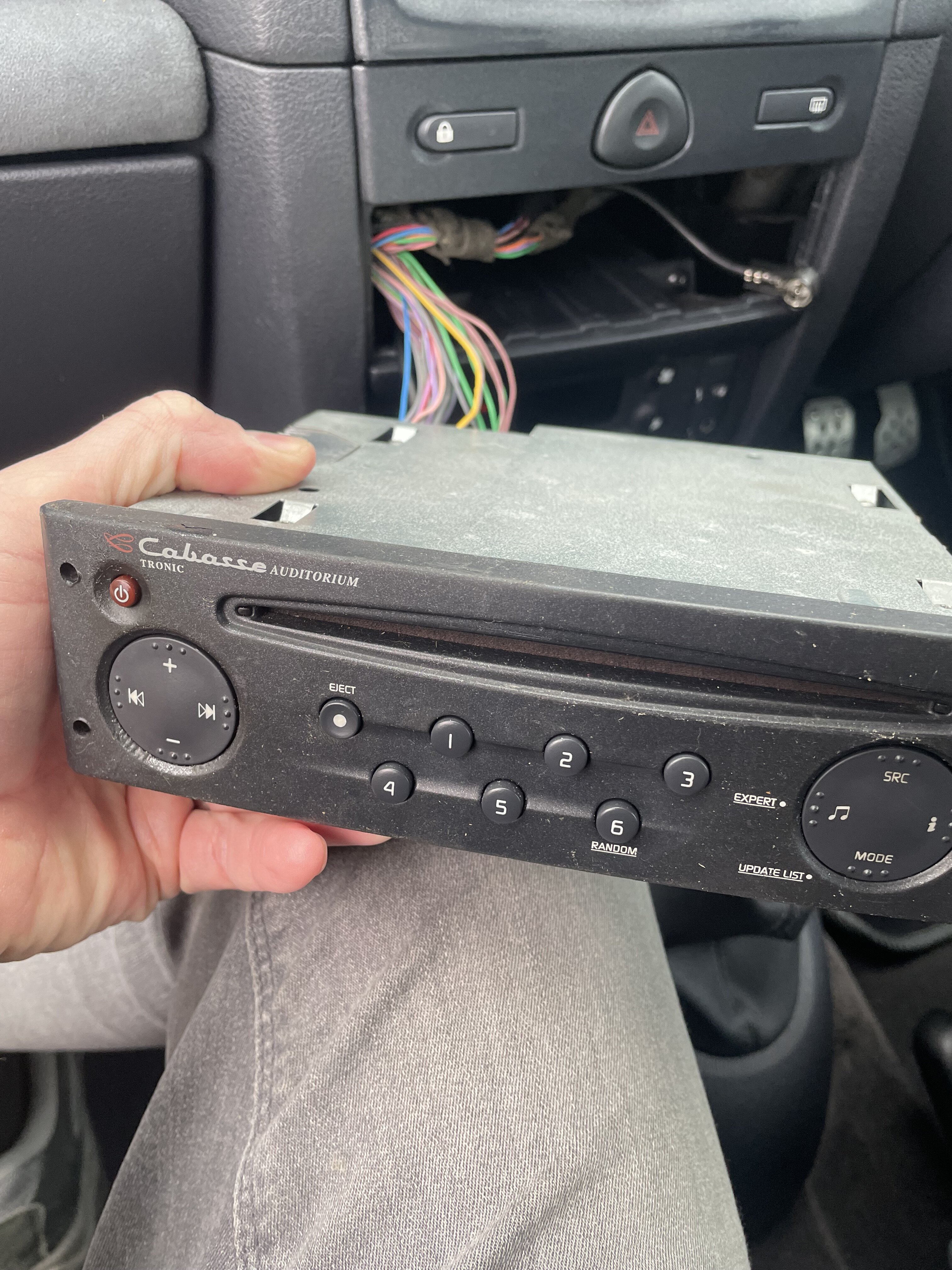

Next job was to get the Cabasse headunit i had secured back in the summer installed. Before that i removed the front of it and de-slimed it as per the guides on here. Its by no means a perfect finish, but i managed to save some of the lettering during the process with insulating tape pressed down firmly. Looks much better and is night and day compared to the sticky mess beforehand! Couple of before / after pics.
