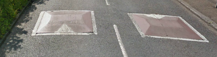

Could a bumpy road break an arb? or going over speed humps like these too fast?
If one wheel was in the centre and the other was on the road, as has happened many times when road side parking is permitted, would this damage the ARB?
Could you end up with a permenant deformation of an ARB which ends up with the car tilted to the left even when not cornering. Never even thought about this untill i started typing the previous sentence.
Doubt it just slow down anyway.

Once fitted on the car the finite amount of available suspension travel means you will never snap one no matter how hard you hit a speed bump. If you do rally stages regularly though you will eventually fatigue the bushes.
