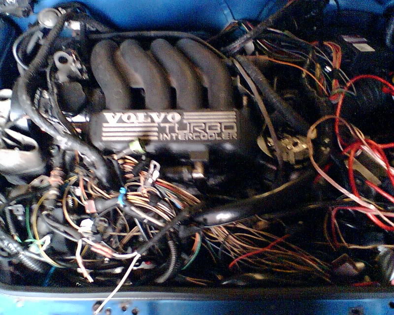

Any help at all would be great, i think i have finally cracked all my loom and what needs to go where as me and the electrician sat there for about 5 hours getting all the wires we need and ecu's etc...

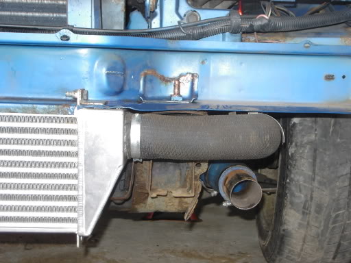

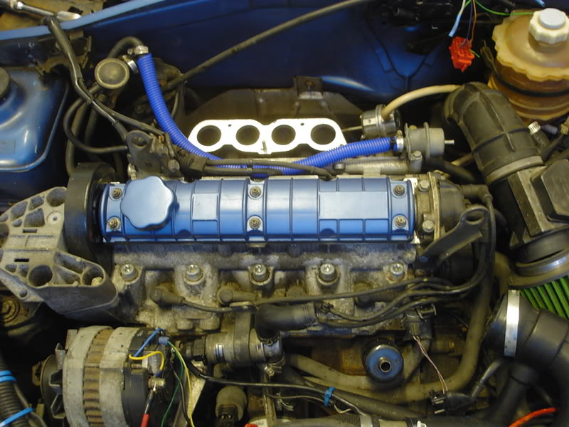

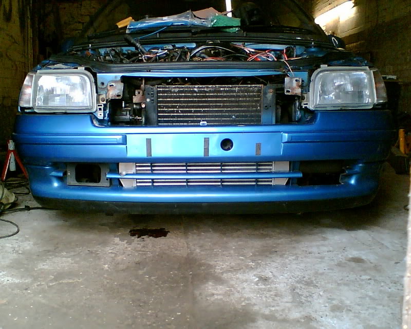

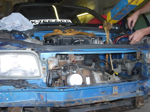

I think DJW_Dave or DJW_John used to have one but I'm not 100%. I've moved this thread in here to see if you will get the answers your looking for this is the right section for engine technical queries. I know they've been done on here before but im not sure of the username, sorry.
Djw John
Scotland - South

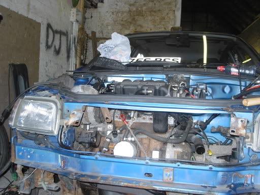

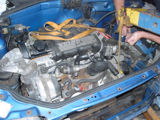

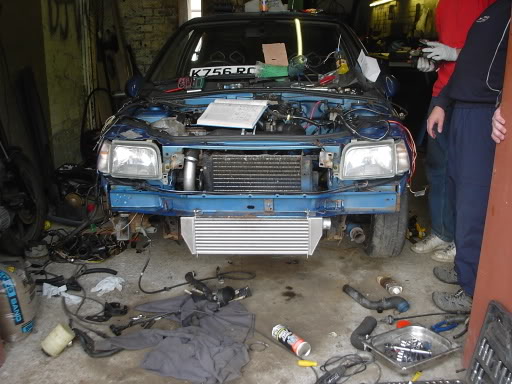

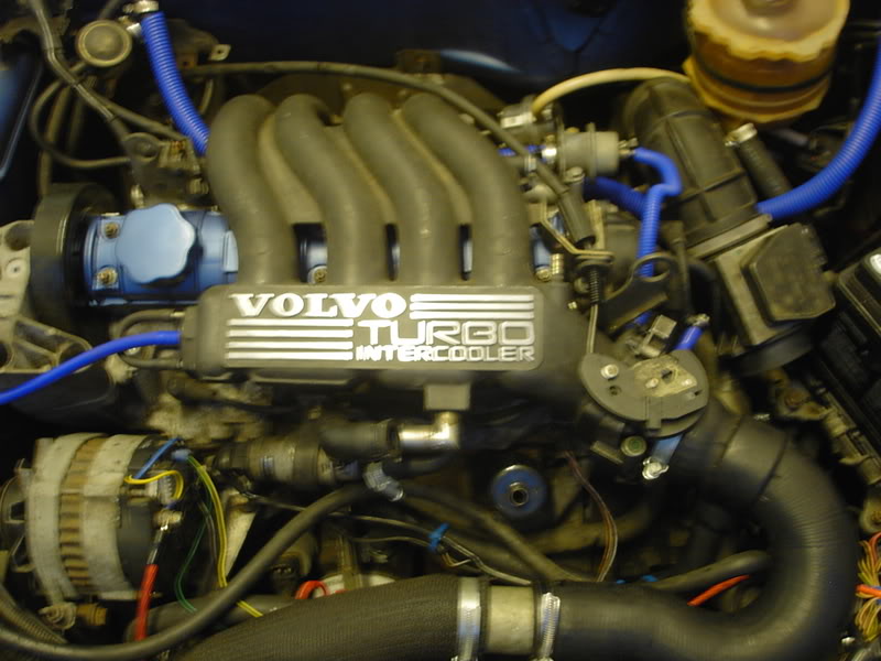

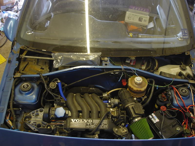

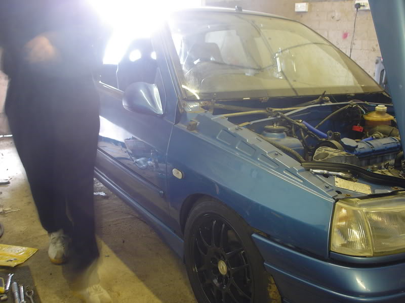

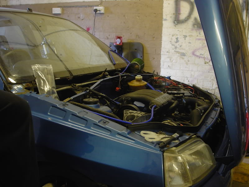

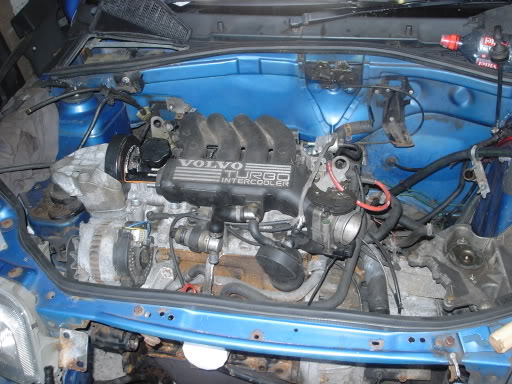

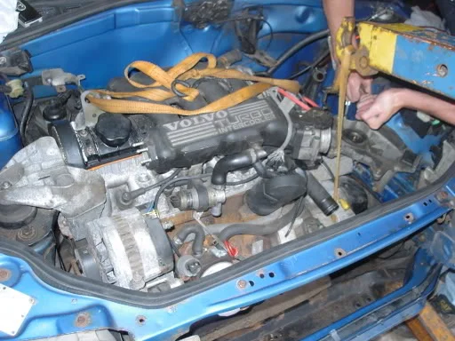

The order is a bit back to front but you get the idea
