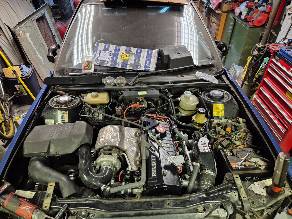

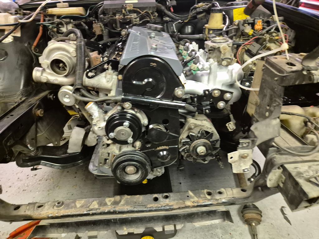

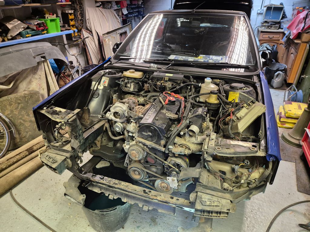

This is a friends car. Really nice on the body, suspension, brakes all work, not bad at all. But the engine, sadly, rattles like someone took a bag of spanners on a buckin bronco.

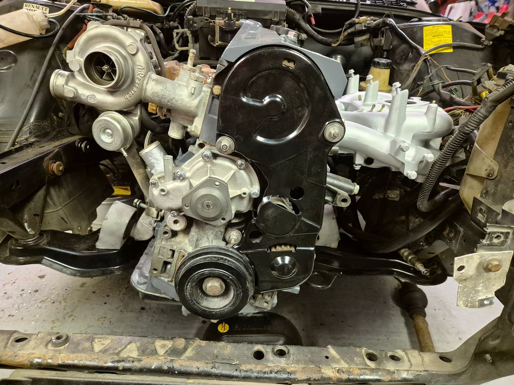

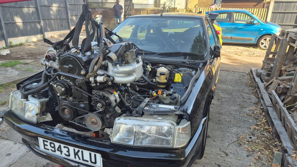

Ready for surgery

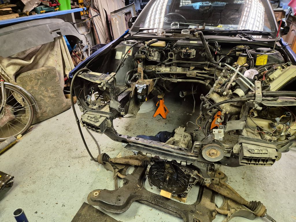

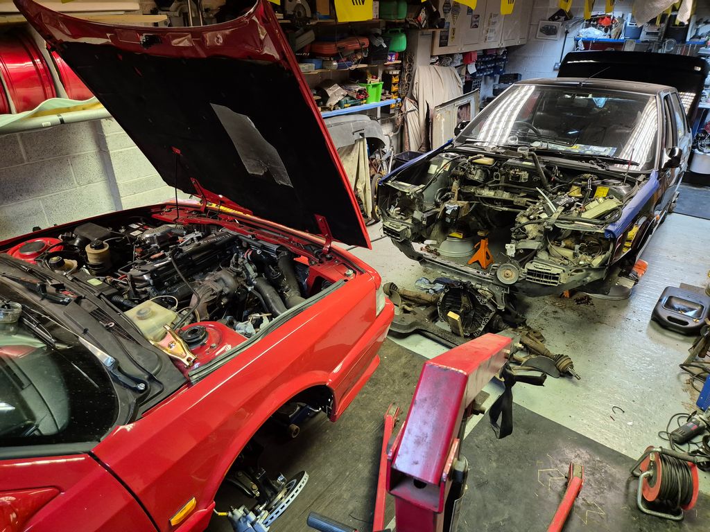

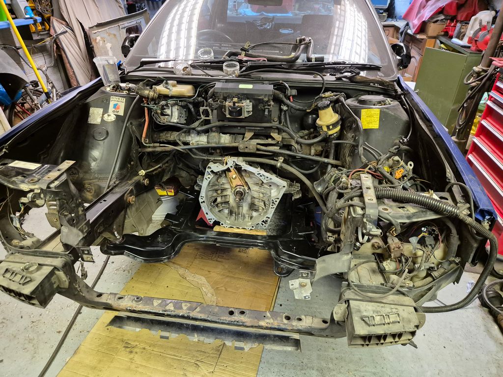

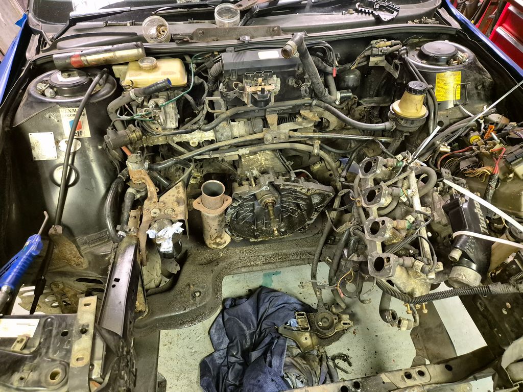

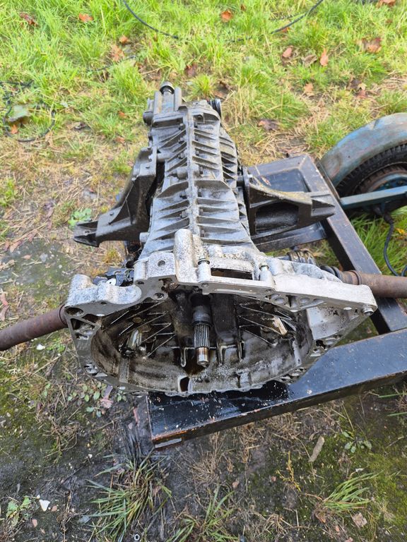

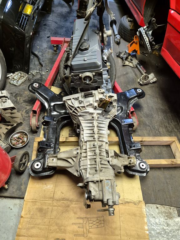

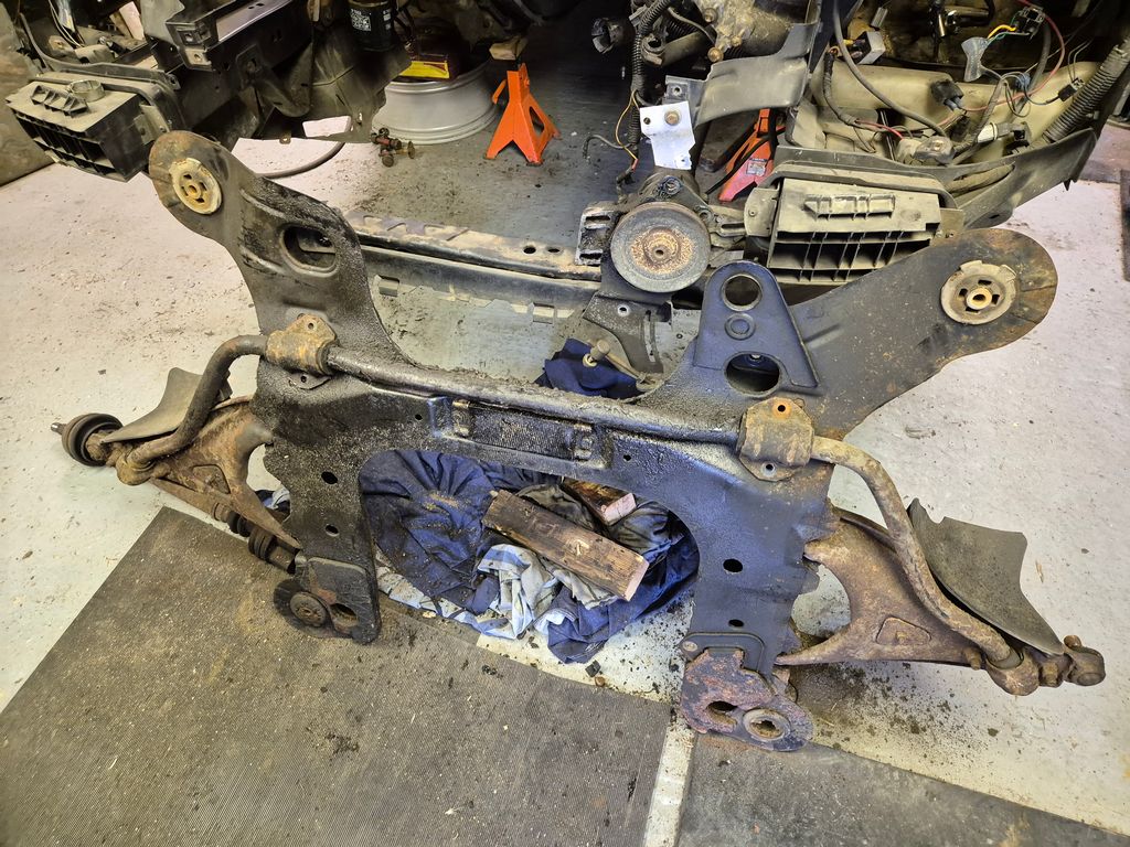

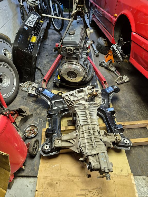

Started on it at half 2 Saturday afternoon, with a plan of getting the engine out, then tackling the gearbox and subframe at a later date, however, unusually, things went spiffingly well and I got the whole lot out by half six :)

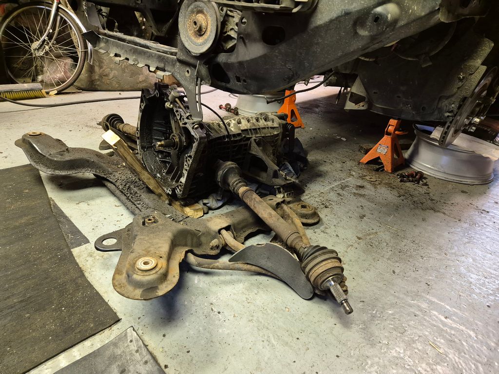

Was fortunate with the subframe bolts to be fair, three came out OK and I only had to chop one off, and even then it wasnt seized in the collar and just dropped out. Relief! I've spent multiple sessions battling subframe bolts before now!
Both in bits now!

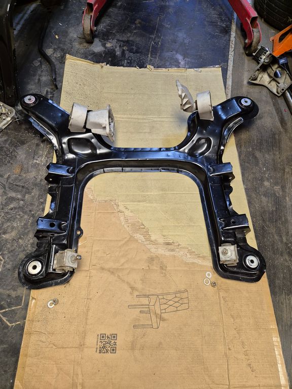

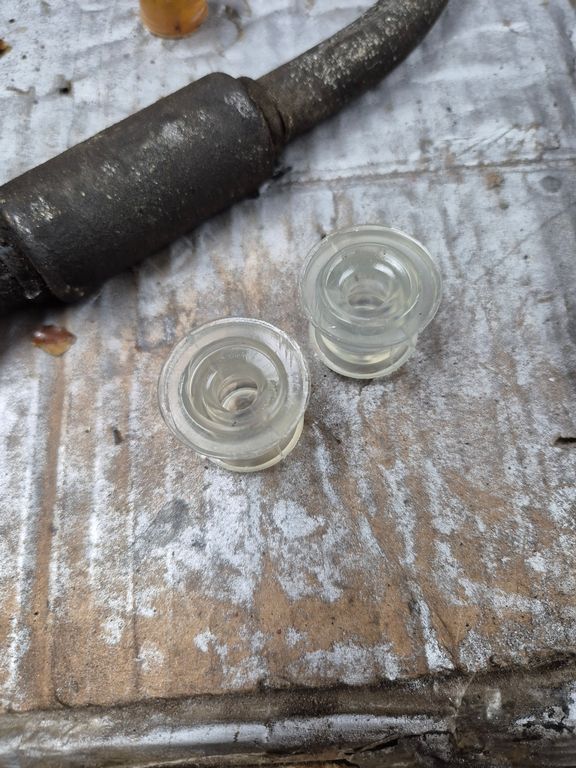

Powdercoated subframe with new bushes

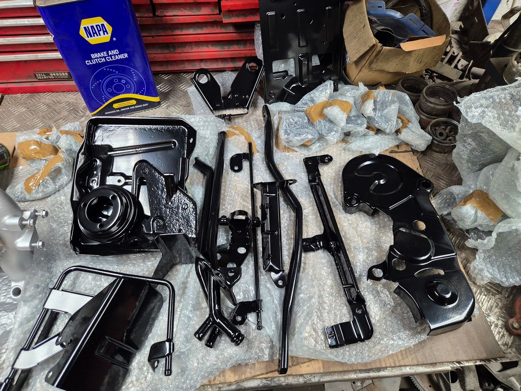

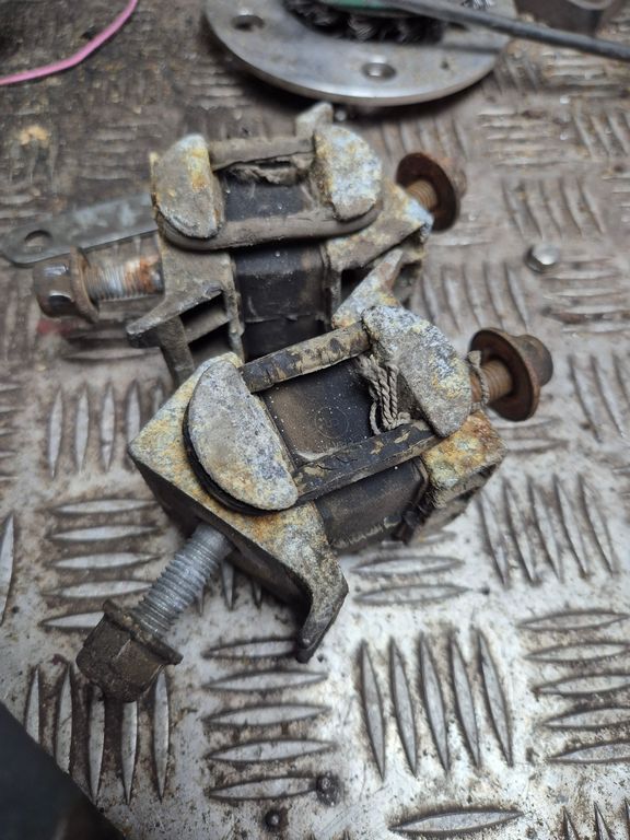

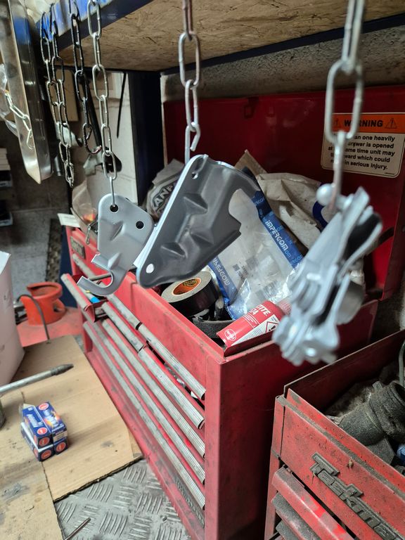

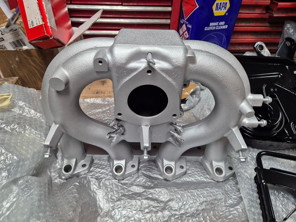

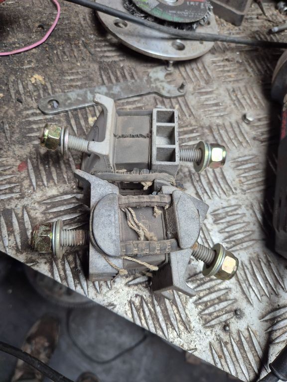

Blasted the engine mounts and gearbox mounts
New fork
Blasted a few other bits, and sent a load off for powdercoat

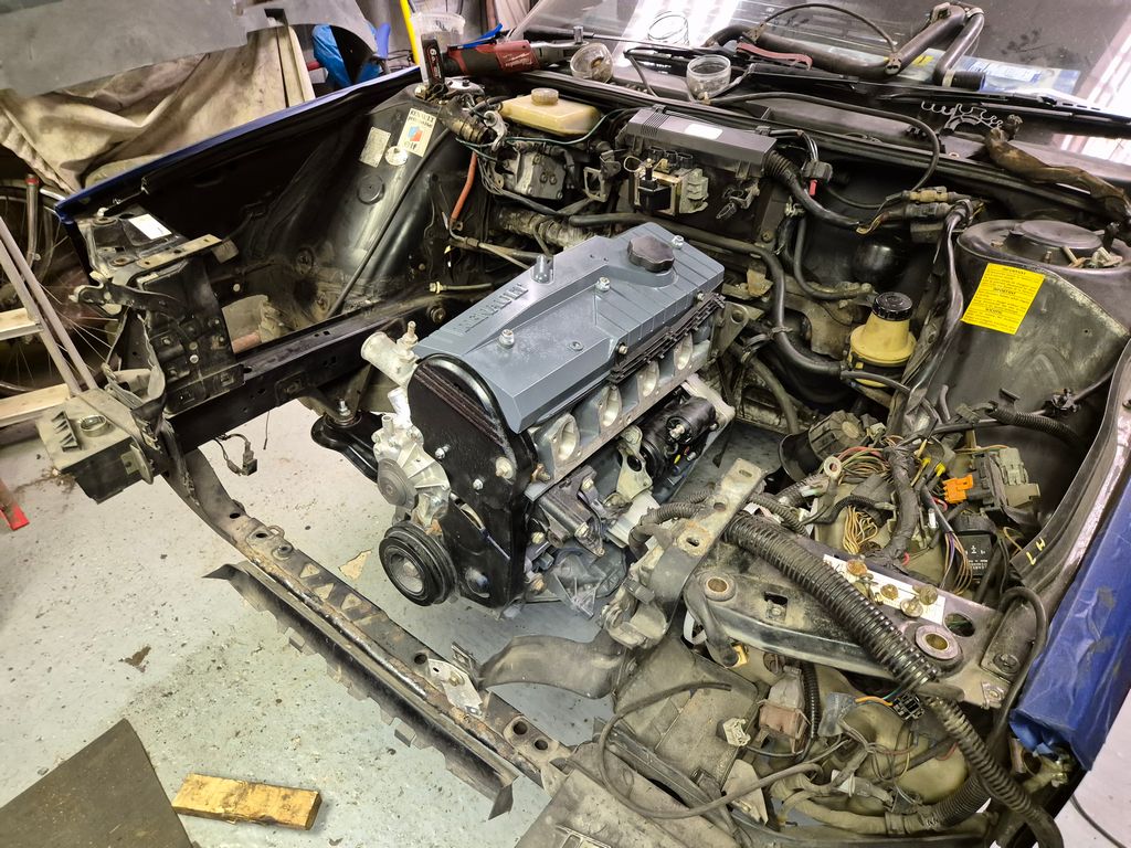

Gave it a size up, made sure the bespoke clutch would fit. It did :)

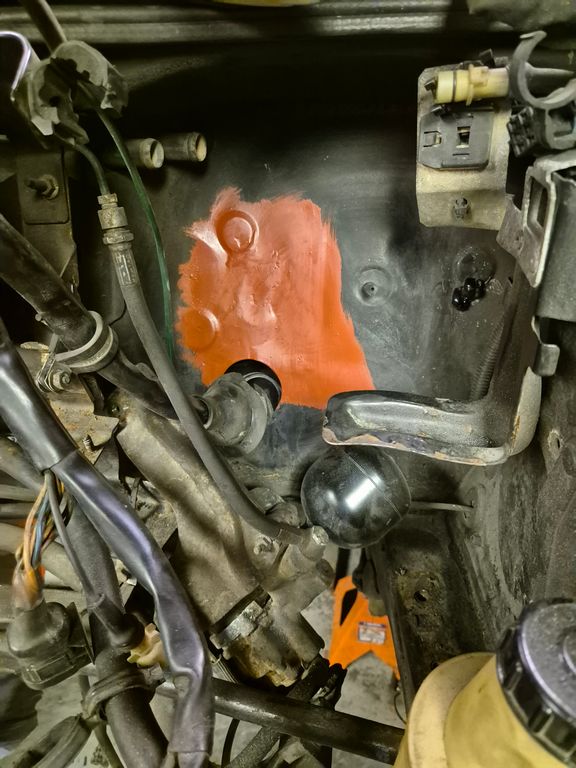

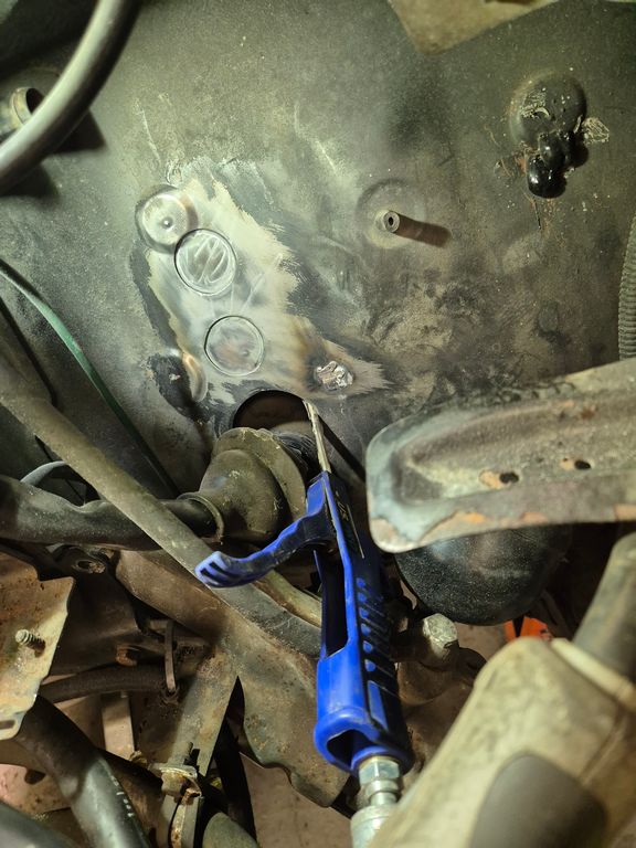

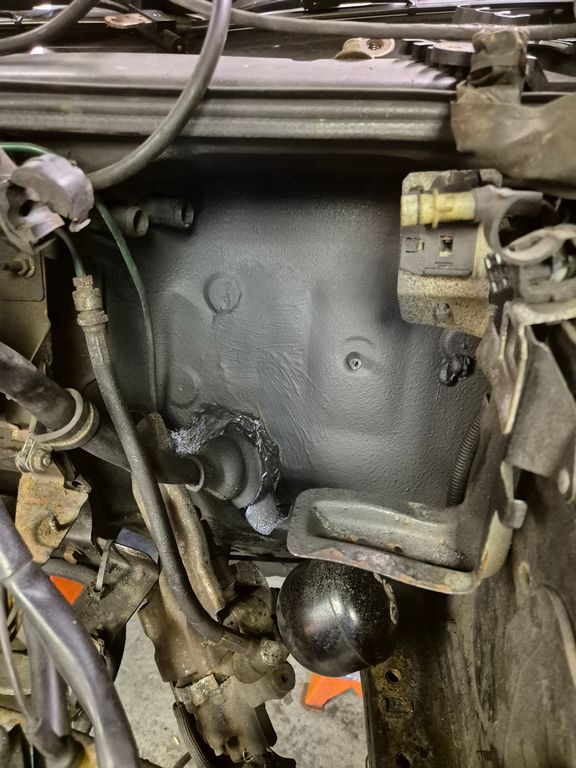

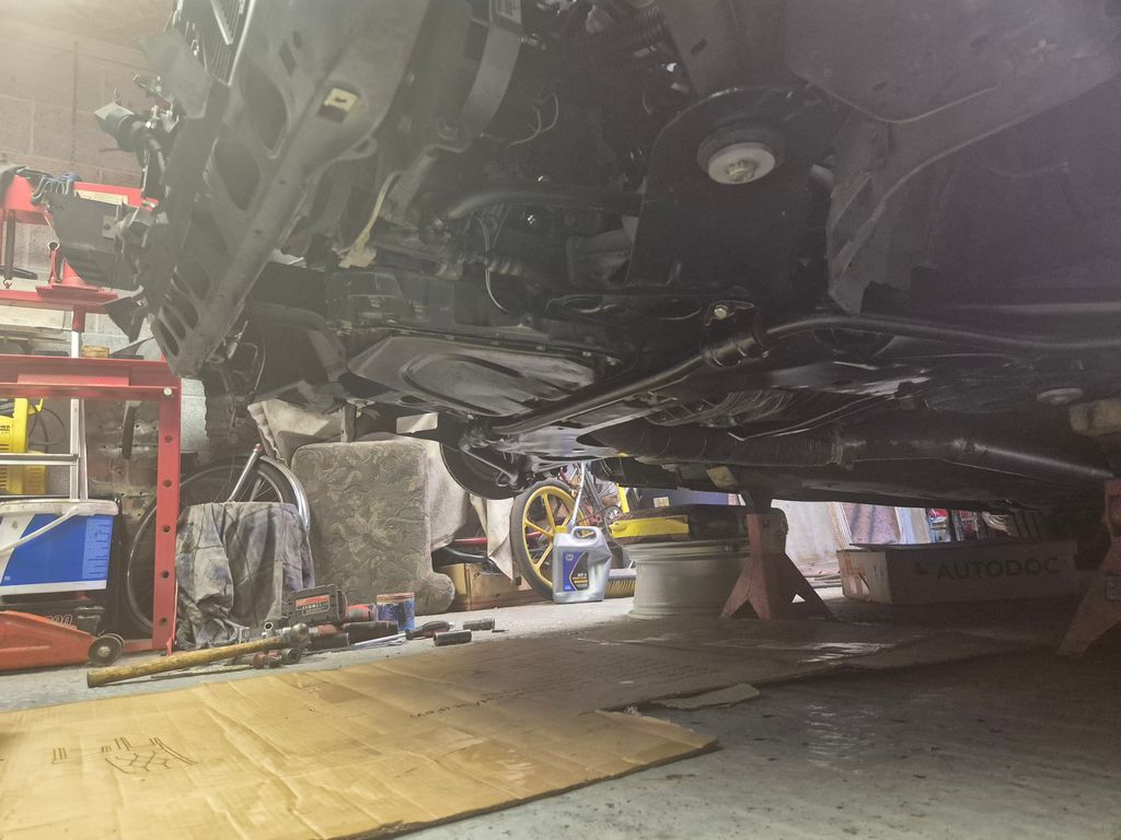

Before I refitted the drivetrain I welded up some holes in the bulkhead left from an aftermarket AC install
New driveshaft pins

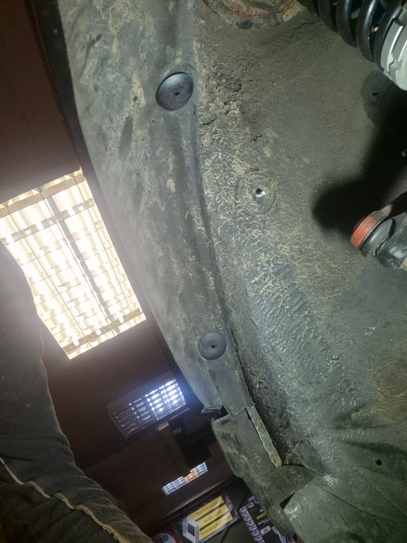

Arch liners refitted, as this wasnt done after it was painted

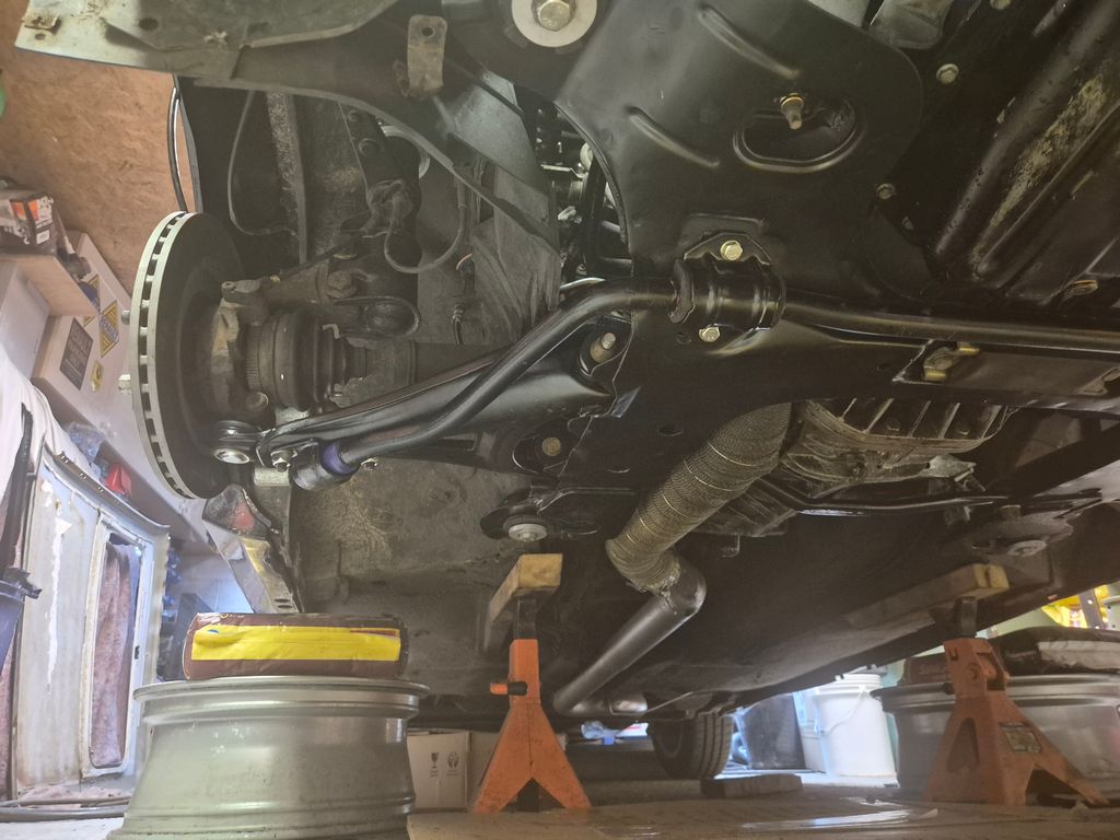

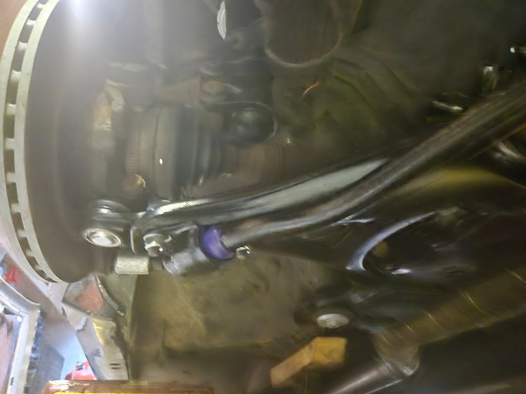

Suspension back in with new wishbones, balljoints, and polybushes on the outer ARB

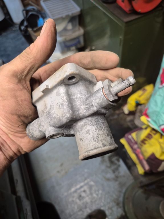

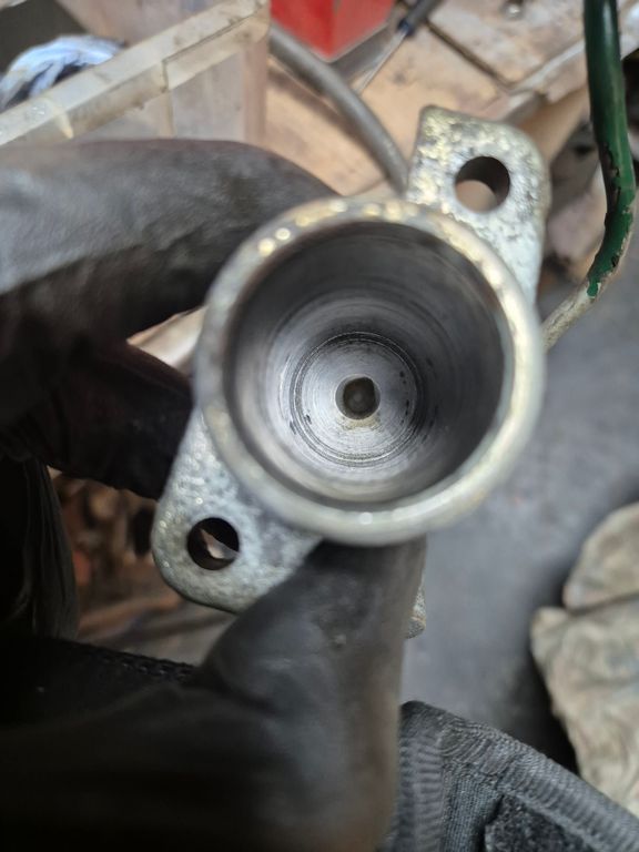

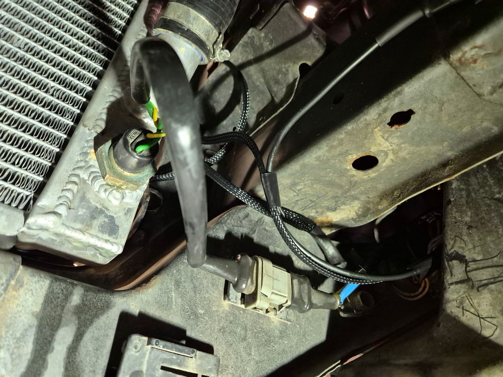

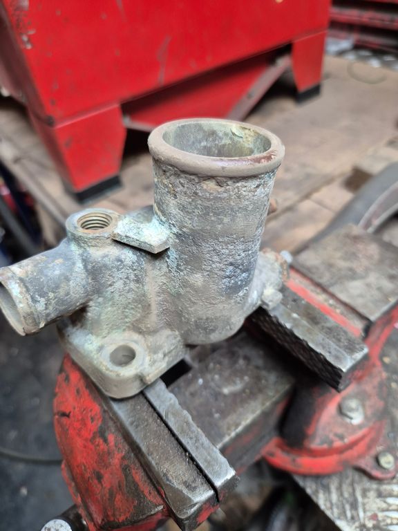

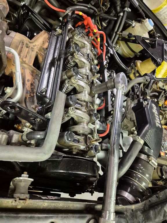

Few more bits bolted in - found a water leak from the oil cooler body

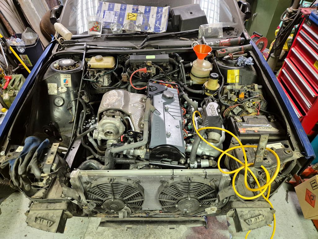

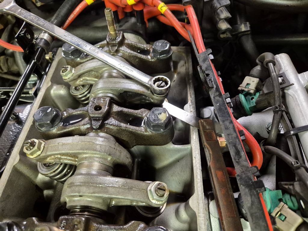

Sourced a used oil cooler, now the fan switch is leaking! FFS. Still, got a heat cycle in so time to retorque the head bolts and set valve clearances.

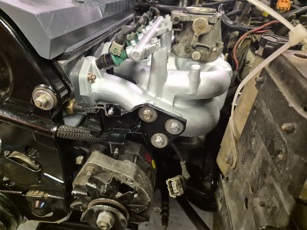

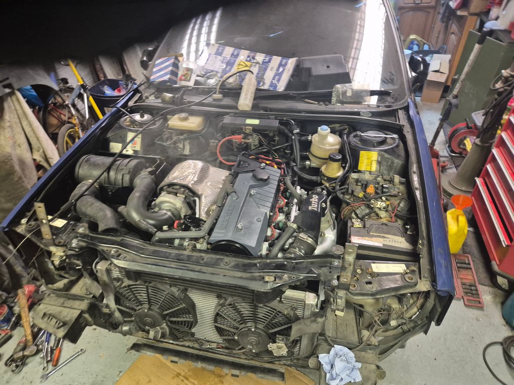

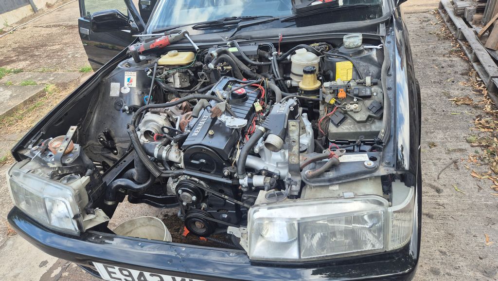

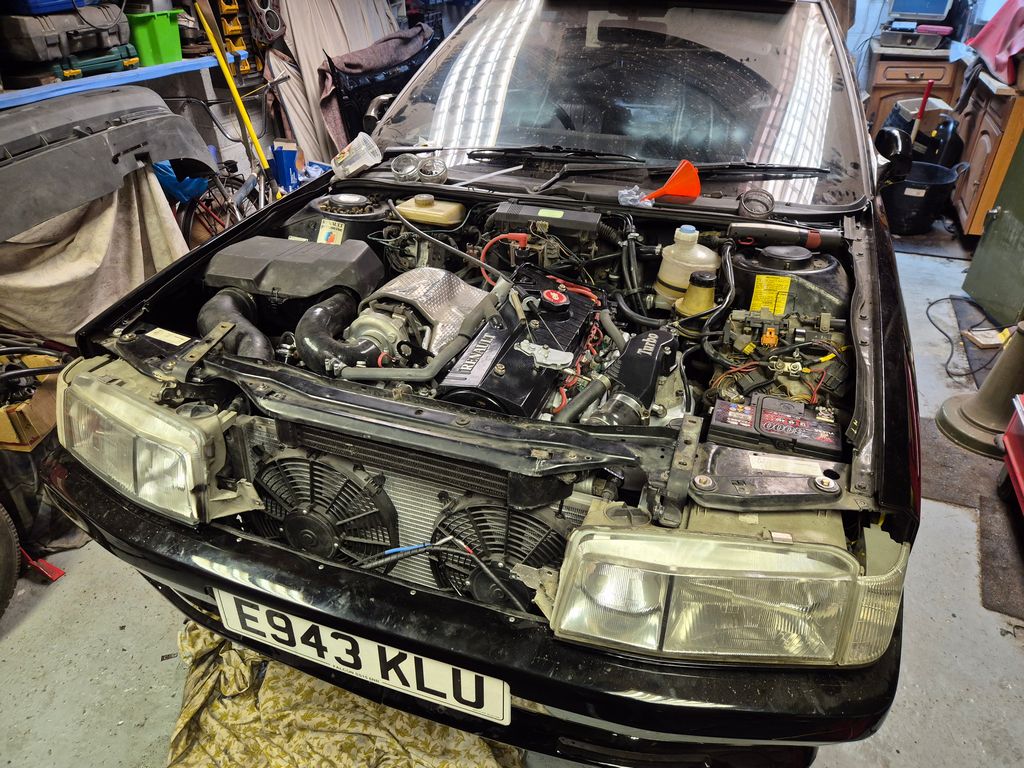

Almost ready to test

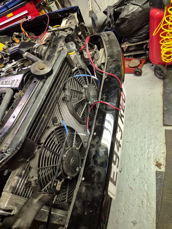

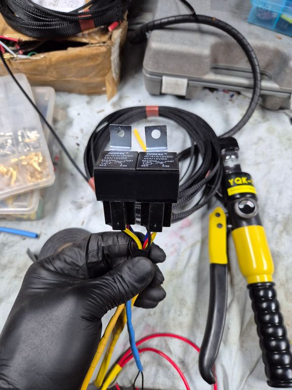

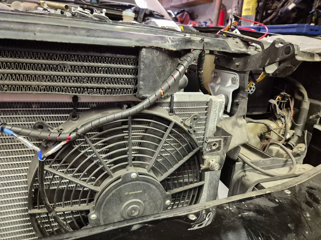

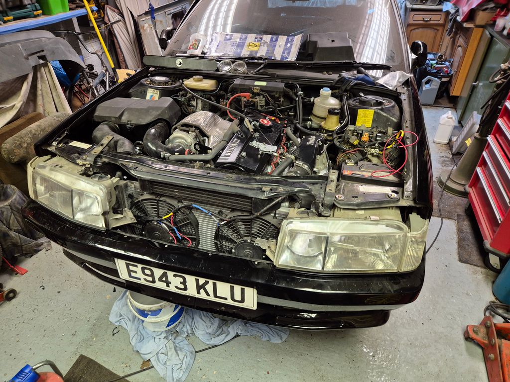

Was on the original fan loom so Jamie OK'd a new one to be built
Can you spot where I ran out of spiral wrap? LOL
Also waiting on some new fuse blocks to go by the power feed, they arrived yesterday so thats the next job. otherwise all working, both fans come on full speed. very effective.

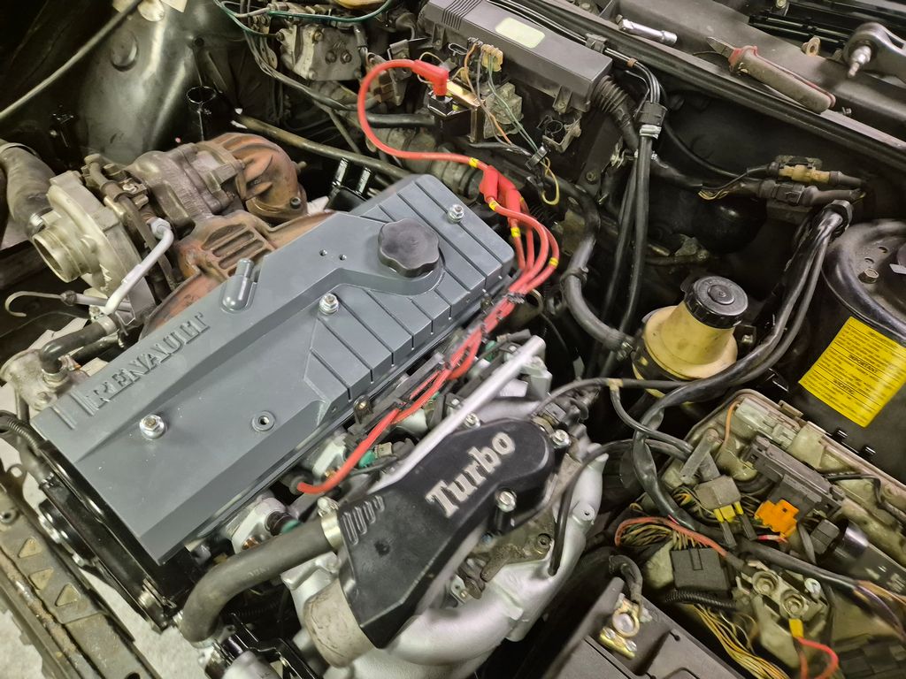

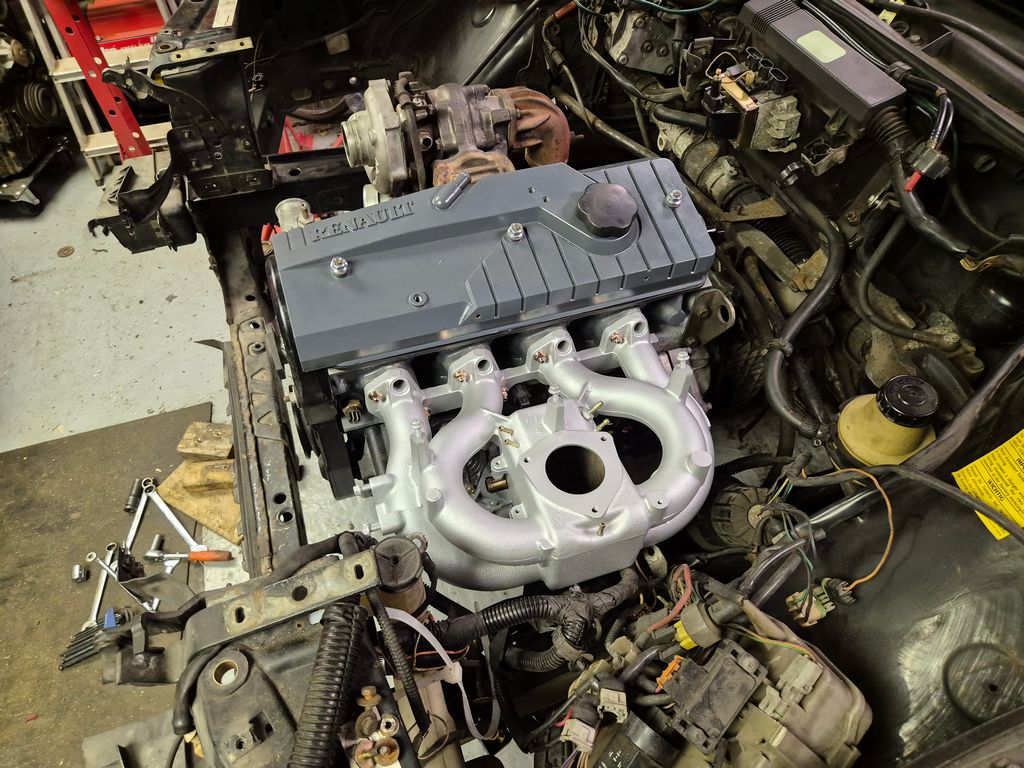

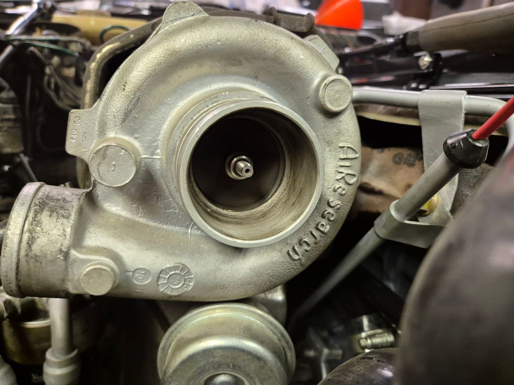

Soooooooooooooooooooooo obviously as the car was nearing completion a kick in the teeth was due. It started running like crap and even dropping cylinders. I did some diagnosis and the compression test on 1&2 was waaay low, in fact all were shite.
Something not right here at all and the only way to diagnose a problem like that is...
Checked a few bits and bobs and then found this, which is pretty damning. So much for the prebuilt tall engine eh.
I took the head to my machine shop and the sorted the valves out. Car is rebuilt now, run up, head bolts retorqued - seems much happier now!
Spotted a few things inside I didnt like very much, there was some damage on the cam journals and the wrong dowel (left) used in the block>head (right is correct). I dont know who built this engine but I think maybe they need to take a bit more care when doing it.

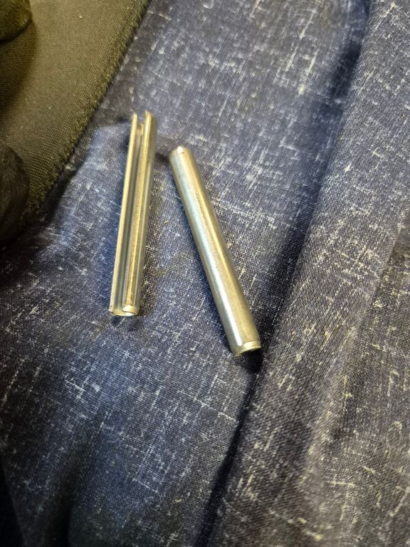

Took it for a short test drive - however the rear brakes had been put together wrongly and they were binding quite badly. The handbrake cable was overtensioned, the locknut was loose and the slider retaining pins were missing on the drivers side. Not good!
Pulled the dust covers off, pushed out and cleaned up the pistons and greased, wound the pistons in and reset the handbrake. Made some new pins for the sliders, dont want them falling out!

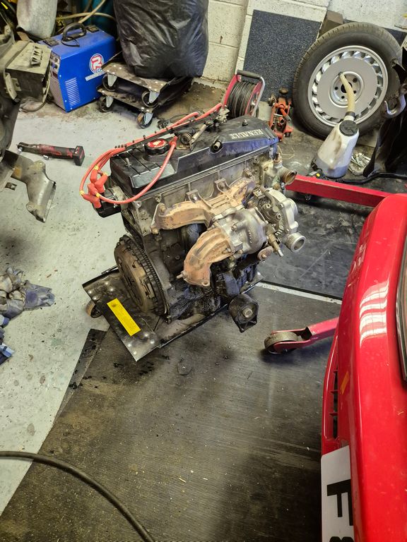

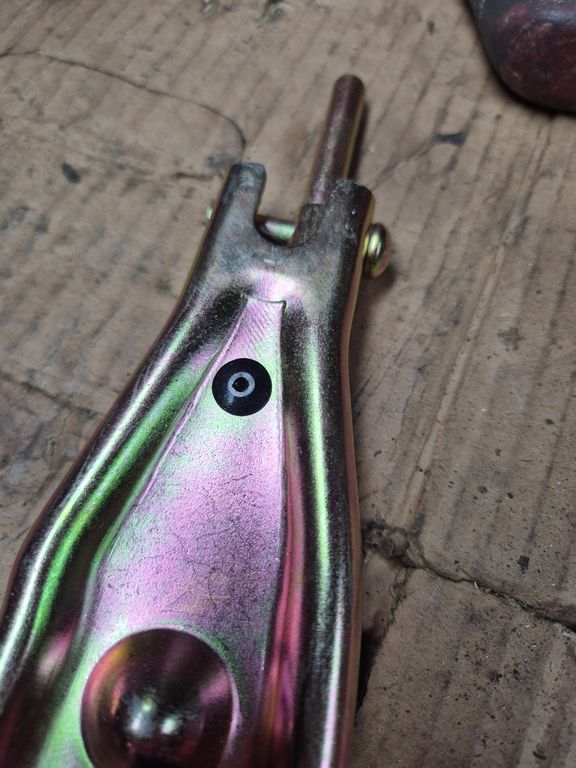

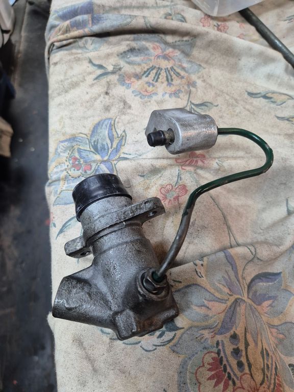

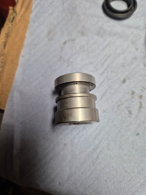

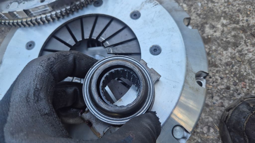

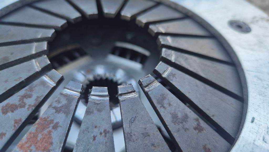

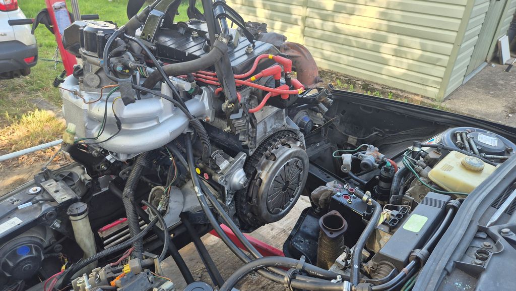

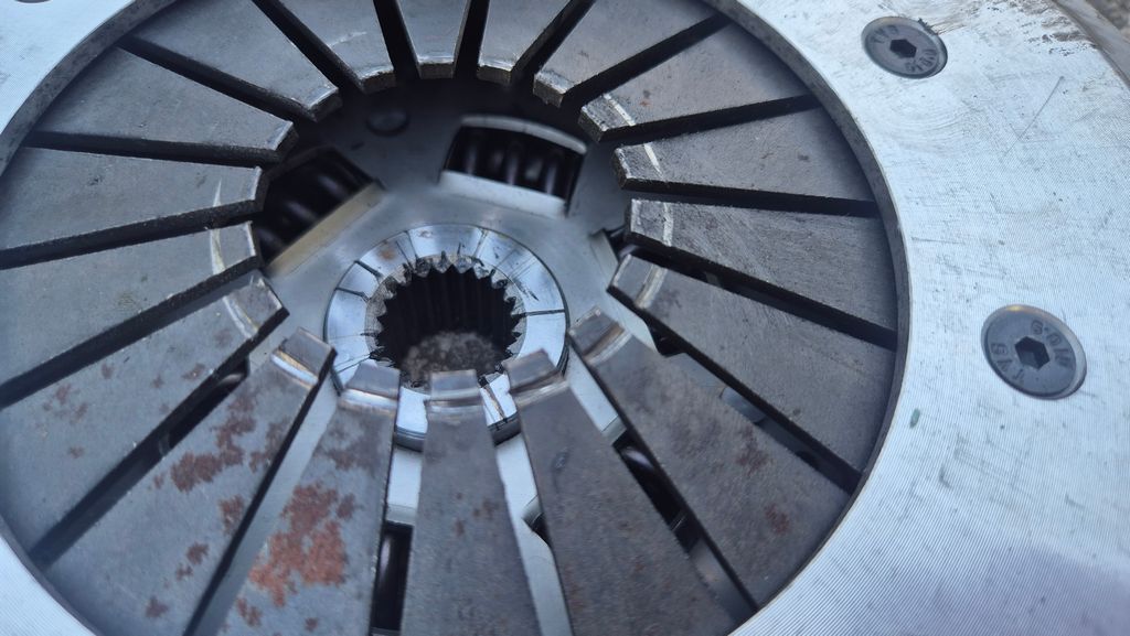

Update - I bit the bullet and took the engine out. I just wasnt happy with the clutch at all.
Good job, as we were close to a complete failure.
In summary, the wrong release bearing was supplied with the clutch. It's way too small, and was jamming in the middle of the spring fingers, or, not sitting central. This has ruined the bearings in the release bearing, and then the backing of the bearing (which doesnt rotate) has interfered with the spling fingers.
Very poor...and expensive. Bear in mind this has done about a hundred miles.
I had a new friction plate and release bearing in stock, the OE cover from the old engine was decent so that all got refitted.
This will be fine for the power its running. Clutch is now sweet as a nut. No judder, no dodgy engagement, no dragging. More test driving to come.

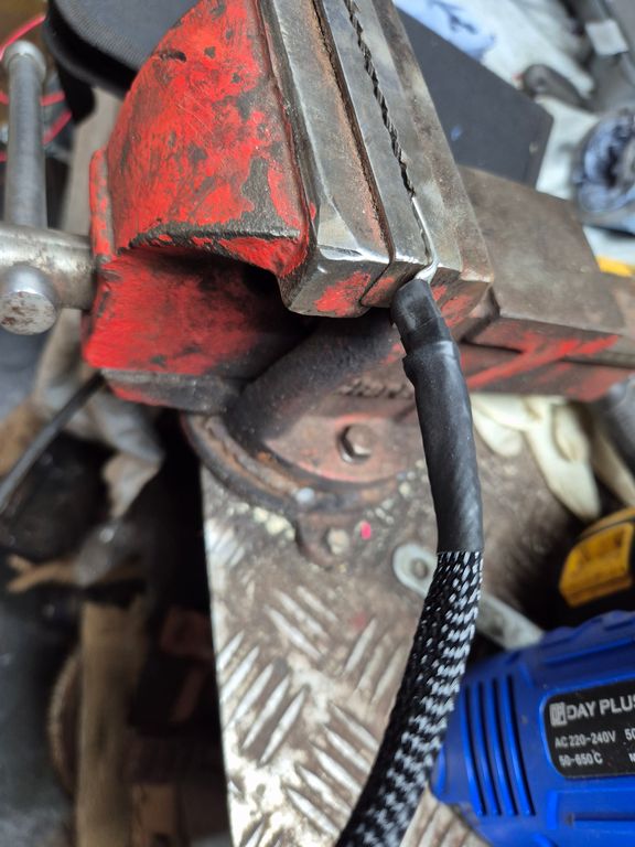

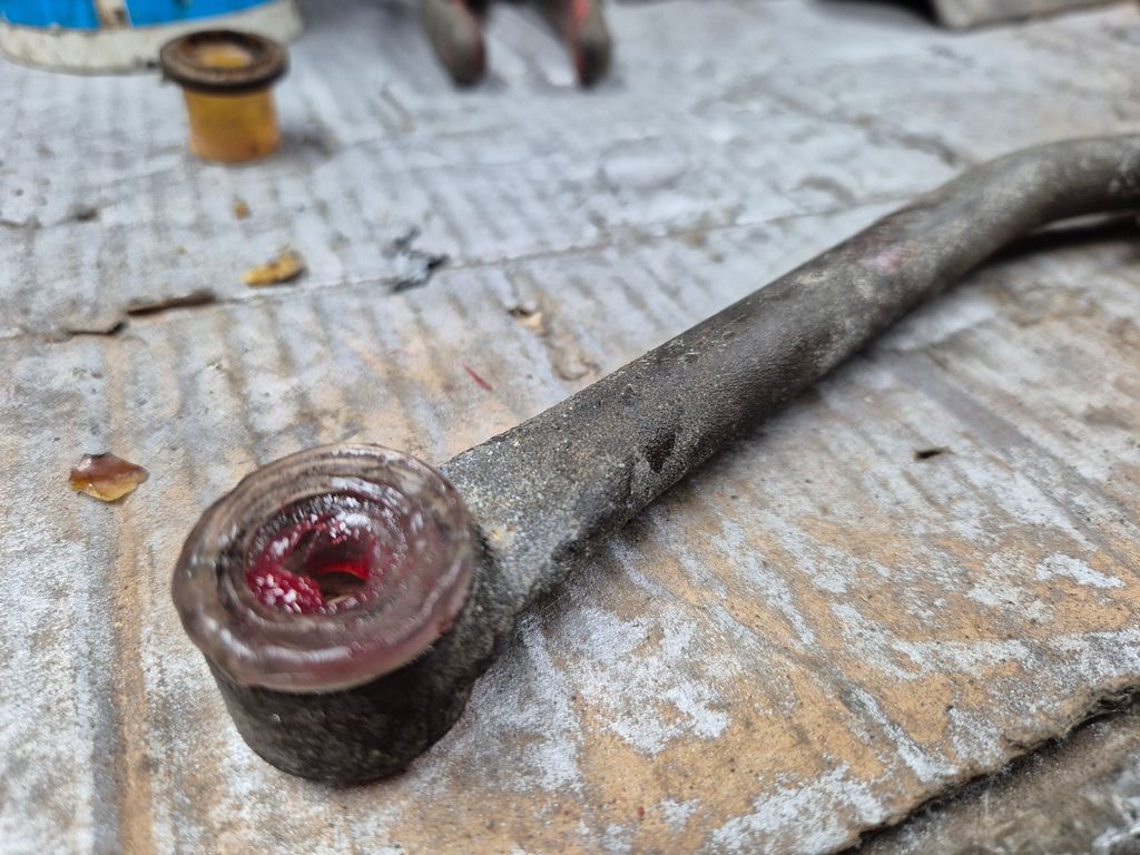

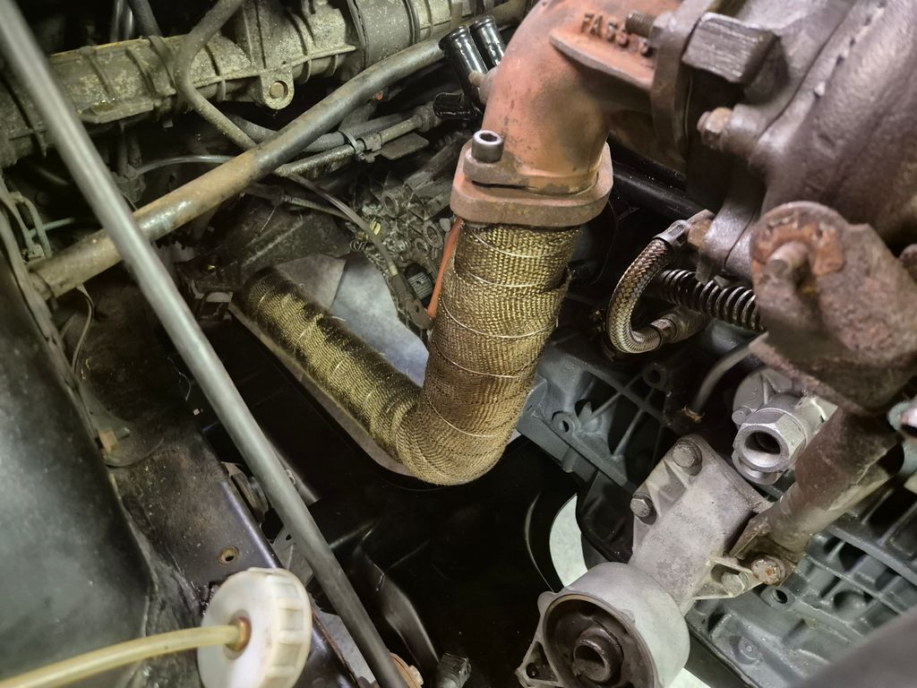

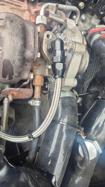

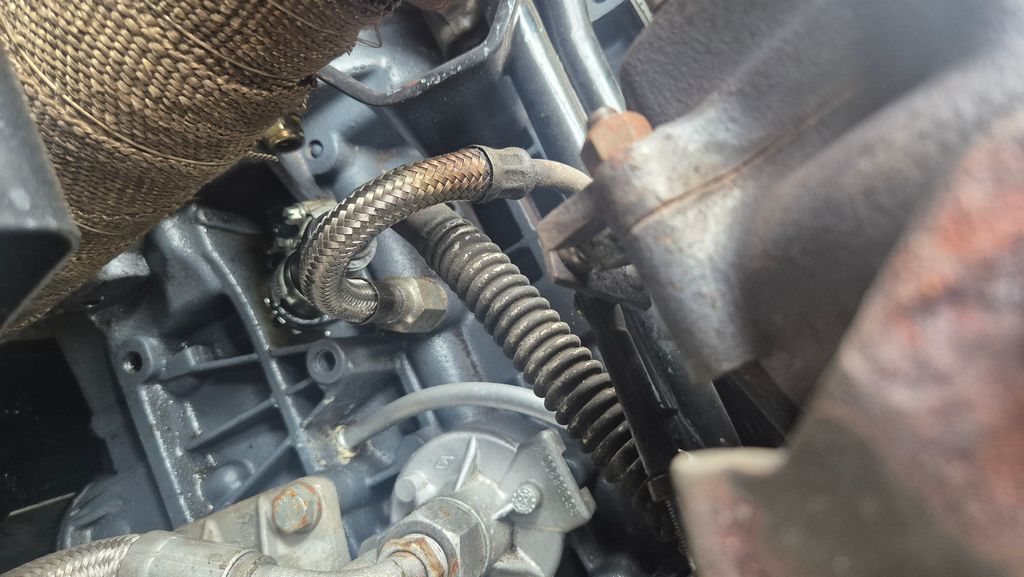

The new engine has decent oil pressure, actually probably a bit too much, the engine builder has probably messed with the oil relief spring. The turbo oil feed has given up with the extra pressure, and started leaking down the block right by the hot exhaust (look at the pool around the base of the return)... so I couldnt leave it like that. Made a new one from torques AN fittings and teflon braided line. The block is M18, so M18>AN6 fitting, AN6>teflon line, teflon line>AN6 and finally AN6>1/8" NPT with a 90° bend which screws into the turbo flange.
