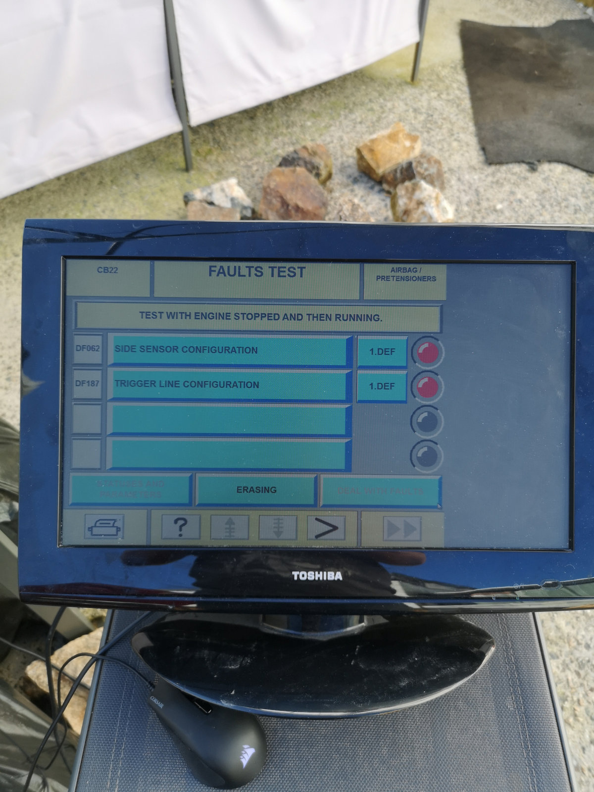

Any insight on Airbag CLIP fault codes?
Car  Clio Williams & 182
The plugs under the seat are disconnected and switched off in clip. The driver airbag is not wired in and also switched off. Not sure about the passenger airbag wiring, but I turned it off in Clip too....
Have a read here.
Sounds like yours is a 2nd hand airbag ecu and has a different configuration to your car. Need to reconfigure to suit your setup.
Thanks, yea I read that thread. It could be a different airbag ECU but even so clip can modify the config to whatever setup I need. I am struggling to find what is on the trophy or not. The last 182 seemed different.
Not that I can see. The ECU isn't locked either. I think I have to go through the clip settings and figure out what is still on or off with regards the airbag stuff. It used to have different seats and wheel but the trendlines are back in as is steering wheel, albeit put in with the angle sensor upside down, but I've sorted that!
