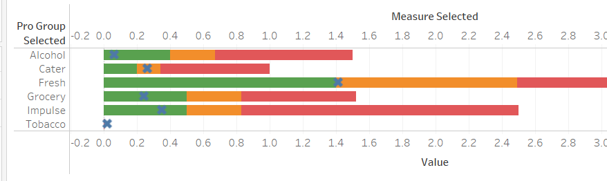

I'm stuck with making a dynamic chart where the results of a parameter change 3 targets and an actual.
I have two data sources - One containing the actual's, among other things and one containing the targets.

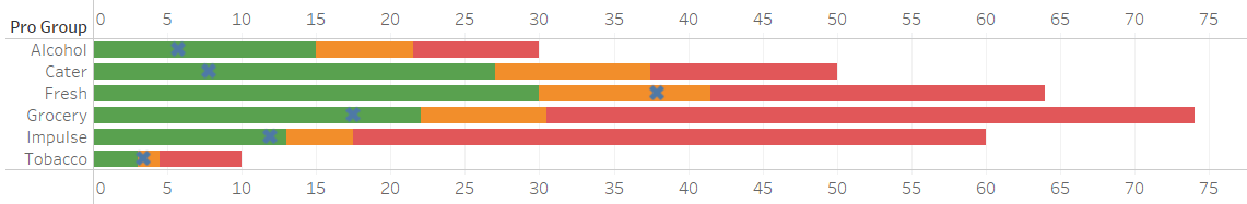

I have a stacked bar chart to represent the targets and a X to represent the actual:
** The data in the tables is made up and not representative of the data in the graph.

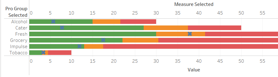

Now I wish to make this dynamic, so if a user selects "GT" they get the results for GT, TNA for TNA and PC for PC.
I have created a Parameter to do this ([Select Measure]), as well as a calculated field:
This works fine, I have added it to the Columns shelf and it changes with the parameter drop down, however I am unable to get the RAG Targets to do the same.
