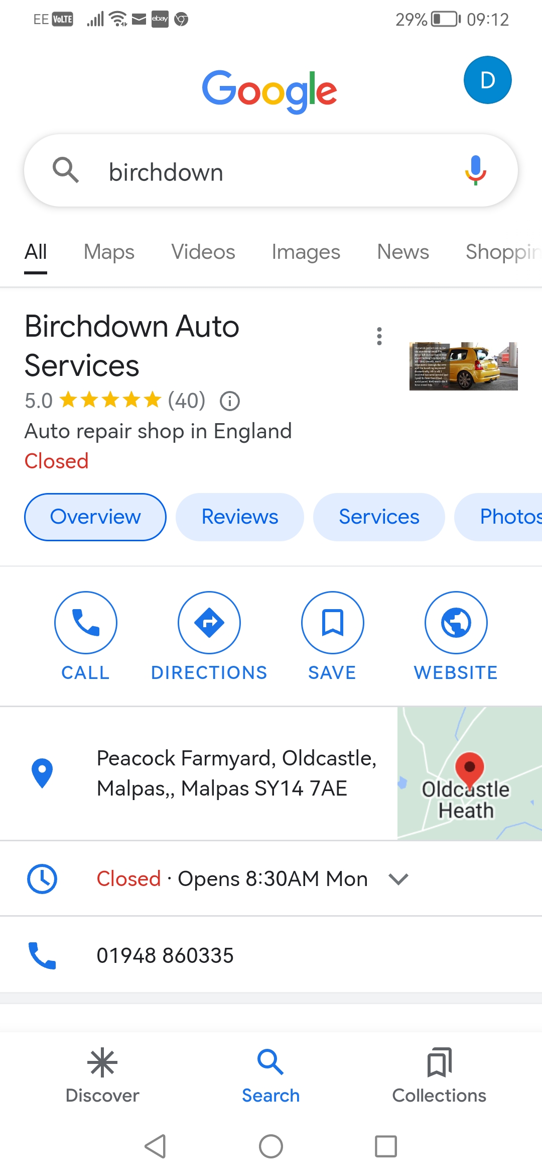

Just done a Google search, that seems like a good option, would be more than comfortable with them doing the job, just have to ask if they do a mobile service as the car is in bits from front to back with trying to get all my new parts fitted , wheels half way through refurb etc. cheers for that bud 👍🏽 Appreciate it

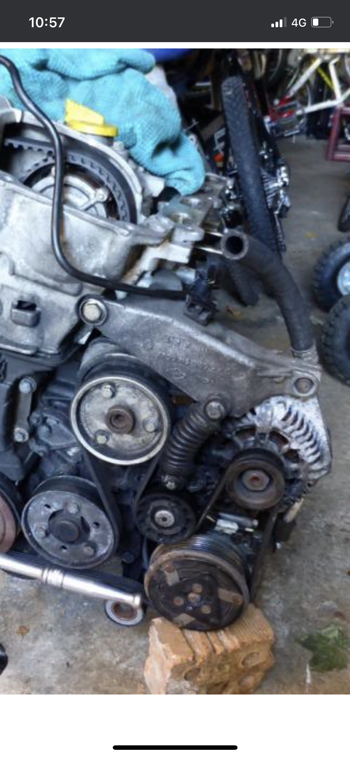

photo of this forum… mine is doing the same.

Yeah, looks about right for the sleeve to be seized to the tensioner.
It is repairable, mine was seized when I did my belts. Knock the sleeve out, clean up and bit of ceramic grease. I just fitted a new pulley on my tensioner as the tensioner itself is bullet proof being just a spring. Only things that go wrong are the pivot sleeve and the bearing wear in the pulley.
