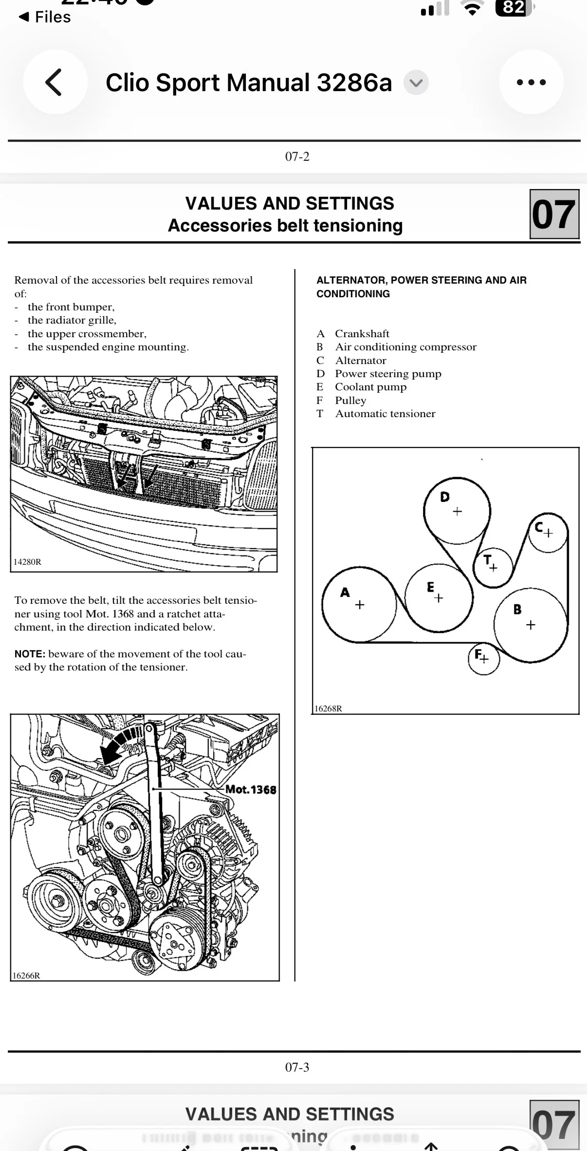

Is the belt run def correct?
Yep, the belt routing is right, I’ll have to try having the alternator pushed down, didn’t think to try that as I imagined it would put more tension on that part of the belt.
