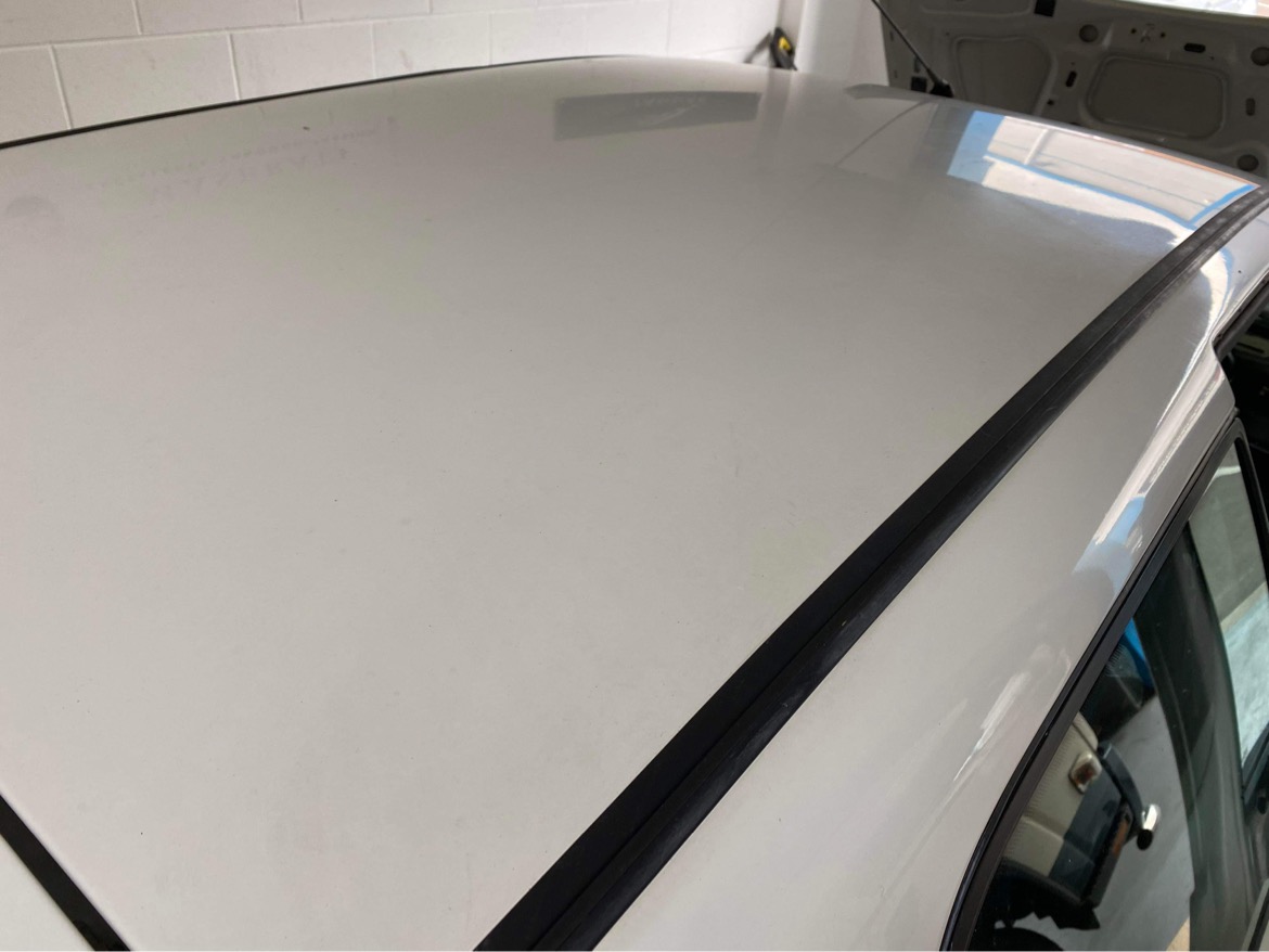

I removed the sunroof, refitted it. Siliconed it shut and it still leaks. Got a mint roof and rails, I need a roof liner though.

I have a MK1 and had the dreaded sunroof leak. have you looked at the arial? the rubber seal between the base of the arial and the roof can perish and water gets in then drips in through the roof console/interior lights. I got a new rubber off ebay and put a bit of silicone in and it worked for me

I know what you mean. I did that with my punto gt back in the day and it cured it. On the valver I have replaced the aerial for a new one.
I did the same, a couple of weeks ago, Mine doesn`t have any drain holes as standard so it really needs to be water tight both on the body to frame but also the rubber seal pressed against the glass.
