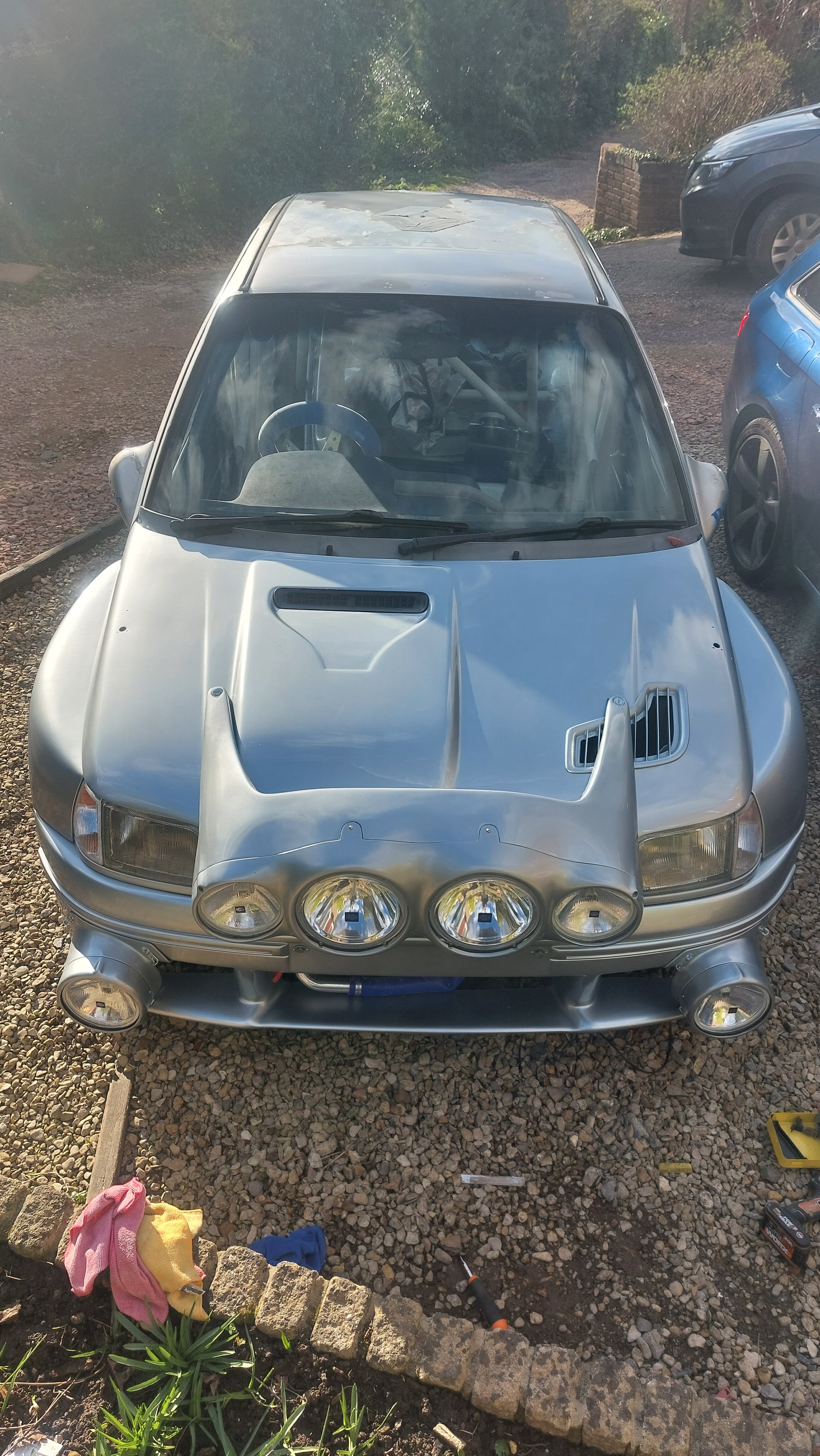

There’s so many options to make the car a maxi with regards to suspension with my basic (no) knowledge of the Clio, it’s a bit overwhelming. I’m a classic Mini and Vauxhall Corsa/nova person which I’ve rallied. So I’m starting to bring another option into the mould.
1. Go maxi replica.
2. Go back to Clio Williams group A replica
Reasons:
1. With the maxi, I’m doing research and I can only get a full maxi body kit from France or Spain and all the good suspension components are there as well. (I don’t want to do spacers) the problem with that after brexit, there’s a lot of taxes involved, vat, import tax and delivery charges. It’s adding half and more to the advertised price of things…also the time involved.
2. Taking off the body kit on the car and putting it back to a clio Williams with 16” Prima wheels and yellow/blue livery might make it that I can utilise what is an already good sorted car, but more of a replica from times gone by.
So, I’m in a bit of a predicament at the moment. I’ve spent 3 weeks reaching it and have had a lot of help from you guys and another guy from Denmark helping me on everything‘ Clio rally cars and where to get parts from and videos.
So I’m now undesided which way to go. Both ways are rally replicas Renault blue/yellow, but do I go full on maxi or stay safe with the group A replica?

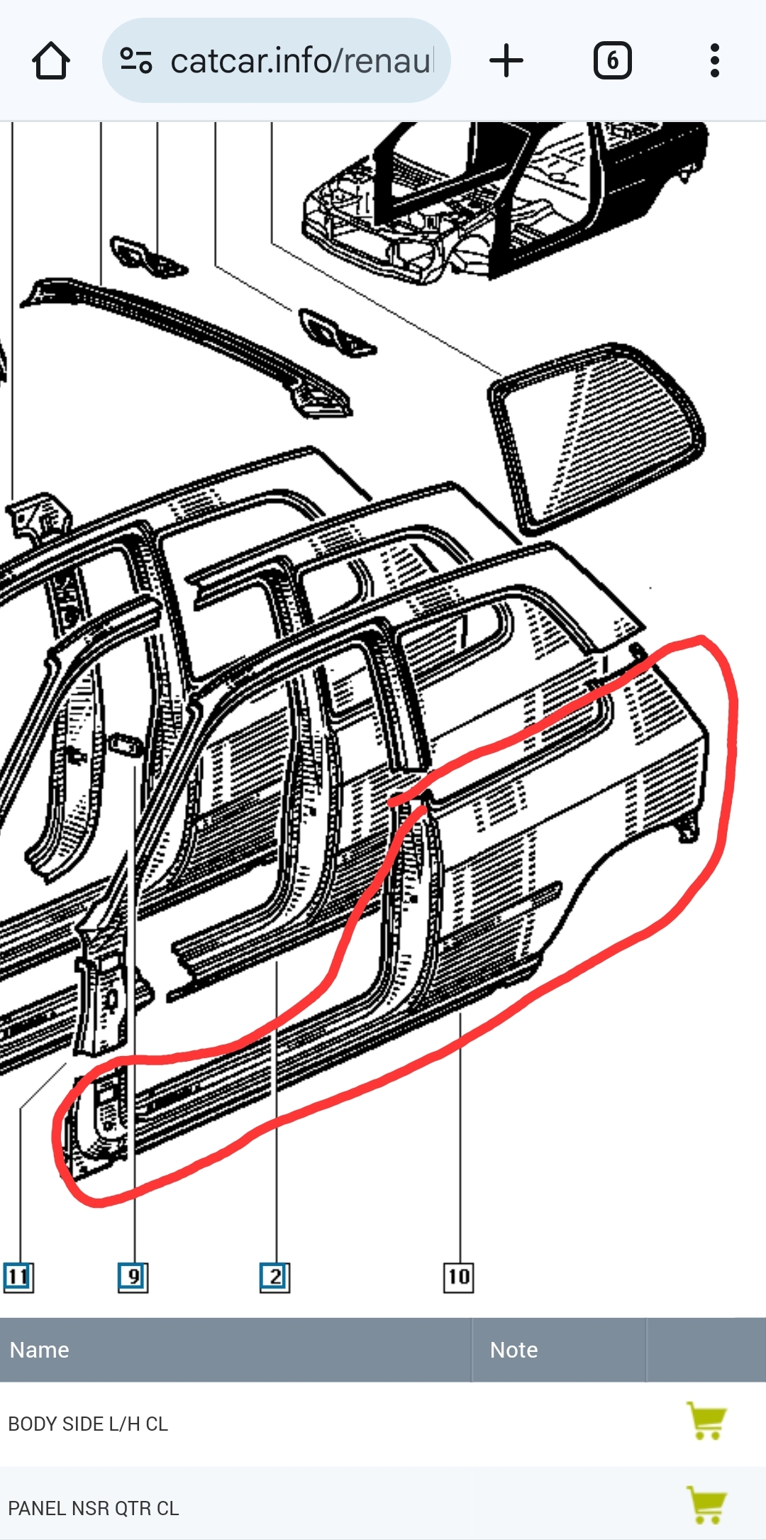

For all intent & purposes there's nothing special or different about the Williams, it's just bits bolted to the shell that make them different
Same applies to the lower spec shells, it's basically just this panel circled on each side that makes the 16v & Williams different

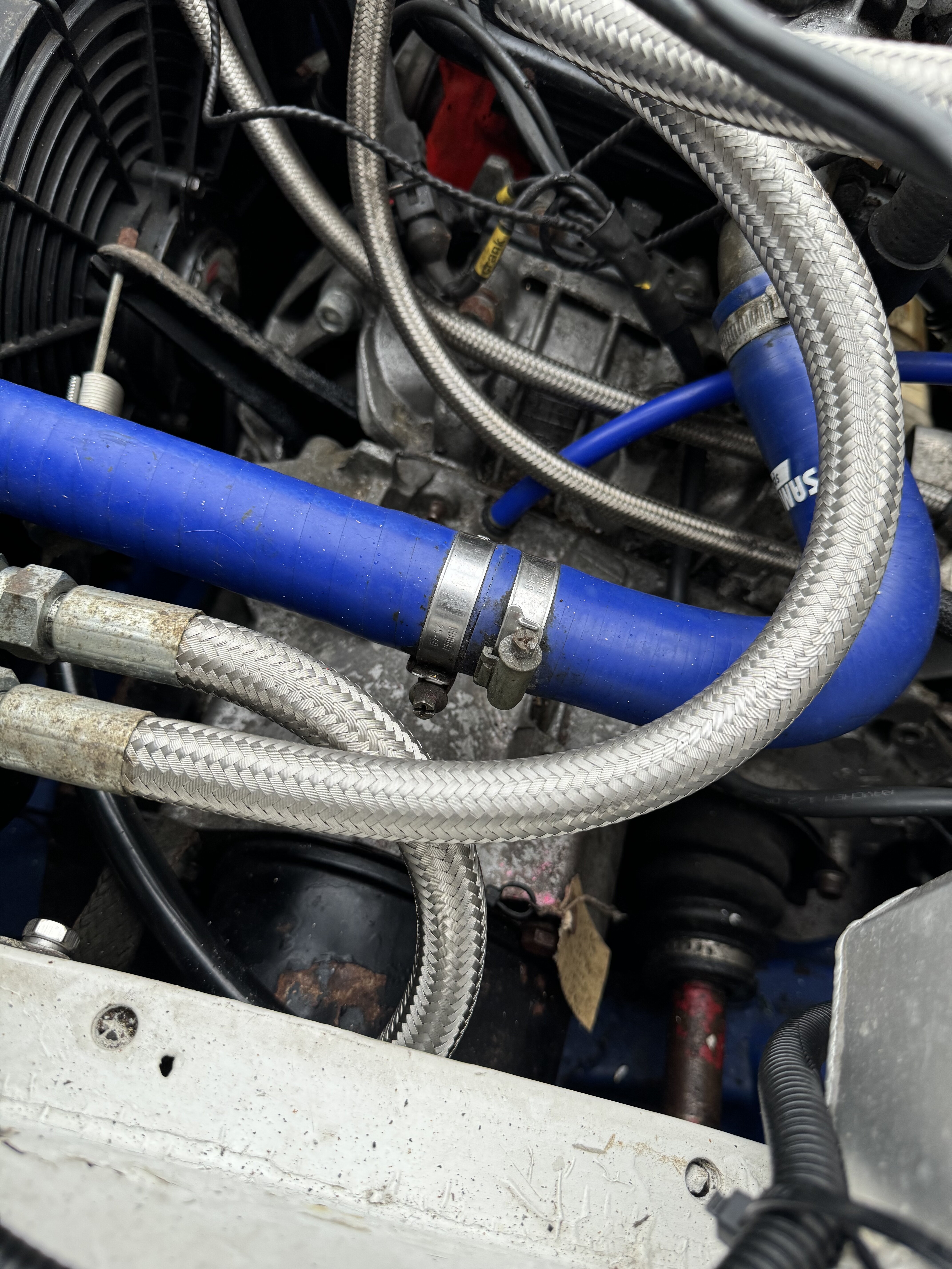

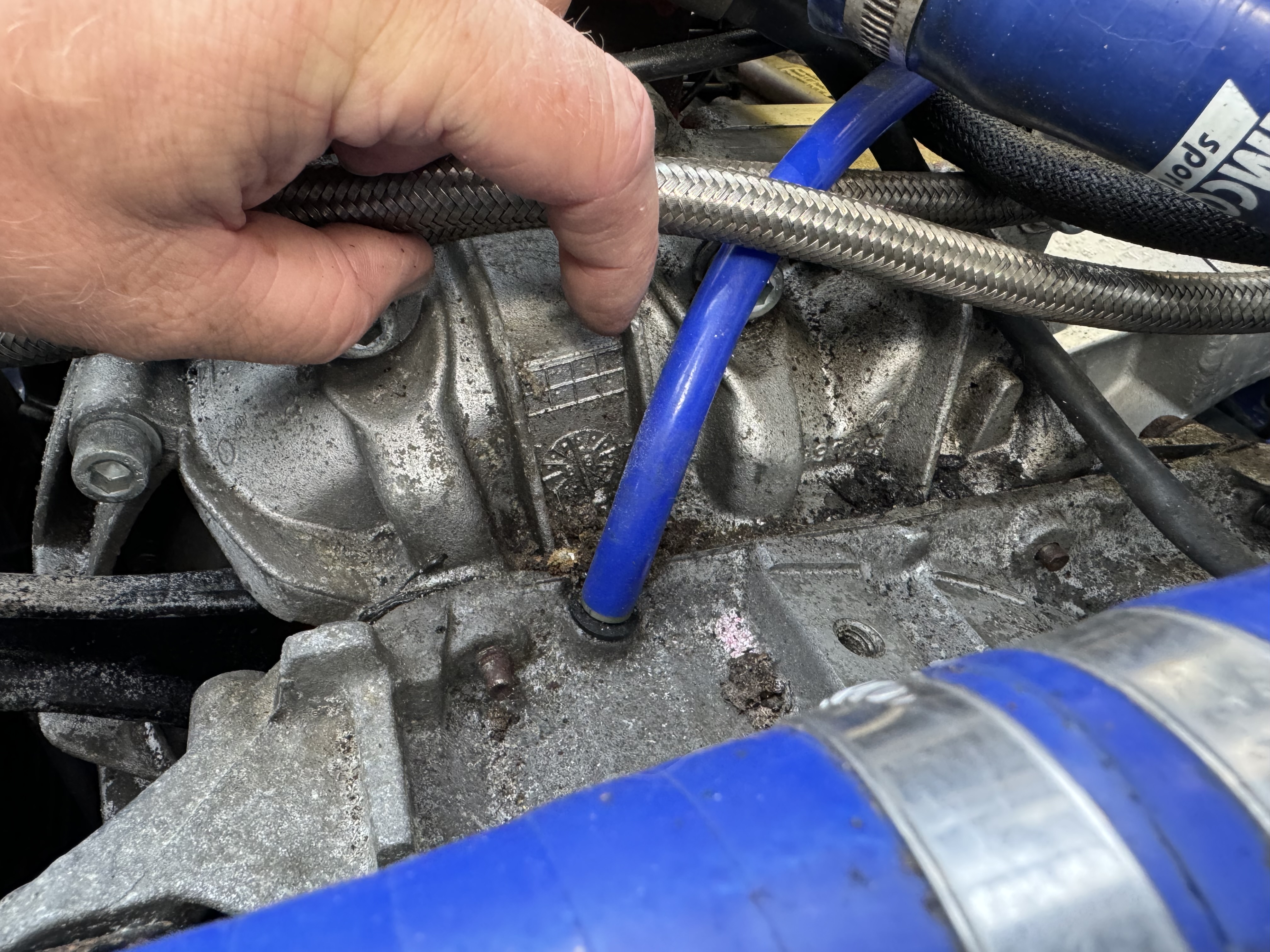

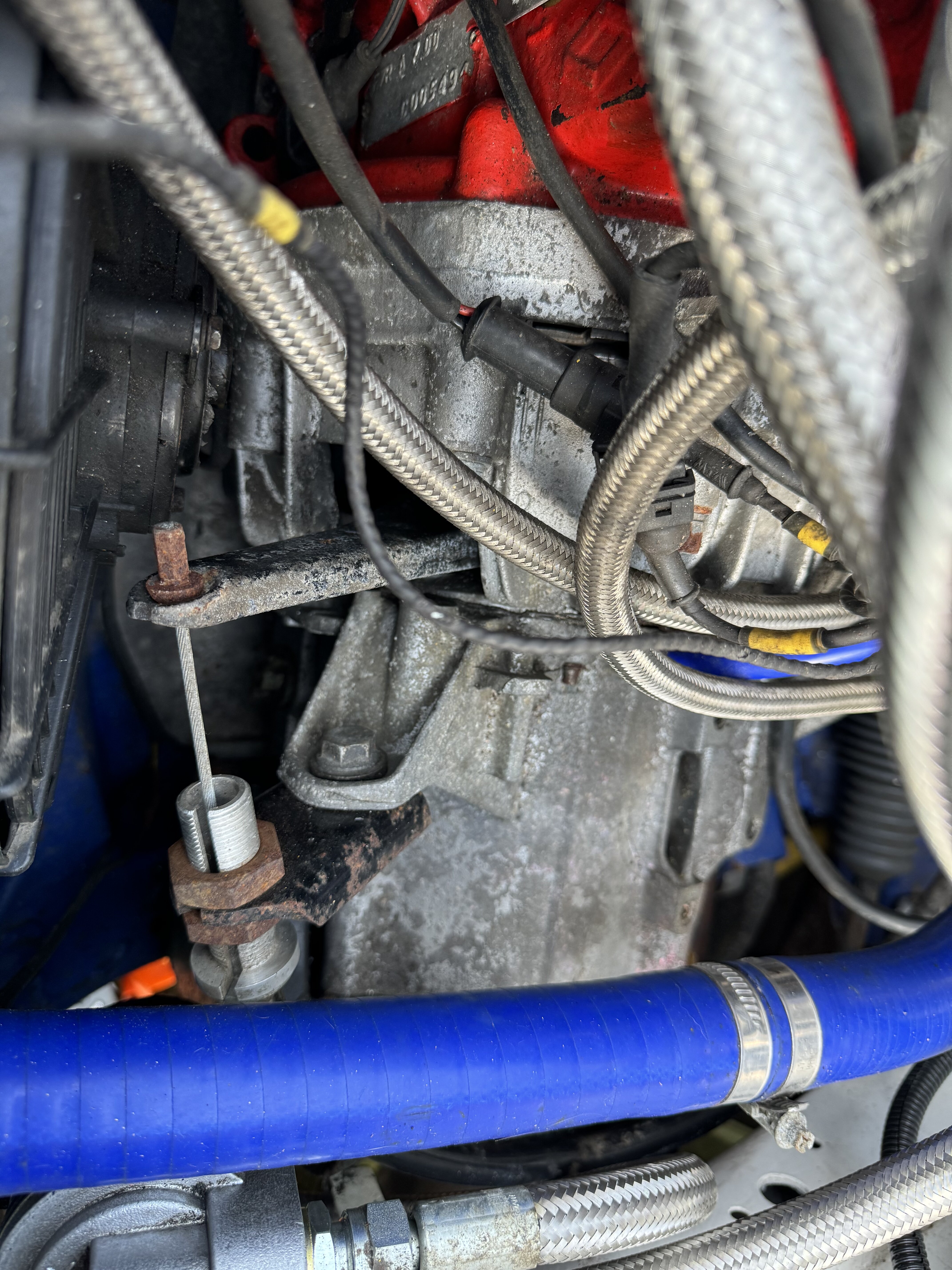

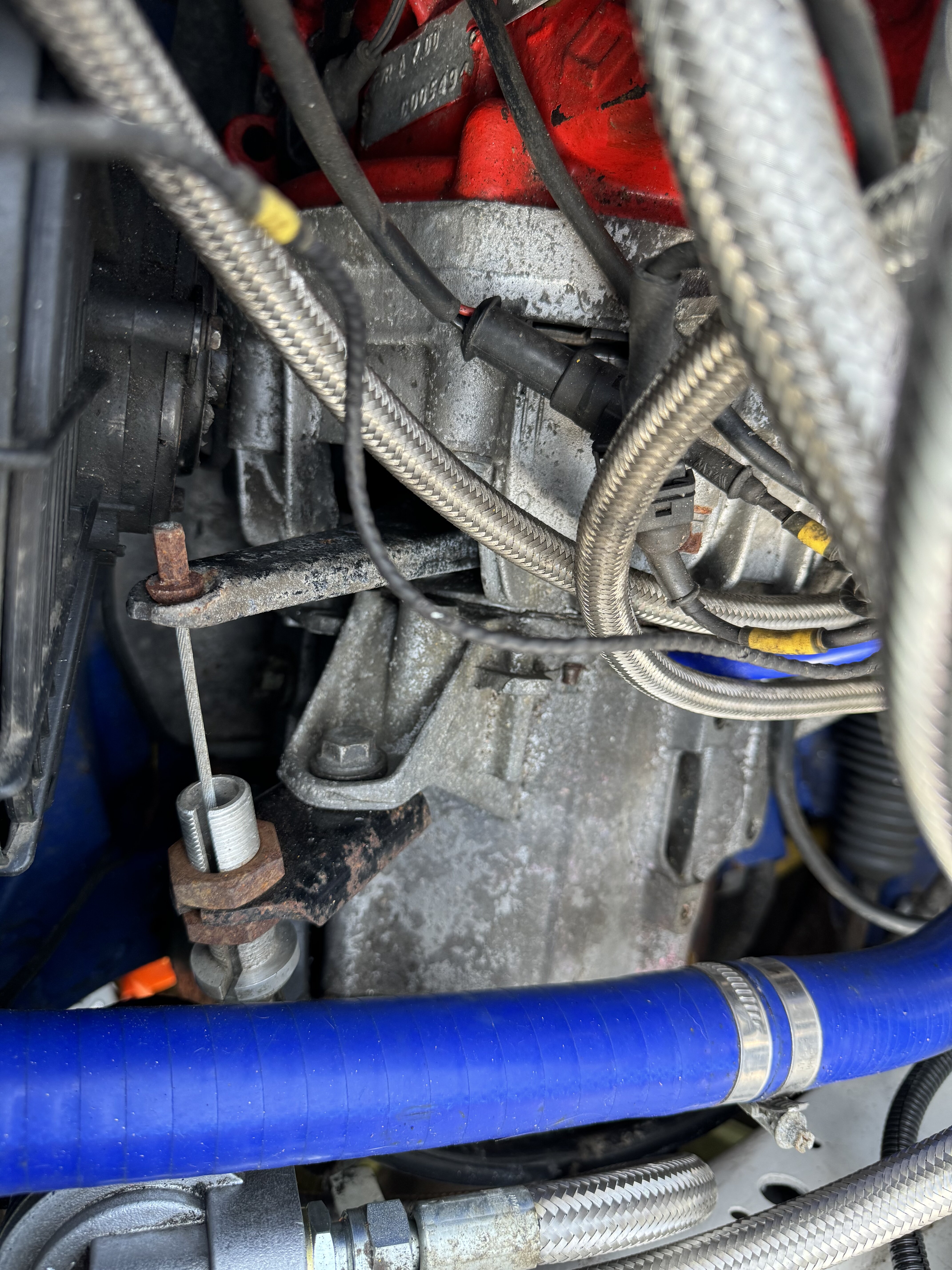

Can you see the box under all those pipes? Is it a jc5?

Annoyingly the pipes are blocking the exact bits I need to look at to id the box 🤣
I'm trying to look at the bolt holes on the top of the box where the mount normally goes.
If it's a speedo drive box you'll be able to see a hole for a speedo sensor or cable to plug into on the top of the box near where the driveshafts go in

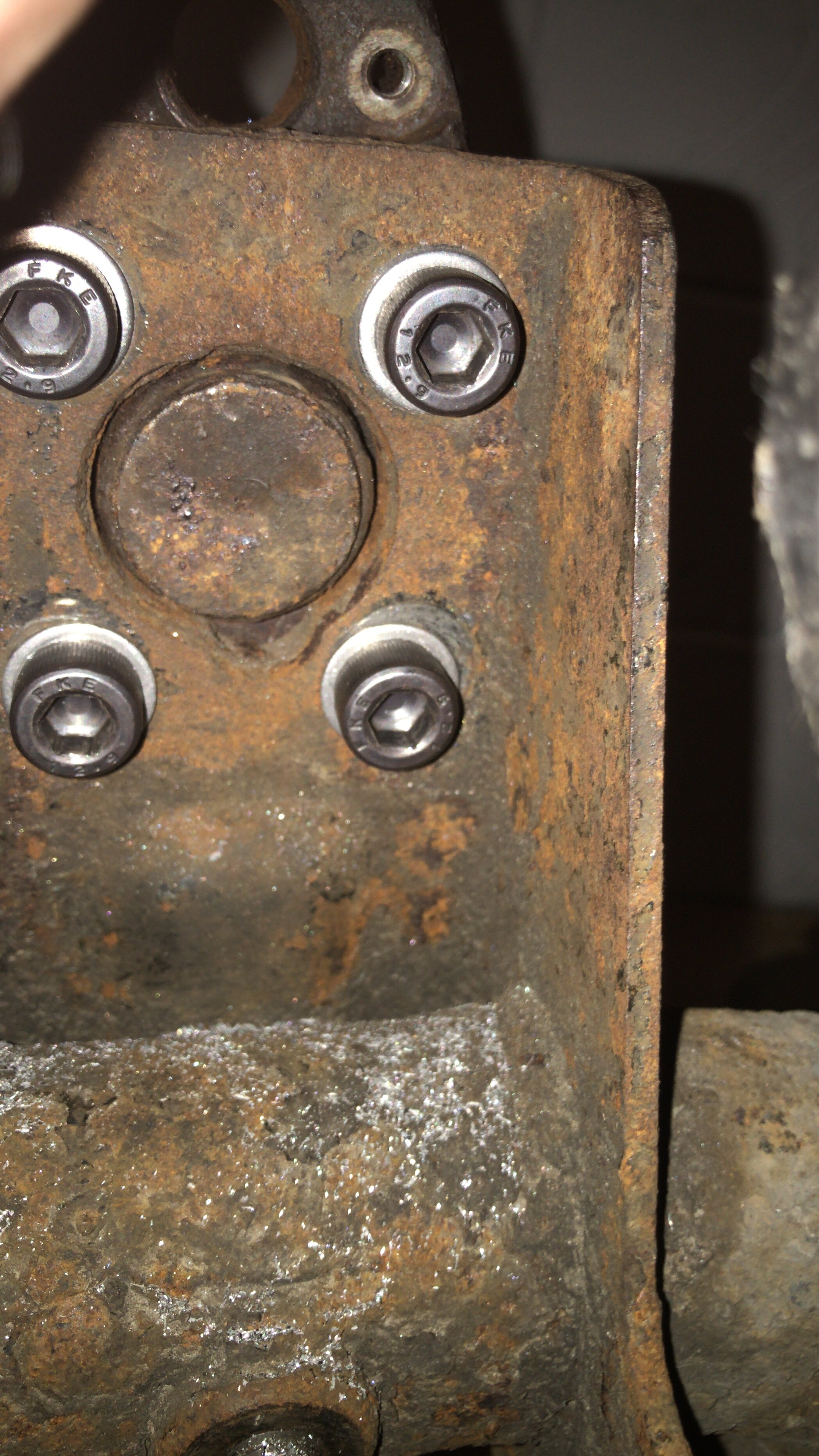

I can see that it's got a mk2 clutch fork

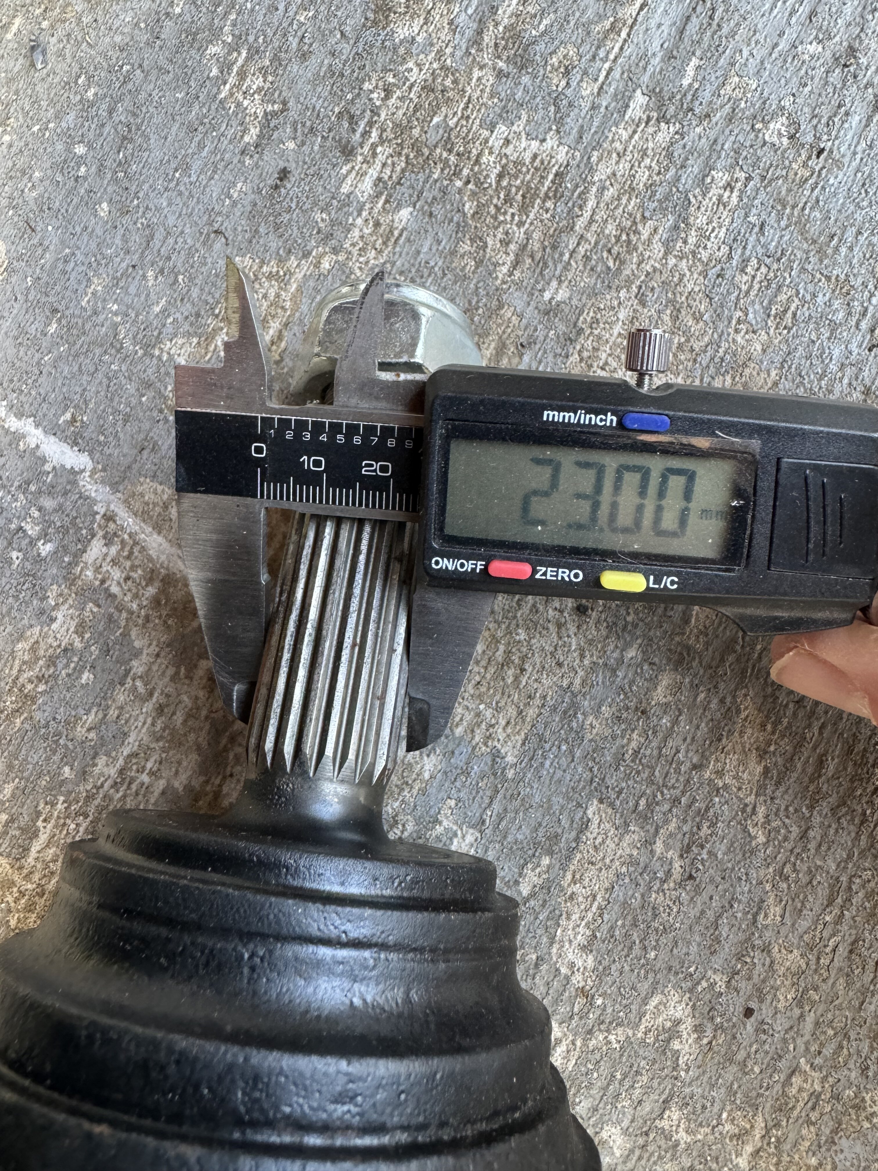

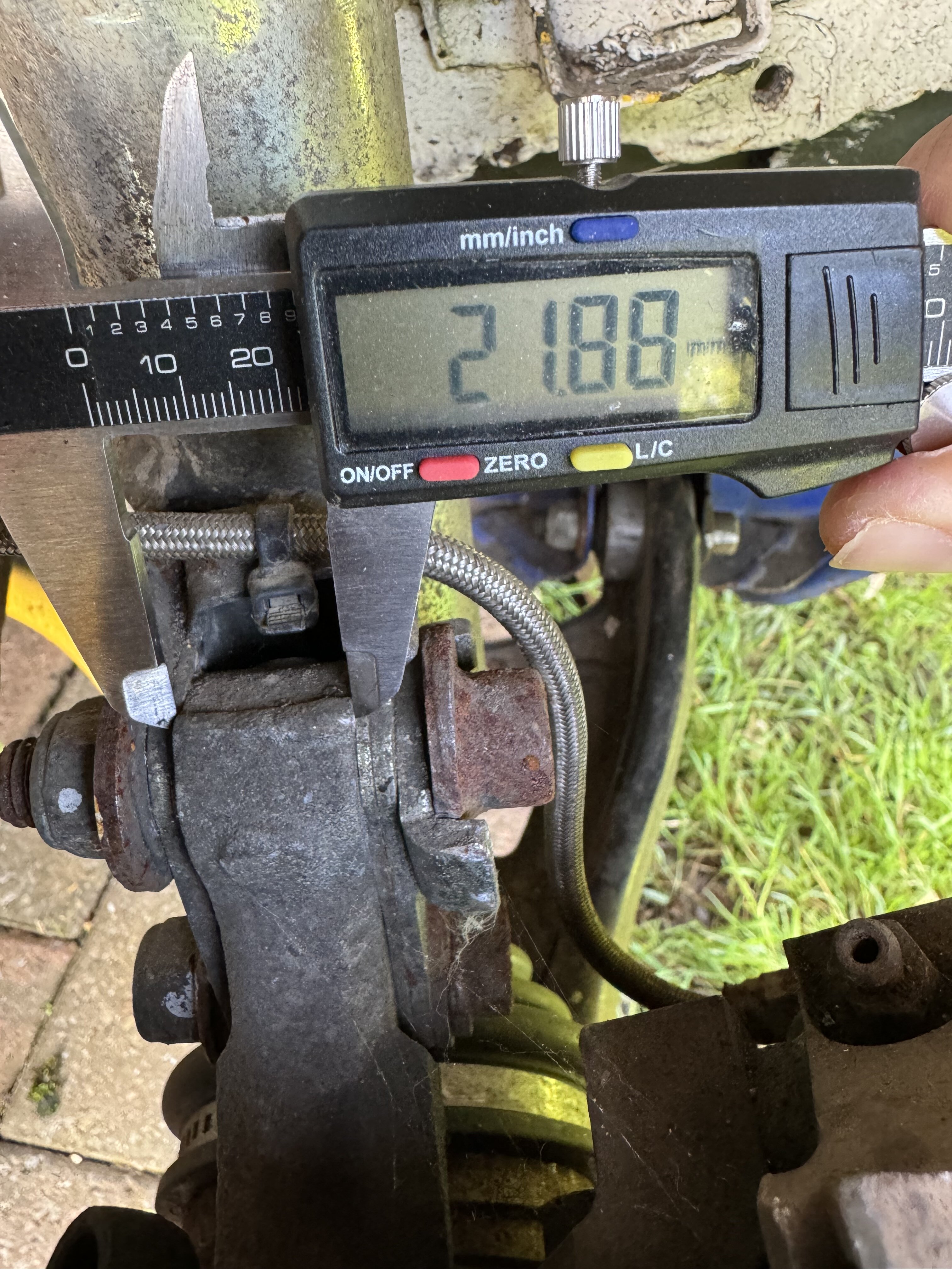

If you measure the diameter of the hole in the hub for the driveshaft spline as well as the thickness of the stub axle where it attaches to the shock absorber you'll know if it's a mk1 or mk2 hub as they're different sizes (I can't remember them off the top of my head) which will also help tell you what the rest of the suspension bits are
Hi paddy,
Here’s the dimensions of the overall diameter of the driveshafts splines 23mm and the hub where it fits into the bottom shock mount 22mm. (See photos)

Hi paddy,
Do you know which hub it is?

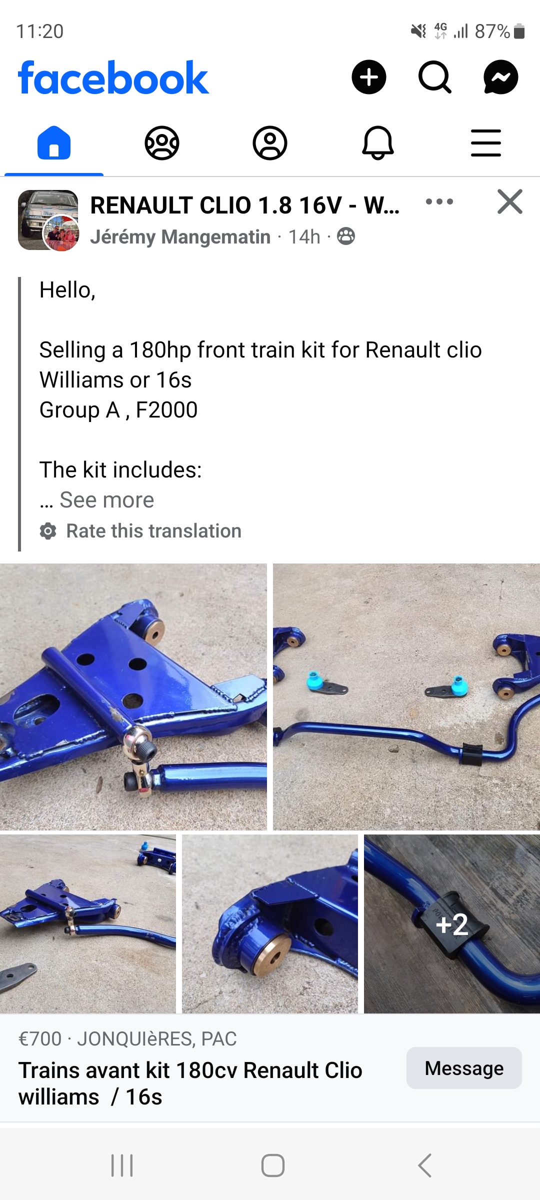

I also found this in case you go down the Group A route

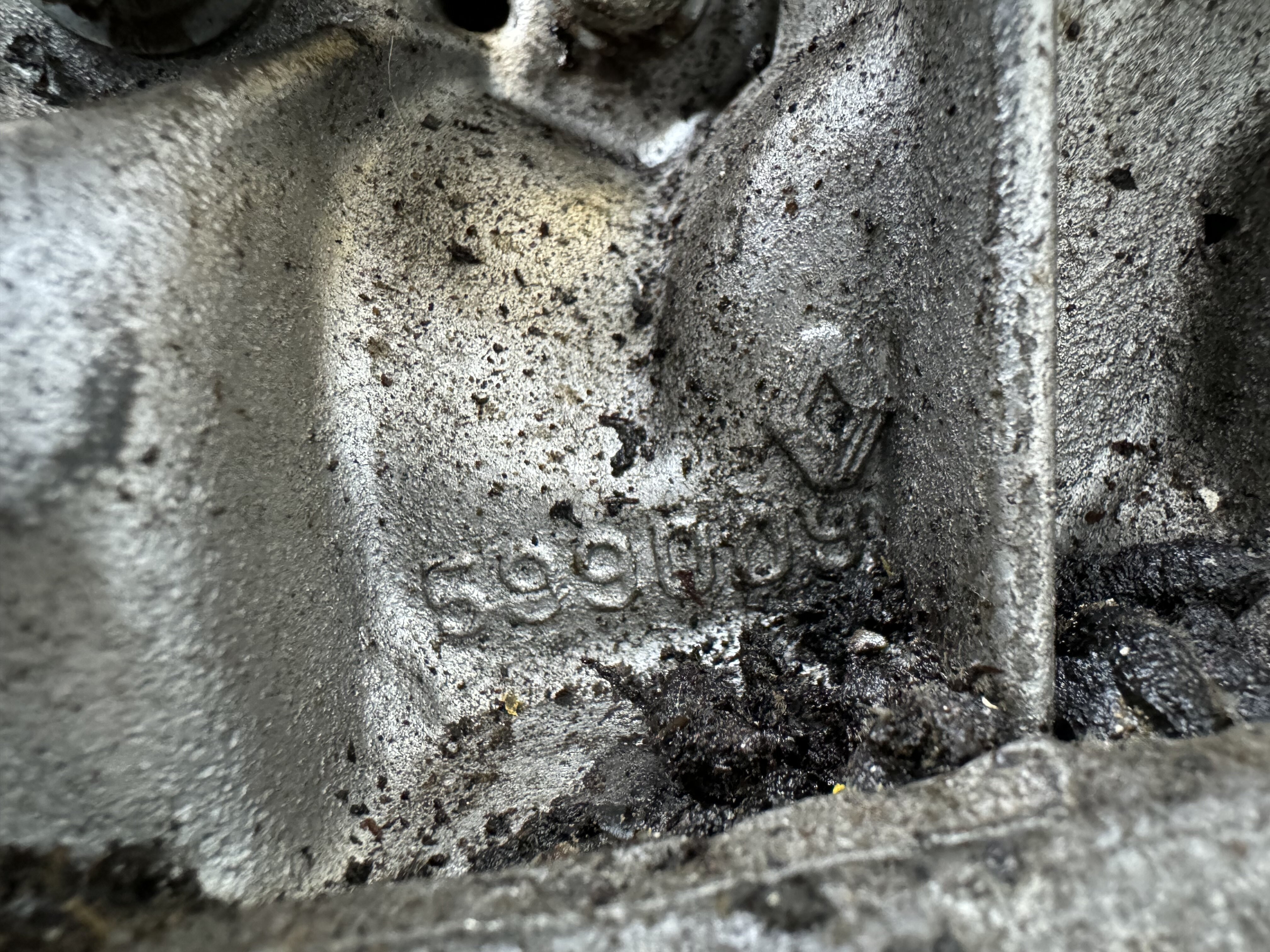

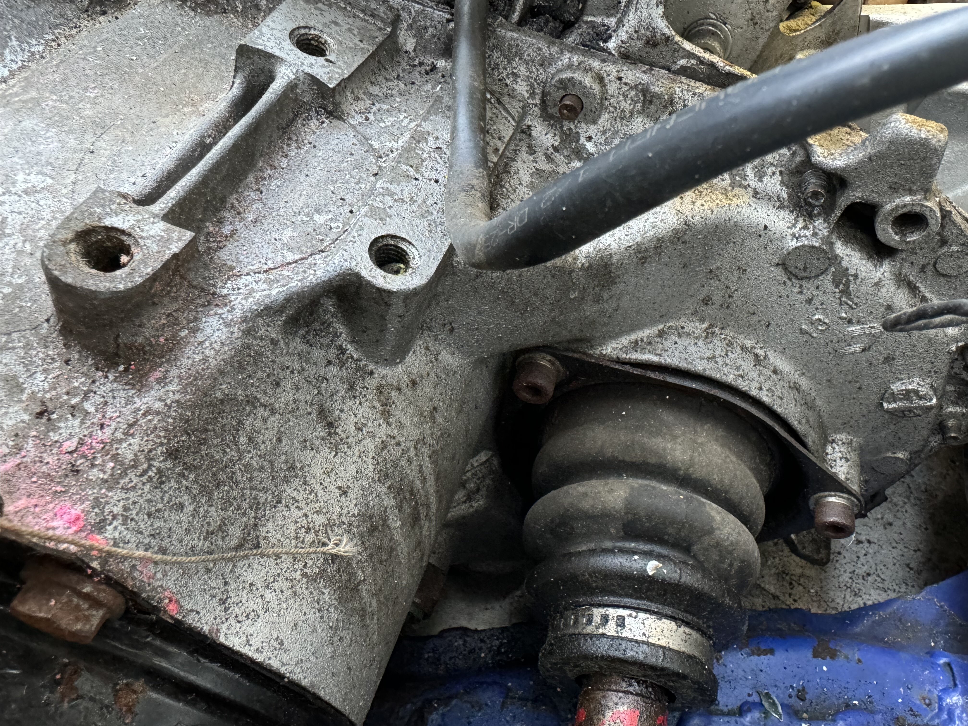

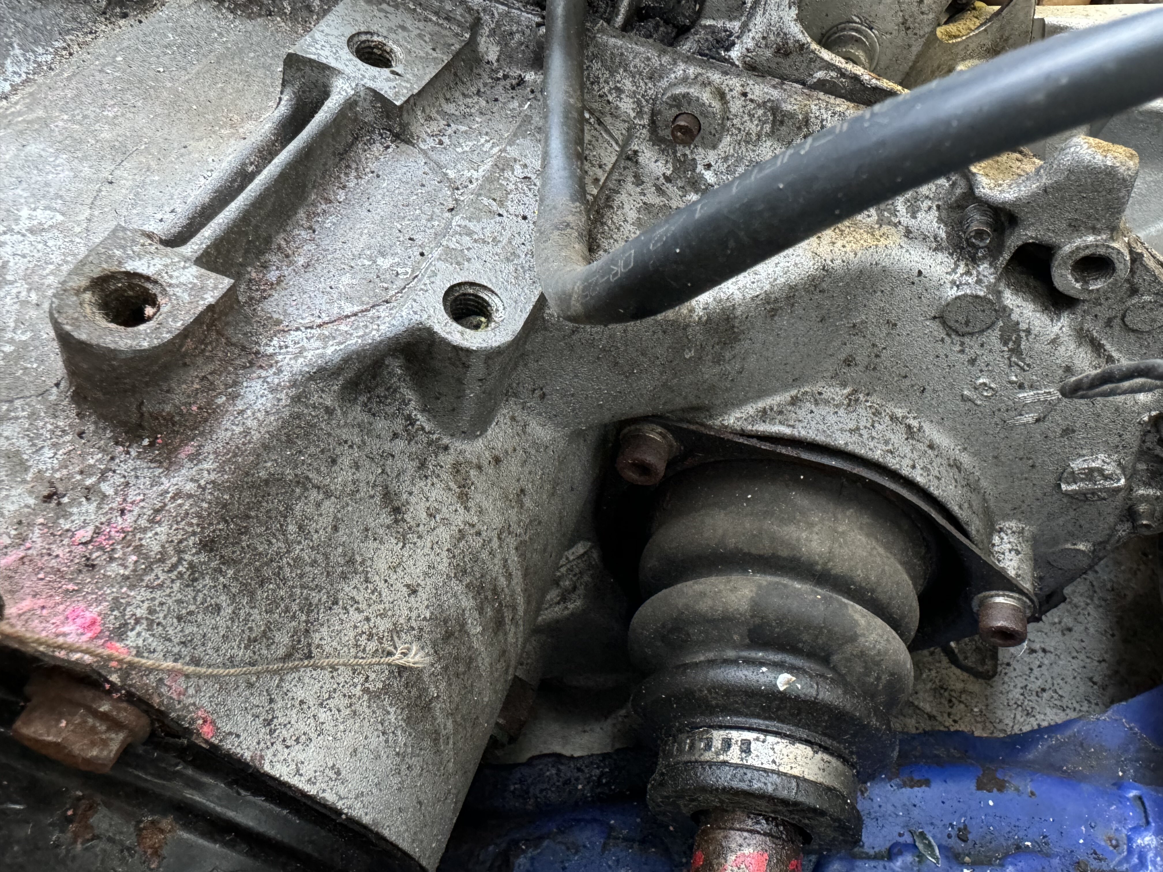

Here’s a few more photos for you. I’ve checked the paperwork with the car and it says it’s a Jc5 gearbox fitted with Avanti gear set and lsd.

Yeah that's a Mk1 box from a Williams but if the gearset inside has been changed it doesn't really matter what you call it, on all the JC5's the 3 numbers after it are what determines the ratios etc inside it

Yes I did.....................sort of, the Mk2 hubs are 26mm thick so yours are deffo Mk1 items.
Unfortunately I completely forgot about the CV joint splines, I'd say they're most probably mk1 items as well but the hub flanges are interchangeable between the 2 so can't say with 100% certainty

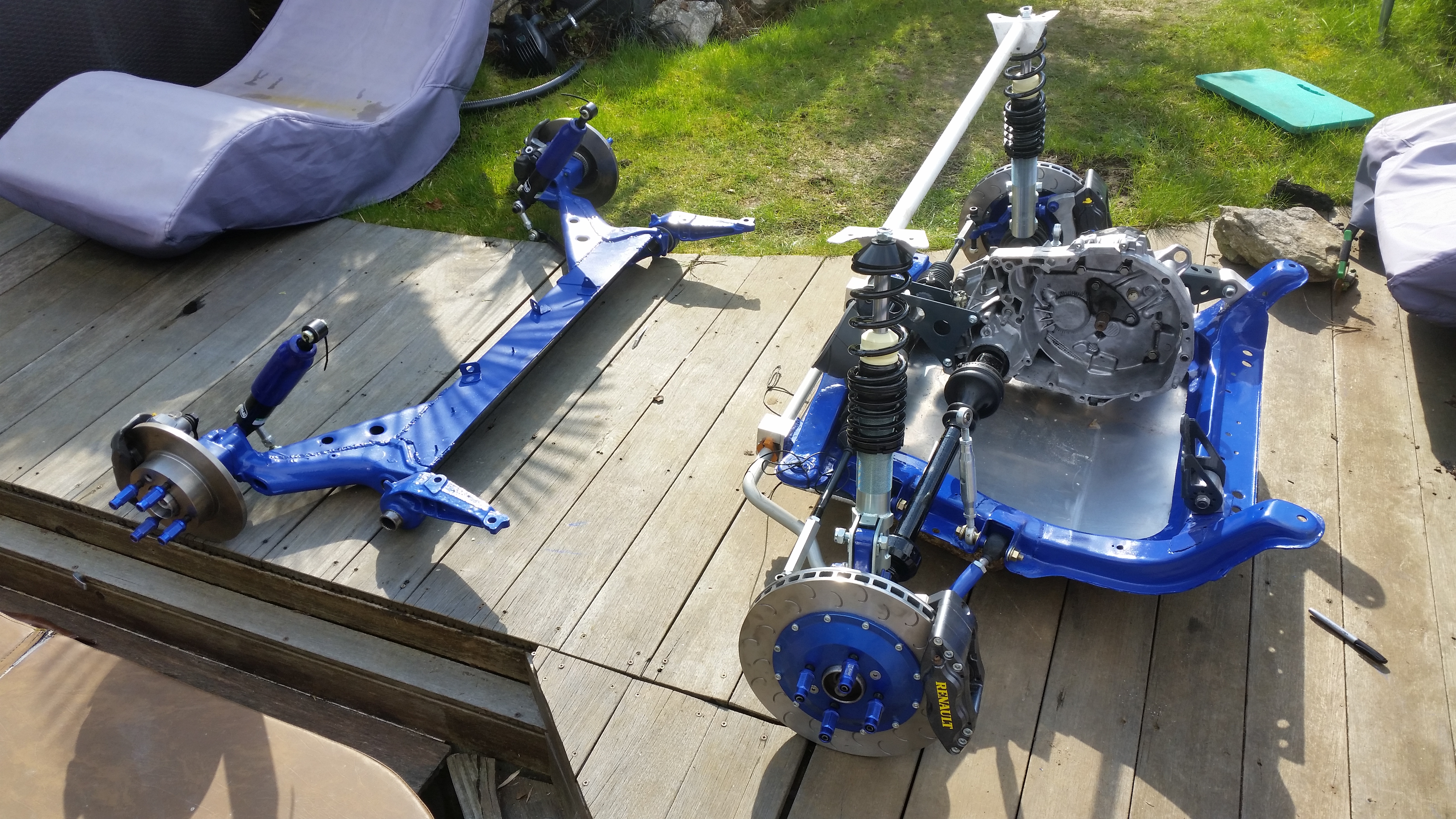

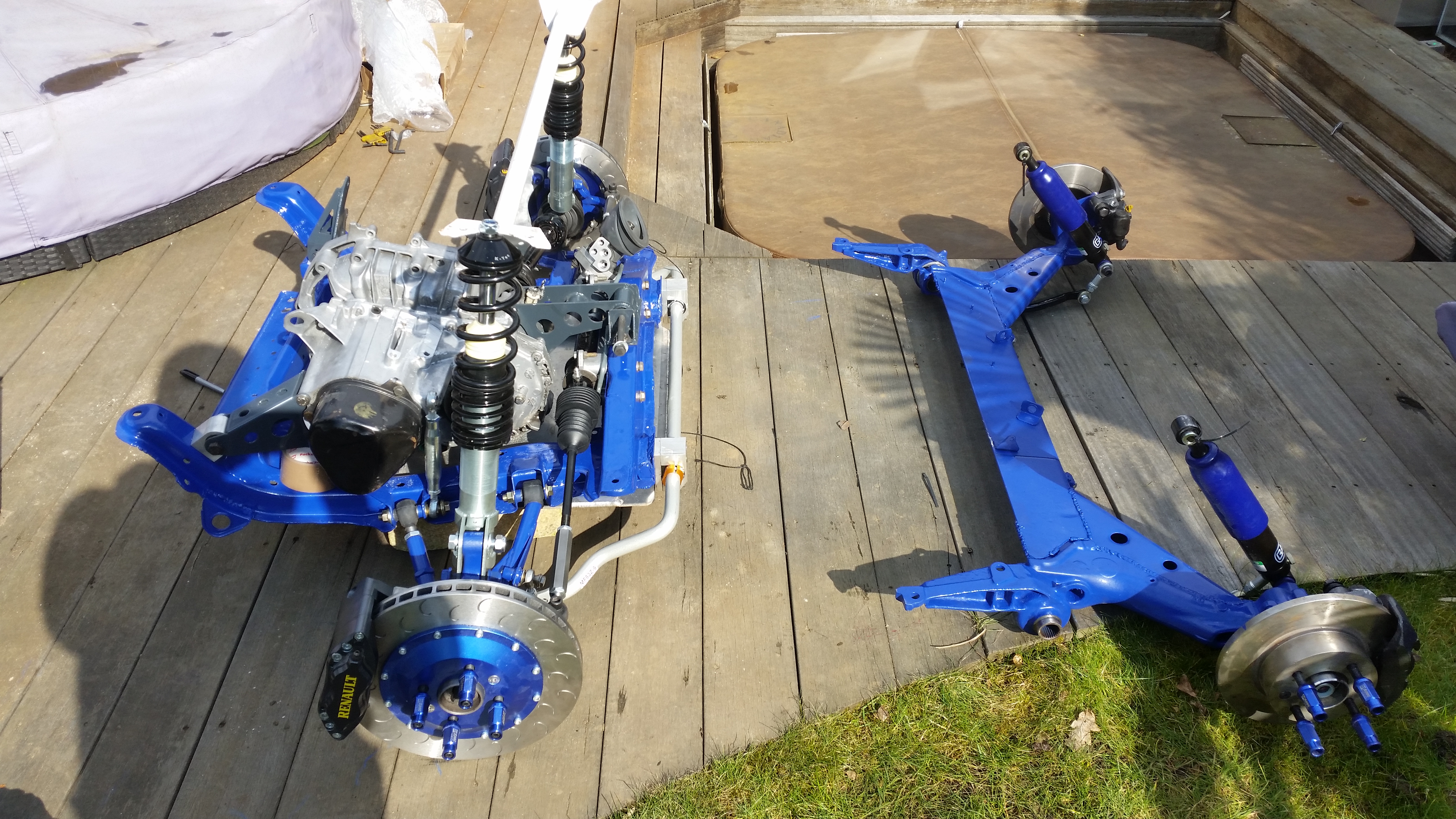

just re registered on here after reading there are other mentally disturbed people trying to do what ive spent the last 12 years trying to do.. good luck is all i will say.. everything ends up being custom if you want to follow the original cars. but if some of us get there it will be well worth it.. just a few pics of my never ending project.. excuse the shocks.. for now
just re registered on here after reading there are other mentally disturbed people trying to do what ive spent the last 12 years trying to do.. good luck is all i will say.. everything ends up being custom if you want to follow the original cars. but if some of us get there it will be well worth it.. just a few pics of my never ending project.. excuse the shocks.. for nowView attachment 1759285View attachment 1759286View attachment 1759287
More pics/build thread required 👍

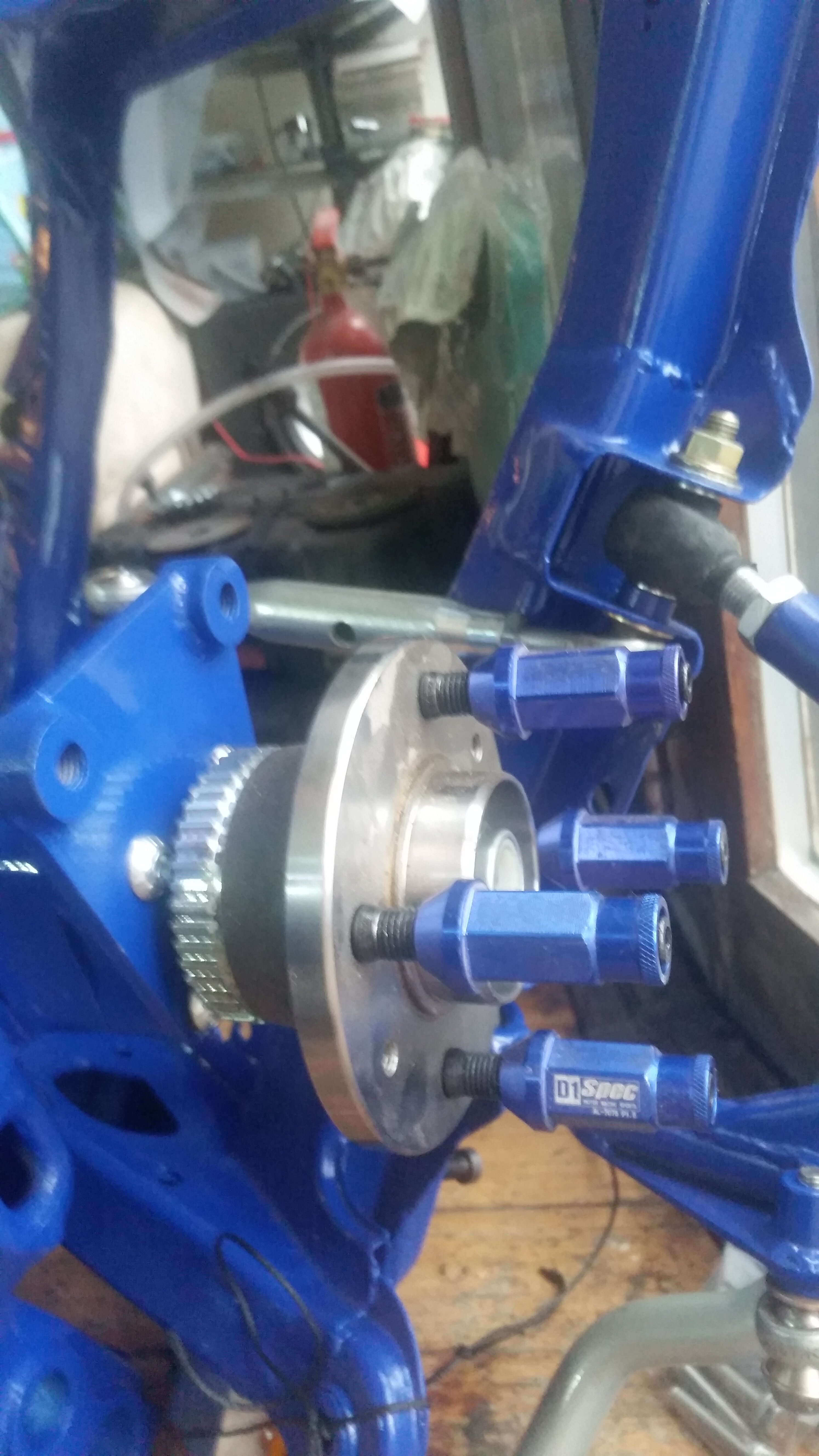

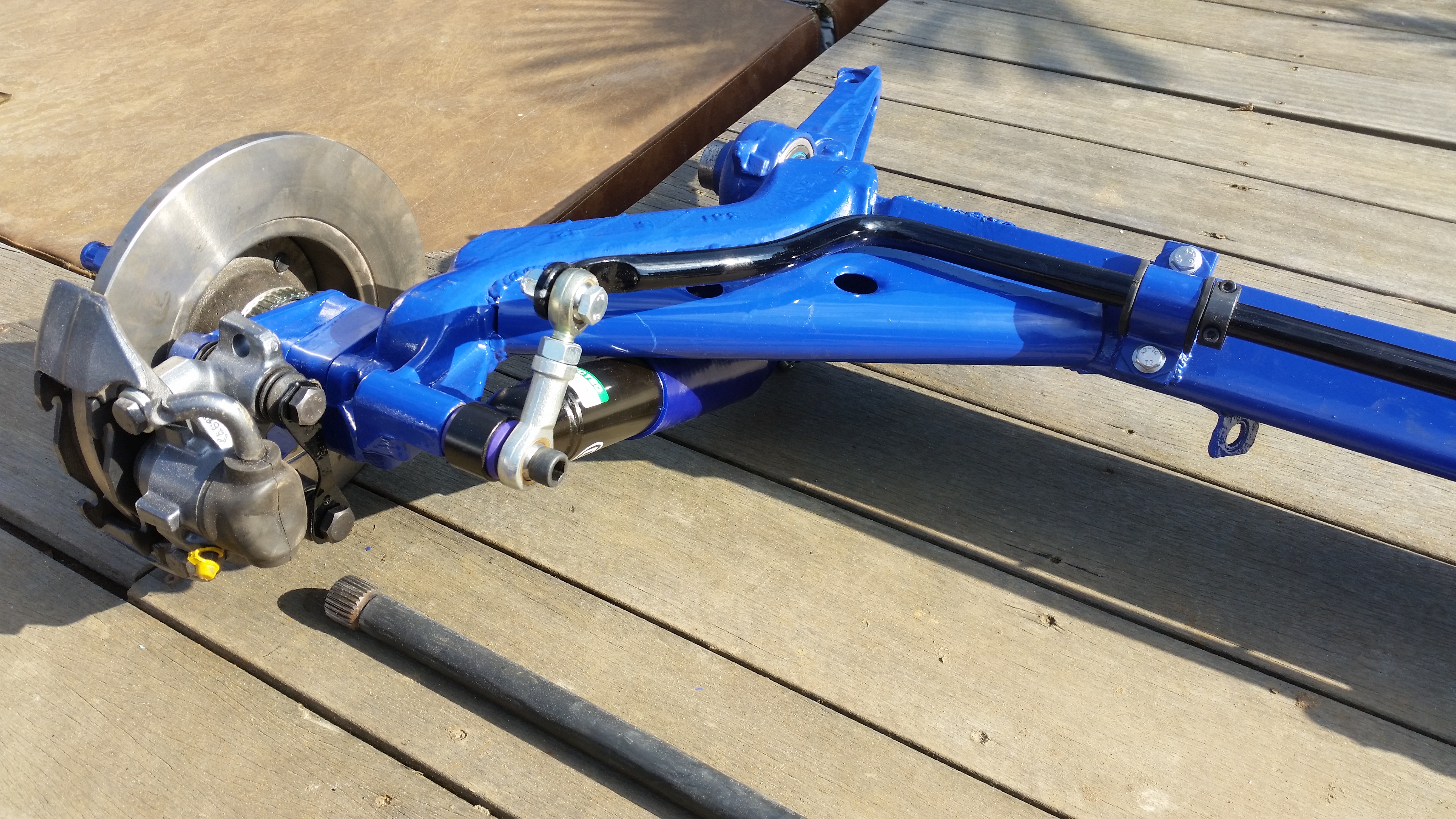

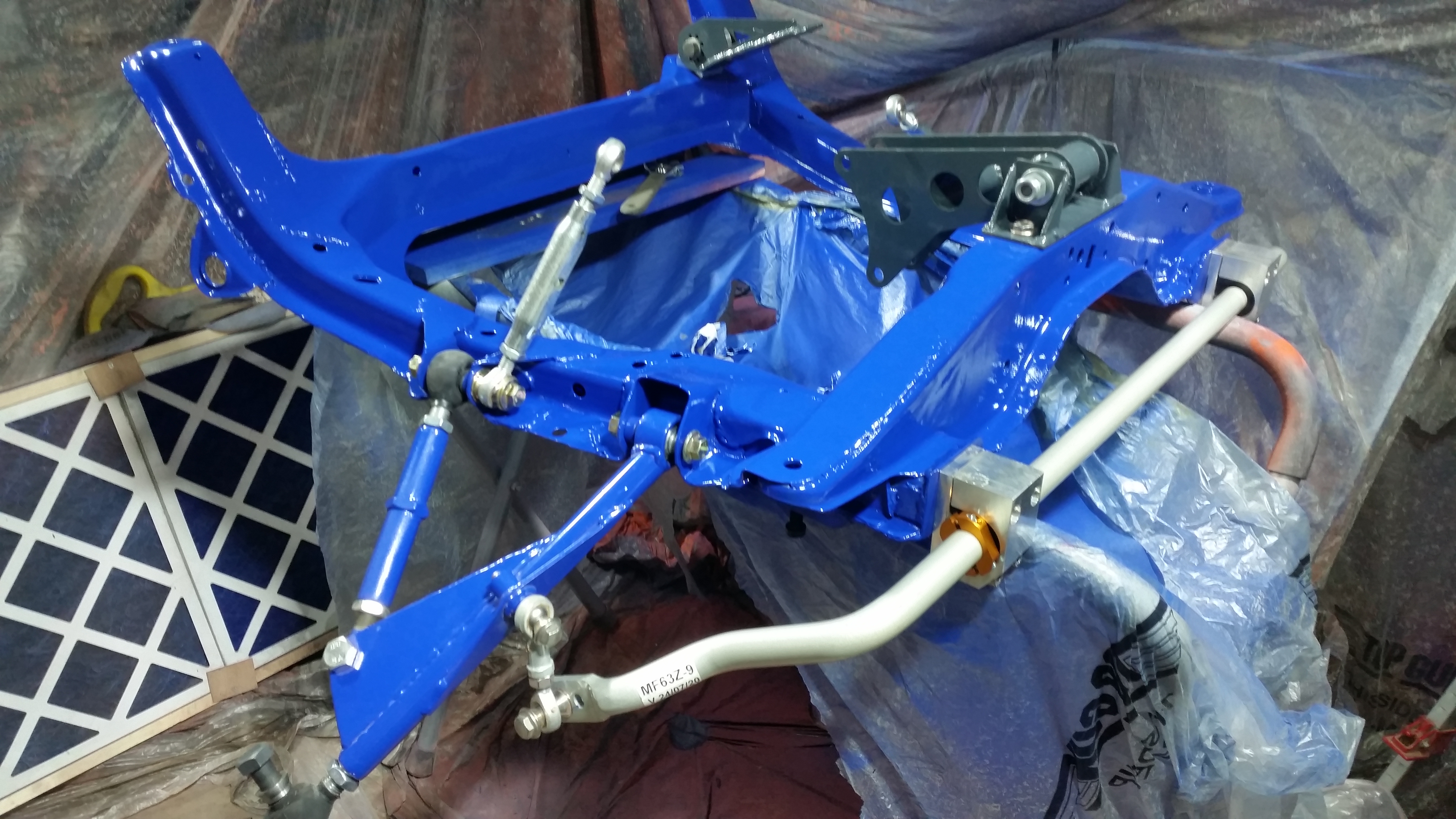

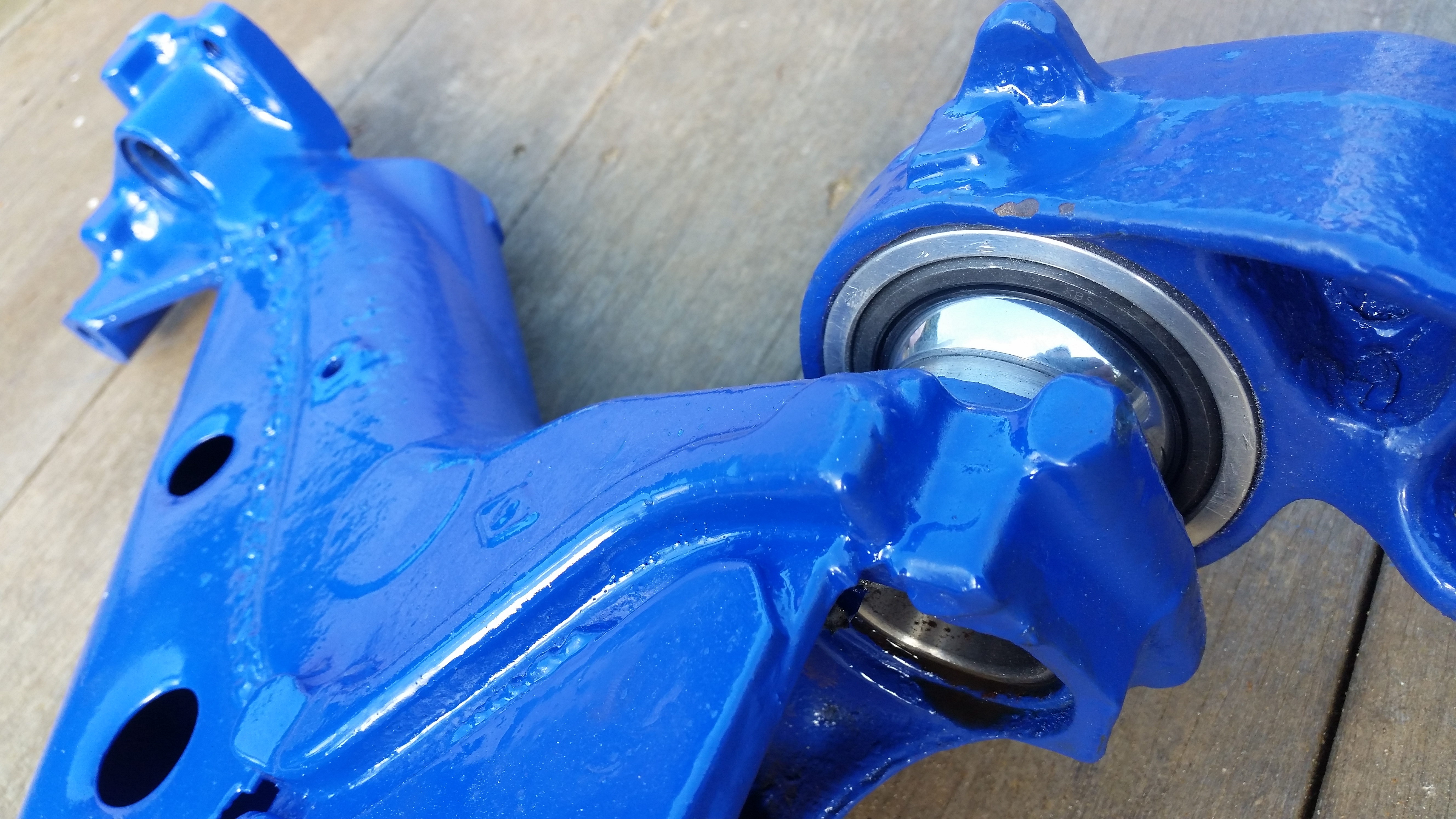

build has been going on so long i started documenting it on a chalk board.. but loads of photos i can dig out.. shell is an ex cup car.. sadly now full of holes so thats the next bit to sort but 2nd engine partly built. low ratio lsd jc5 built and most other parts built more or less from scratch.. if i remember ill dig out some more stuff and post it..

Whats the rear beam from?
standard clio valver/williams rear beam with rose joints fitted, welded stiffening and optional external arb options from the front of an mx5. also 172/182 stubs, shimmable and custom brakes with separate bearings and discs.. cant remember what from and custom calipers to take the wider discs. i actually have 2 as i built a spare..
What are you doing for the extra width on the rear?
part of it comes from the stub axles but the other part comes from a big lump of steel between the stub and rear beam.. it is also often done even on the factory cars with huge spacers that i think bordanova sell. i used to know from memory what the dims were.. its something like 100mm rear track increase and 148mm front.. might even be more than that.. thats over williams dims which are already 12mm or something wider on the front than a valver
