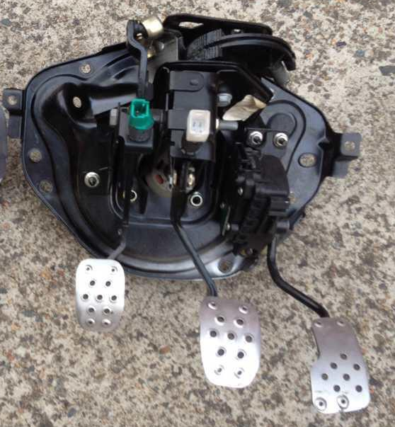

On the PMS website, it says I need a pedal box or a clutch pedal from a clio 2 that has/had a hydraulic clutch.
I was just wondering what the deal was at the pedal end of things. I have a Mk1 clio and I’m not sure if I can get away with fitting a Mk2 hydraulic mech or if I’ll need to go full custom with a pedal box. I really can’t afford the latter but my clutch cable has pulled itself through the fork and the fork mount has actually split,

Am I right in thinking the clio 2 pedal box fits the clio 1? If so then you're laughing mate, @Coops Mk1 you run clio 2 pedal box in your clip 1 don't you?
If they do fit then yeah it's a straight swap. You'll just need to get a hose made up that suits the hydraulic pedal box to the Pure Motorsport kit which will be also nice and easy

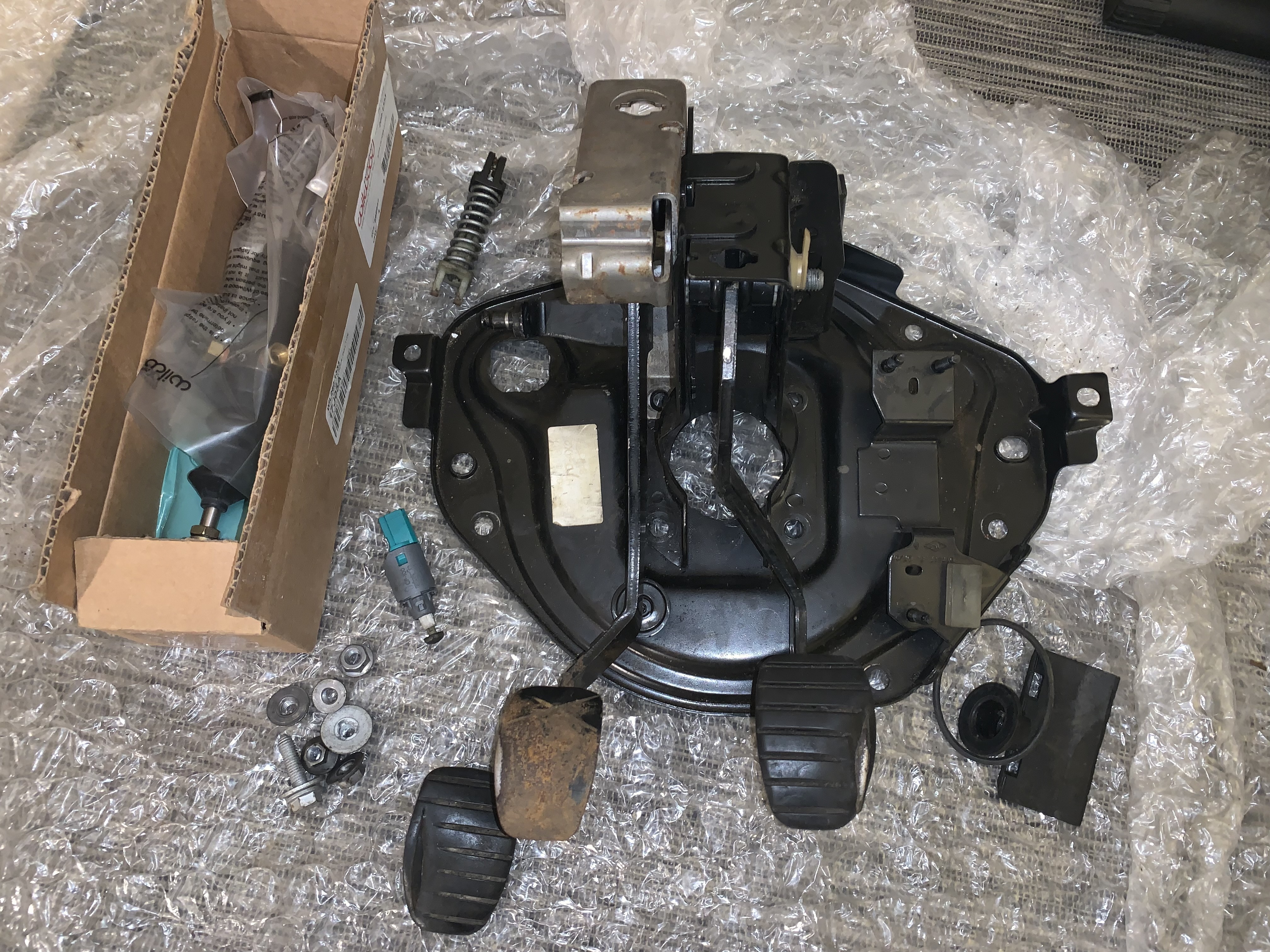

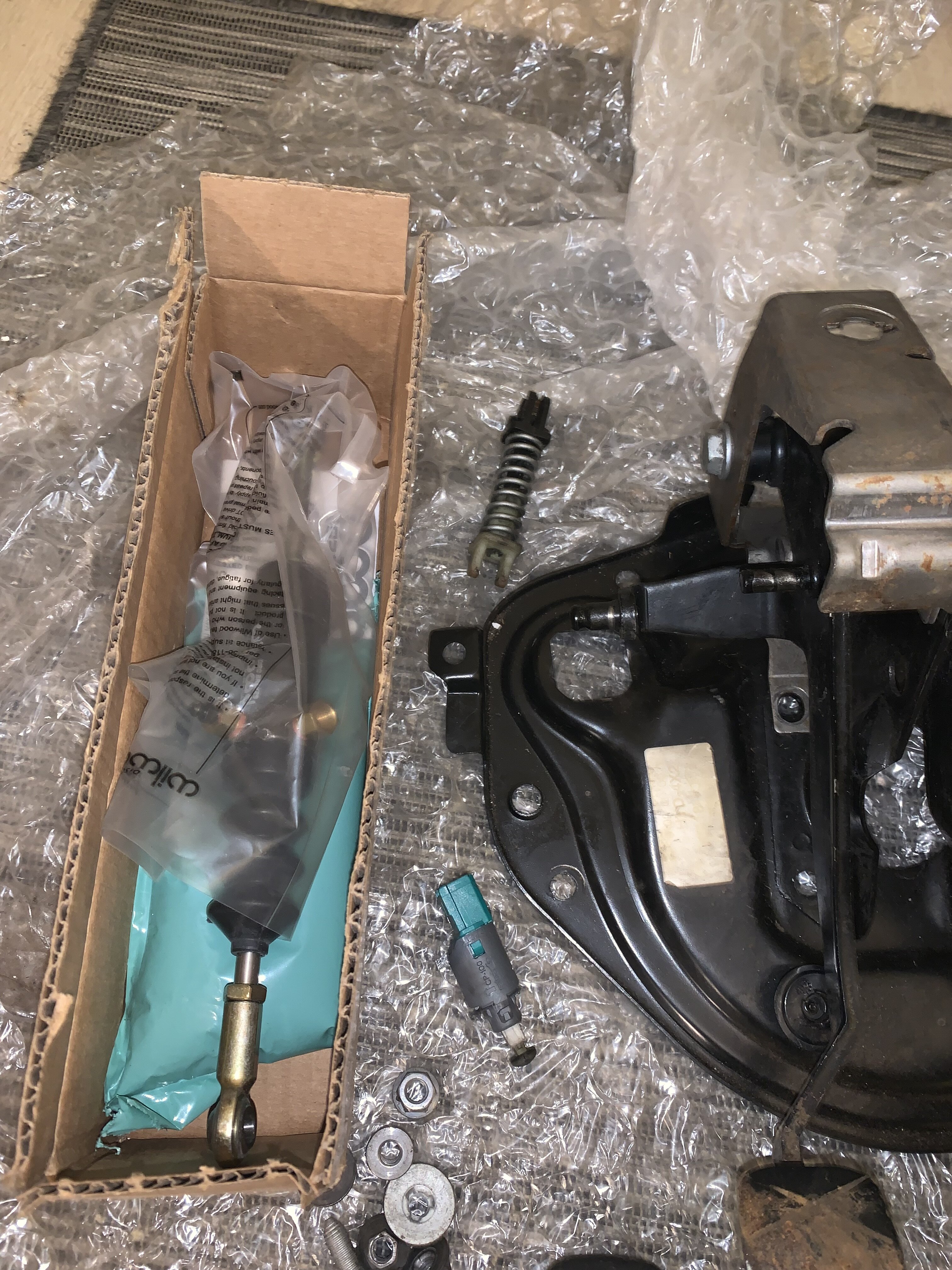

@The Crumb Master my box does have a welded loop though and then a custom brace as well, been fine years, I can try get a pic this week when I am back at the car
Beauvais Motorsport
I’d love you forever if you could post a picture of it so I can see the shape??
I dont have it at home but its the same mounting as the mk2 like this. Im going to my unit tomorrow so can get pictures then. I also have new 280mm brembo caliper brackets for sale if you want them too? 😁

Thanks for the pic, that’s perfect. I’ll get the car out tomorrow and do some guesstimates.
