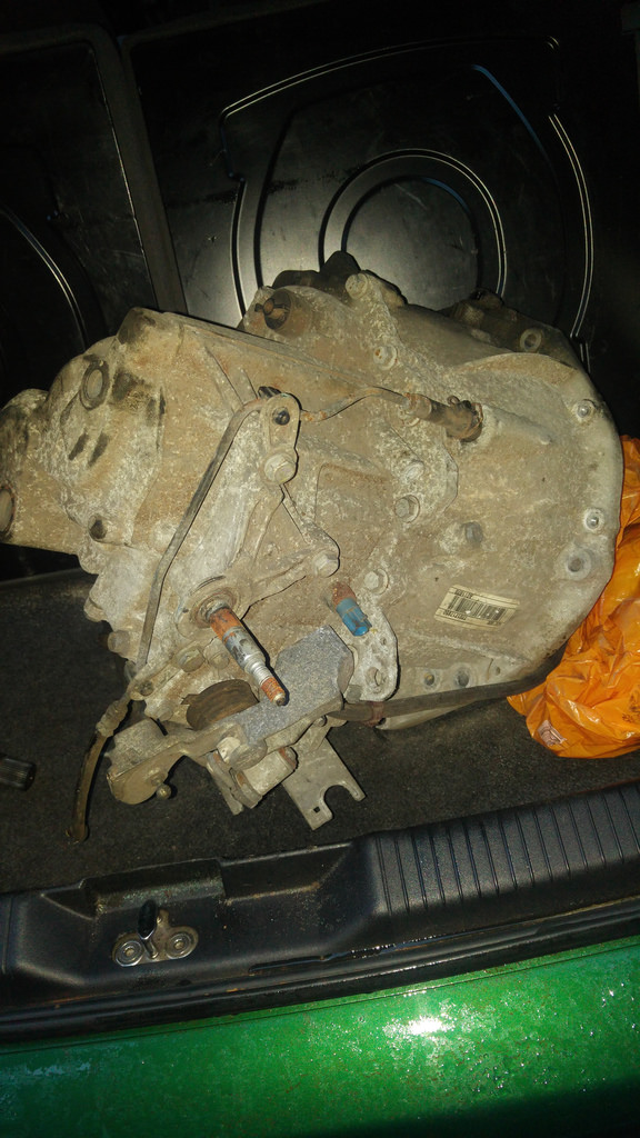

I've picked up the gearbox and painted that last night. Pic is obviously pre painted here haha
20170808_200902 by dann2707, on Flickr

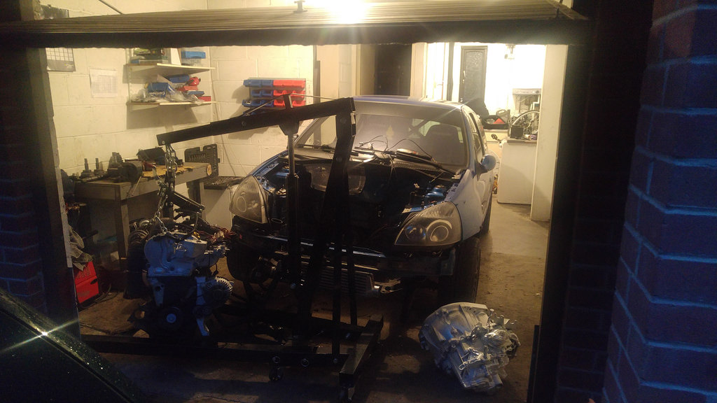

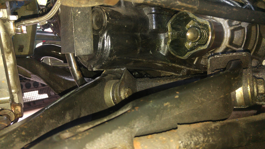

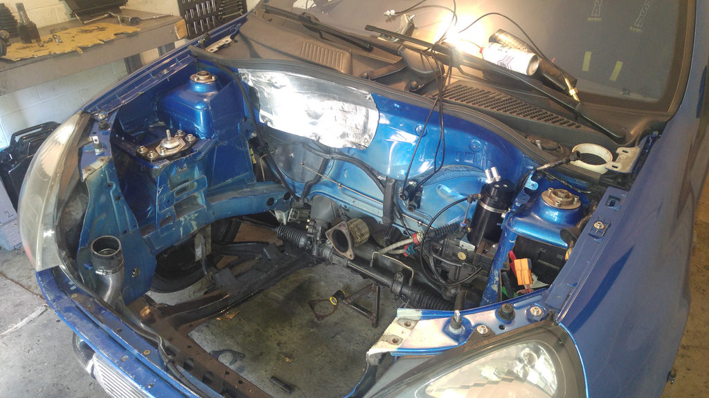

Realised when removing the engine and box that the box end is far too low. Catching on the subframe as you can see here
20170808_125640 by dann2707, on Flickr
20170808_125633 by dann2707, on Flickr

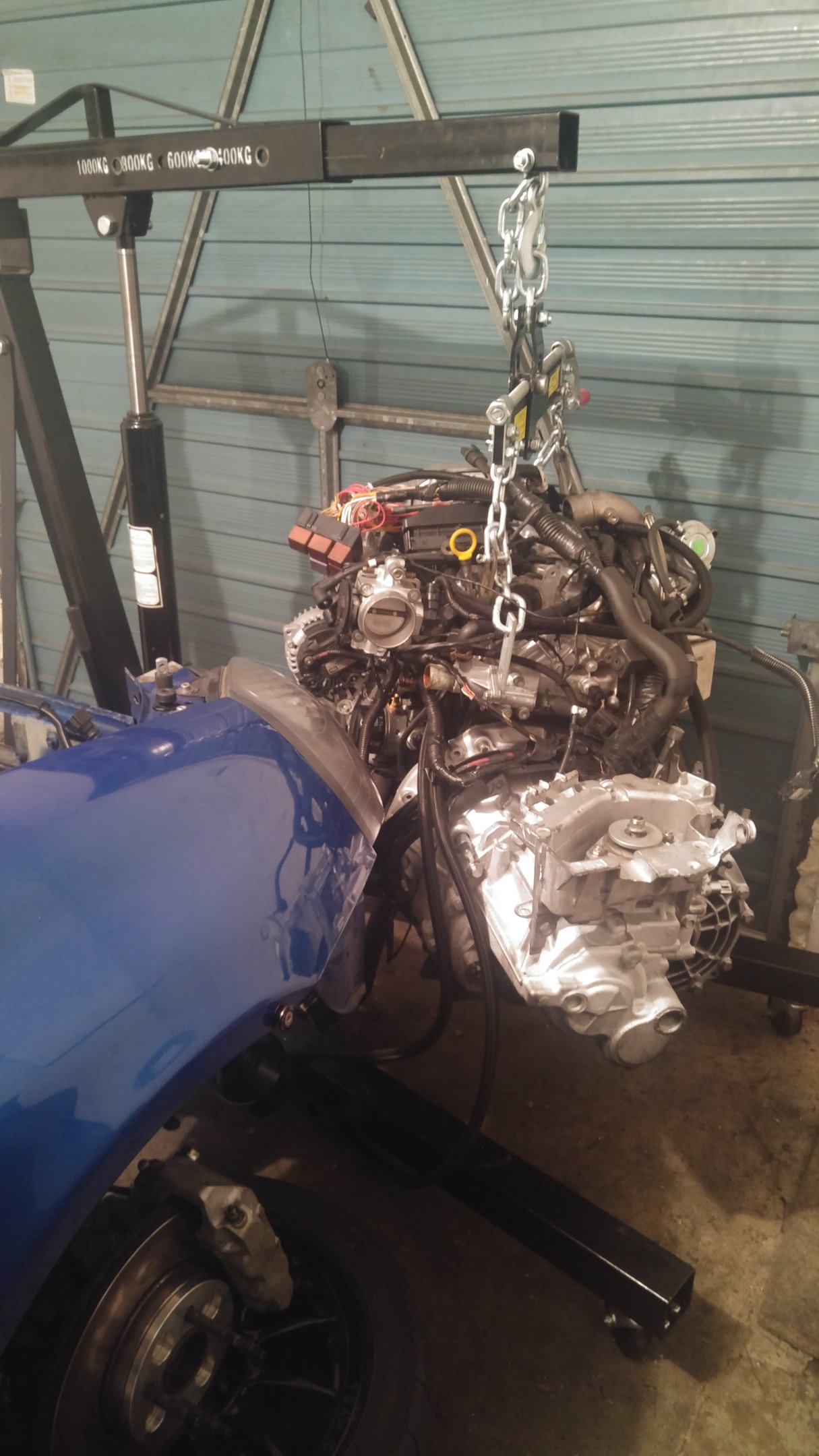

I've now sorted that by the use of some spacers on the gearbox mount.
Engine is out though, didn't take too long at all really.

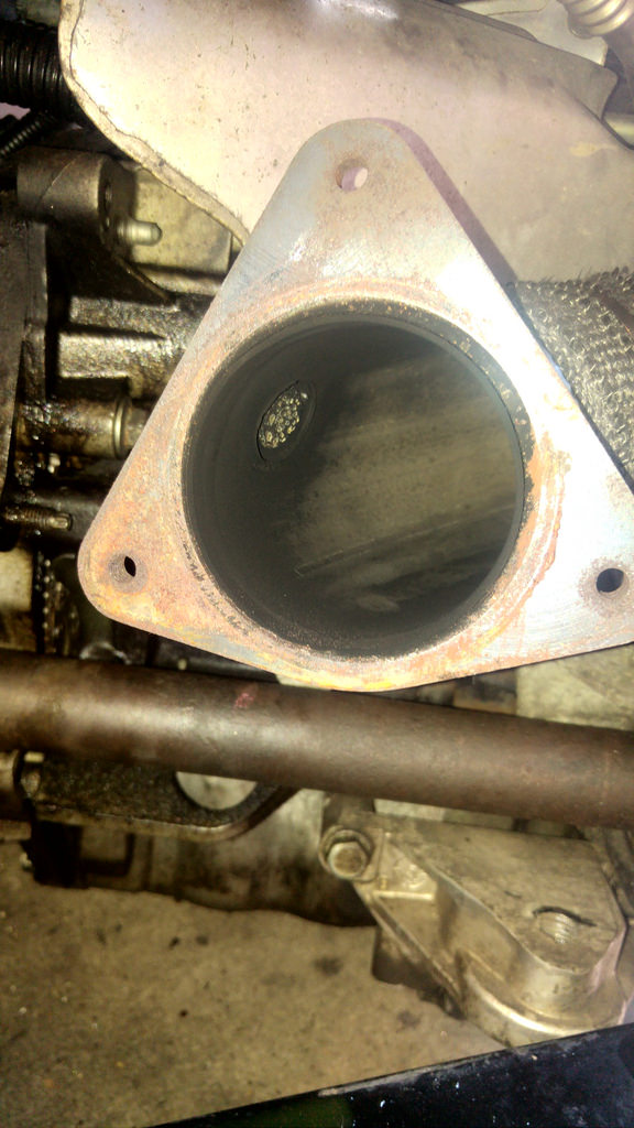

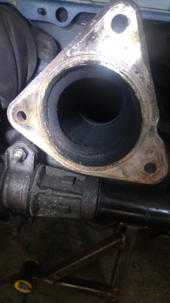

Think i've found my restriction in the exhaust too. This is the link pipe that goes from the 3" decat to the rest of the system - check out the weld. Also just noticed now when uploading pics that the flange ID are different sizes too so that will be restricting it.
20170812_122038 by dann2707, on Flickr
Compare that against the 3" decat pictured here
20170812_122136 by dann2707, on Flickr

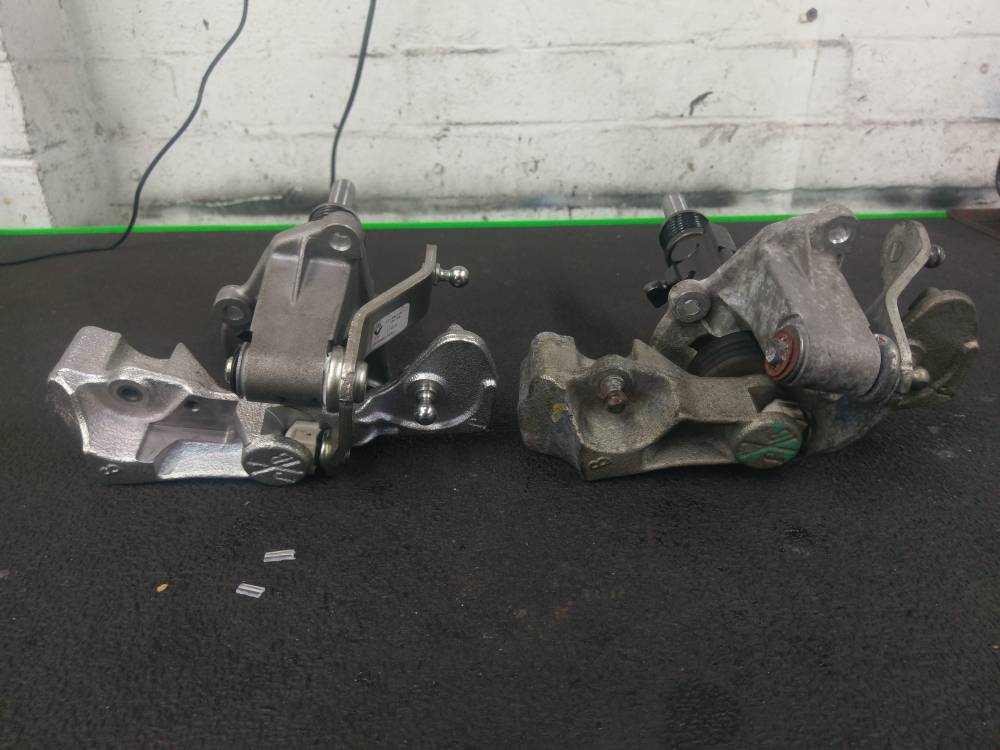

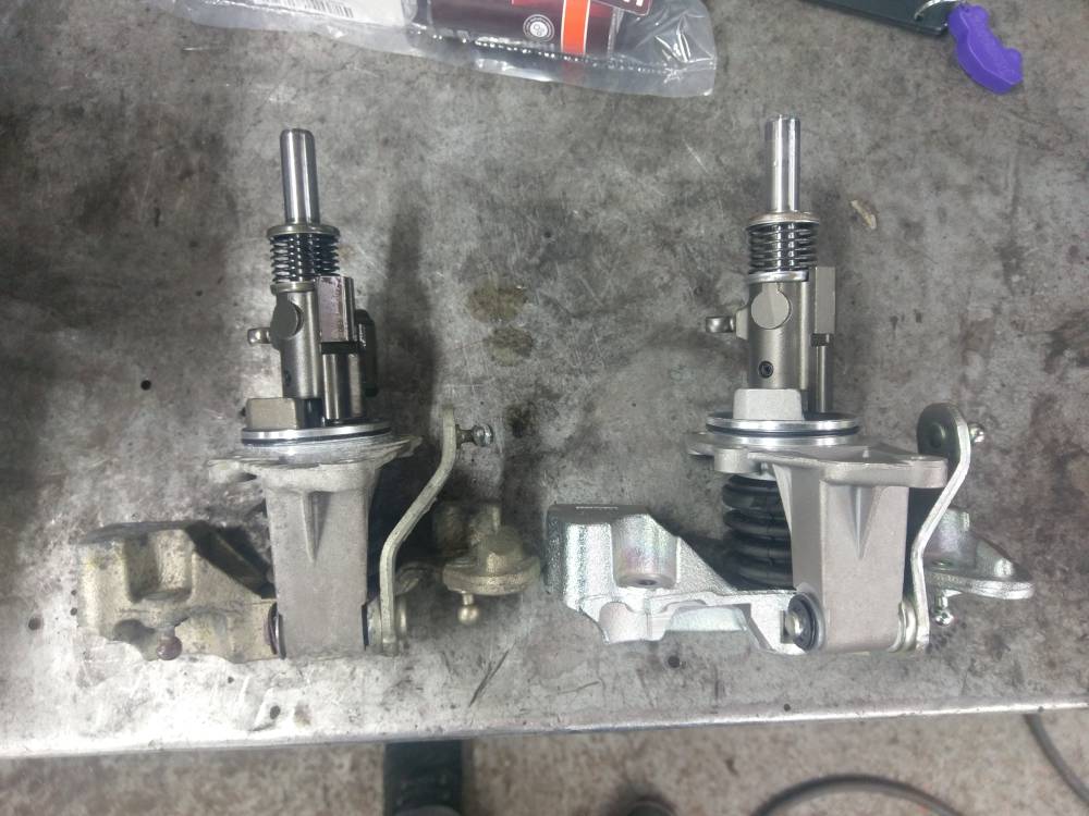

Ph1 short shifter is easy enough to do. Ph2 requires a bit of the shifter machining off.
Thanks mate. Just checked and I have both!
I've already done the phase 1 one, drilled and tapped ready for the 10mm bolt stud which is in the post.
What needs machining on the phase 2 one? I can almost imagine it but can you confirm with a pic please James??

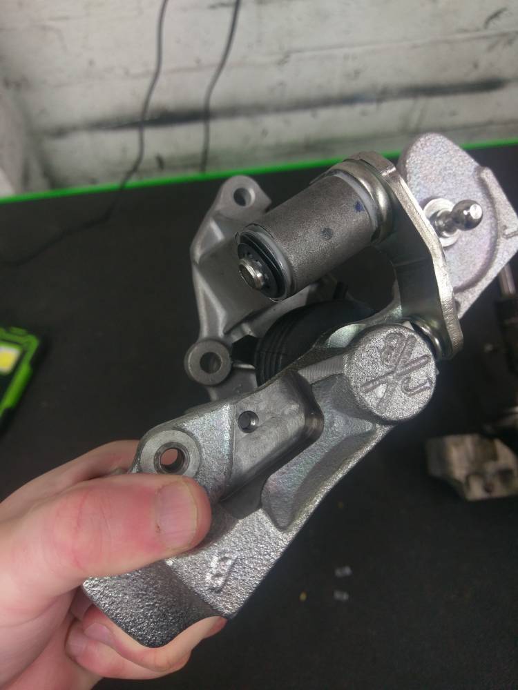

These might show it a little better Dan. There's a section on the left that's machined away to stop the cable from fouling in its new position.
A hole is drilled and then threaded with a ball stud fitted in place.

Thanks for that Rob! That's absolutely perfect. Looks like I can make another one out of the other I have! How much do they sell for usually?

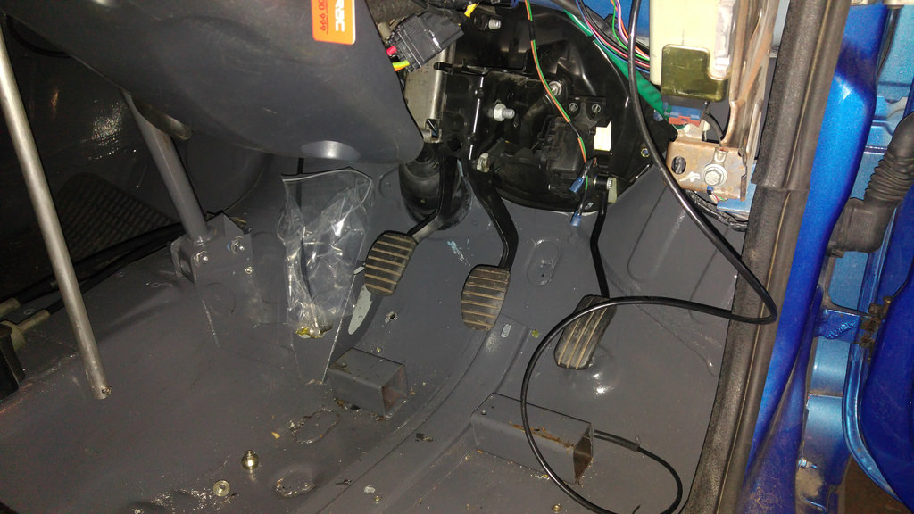

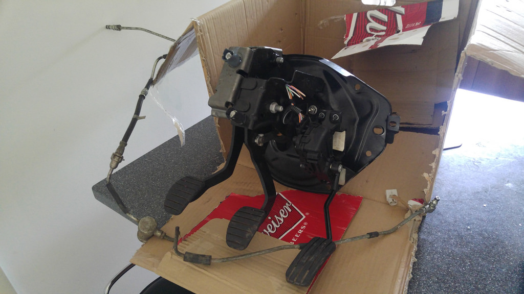

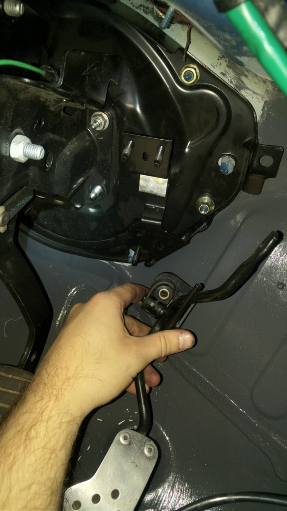

So the pedal box I was picking up from the v6 failed me, the guy who worked at the breakers told me that despite me asking 3 times if the part was available and it was... turns out it was broken. What a dick.
I called back Renparts and asked them for the one they said they had from a dci100, they ring me 10 mins later to tell me that it was broken too.
Started pulling my hair out a bit but luckily I had found something that looked like it would fit... it's from a kangoo but all the other kangoos seemed to be cable clutch apart from this MPV one I found. There was no other information on the internet to suggest it would fit but I found it for £20 delivered so was worth a punt either way. 2 days later it arrived..
20170916_140205 by dann2707, on Flickr
Trial fitted it and it does :D Ignore the accelerator pedal, that will be being replaced with the ph1 172 one when I find out how it bolts to the assembly.
20170916_141344 by dann2707, on Flickr
20170916_142246 by dann2707, on Flickr

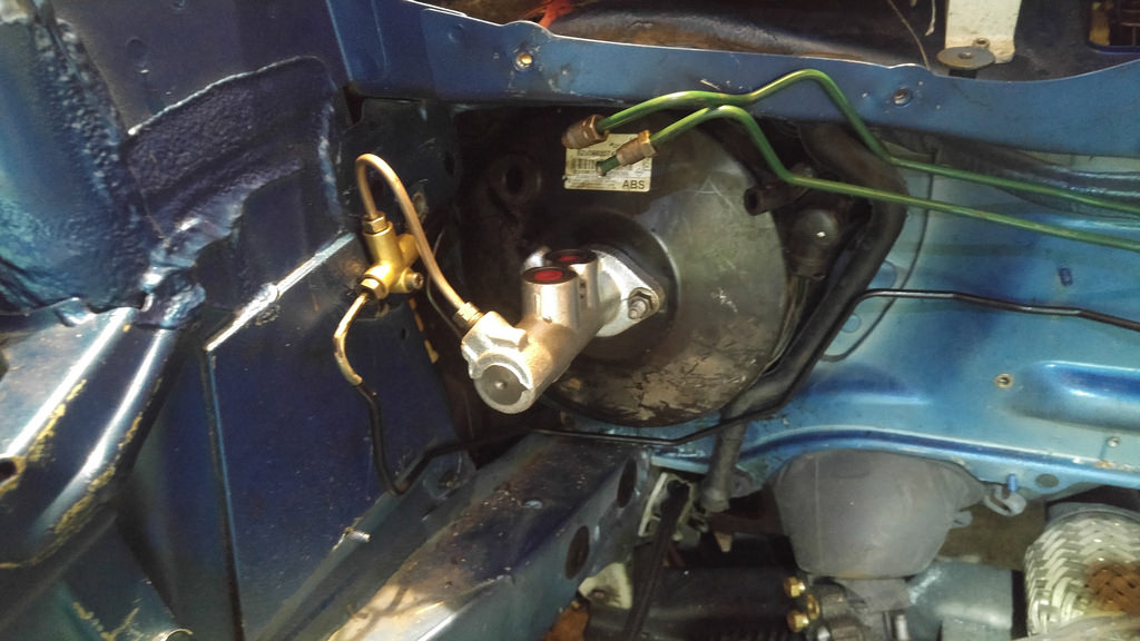

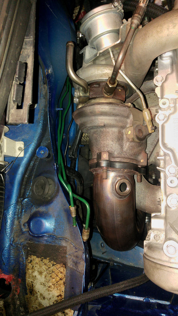

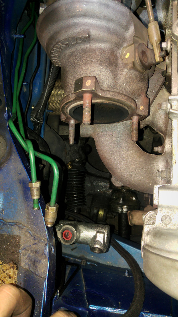

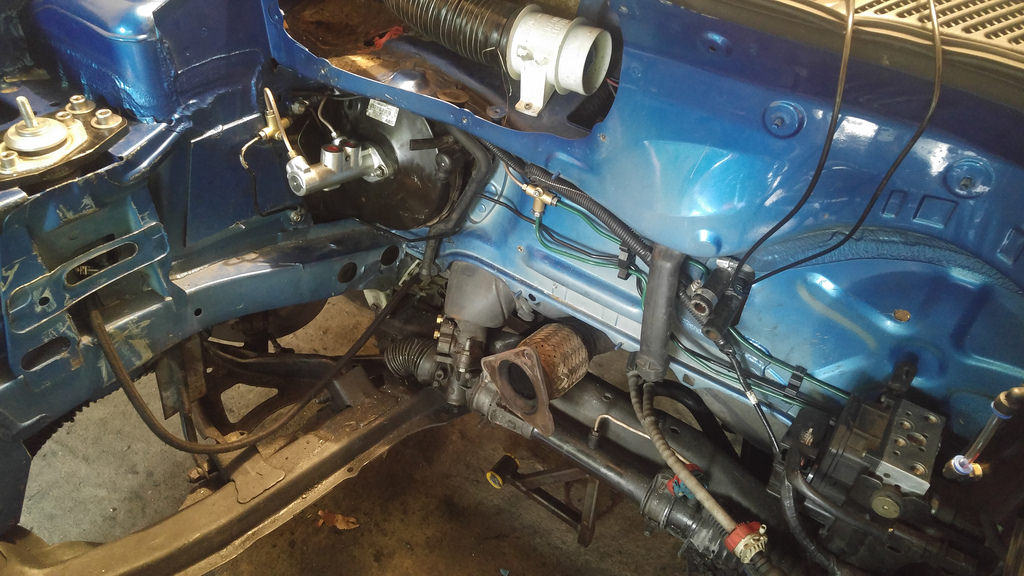

So with the new peugeot 406 v6 master cylinder fitted I wanted to see how close the de-cat is going to be to it. Absolutely no chance it would fit.
20170916_143727 by dann2707, on Flickr
20170916_143834 by dann2707, on Flickr

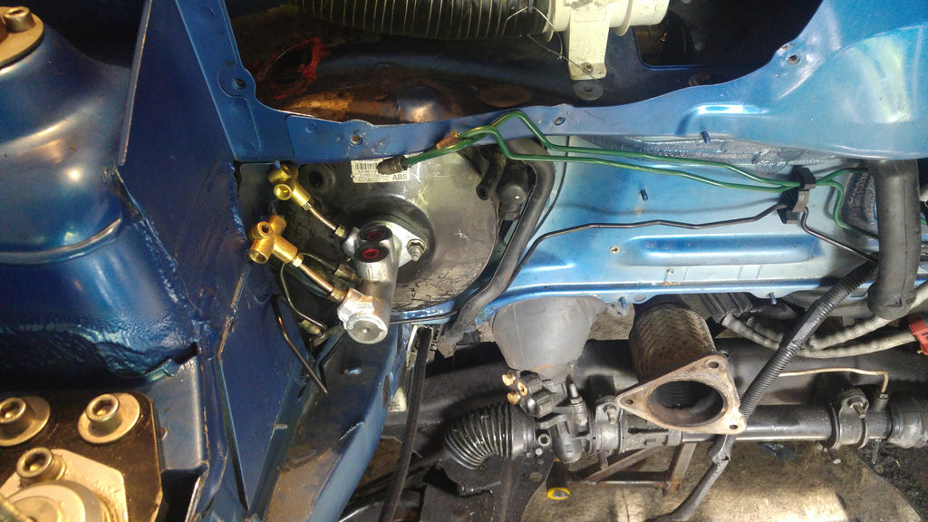

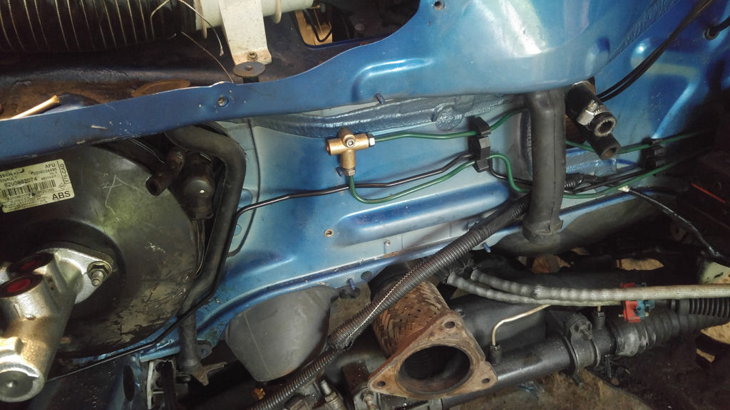

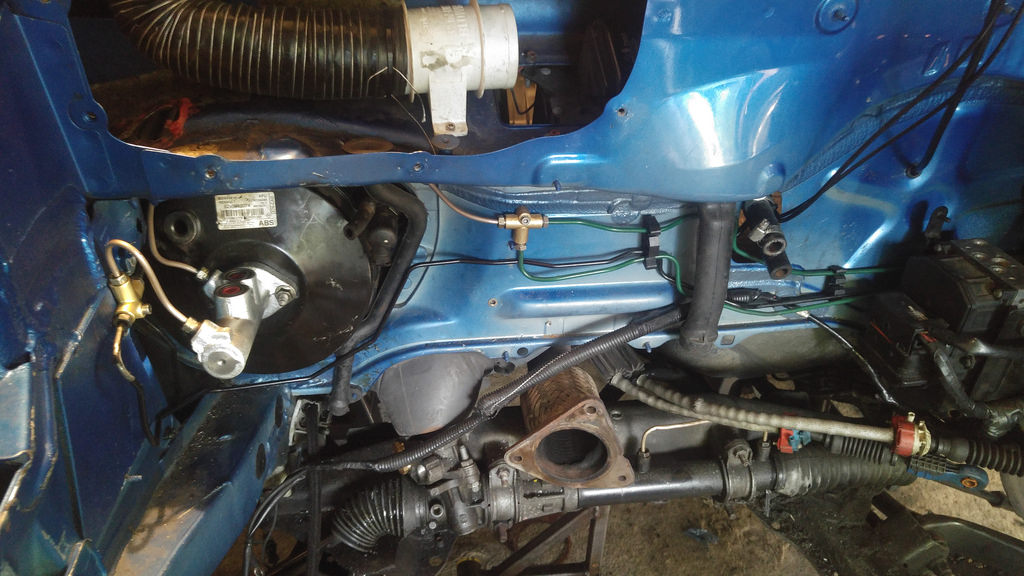

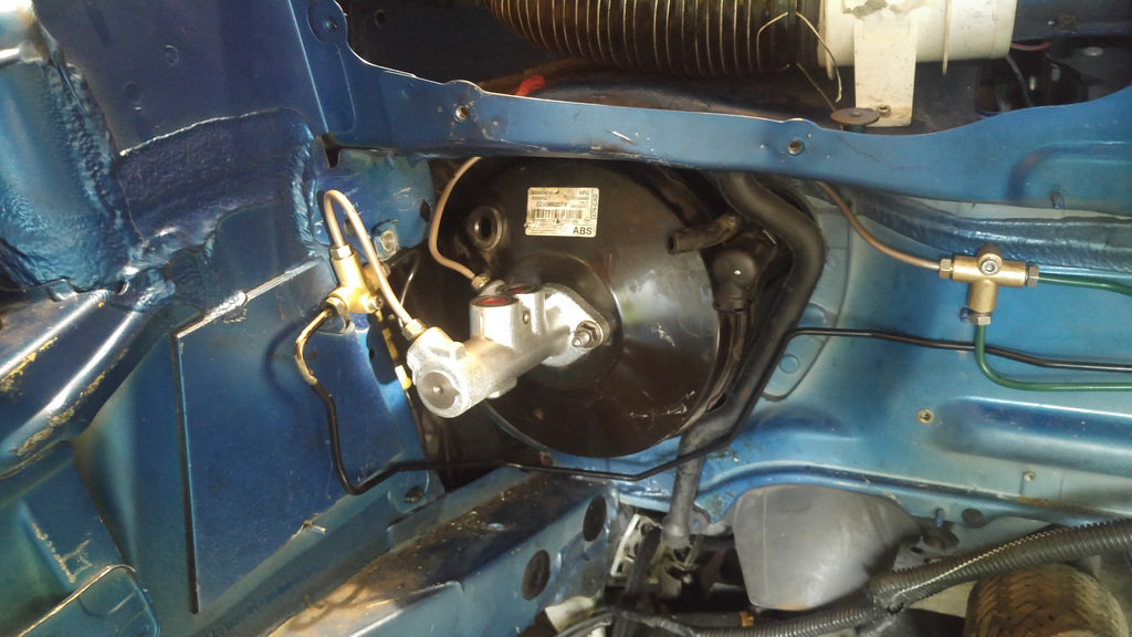

Anyway, the next day, today I started with the custom brake lines to the master cylinder. Due to the ports being on the one side now, I had to create some new brake lines to suit. Using 2 m10 splitters to brake them up into 4 brake lines.
Also removed the engine to do this, did it in under 15 mins as nothing was connected really.
I originally tried it like this but quickly discovered it wasn't that neat and very hard to get to.
20170917_140025 by dann2707, on Flickr
I went for a different approach, I mounted the splitter to the side of the car.
20170917_160901 by dann2707, on Flickr
Then did something similar for the other lines
20170917_165226 by dann2707, on Flickr
Connected that up:
20170917_173752 by dann2707, on Flickr
20170917_173756 by dann2707, on Flickr
20170917_181633 by dann2707, on Flickr
Nice and neat and out of the way, really quite happy with my progress today as i've been feeling a bit hungover but got it all sorted pretty much.
I'm now going to get some motorbike reservoir bottles for the clutch and two ports to the master cylinder and hide them away under the scuttle panel like before. Then fingers crossed i'll have my servo assisted brakes again which will make me happy.
To get around the downpipe issue i'm going to get my mate who's making the exhaust to avoid the master cylinder when shaping the downpipe. I guess i'm mainly waiting on that to be sorted before being able to drive it.
