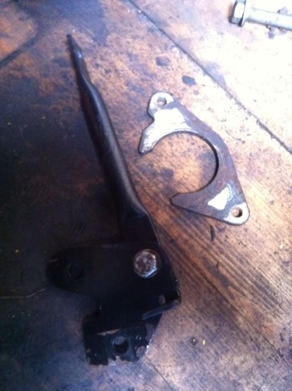

Anyone ID these parts and tell me where they go?
Car  Clio172 / Focus Ti X
I know the black bracket goes on the gearbox somewhere but cant remember for the life of me.
Other part i have no clue.
One is a subframe/chassis tie bar. The other is the retaining bracket for the drivers side driveshaft intermediate bearing.
Hero! Thanks mate
Any idea where the tie bar goes? Behind the gearbox sumwhere? Iv already got the two on infront of the wishbones
the bar goes onto the chasis and connects to the longer wishbone bolt. theres a bolt hole next to the cambelt side of the engine if you look in the wheel arch
Laine is correct, it's the bracket that goes from the bottom of the gearbox, to the dogbone mount
