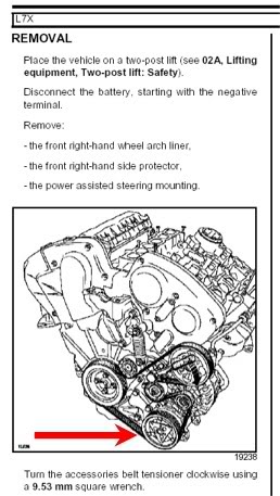

Its ran by the aux belt so will be on the route of that somewhere. Following the pipes will be the best bet if you don't know what an ac compressor looks like. I'll go out on a limb and say it'll be a b*****d to get too on a vee.
Cat its at the bottom mate its an arse to get on when your not on a ramp.
If you do get down to it, you can check the compressor clutch spins freely, by hand, and if your keen see if its getting 12v.
