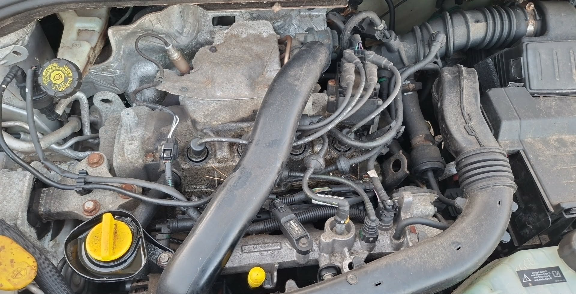

I've looked at a ton of different tutorials and such and for whatever reason my exact engine never seems to come up so figuring this out has been awkward, attached a picture for reference. I think getting the plugs in and out will be easy enough doesn't seem too hard a job but I just can't find a clear answer on what plugs I'll even need.

Those are the non turbo plugs, according to the OPs post above with the photo that's a turbo engine.
Just stick your reg into autodoc and order a set of NGKs, the turbo uses a specific plug and they don't run properly on the NA plugs

Only just noticed the picture in the original post.
You can see your turbo at the back of the engine and the black pipe going across the engine leading to it.
