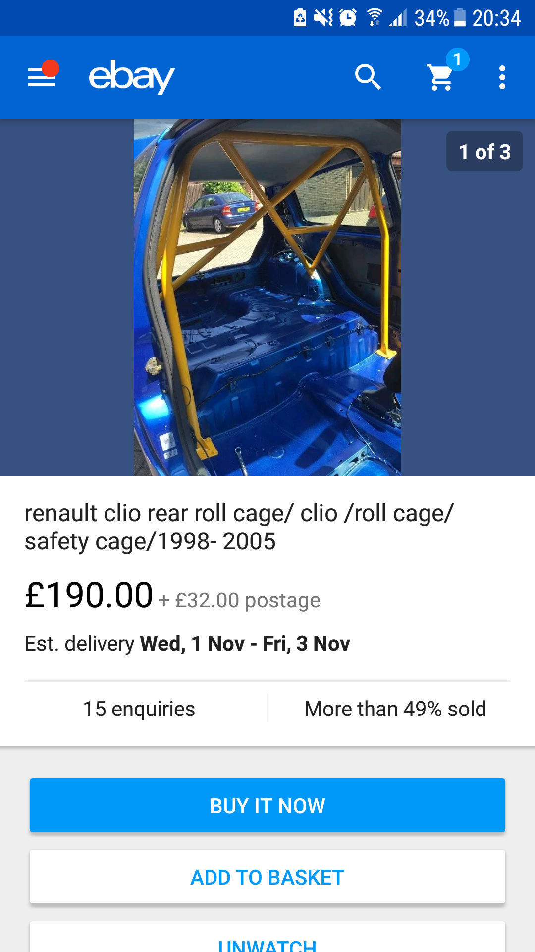

Anyone used alachi for cage?
Car  Clio 182
Plenty of threads and posts on ebay cages, but in 99.9% of the time you'll be fine, it's just that big shunt or awkward roll where you may come unstuck or to put it bluntly impaled by the cage due to its materials and construction.
For the sake of a few hundred quid buy a proper one.
There made from non CDS tube, so they won’t pass scrutineering. They are made using seamed tube, which is weaker than seamless (CDS) tube.
I have the aforementioned cage and it’s fine, fits well. I occasionally do trackdays. If the car got a more serious track toy then I’d upgrade to a better cage.
