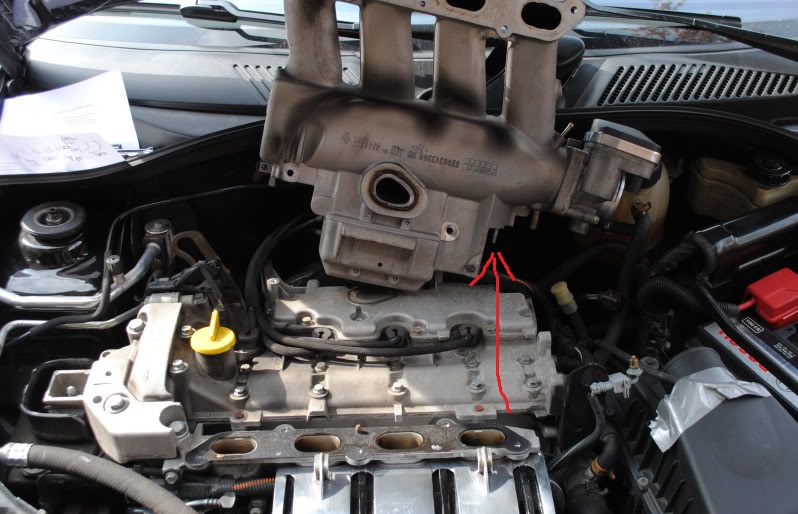

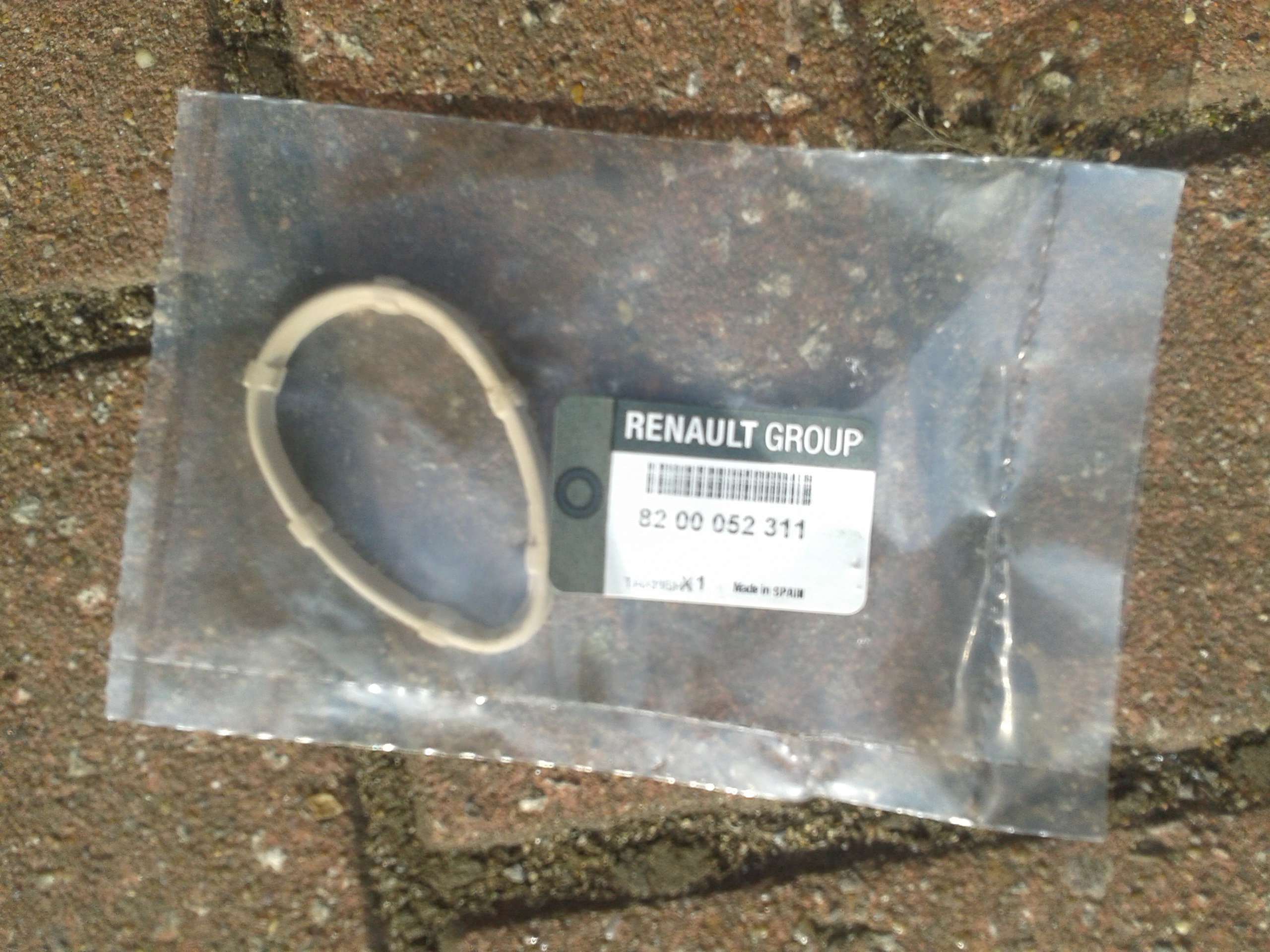

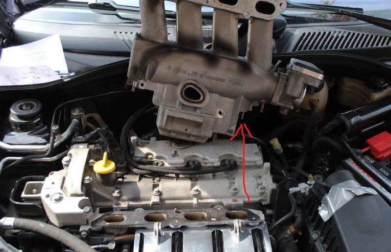

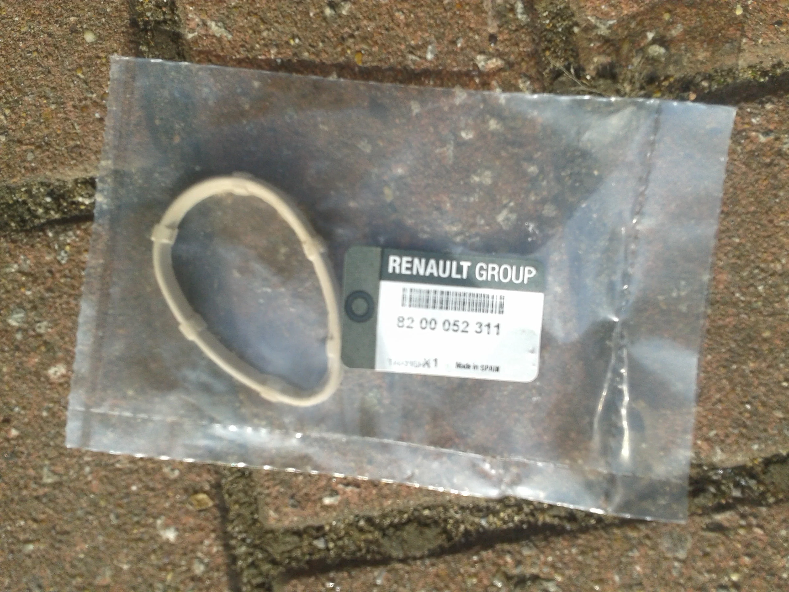

Relatively, did replace the gasket. Whats the best way to check for a leak?
Did you replace the egg shaped "O" ring at the same time?

Definitely not, no. Is that at the throttle body?
No, between the top and bottom inlets
If you changed the gasket, it may have fallen out.
By the way, is there an orange light with a squiggly line illuminated in the centre of the instrument assembly?
