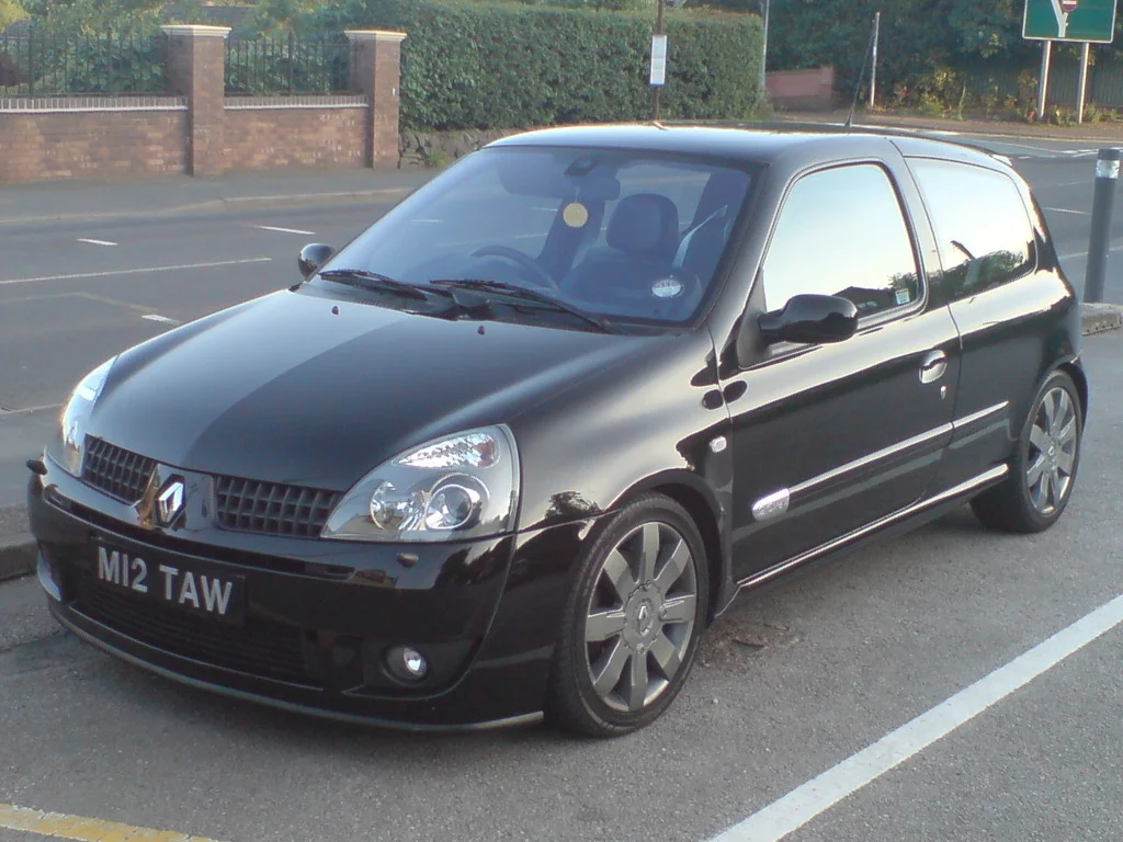

I have a set, and had them fitted to my old Clio for months without a problem from the police, but they attracted far too much attention of the wrong kind! :dapprove:
Personally, I wouldn't go back there, lol!
  WR1 impreza
I love the look of them on my car, illegal or not. They are velcroed on anyway so can be removed.
