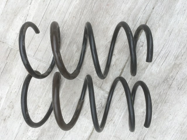

Got a set of front springs here sold to me as Cup springs, and trying to work out if they are actually Cup items. I suspect they are not as I have seen photos of Cup springs showing five full winds whereas these have four.

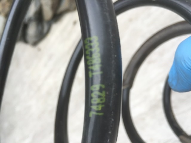

No paint markings on the springs, but they do have numbers printed on one of them: 74829 T486333.

They look like some aftermarket ECP type of springs to me. Genuine cup springs have red and white dots on them.

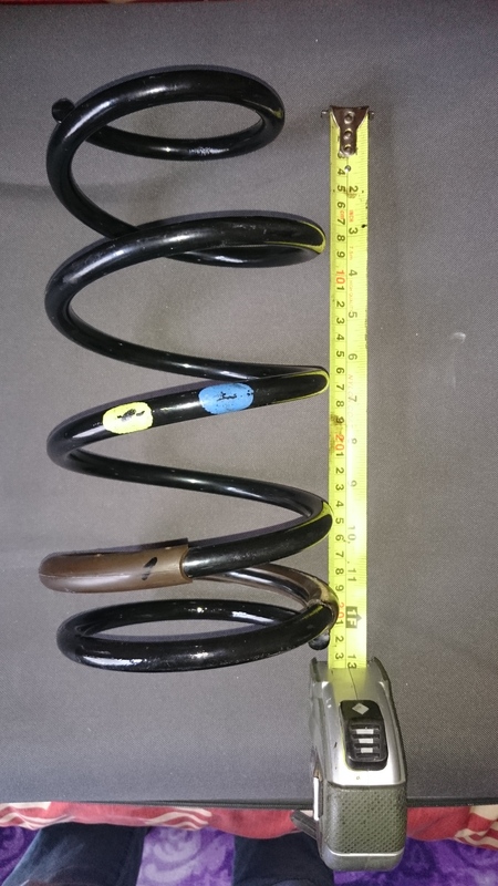

Thanks. Pretty sure that 172 Cup and 182 Cup/FF springs are different. 172 Cup front springs have yellow and white dots while 182 Cuo/FF springs have yellow and blue dots.

It was my understanding the rear Cup springs have red and white dots whereas the fronts have yellow and blue as per this pic
