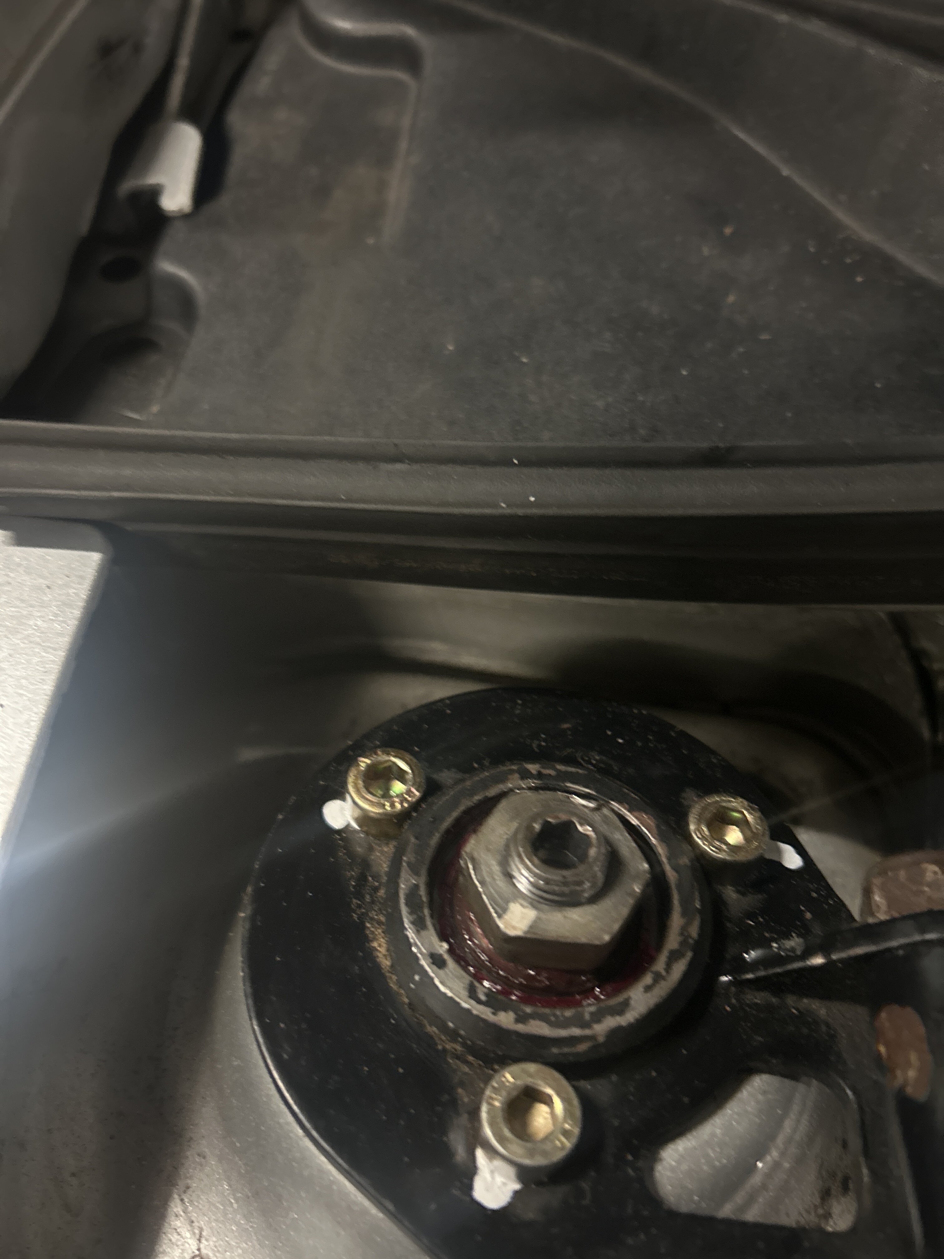

Really not impressed with the b14. It’s like chocolate metal. The 7mm Allen key has rounded off when torquing it to spec. Adjusting them is nearly impossible. Honestly it might drive good but so far I’m not impressed at all
Aluminium lol?
What 7mm allen key?

The shock allen key top rounds off on all shocks. Best off giving it a couple of ugga duggas with the gun to tighten from experience.
