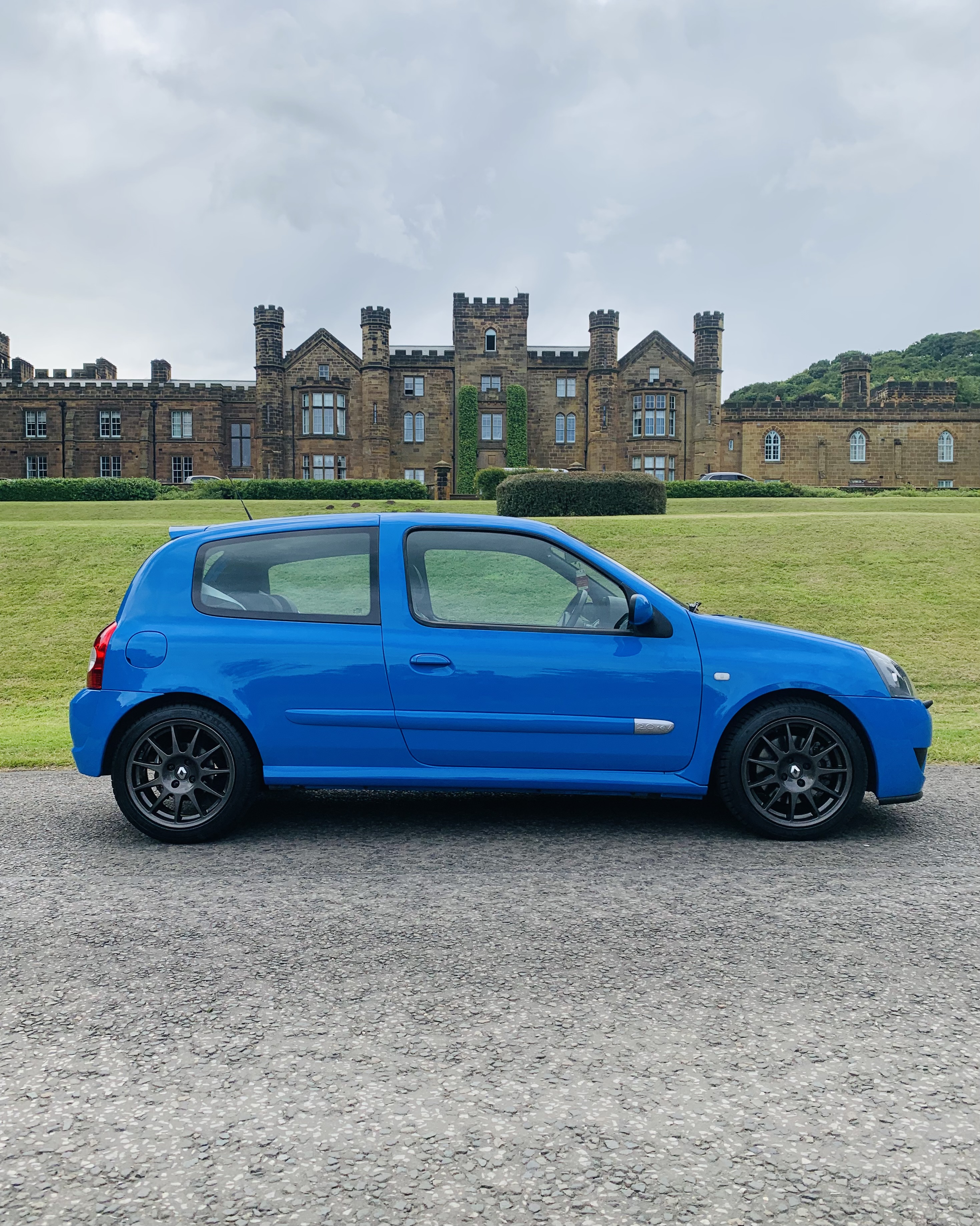

The Eibach Pro-Kit springs are about as close as you can get to factory Cup springs. They maintain the original ride height and offer subtle changes in ride and handling, making the difference hard to notice. I installed them on my 182 after being unable to find a set of factory springs in good condition.
Ride height. Factory dampers, 16” Turinis and Eibach Pro_Kit. As I said above, it rides lovely.
