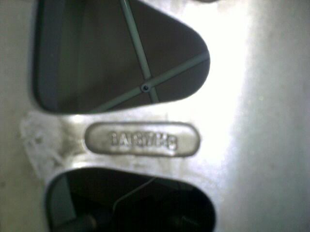

Are these Speedline Corse 2020 in Magnesium?
Edd
  Ghibli/Boxster/197T
Stamped on the inside with a part number which ends in MG.
4x100 ET37, so clio fitment? Will just need spigot rings I think?

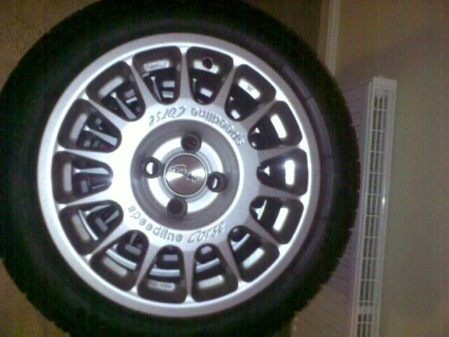

2118
2020
Am I right with these images? Mine are 2118's?
  BMW M4; S1000 RR
Look like 2118s to me.
If they're light, they'll be the Mags. If they're not (i.e. can't tell the difference between that and a normal Clio wheel) it'll be the normal cast ones.

They didn't seem that light, probably the same as a 15 inch OZ F1.
try weighing one and seeing if you can look up how much a MG rim should weigh. 195/50/15 tyres weigh about 5kg

They are 2118's cast aluminium. Mg is part of the Aluminium code they use.

i emailed speedline, they said they were cast aluminium 2118.
