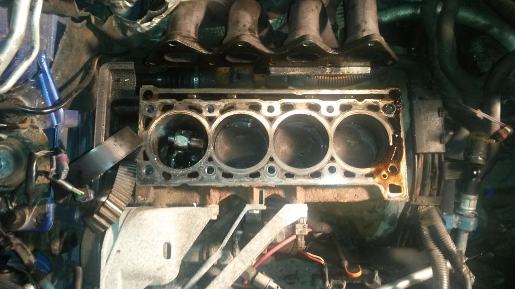

Whipped the rocker off last night expecting to find a mess of rockers and tappets, but nothing. After all that it must have been the bottom end :(. So have to rip it all out now. Also found bits of metal in the inlet so something must have got sucked up the breathers so could well be more damage on the under side of the head. :( :( :( :banghead:

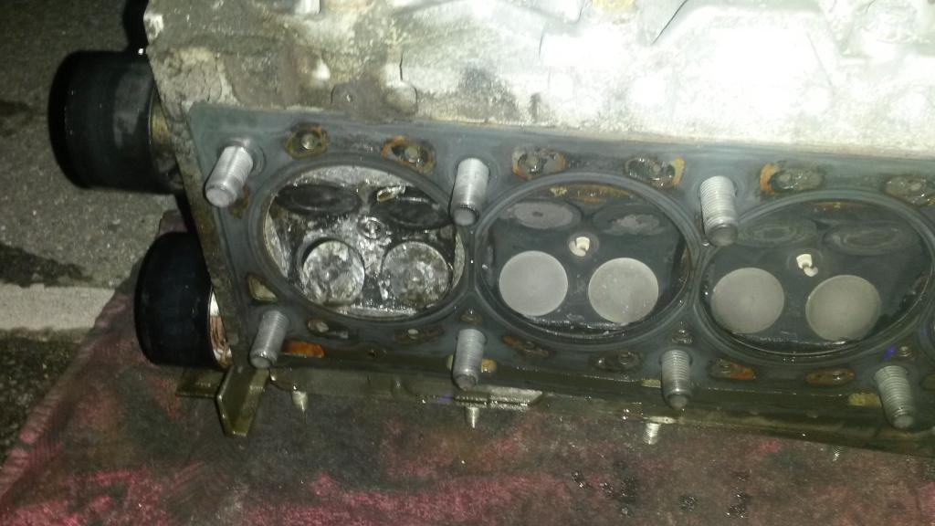

Oh dear.... wasn't expecting that much mess..... opps

what at causes a dropped valve any reason or something that just happens out of interest?
