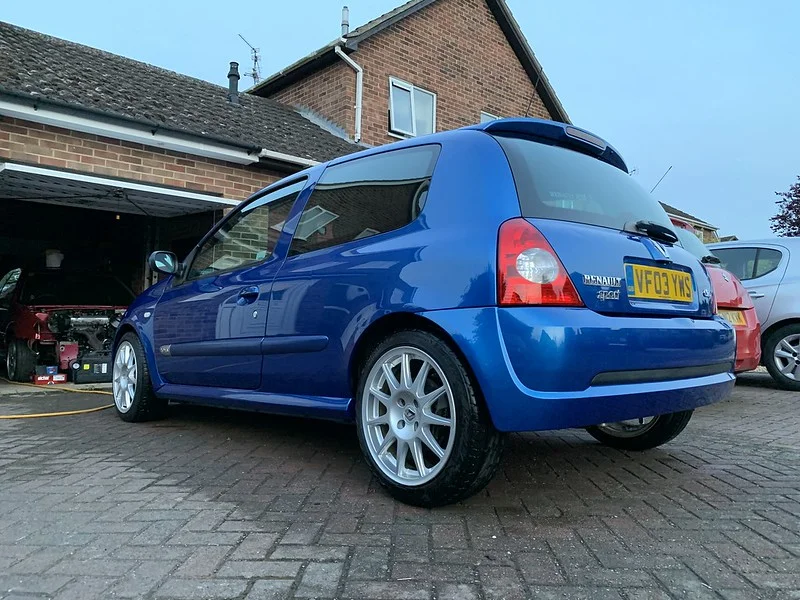

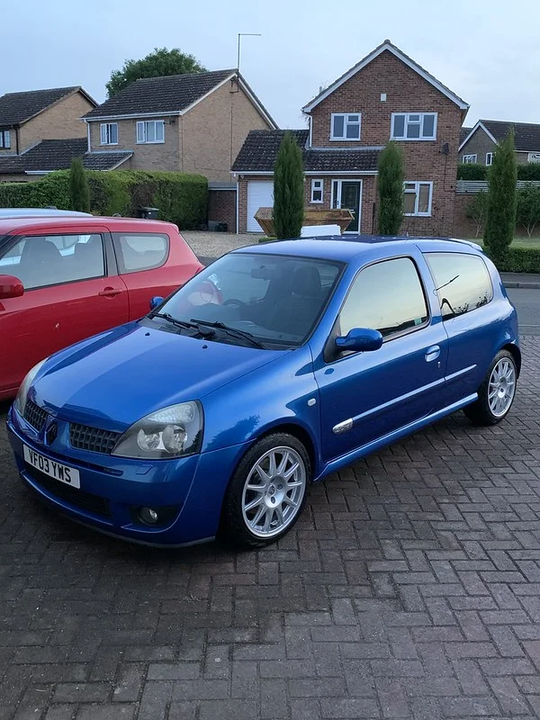

Ash's 172 cup
Why did you decide to remove the front spacers? has the rear got stub axle spacers? Looks a nice Cup, enjoy it.
wondering that myself. doesnt look like its got rear stub axles spacers. they sit much nicer on them front and back, recently fitted both to mine and looks so much better and didnt notice any difference to the drive. looks a nice example though.
Il be honest, I wanted to see how it felt/handled with and without front spacers.

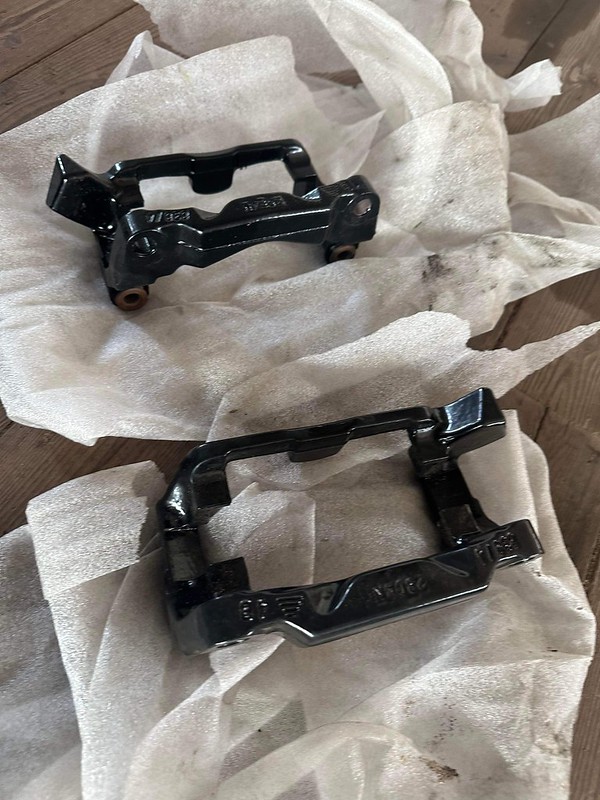

On Monday I had a check round the front brakes, a nice little surprise was awaiting me, both front lower Carrier sliders seized solid (one snapped).
So no test drive :(, I have a new pair of carriers freshly powder coated inc new bigred slider kit arriving Friday.
Sorted the brakes over the weekend,

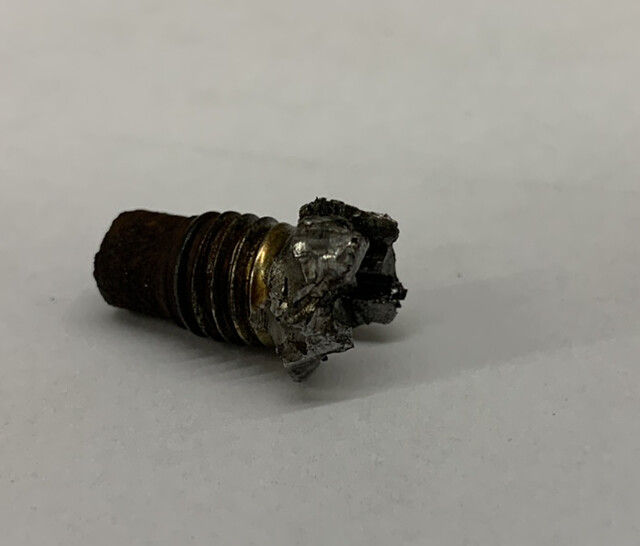

Fitted both front reman caliper carriers & slider pins kit. Had great fun with the disc retaining screws, all four extremely tight.
One of the 4 screw's this being the worst, the other 3 came off with tones of persuasion.

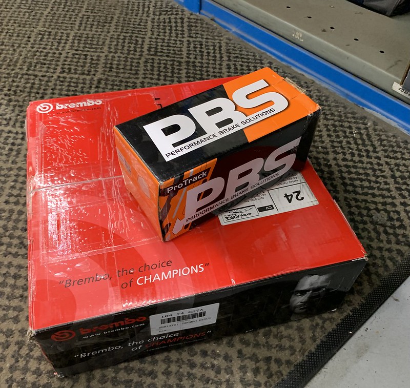

PBS Protrack pads & Brembo HC discs came Friday afternoon.
Untitled by Ashley Hanson, on Flickr
Im not looking at doing a track day till after the end of august so, wont be fitting them just yet, the Oem discs & pads on at the moment have plenty of life left.

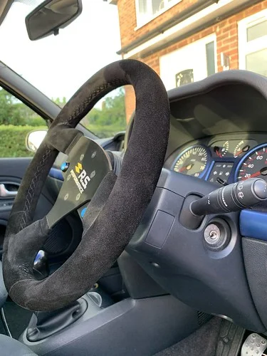

Managed to grab a RS Sabelt steering wheel and sell the RS performance one pretty quickly, definitely feels nicer to grip, I will give the interior a good detail soon as this great weather improves.
Even with the two SRS resistors fitted the SERV/Air bag light illuminate so I will try bending the contacts on the themselves to make a better connection.

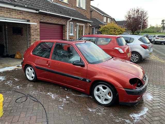

I have to juggle getting the Clio ready & giving my Vts attention, below a pic of the old girl.
She's not in the worst state but needs a fair bit of welding & tidying up.

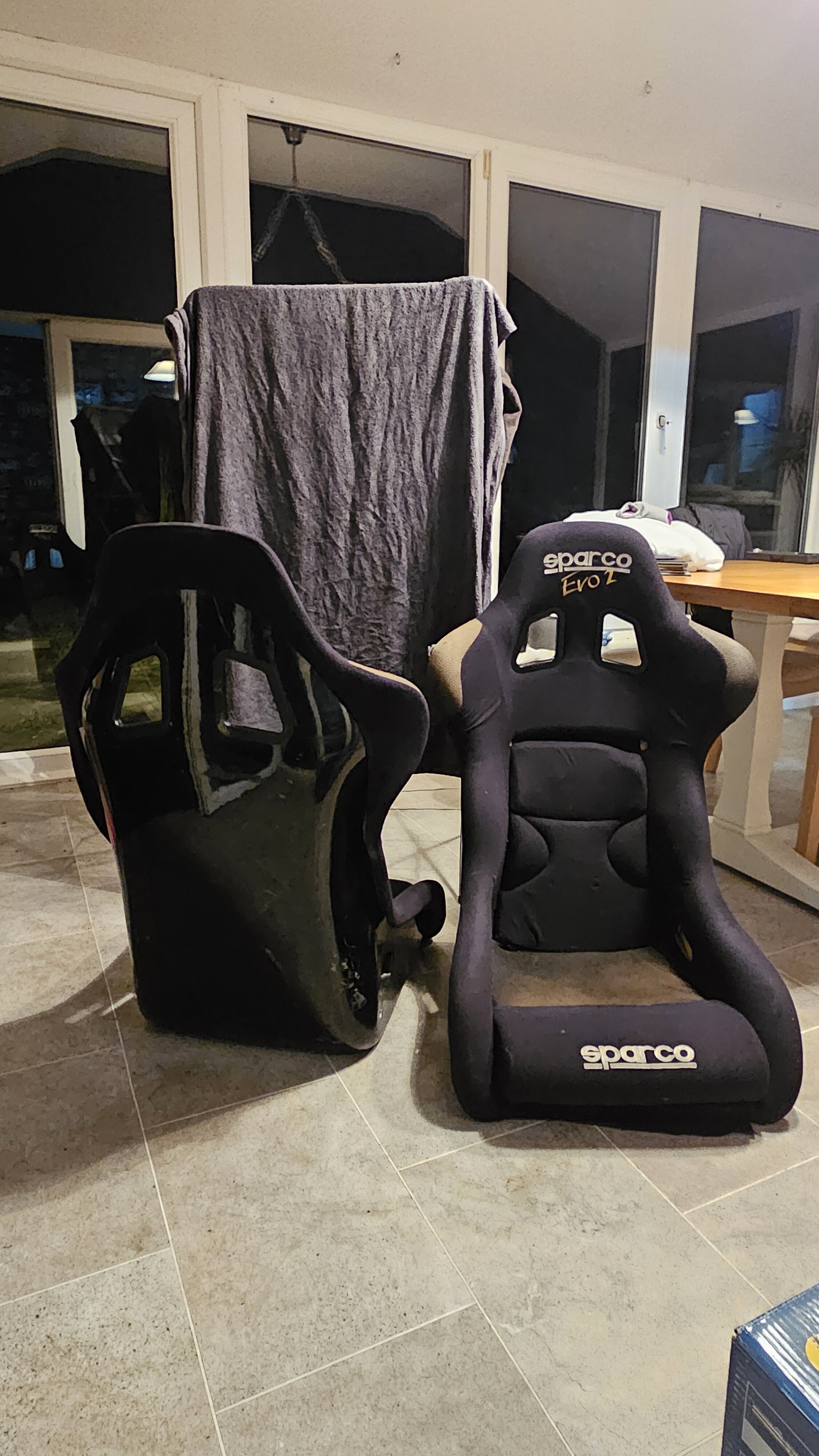

Since my last post, the car has had:
- Bilstein B14 coilovers.
- Non-resonated K-Tec Stealth exhaust.
- Sparco Evo 2 seats.
- Jonfoz XL frames.
- Powerflex camber bolts.
- Pure motorsport Rear stub axle 10mm spacers.
- Rear calipers.

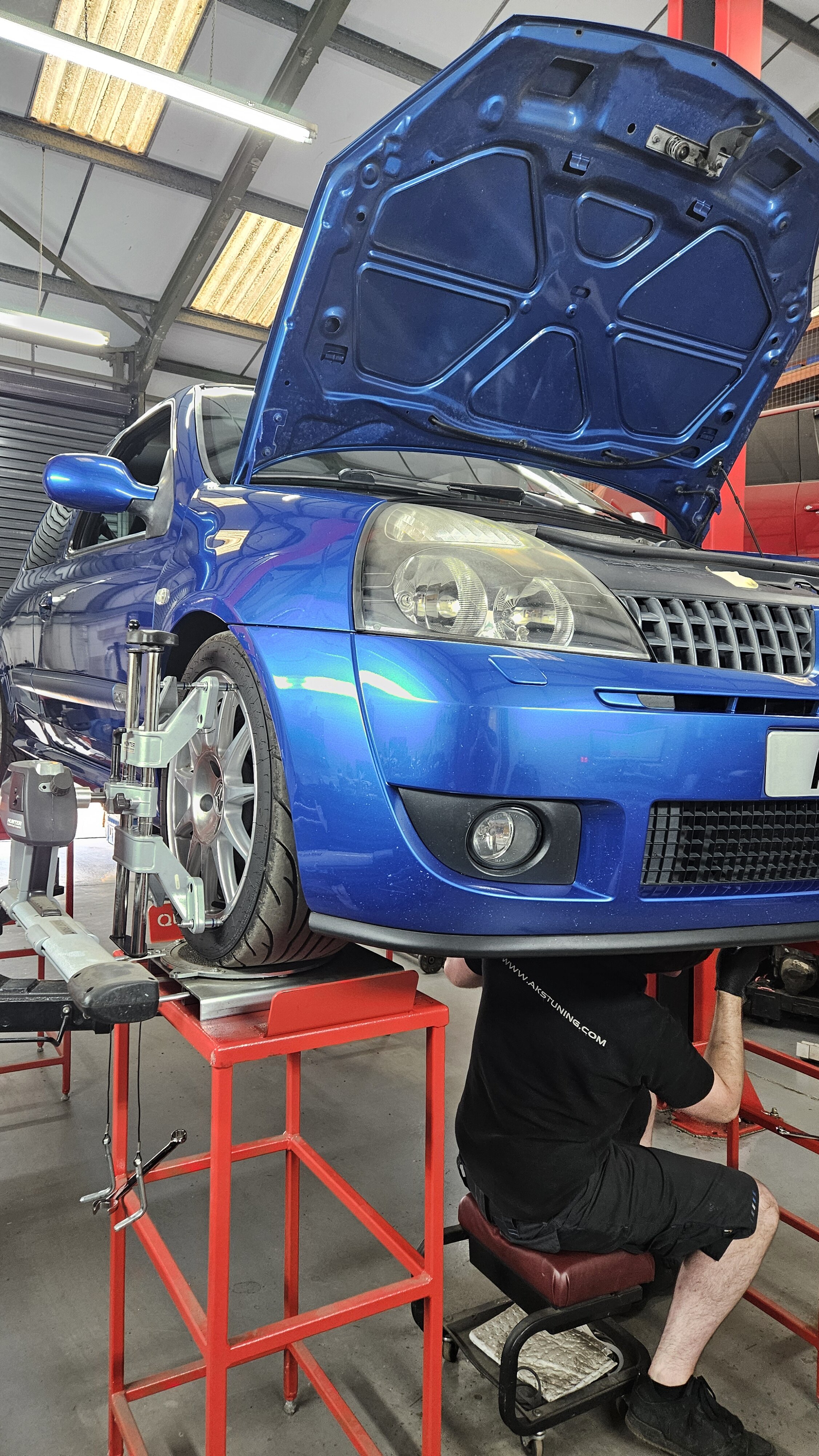

A trip to AKS Tuning Bedford for wheel alignment fast road setup.
After fitting everything lately, it will be interesting to see what changes have been made the next time I go on track.

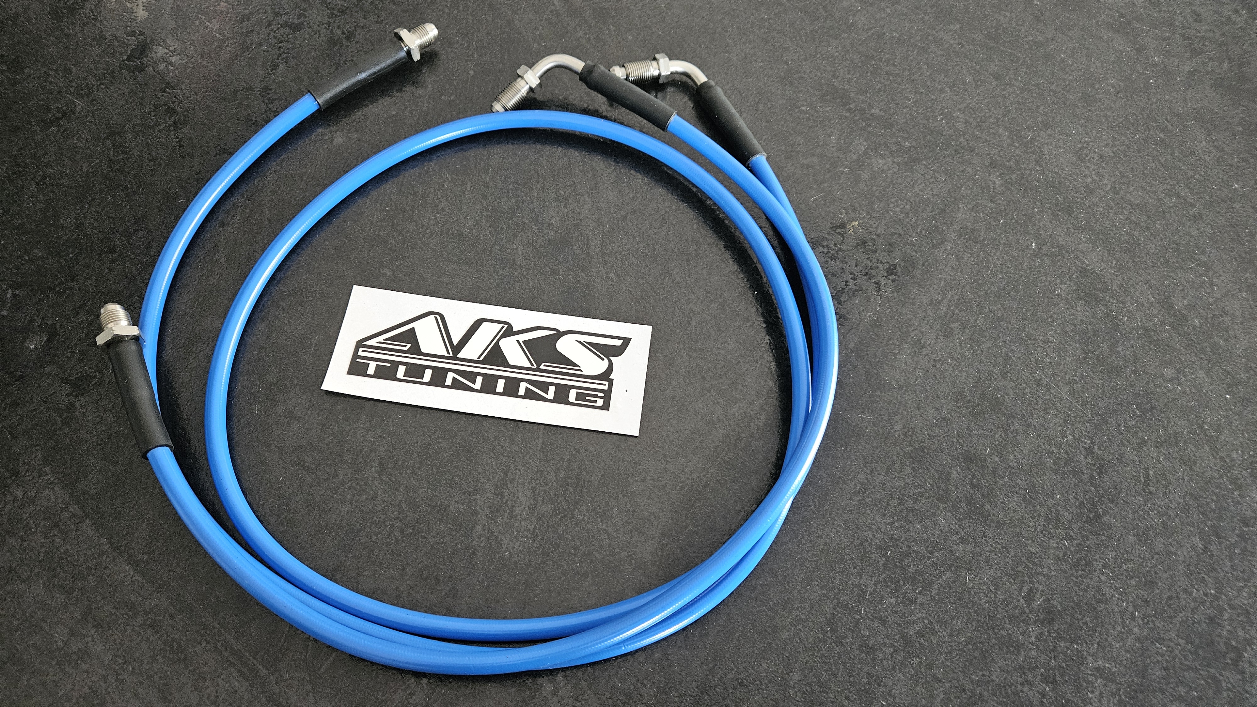

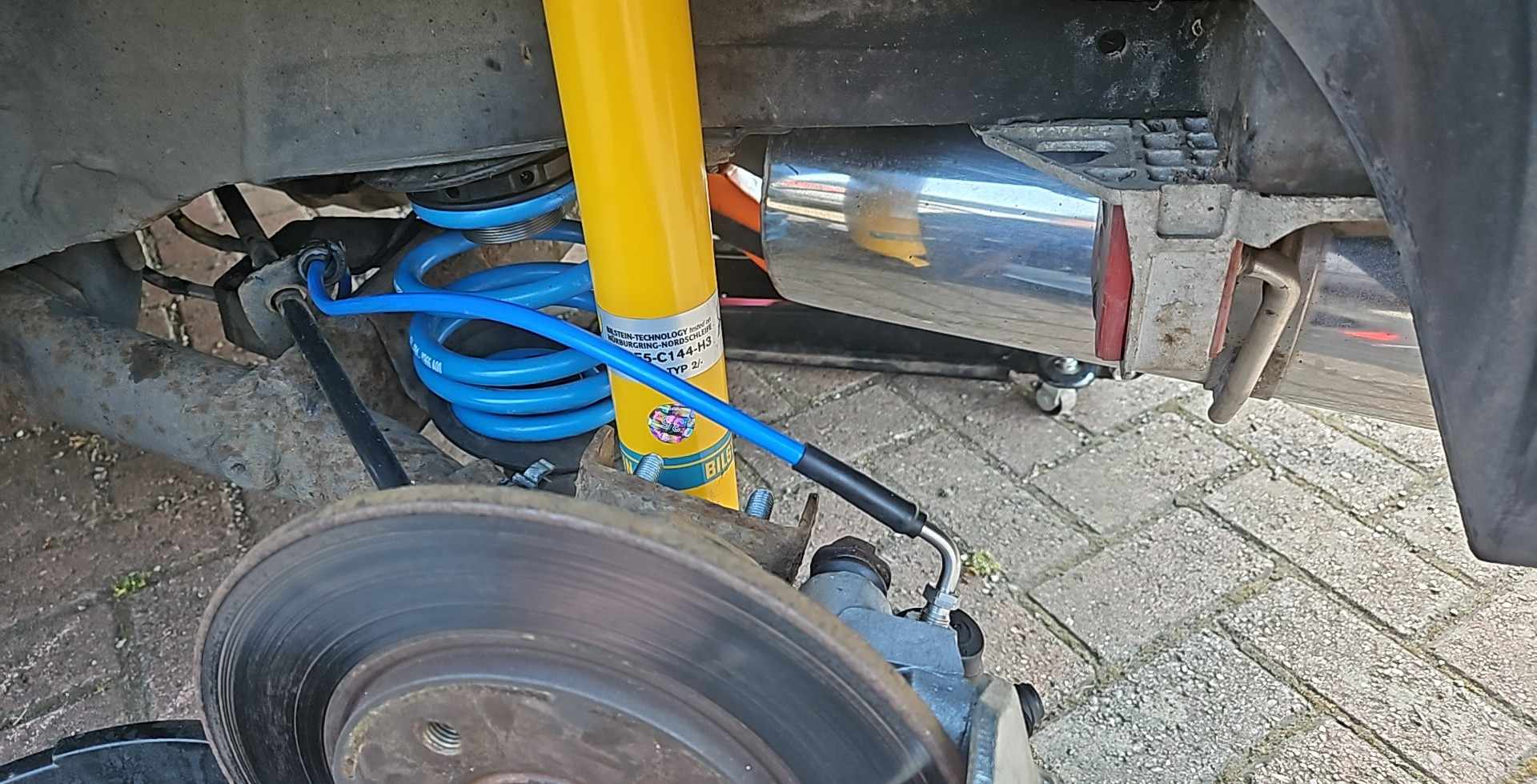

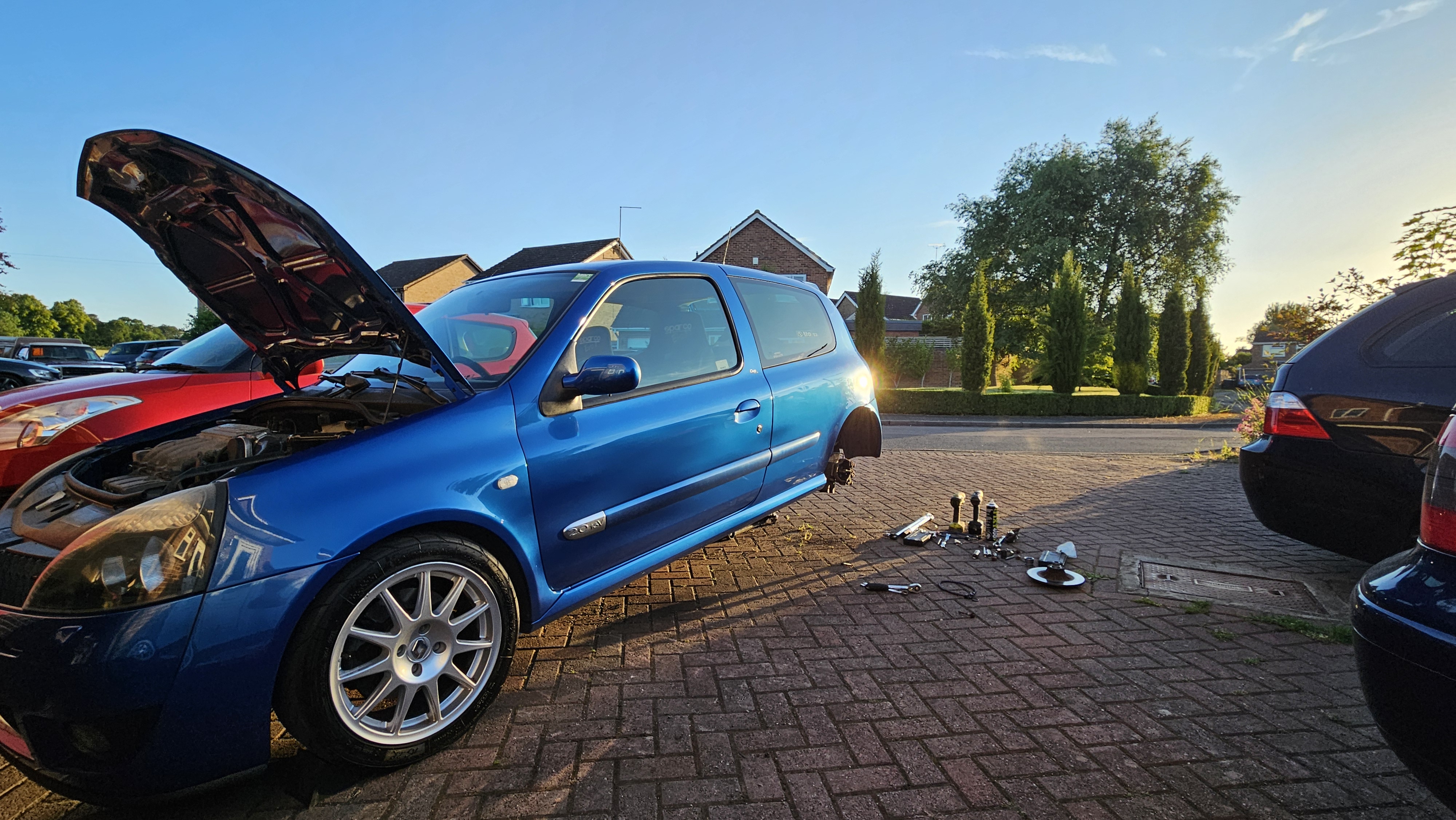

Who doesn't love working on cars with a sunset backdrop? Rear stub axle 10 mm Pure Motorsport spacers installed. I noticed the rear brake lines going to the caliper have seen better days, so bright blue HEL lines were ordered, i will replace them soon..
I'm planning on replacing the cambelt + water pump very soon especially before any track days. Also repainting the bonnet due to a poor quality job done previously. I plan to just enjoy the Cup now through summer. Maybe a few trips to C&M the bowl, if anyone is local to Bedford N'hants I'll keep an eye out for meets etc.
That's all for now.... :) PS the headlamps will be polished very soon .
Small updates on the Cup.
Fitted rear braided brake lines as the originals were past their best.
Some fresh brake fluid and she's back on the road stopping properly.

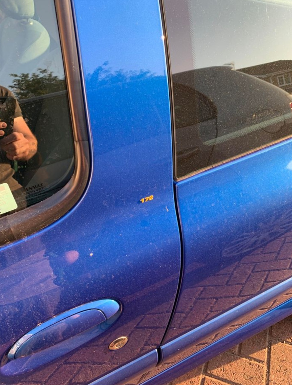

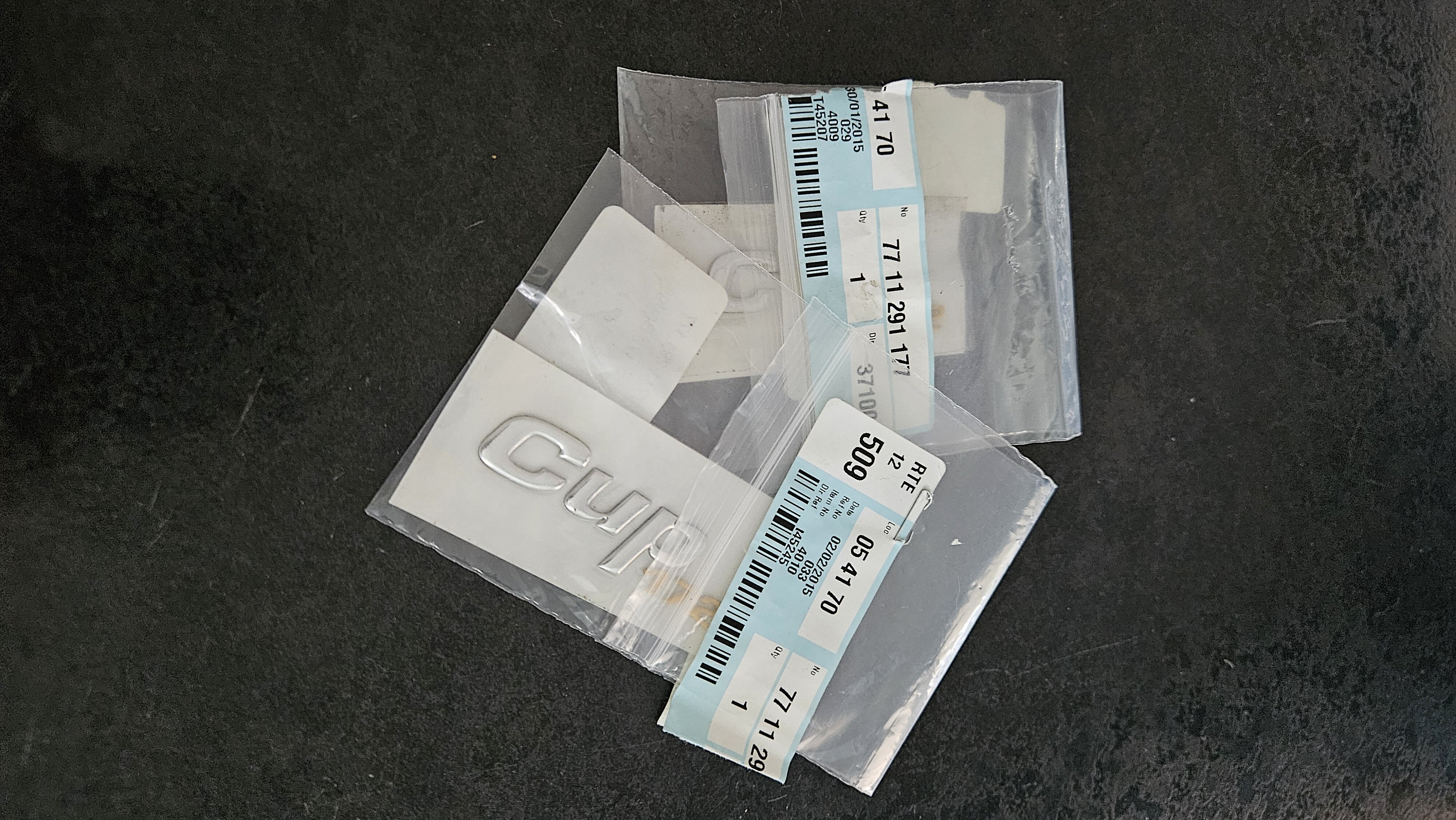

Also, something I have been on the lookout for nearly a year now: a pair of Cup 172 badges.
I have purchased a tube of badge adhesive from America just for the job, due to my old ones flying off.
Fingers crossed the cambelt job goes smoothly.
Thanks for checking in for a small read :)
Looking great, wish I was able to do this sort of work myself.
What badge adhesive did you go for, recently one of my 2's came of I used some thin 3M tape and a scalpel, it was a bloody nightmare!
Thanks mate,
The stuff i ordered was 3M 03601 I'm not taking any chances this time haha.
😄 I've got a couple of spare sets for when the inevitable happens again. Will give this ago next time.

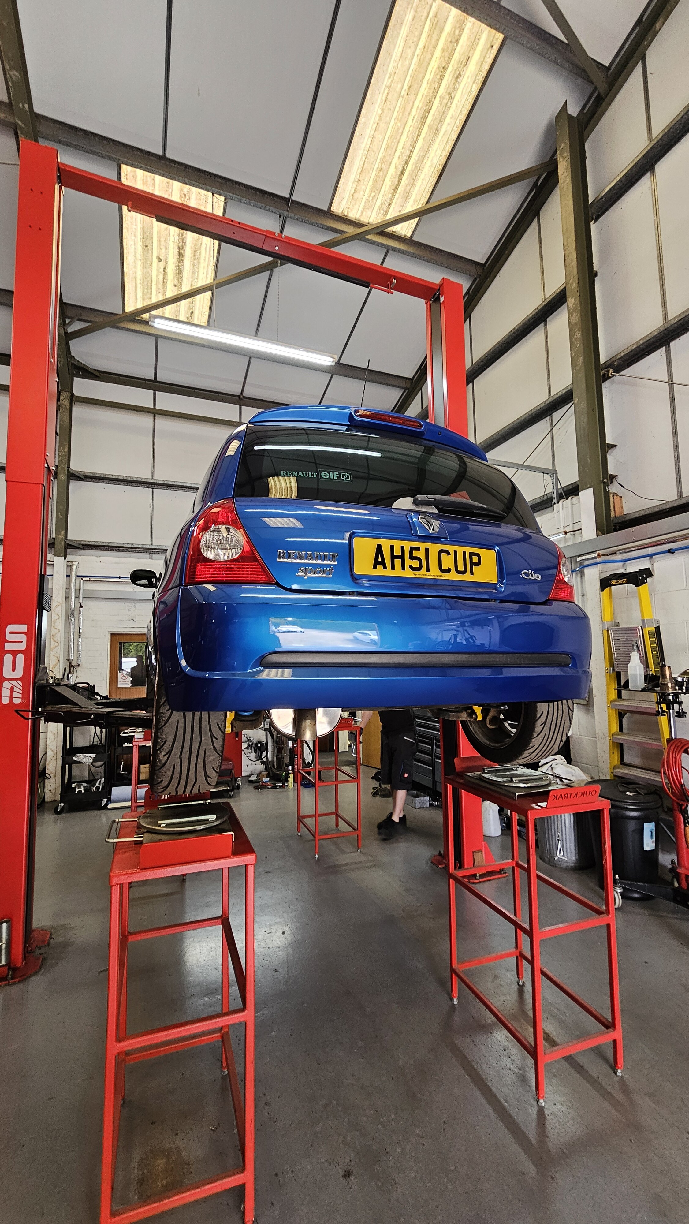

2025 update
With all the house work going on tail end of 2024 the Clio was put aside for a while.

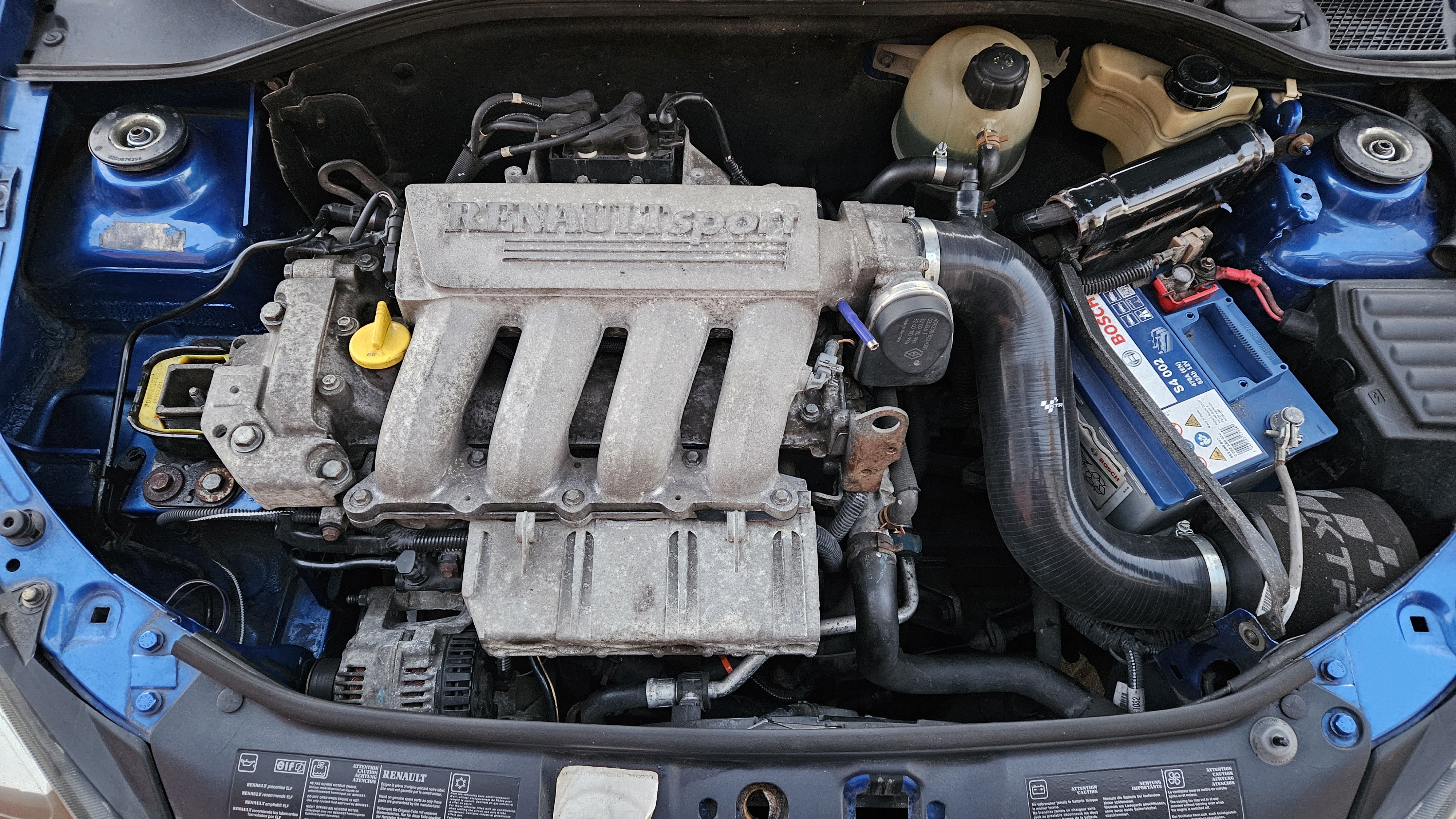

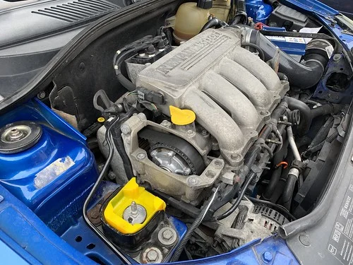

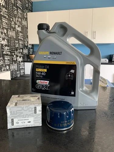

Since September I have fitted the cambelt kit, water pump aux belt all genuine.
-Oil service
-Spacers back on the front
-Brake fluid change

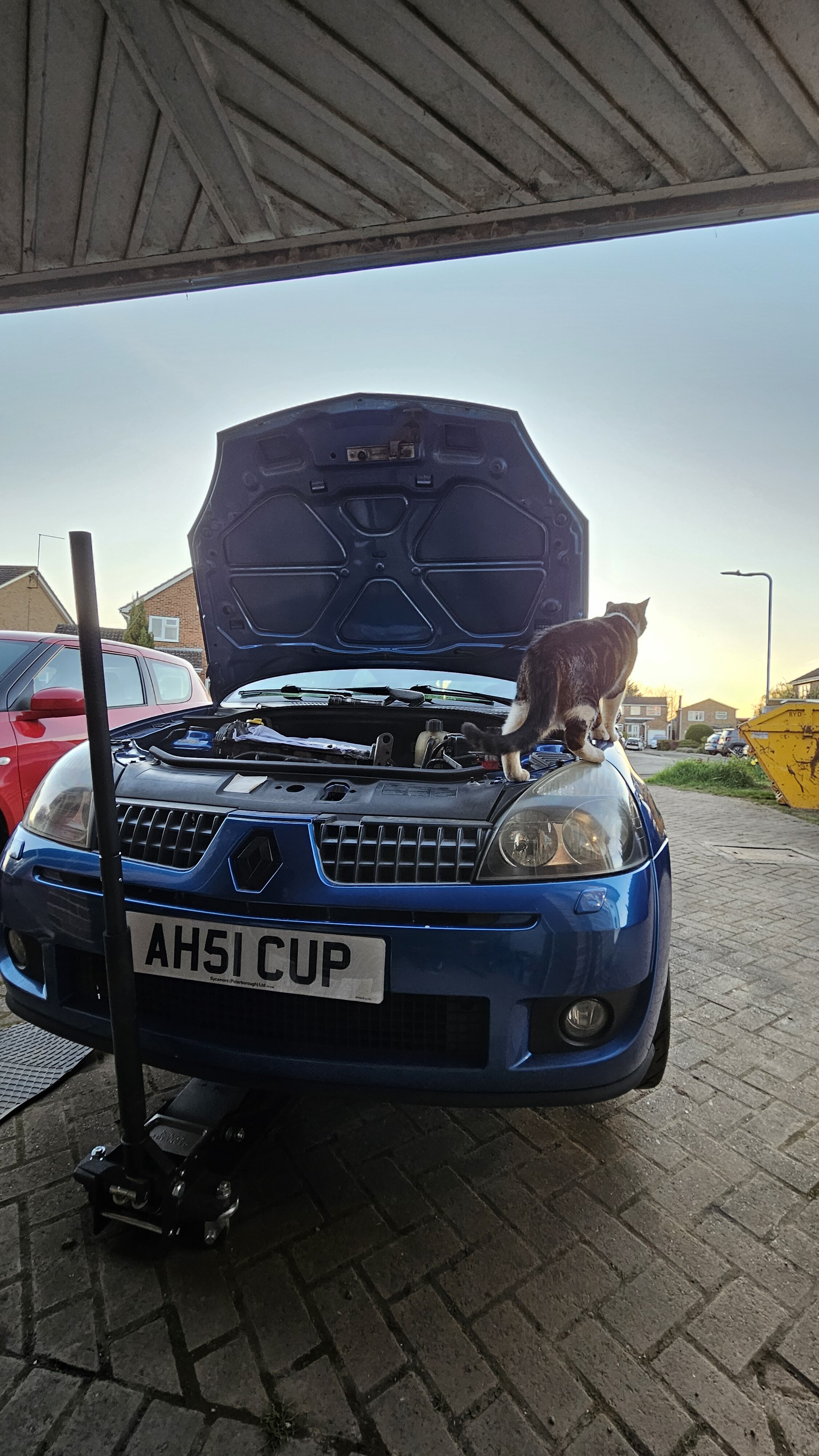

The water pump was fun to remove there really isn't much room, i found it easier to lift the engine nice and high, lots of wiggling a bit of swearing and its out.
Its old gasket took over an hour to fully get off using a small Stanley blade.
Definitely worth having all the correct genuine tools at first i thought it would be ok to use just the crank pin + horse shoe.
The engine became out of time once tensioned no matter how many try's timing it up, the cam pulley lock was essential.
locking the cam pulleys and being able to take the slack out of the belt got the timing where i wanted it to be.
After getting the engine to TDC numerous times both locking tools went back in without any hiccups.
Hurrah! job complete, the Clio runs/ pulls better than before and a little less thirsty.
Then an oil change + Genuine Renault coolant to complete the job. It's only done 3 thousand miles since the last service.
These little Clio's still look great 20 odd years later.
After checking everything over for leaks etc. All was good so time for the heart pumping moment of starting it up + bleeding any air out of the coolant system.
The engine ran great with the new aux belt tensioned up properly i didn't have the slight squeak previously on cold starts.
A little blast up the countryside made me realize how much i missed this car the engine pulls great and defiantly feels better in the midrange power wise.

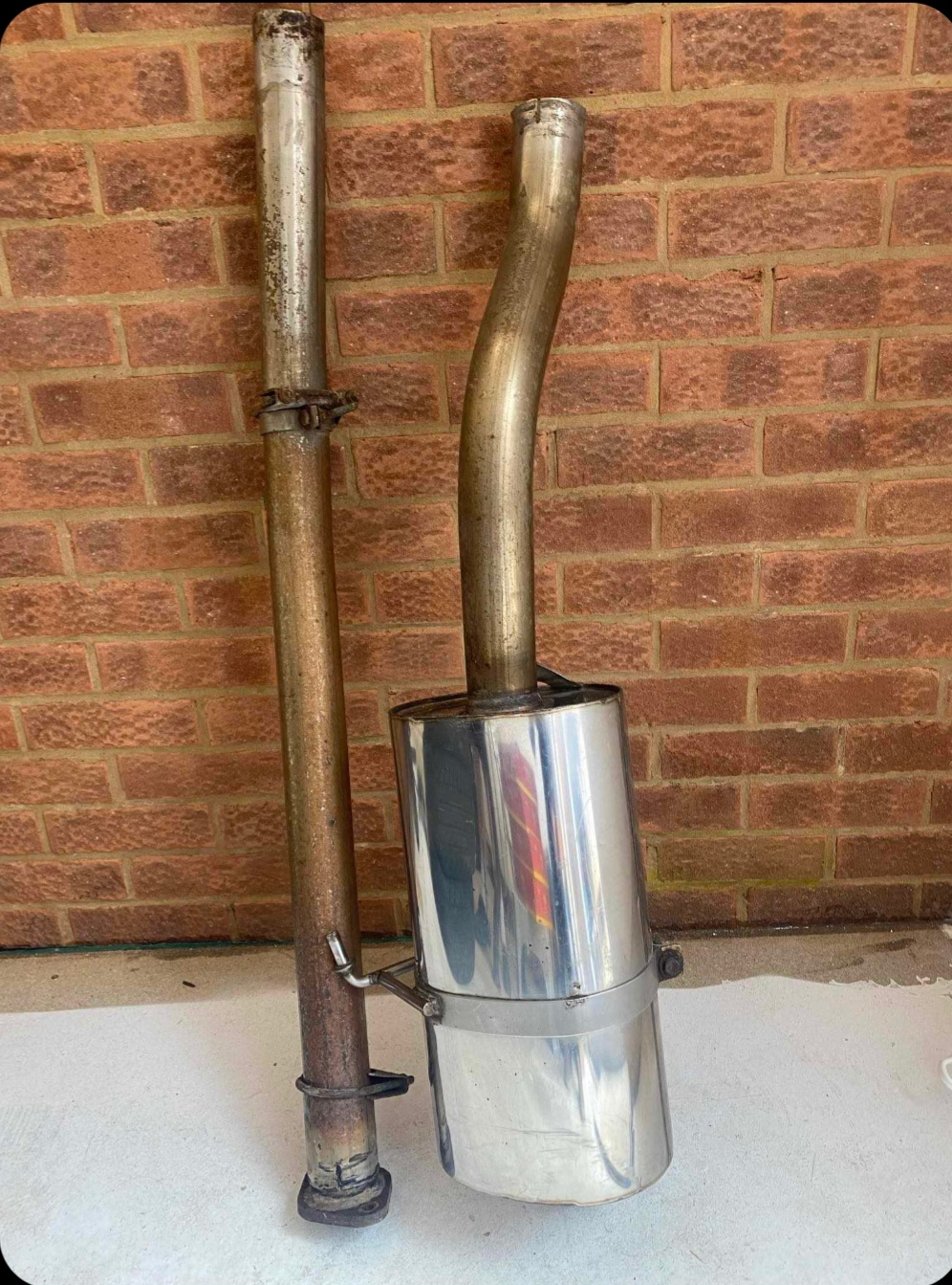

Adjust rear silencer so it sits further up (isn't very stealth at the moment).

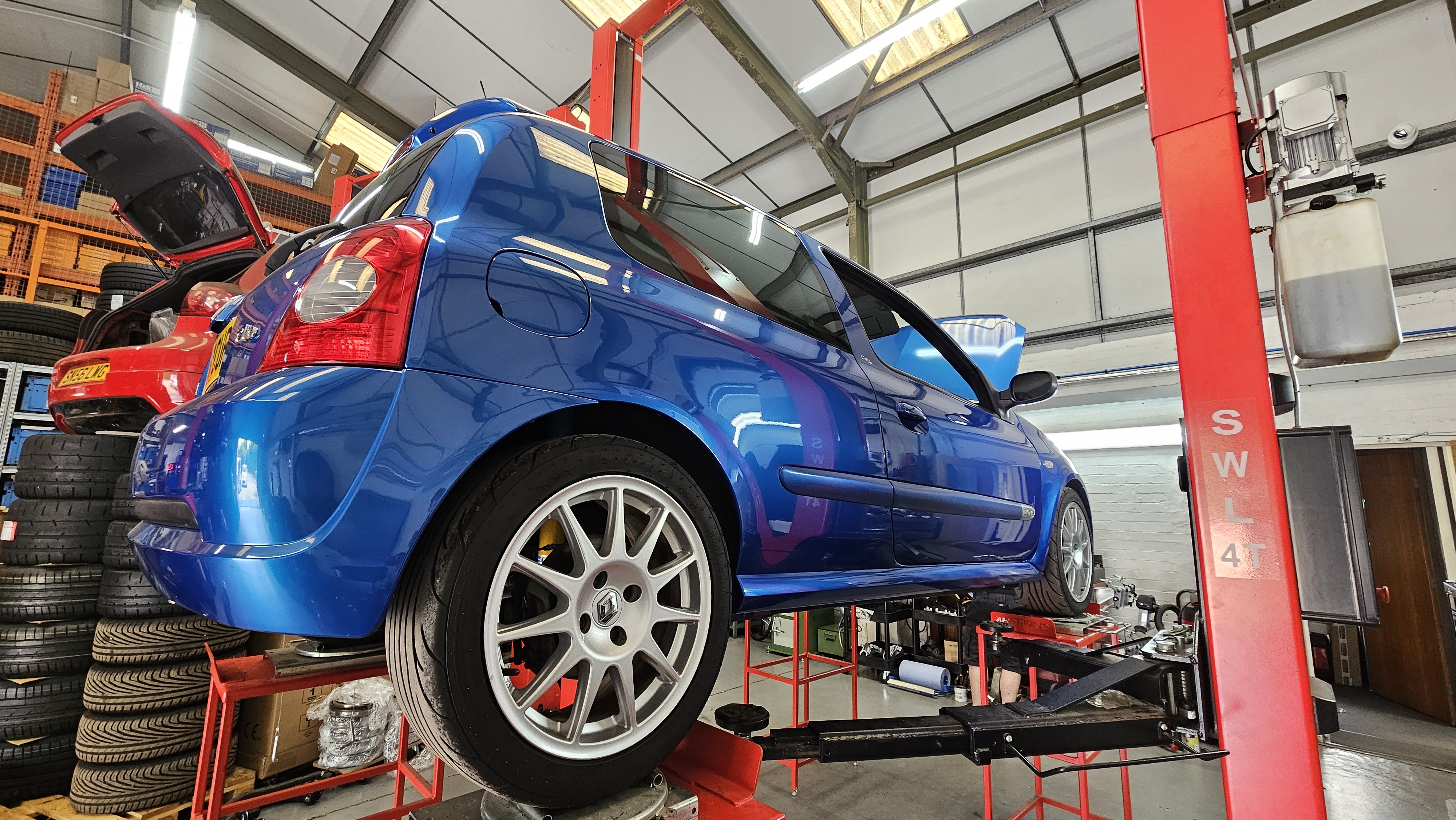

Morning guys,
The evening session at Snetterton was very good, even after the five or so red flags, an EP3 Type R with its front tow eye glued on :unsure:.
Without a cloud in the sky, this definitely made up for a lot of waiting around.
Having done Cadwell previously with just lowering springs and PBS front pads as modifications, I was keen to see what difference the Bilstein B14s, fast road alignment, and camber bolts would make.
I wasn't disappointed, apart from forgetting to bring my standard wheel bolts to take the front spacers off in case of rubbing.
(There was a lot of rubbing) on the sharp bends, so much so I couldn't take passengers.
Last time I was at Snetterton, I took my MK6 Golf R (390 bhp) a few years ago; the Clio was so much more fun. Every lap it felt like the car wanted to be pushed more and more.
But this eventually caught up with me, with the back end skipping out and sending me almost sideways. I really do love this car.

-Sort the Exhaust back box out so it sits further up
