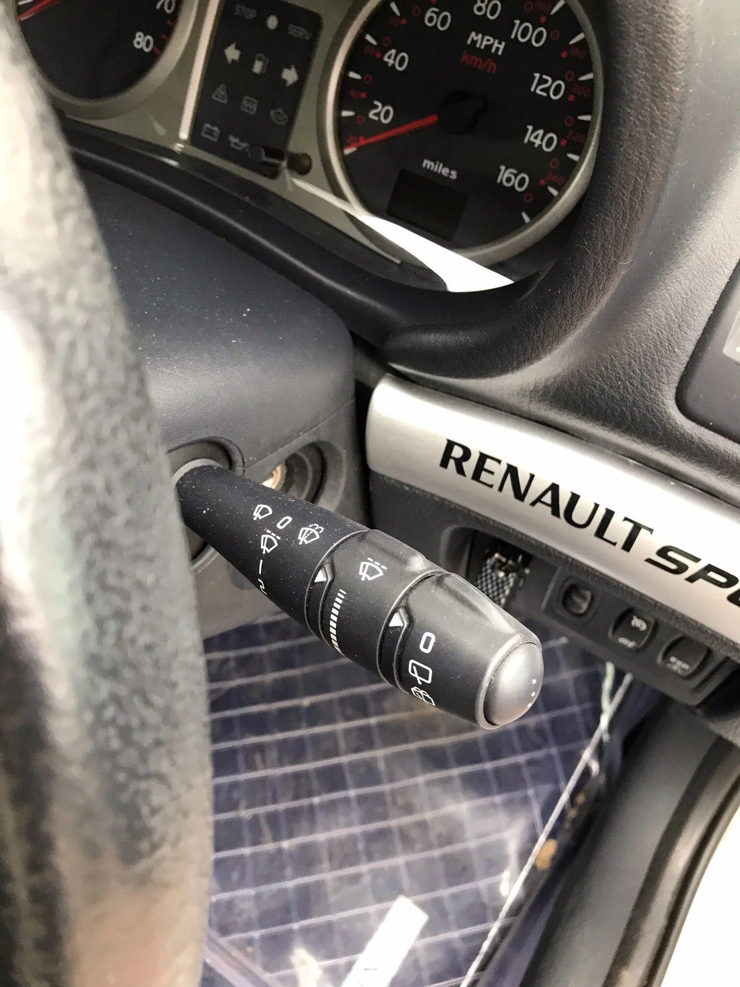

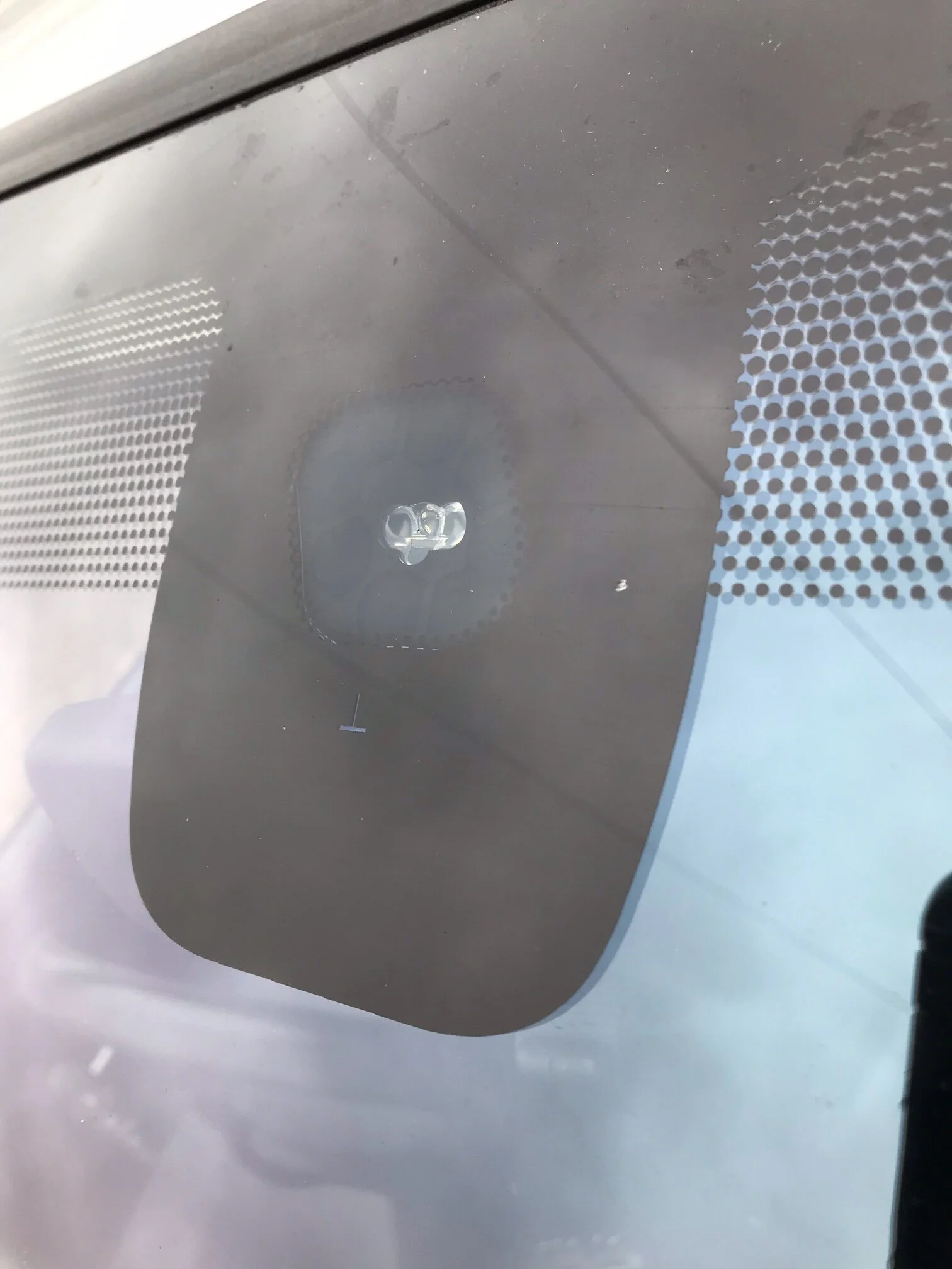

I would like some help please on my intermittent wipers issue. My recently bought 182 had a few minor issues which I have managed to sort, however this one baffles me.
All 182’s as I understand have automatic wipers and lights. My one it seems does not work.
I have the window sensor (see photo) however I have the wiper delay on the switch. I would think with auto wipers I would not have this?
I suspect that at some time the auto wipers failed and someone has changed the switch for a manual one can anyone shed some light on this for me please?

Put the stalk down into position 1, when it rains it should auto wipe. And like i said, the dial on the stalk sets the speed of the wipers. I turn mine on the fastest setting. But also how hard it rains determines how fast the wipers work.
Put your key in the ignition and turn to position 1. On the left hand stalk, for the lights, quickly turn dial for the lights on/off on /off and you'll hear a beep. That's your auto lights set. Do exactly the same to disable auto lights.
  Fiat Panda 100HP
Many thanks for all the help. Wipers working automatically fine now, used a hose and it slows and speeds up as it should. Did the lights, got the bleep but can't test until it gets dark.
