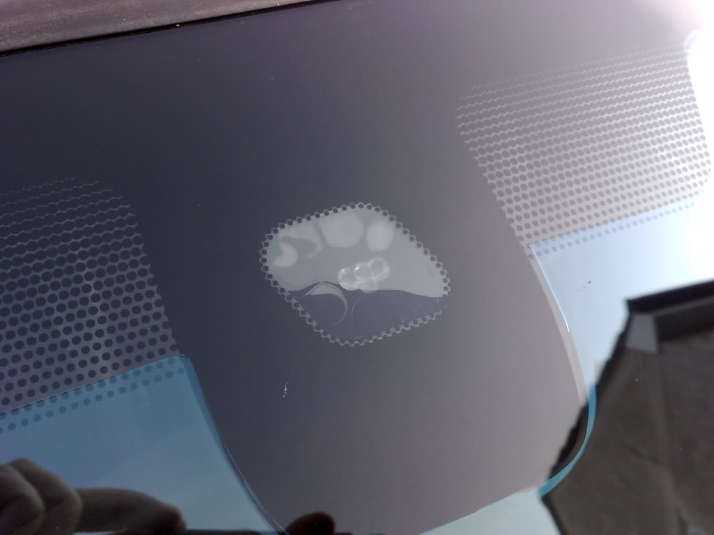

got my windscreen replaced a few months ago and the auto wipers have not worked since.
do we think the sensor just needs cleaning??
if i take the sensor/holder off the windscreen what do i stick it back with?
its pretty misty
grrr.........................
bloody RAC....
the tw*t from RAC who fitted my windscreen didnt bother putting any glue/sticky stuff on the top part of the sensor so it was hanging off.
also very dirty.
i didnt even bother with new gel, i just lifted the old gel up cleaned the sensor. i cleaned the windscreen which was mega dirty under the sensor. im currently using double sided tape to hold the sensor in place till i get the correct glue.
but the wipers are working already.
ok the whole brack has come off the screen
what should i use to stick it back to the screen?
