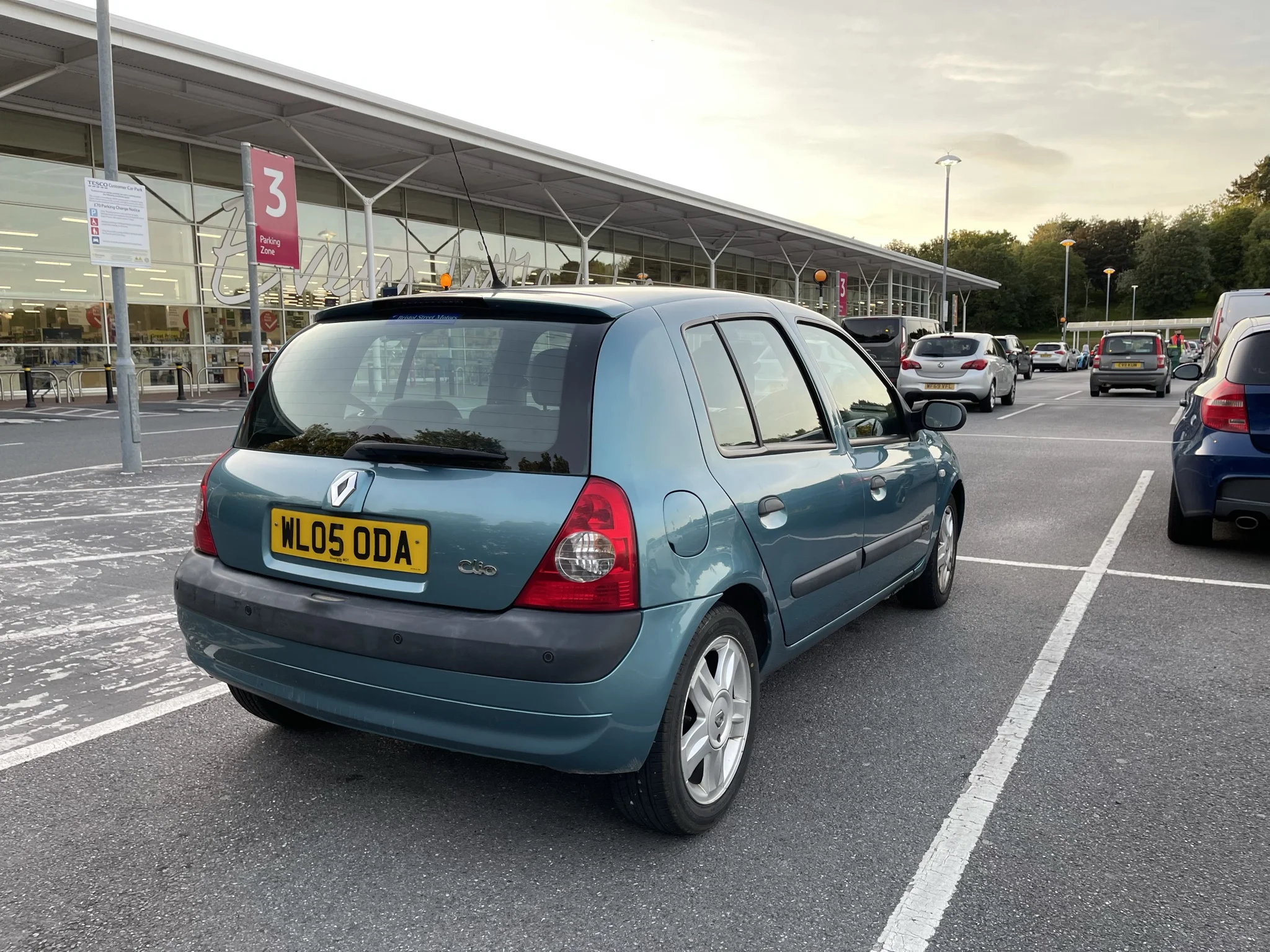

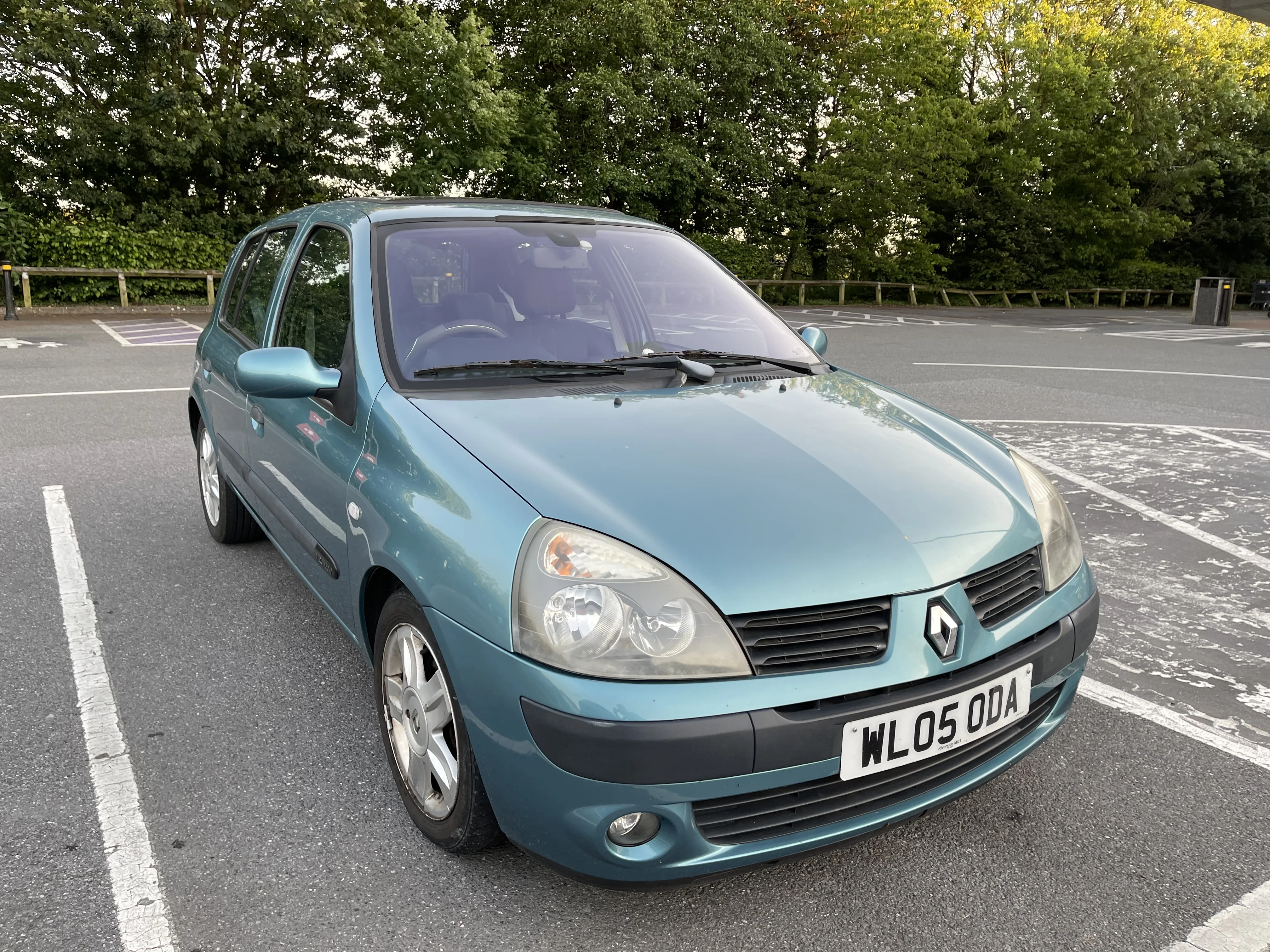

So my better half is currently learning to drive, and therefore it’s first car time. What better, then, than a Mk2 Clio?

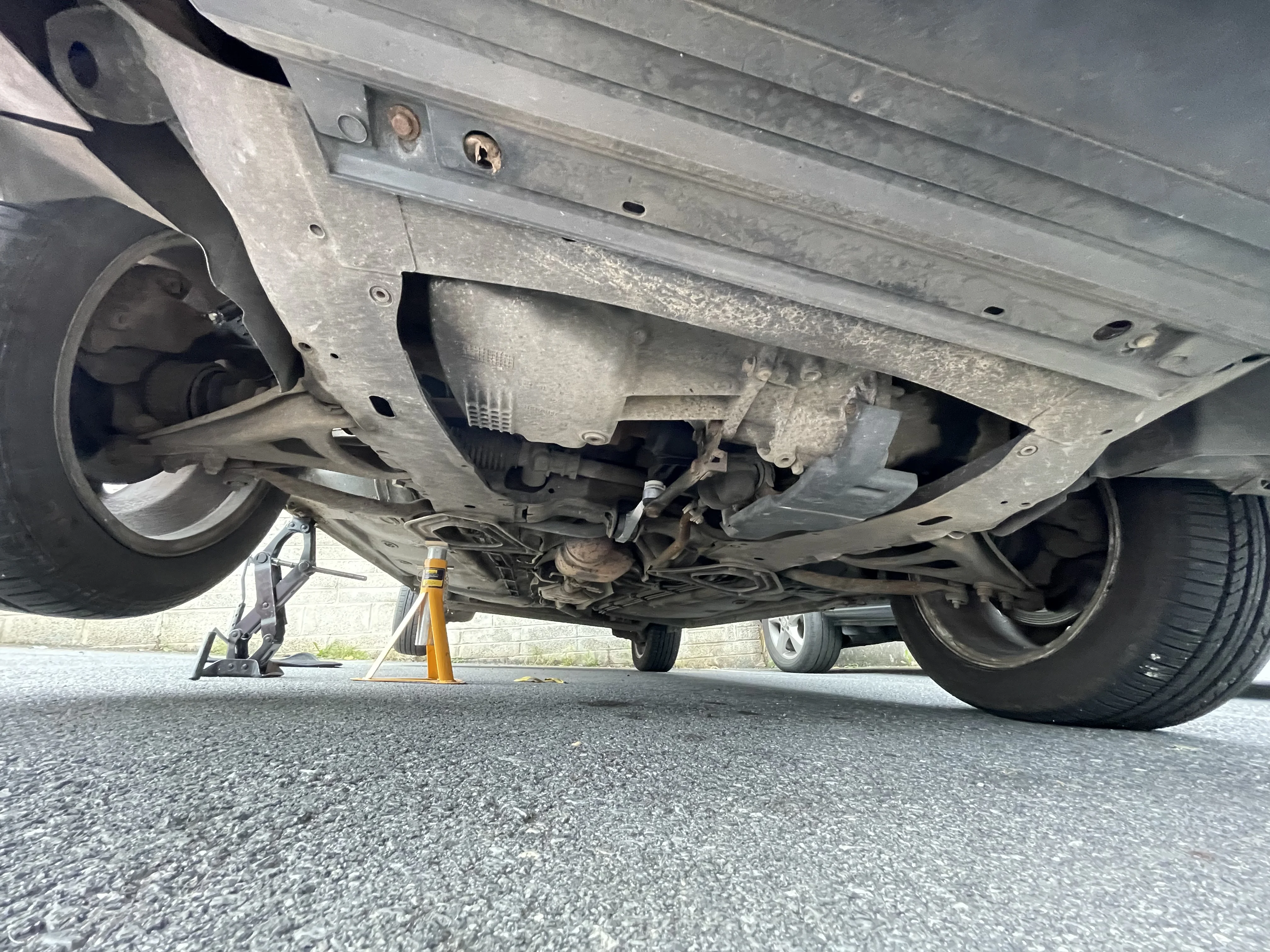

So it’s a 2005 1.4 16V but it’s actually pretty clean. There is like ZERO corrosion underneath, and the engine is absolutely sweet as a nut. It’s even got a sunroof which, whilst it whistles slightly, doesn’t appear to be letting any water in anywhere with the roof lining
Currently on 129,000 miles, bought it with a few little bits to do but nothing major;

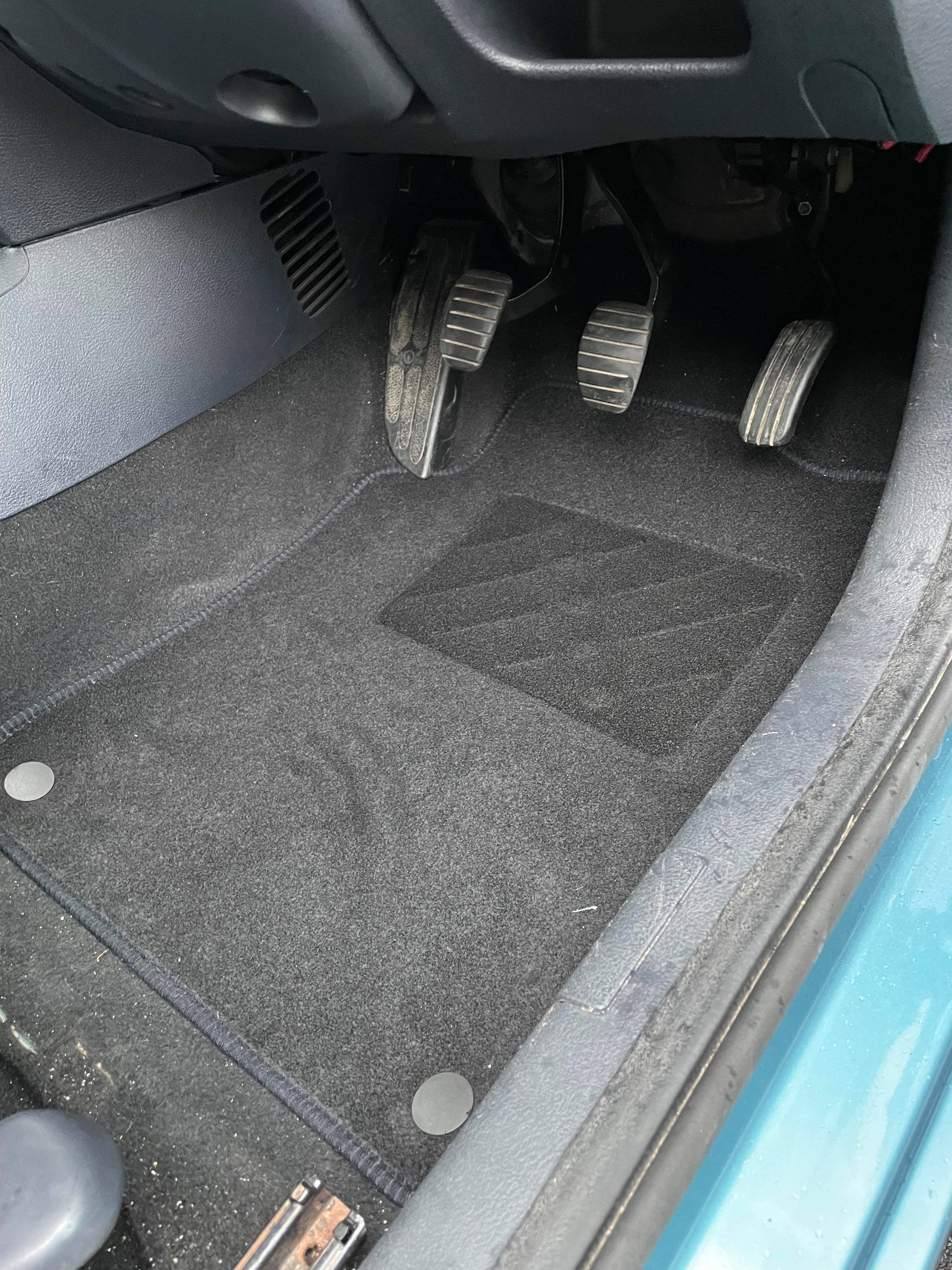

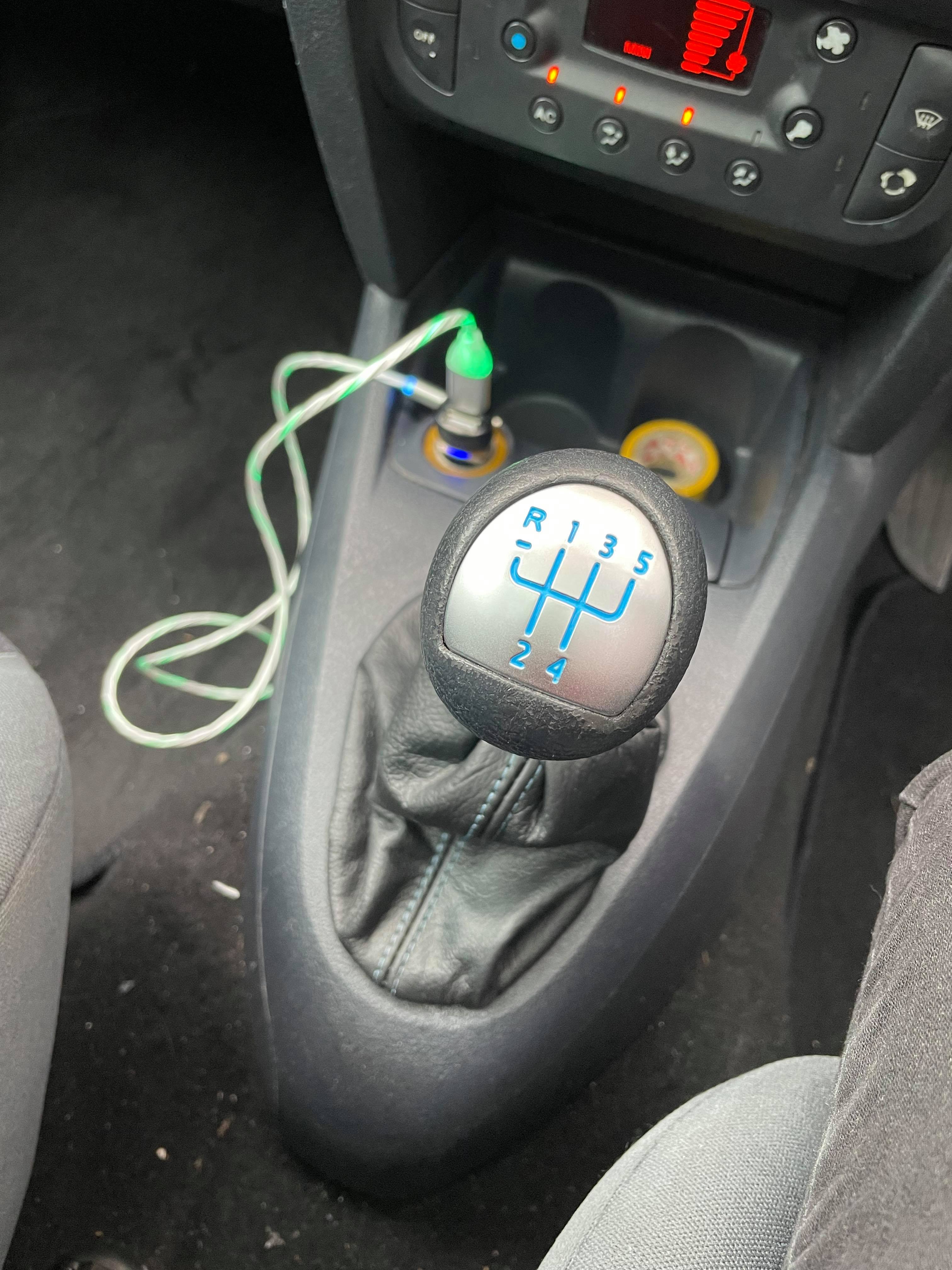

Fitted floor mats arrived the other day so they went in today, much better fit and don't slide around because they're screwed in. Much nicer. Gear stick insert was also completely worn smooth and since the good lady is learning to drive in this car the lack of any gearstick markings was an issue so a cheap ebay jobby went in, simple touch but worked wonders, likewise with a new gaiter. Oh and new wipers too, couldn't Gtechniq it and have crap smeary wipers.

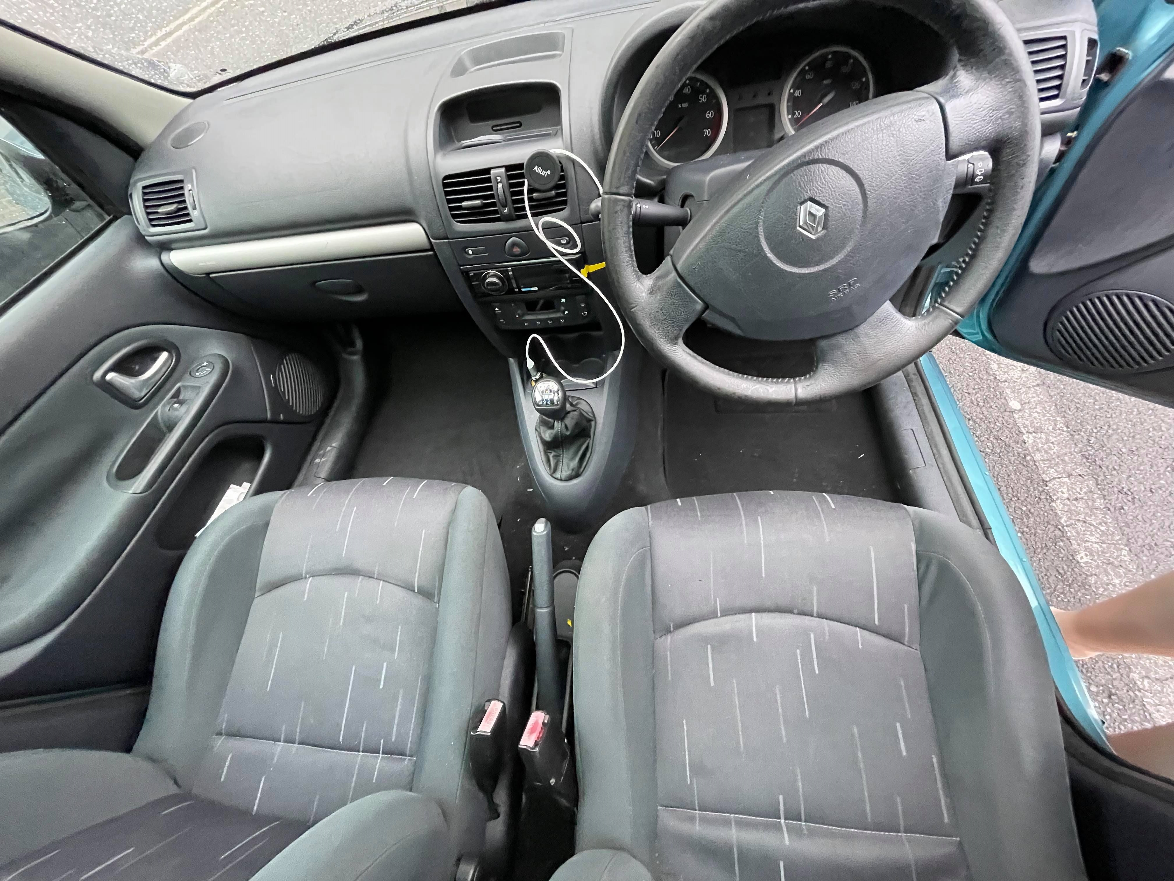

Interior needs a bit of a clean though, lol.
I can’t believe you fitted new mats without cleaning the interior, makes my willy hurt.
Apparently it was hoovered but that stuff wouldn’t come up.

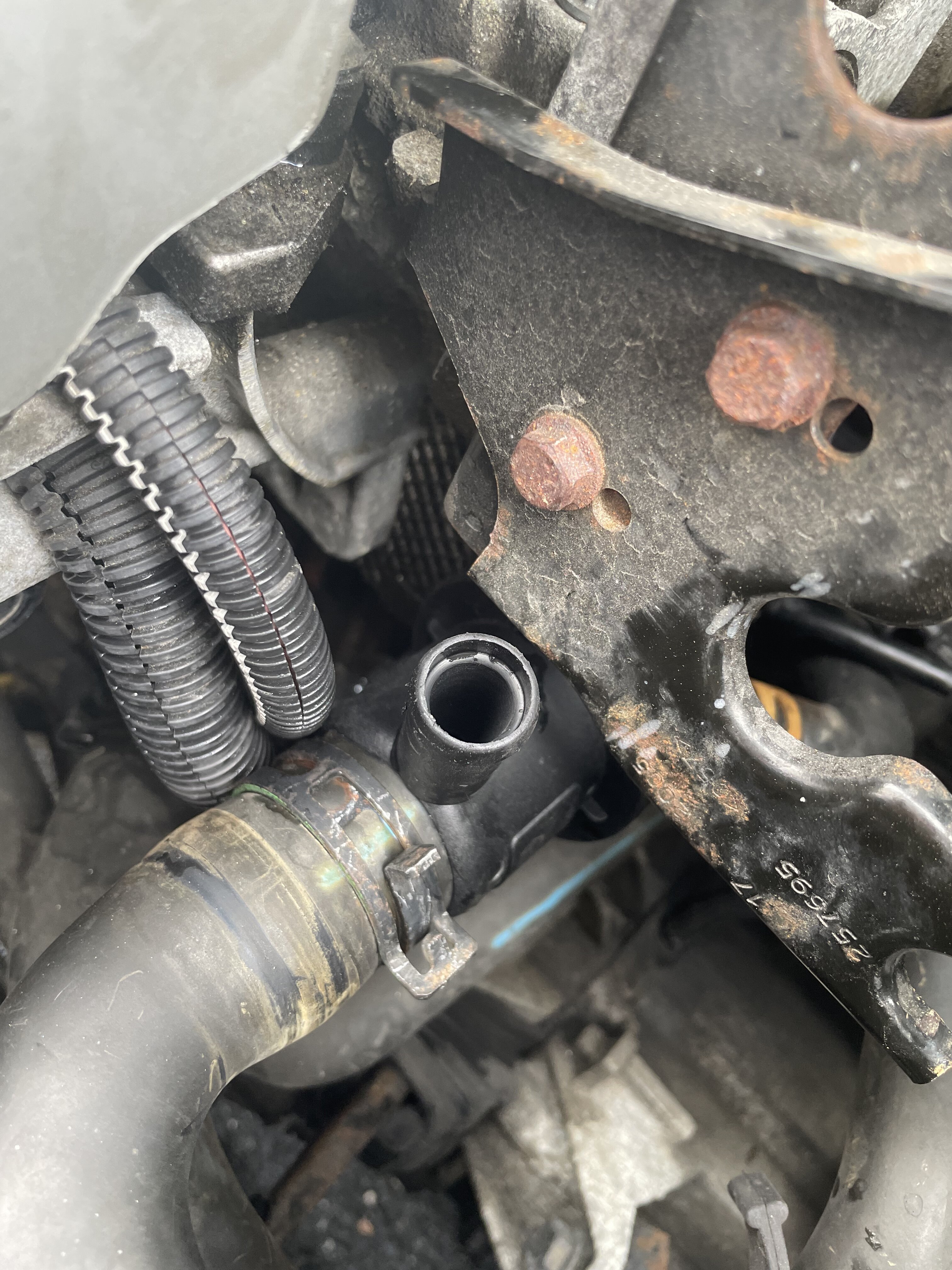

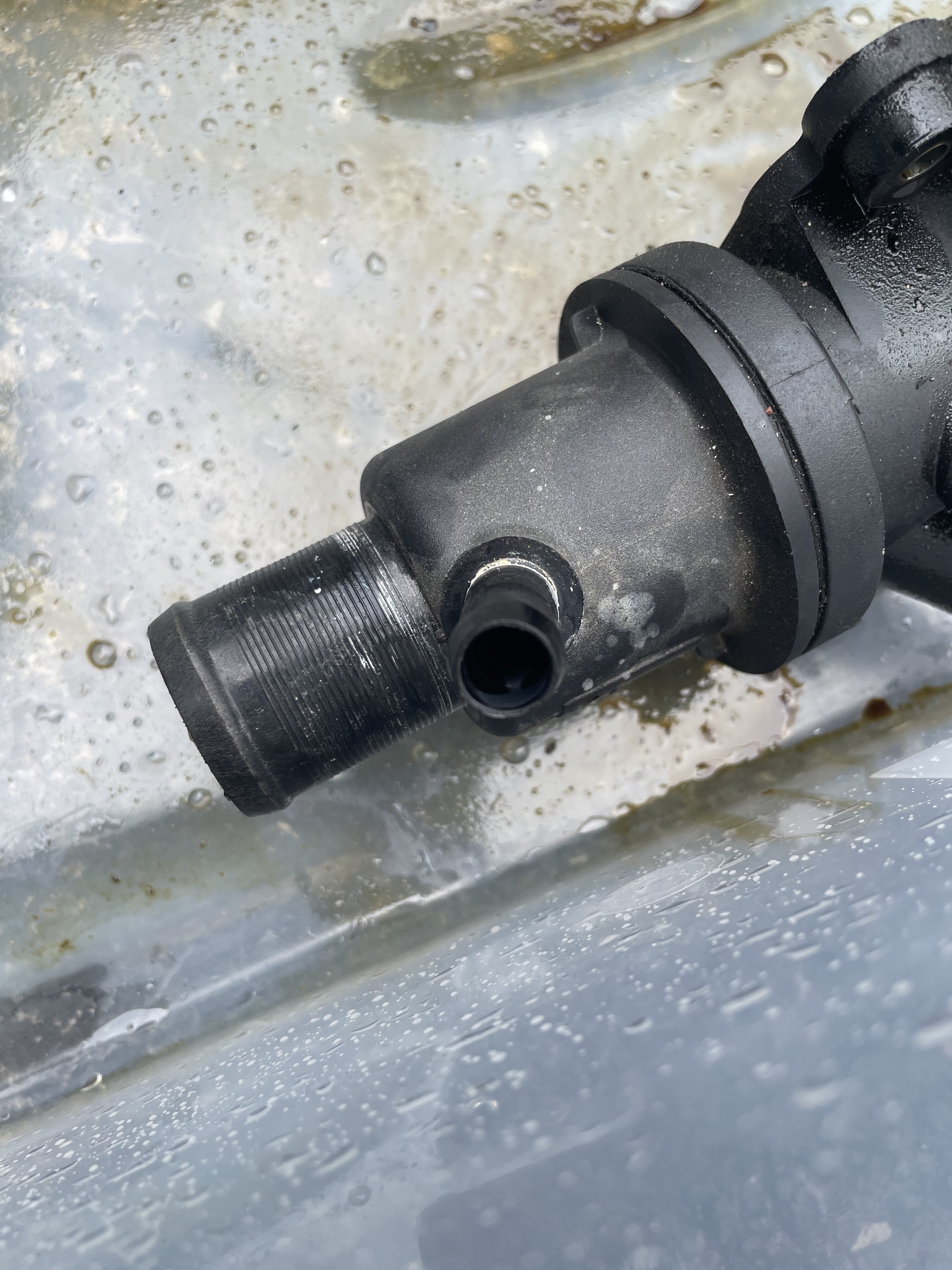

Had it on OBD today, drove a good 20-30 minutes and the hottest it got was 68c, so thermostat it is. Shame it’s one of those bloody integrated housing jobbies though, have to replace the whole lot instead of the thermostat. Still, easy fix and no doubt will unlock some extra empeegees. Will probably do an oil change at some point too as it’s probably been dumping extra fuel into it.
Great little motor tbh.
Ffs. Coolant return hose is a completely different size - everything else is the same. Got to the last possible moment before I realised too.
something like 18mm id instead of 10mm.
