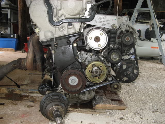

Make up some sort of tool to release the tension. 3/8" square drive but very poor access.
What do i loosen on this pic?
i loosen lower alt bolt, remove upper alt bolt/nut and pull alter down towards the front of the car, just makes it a bit easier as you have to put a s**t load of force on the tensioner
So the little square female bolt next to the male torx needs to be loosened off to release the belt tension.
