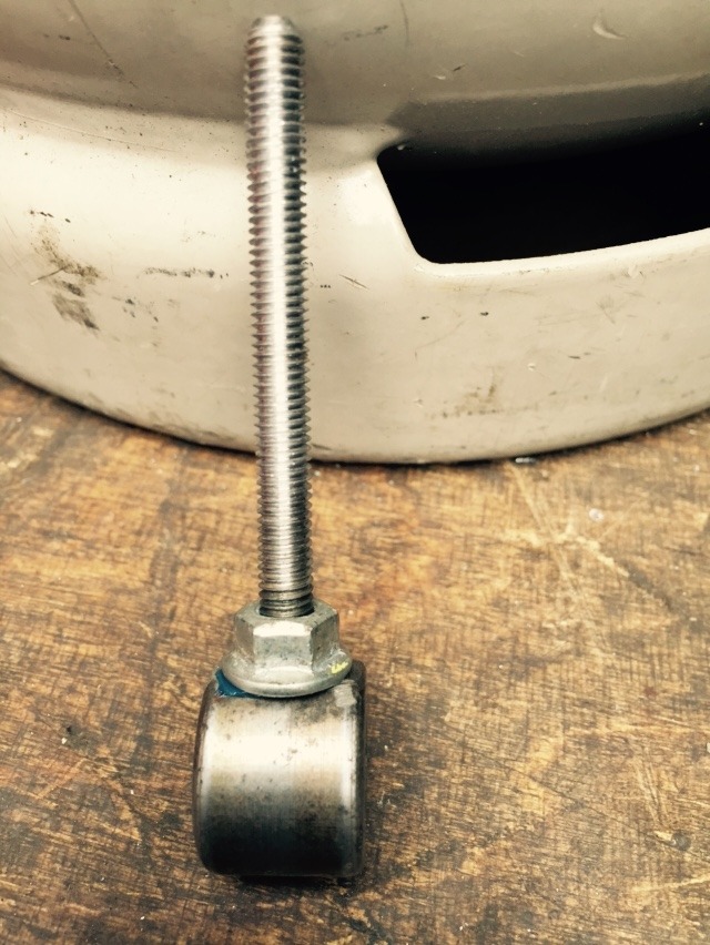

Hi wonder if anyone can help, the bolt that tensions up the aux belt has snapped on my 172 cup. Renault say they don't make the part anymore , anyone got any ideas??

There's a long screw that is missing
You could get a few inches of M6 threaded rod or a long bolt and either weld, or as I did, drill and tap the lower piece and screw the bolt into it.
