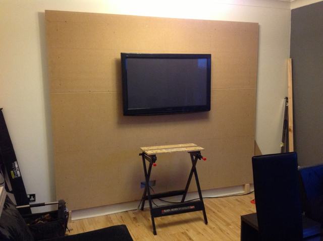

More photos of mine as promised. (Sorry to hijack)
Still in primer but hopefully get some final decoration done this weekend.

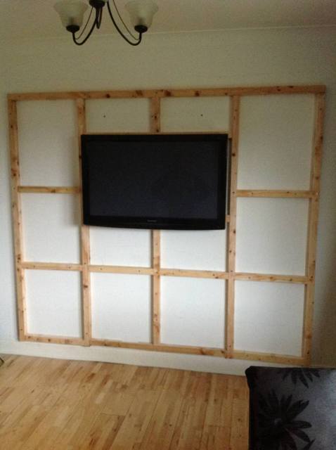

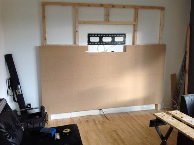

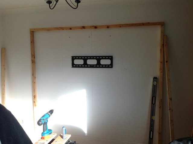

Ahh I see now! Is that plasterboard on top?
how do you fill the screw holes in? Normal filler I presume?
Jaff.
12mm MDF. Filled with just normal filler but in stages with 24hrs in between.
Cool, I guess you just paint over that then? Doesn't need plaster?
i want to do this and put a projector screen on it so this has helped me visualise how to do it now thanks :)
gotta get my fecking house first tho :(
No plaster required thankfully!
  BMW E46 330i Touring
Doesn't need plaster but will need a lot of painting, sanding, painting, sanding, painting to get a decent finish. In my experience.

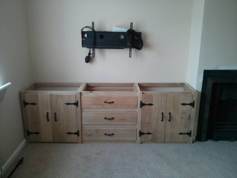

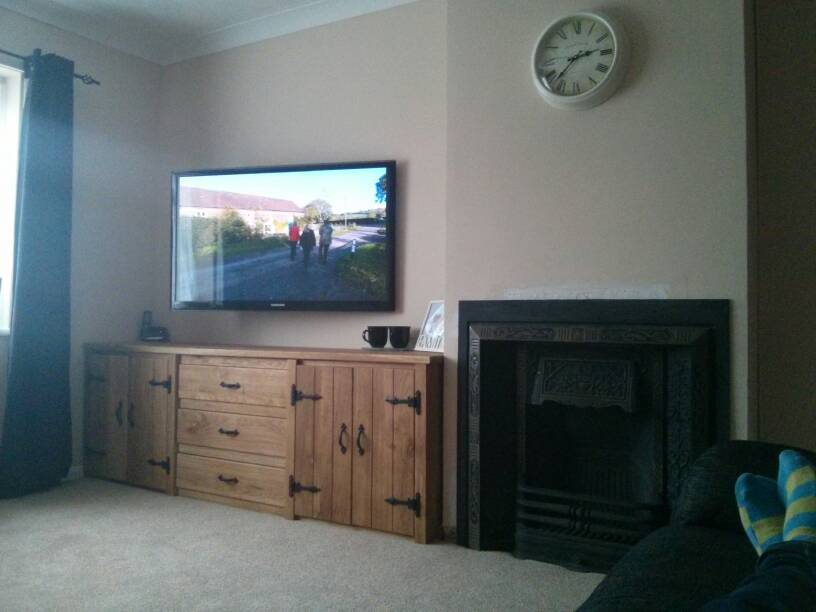

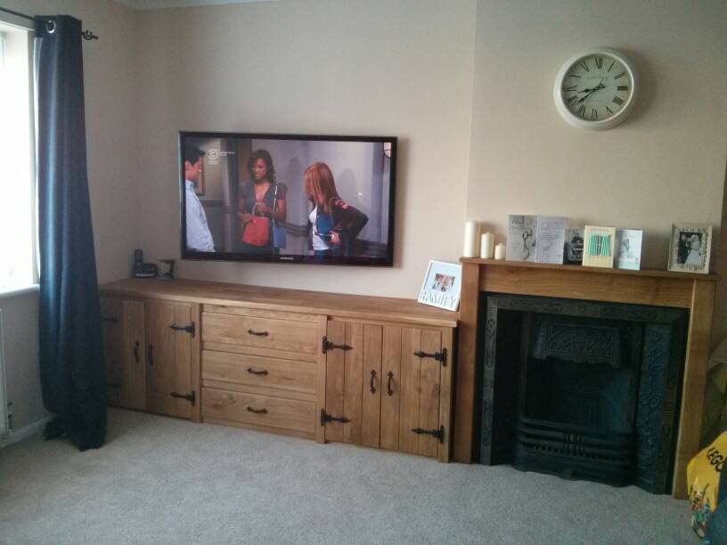

Here's what was made ..
Wall has conduit inside it and plastered over ..
Wires come out inside a unit that we hand made .. Just need to finish the top!

That's a good effort :)
I need to sort something out for mine, as the wires are pissing me off.

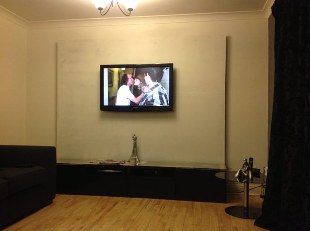

I was skeptical with those units at first as I thought the units looked a bit 'busy' with the black hinges and handles but thought I would wait for the finished pictures.
Looks great though and has really surprised me, really nice set up now! What size is the TV?
