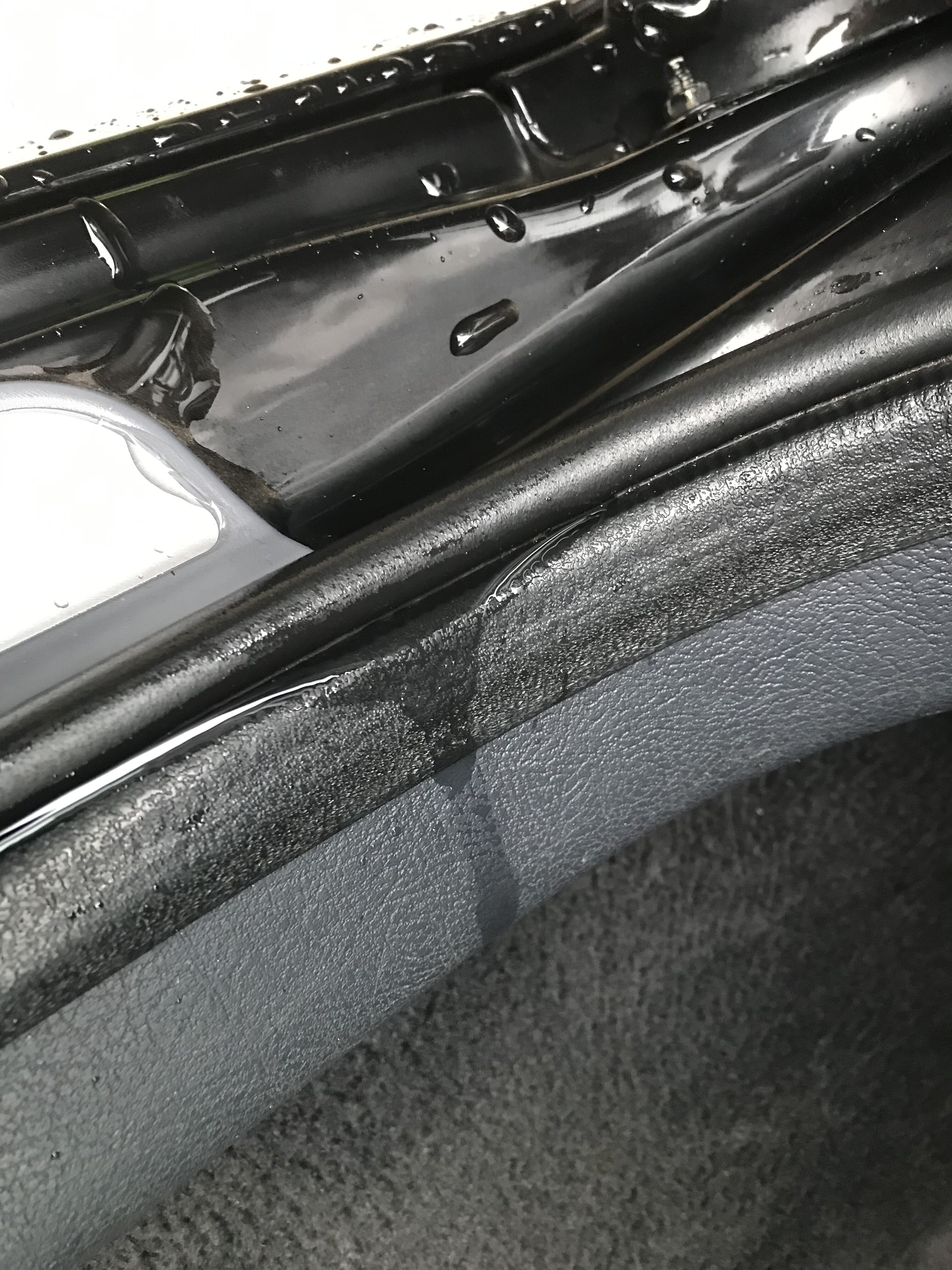

That’s odd that your footwell is dry, maybe the leak is coming from the door card as most people don’t realise there is a black sticky seal which needs redoing when the door card is taken off and put back.
G4RDC
  Inferno Orange 182
How do I check if the seal is intact without removing the door card and then breaking the seal
Chocice
  172 Cup, RSI, 200
You might see some water on the plastic trim leading to the wet carpet if not look at the screws at the bottom of the door card as you pour water on the external weather strip to see if any water is dripping through.
G4RDC
  Inferno Orange 182
I did check the plastic trim but I will do a water test to see if any drips through. Thanks for your help.

I’m not sure you’d necessarily see it coming in through the door cards. Best thing to do is to take them off and replace the butyl tape. It’s literally a tenner from Amazon.
main places for leaks are the rubber boot bungs, aerial base, door card seal, door seal, front scuttle blockage. If you’ve ruled out the rest and not taken the door cards off, I suspect that’s it. Especially with where the water is pooling (under the seats)

If the leak is coming from the door cards, water will be sitting on the door seal, which will overflow and enter the car. Ask me how i know.
G4RDC
  Inferno Orange 182
Mine is bone dry on both sides. So if it is it’s a little trickle that might be coming through where the door seal joins but like I said I can’t see a trail of water or a clean like or anything.

On mine the rubber that seals the aerial base had gone brittle so yes it was noticeably loose I think your main culprit has to be the door card from what your describing, anyhow if you want to tighten the aerial base you need to remove quite a bit of trim it’s a real faff I would do the door first it’s actually easier and most likely the cause of your issue
G4RDC
  Inferno Orange 182
By the condition of the aerial I’m confident it’s not that. Butyle tape ordered.

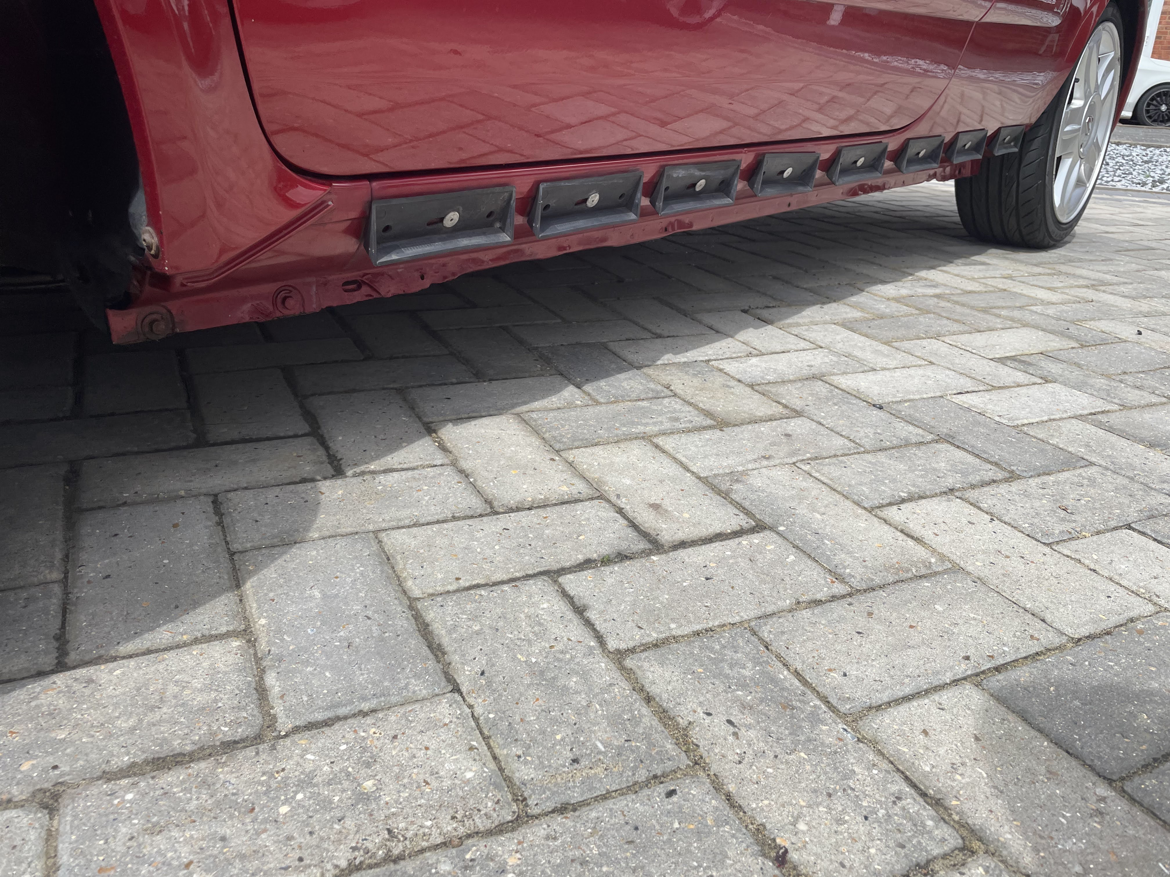

Feel free to shoot me down but as one of the firsts steps I cleared all the crap out of both front arch liners. Could there be a similar build up behind the side skirts forcing the water in through a seal or something similar?
G4RDC
  Inferno Orange 182
I think I can rule that out. If it was to come from the rear door cards I think it would be leaking into the rear footwell but it’s only under the seats.
