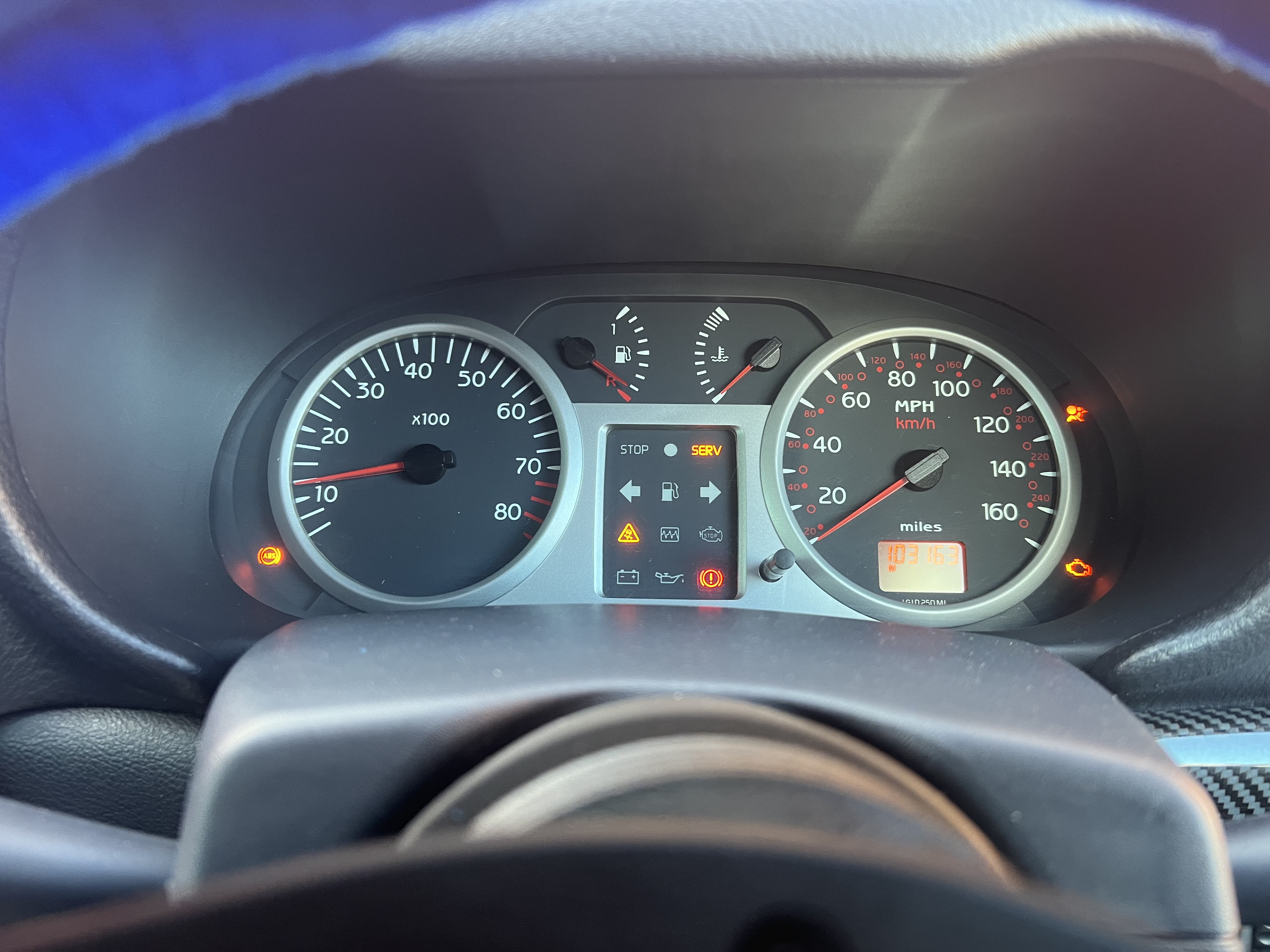

I’ve now got an abs light since the works over the weekend as well.
Hoping to get the air bag ones coded out soon. And the stability/ serv light is from the steering angle sensor I believe. But the abs one I’m not so sure ….
Any ideas ?

Does it go out when you turn the ignition off and back on?
I’ll check after I’ve finished this call. I did notice the ride height sensor was busted when it was up in the air also….

Been doing some reading. I am wondering if the abs sensor light is now on due to the steering wheel replacement (Cruise control) etc.....
I read that sometimes it takes a few days to come up?
Can this be coded out with clip at all?

It could be the wheel, although the light normally goes off and comes back as soon as you turn the wheel.
Usually on constant if an abs has gone.
Need scanning really.
Did you fit a steering boss that had the tabs on the back which locate in the steering angle sensor?

Erm, it’s the ktec momo one if that helps?
It’s splined obviously and slotted which locates in to the slot on the angle sensor..
I know my service and stability light is on because I didn’t line up the steering angle sensor properly when I fitted it.

Yeah the Momo one is the right one.
Ahh so you know about the angle sensor fault.
Sounds like an abs sensor has gone then, maybe disturbed when fitting coilovers?

Probably. I’ll see if I can get it plugged in 🤦🏽‍♂️
