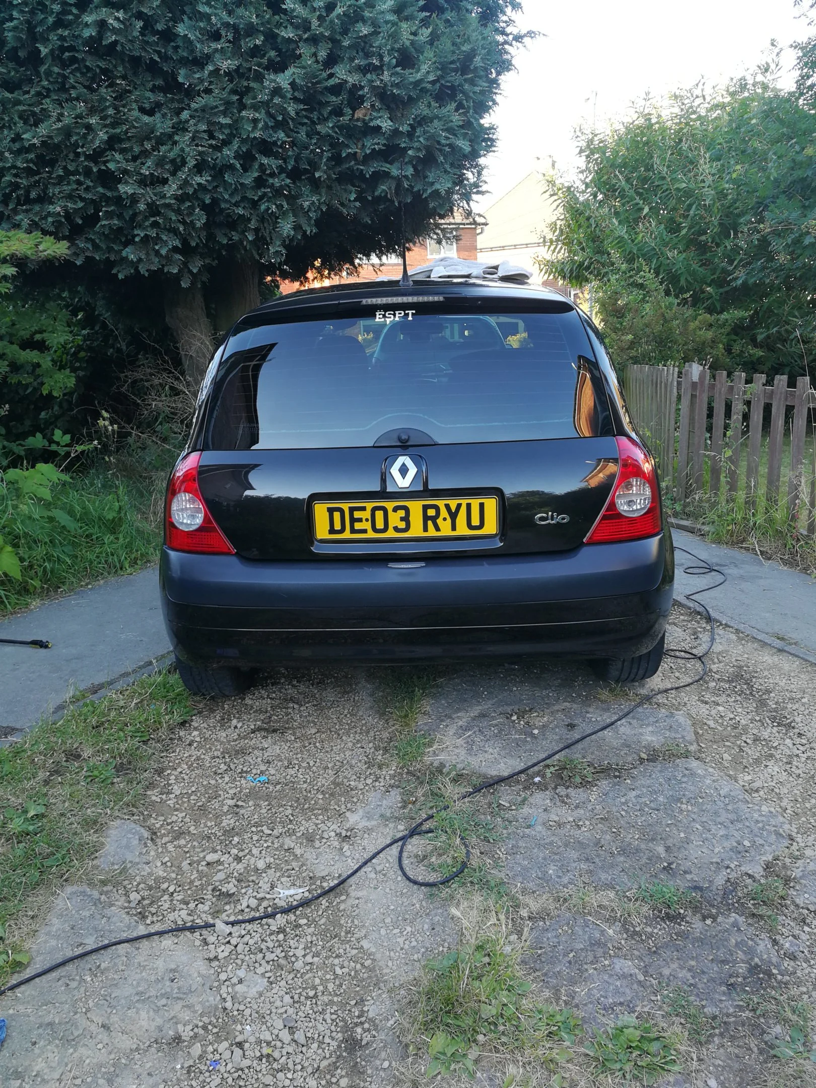

Ok, I have been away from these pastures for a very long time ..... Guess it's high time that I returned!
11th June I picked up this little Clio (making total owned up to now 4, I only have this one currently ).
I didn't really give anything for it. I had a Mondeo that I didn't want anymore so just swapped it.
It's a little 1.2 16v billabong edition and not so far in the distant past it was really well cared for (I now know the previous owner who sold it on 4-5 months ago).
Much toil and effort has gone into saving this little car over the last few weeks.
New driveshaft, brake pads, lower ball joints, tyres and a couple of hubs to mention just some of the items.
But ..... We now look like this .....
I still have the door to get right and a pair of front wings sourced already so they will be fitted soon.
I have some long term plans with it as I go along. Not sure which direction that I will go just yet. I may chase power and Chuck a bigger engine in (maybe), that's certainly not a priority at the moment!
I may just stick with visual mods once I have it returned to a base point if you like.
Either way... I will update here as and when I can as the car progresses. I shan't be asking silly questions about what engines fit in etc as I already know and the topic is somewhat of a joke against 1.2 owners it seems ?

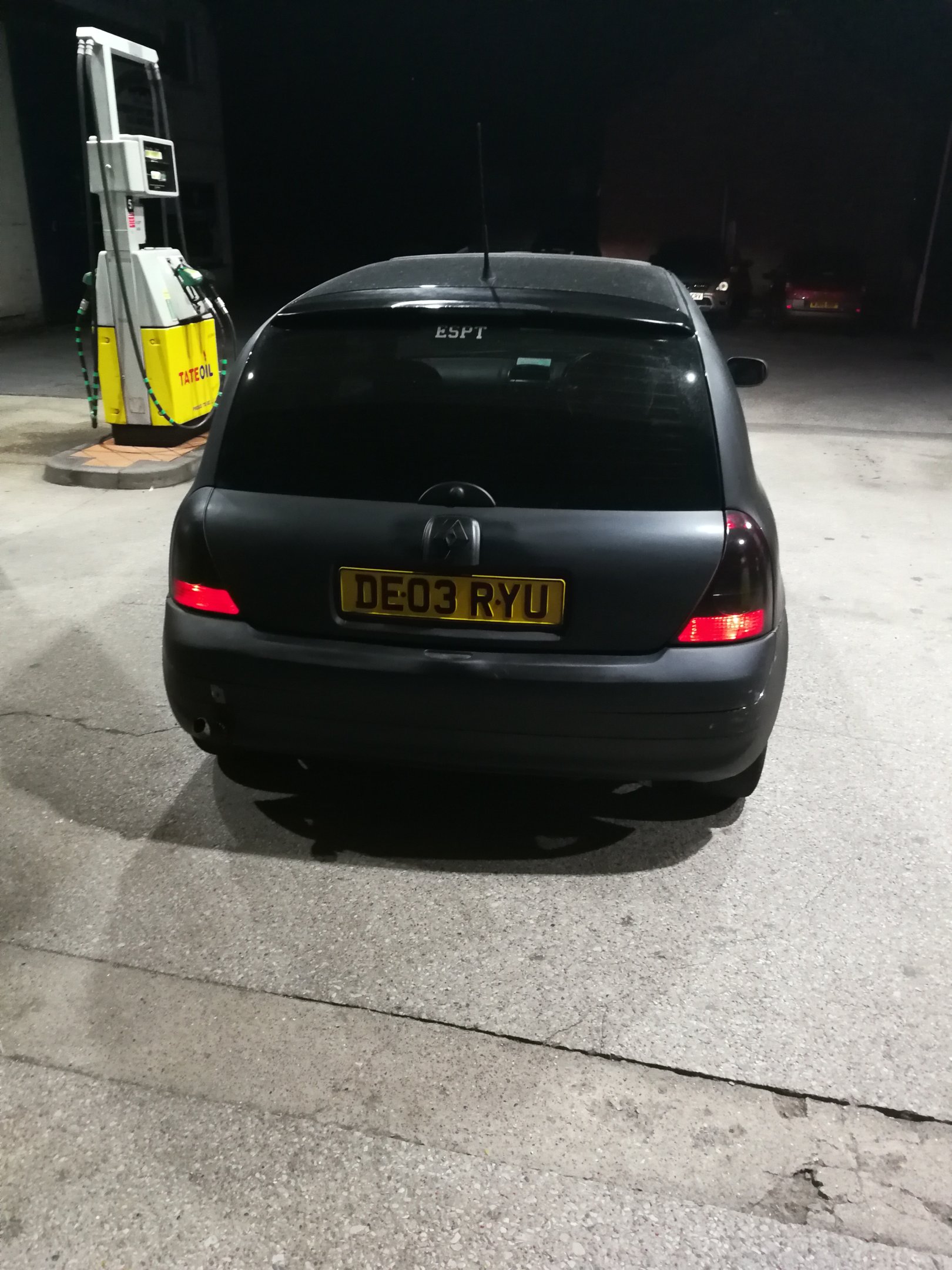

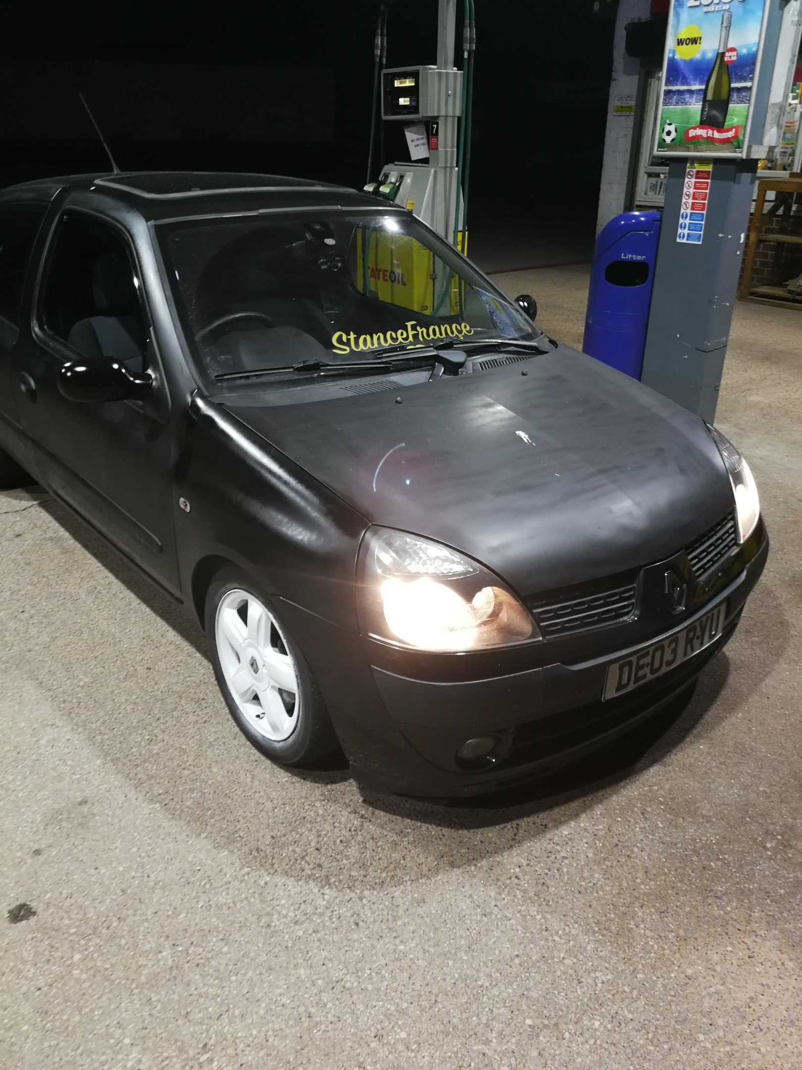

And yes .... If you were wondering, it was painted with a Fisher Price "my first paint set" .... It must have been haha
