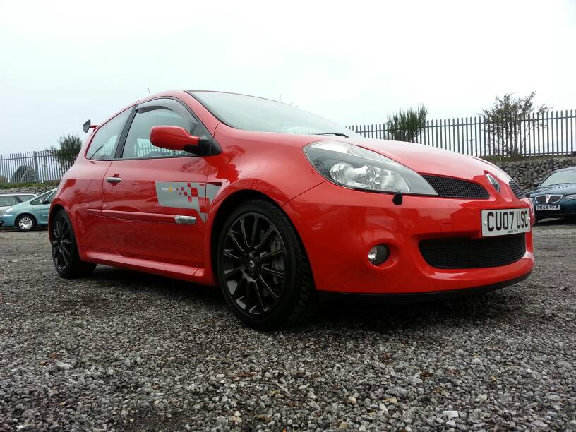

Here's the car :)

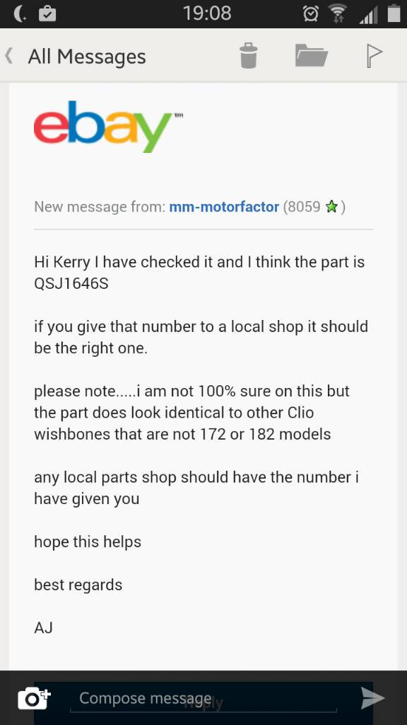

Just had a message from a seller on eBay and he thinks that's the part number for the ball joint I need. Can someone confirm this please ?
