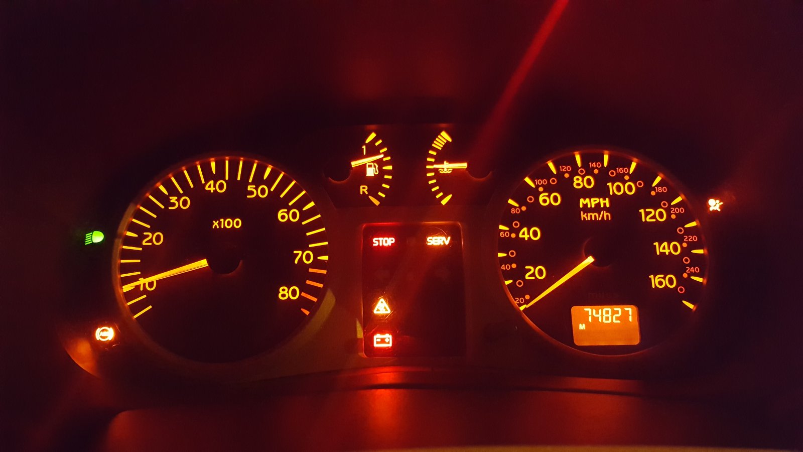

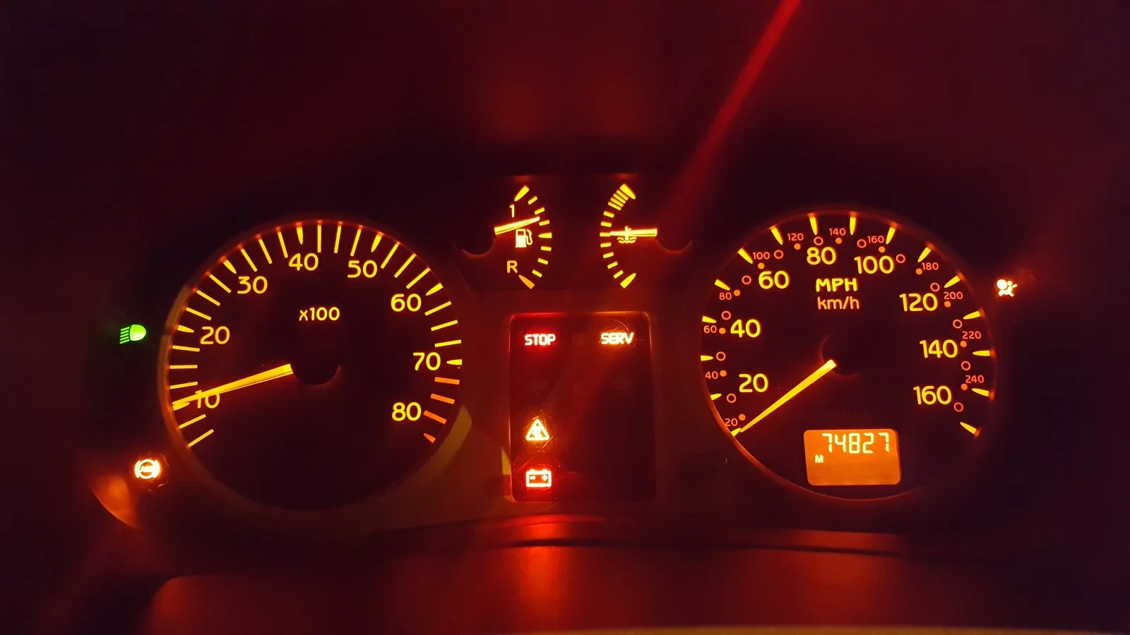

the clio has now started to go abit strange for no reason?
STOP & BATTERY started flashing 4 weeks ago and all lights are now permanently on!!
abs - airbag - esp have all illuminated today
my windows no go really slow?
and my auto headlights are working for 1st time ever?
if anyone can help I don't know where to start I would happily pay a member to come have a look and drive tomorrow lol
thanks

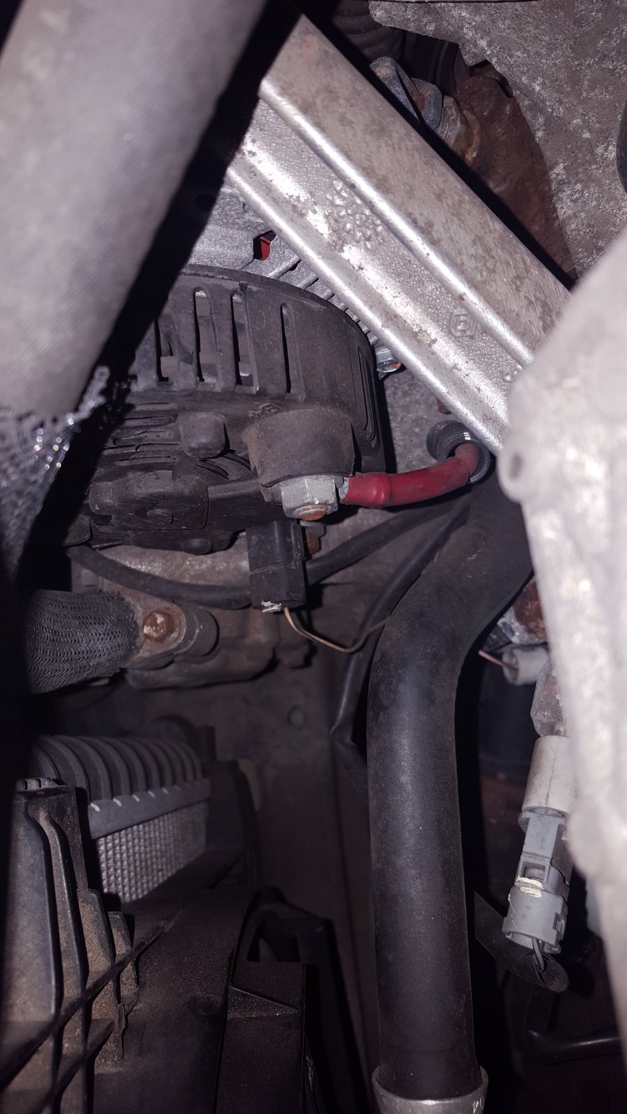

Alternator or the wire like james said. I had this on the way back on the motorway in the rain from doing Oulton park with four people in the car. It was not fun when the Windows went slow, lights dimmed and eventually cut out. Wasn't the best of days. Get it checked asap

Did you google that pic? But yeah pretty sure that's the one. It was a while ago since mine went
  clio 182
no that's taken fresh from the hard shoulder of the m42 haha.
I'm trying to get booked in at diamond motors for cambelt water pump and spark plug service etc and now typical this has gone wrong lol
  clio 182
could the internals of the alternator packed up? the big red lead is solid on and no movement in it?
