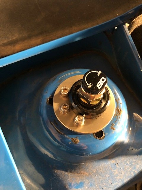

Hey Guys
I have BC top mounts fitted to my BC coilovers, fitted them and everything was fine, had to remove them and since fitting them again I can hear what feels / sounds like the top mounts are loose when say moving around a bumpy car park, driving at speeds is fine, ive loosened off the the 3 allen key bolts that hold the top of the mounts through the strut towers and retightned them but something still feels loose, any ideas? how do the tops actually come off if i pull on the adjuster knob will it pop off with out damage and then can i simply tighten them back down with 2 spanners or do they not work that way?

adjuster knob I think is held in place with a small grub screw.
I would be stripping the top mount down, checking the bearing for wear and play. They wear out eventually - especially so as bearings prefer a verticle orientation for longevity(but I'm yet to see that design make its way to any coilover and top mount setup at the front :D)
they only have maybe 1000km on them, I installed them couple of months ago and had no problem, I had to remove the coilovers to have them modified to fit the roll correction kit on and figured easy just to remove the the coilover and top mount together. I did have a bit trouble when I put them back in to have the top plate to sit flush on top of the strut top but i loosened the top plate a couple of times and ended up getting it nice and flush,
Car was fine for the 1st and 2nd session at a track day and noticed after coming in after the 2nd session something sounded a miss.
can anyone correct me in the correct / best process to fit the coilovers and top mounts for future? is it fine to jack say the brake up to get the coilover into place before securing the top mount or better to basically pull the coilover up while tightening the the top mount
