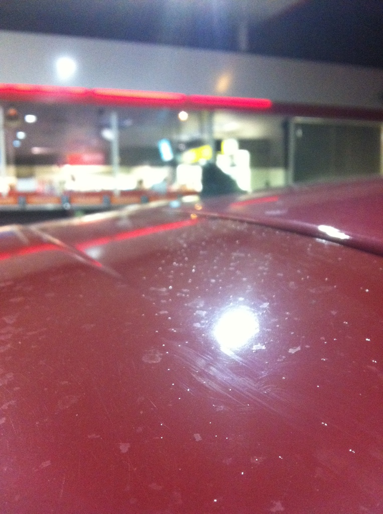

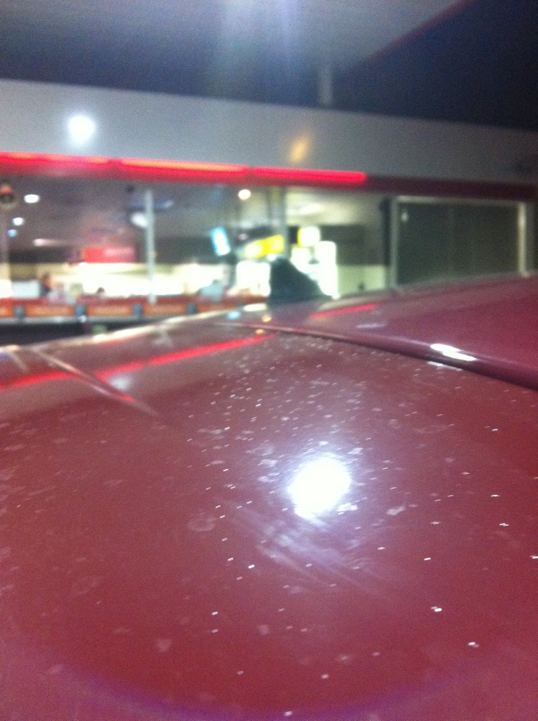

Noticed this
When I was getting petrol, this was immaculate when I had it colour coded, does anyone know what this is/what causes it?
No big deal though as I've got a cup spoiler to go on in a couple of weeks :)
Edit, iPhone pics, not the best. And excuse the dirt!

Looks like silicone under the paint causing tiny pits
Edit: I was looking at the water on it, haha! It could be dirty water stains

Laquer is coming up, My whole car has done this, Basically when something has been resprayed and a layer of moisture gets in-between , Well so i was informed by the bodyshop.
  172 cup
I had this one an l200 tailgate I had sprayed,bodyshop put it down to moisture in the primer.
That's not water lol! Thats the bumps! Unless you were talking about the watermarks.
And from what I gather I'm fucked lol, I've had my bumper done by the same bloke! :( damn

Looks like silicone pop to me to. Probably from some dodgy products in the garage mate.
Only has to be in the air for it to ruin paint.
  Astra GSI, 172, Golf
can be the start of lacquer peel.. or trapped water from waterbased paint not been thoroughly dried before lacquering.. whichi will normally lead to lacquer peel anyway
or are you on about the bright smaller more white marks ?
