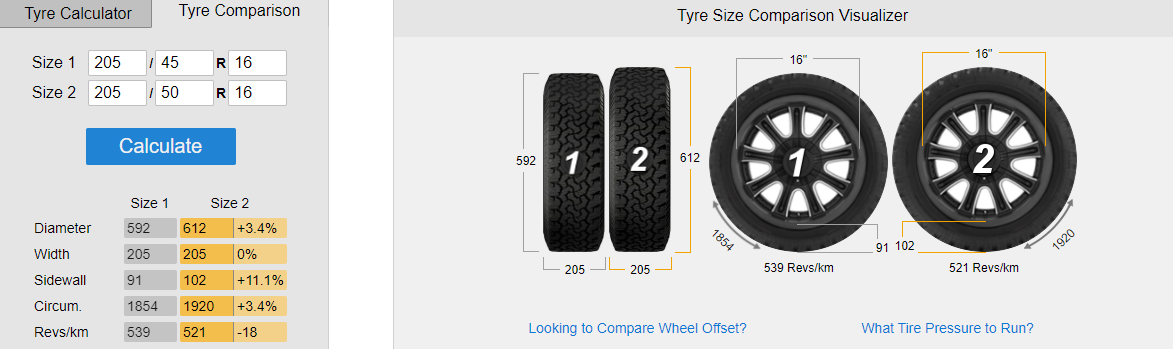

Thats a great idea! Yokohama A052 seem to be very good looking at the reviews. Will I get away with running 205/50/16 instead of 205/45/16. Thanks
frayz
You'd need to bump up to a 205/50/16 but Yokohama A052 is the best road tyre on the market currently. Quicker than most semi slicks in the dry, yet are comfortable, progressive and work from cold. They are also decent in wet conditions.

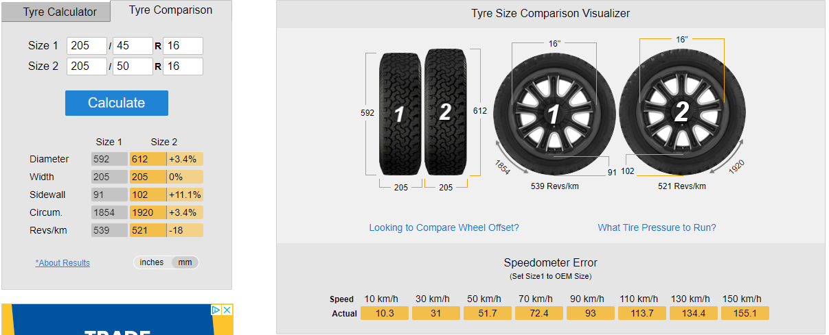

I considered this but im only just getting away with a 45. A jump to 50 and they will be catching. :(
205/45/16 to 205/50/16 is a 20cm difference in height. If running stock Trophy Sachs dampers you should be fine.
  182 Trophy
Cheers guys. Just a note to add .. I am running Mark Fish Springs which lower the car by 15mm

Anyone know either the a052 in a 205/50/16 will fit with sachs combined with Eibach Sportlines? As they give a 25-30mm drop?
