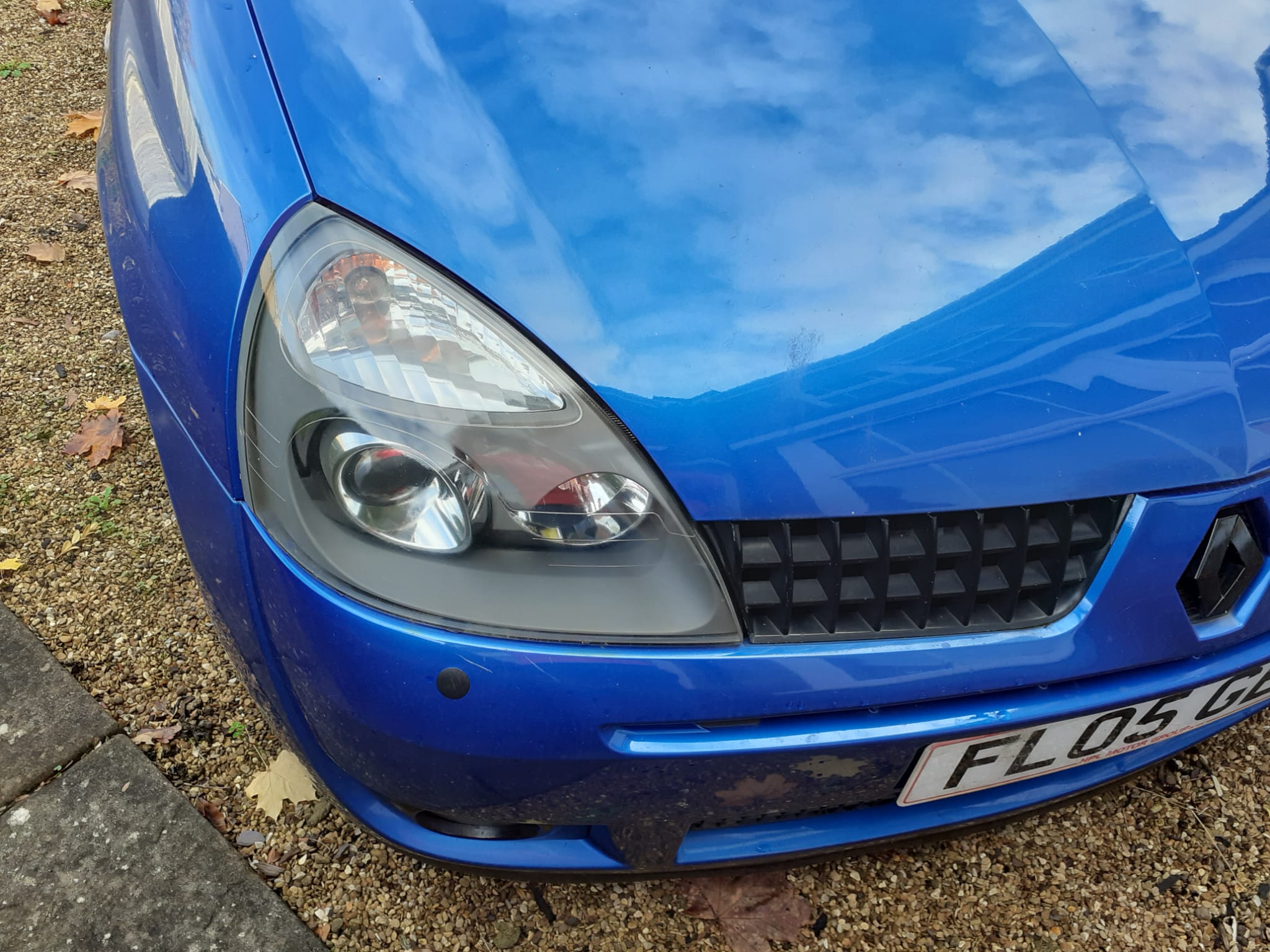

1500 wet and dry, 2000 wet and dry, machine polish with some compound, et voila;
Cheap chemicals, wipe on and wipe off. £20 and takes about 15 minutes. Doesn't last more than a few months, but there's enough in the bottles to do it a few more times. Would probably last longer if you coated the lenses in something afterwards though idk
