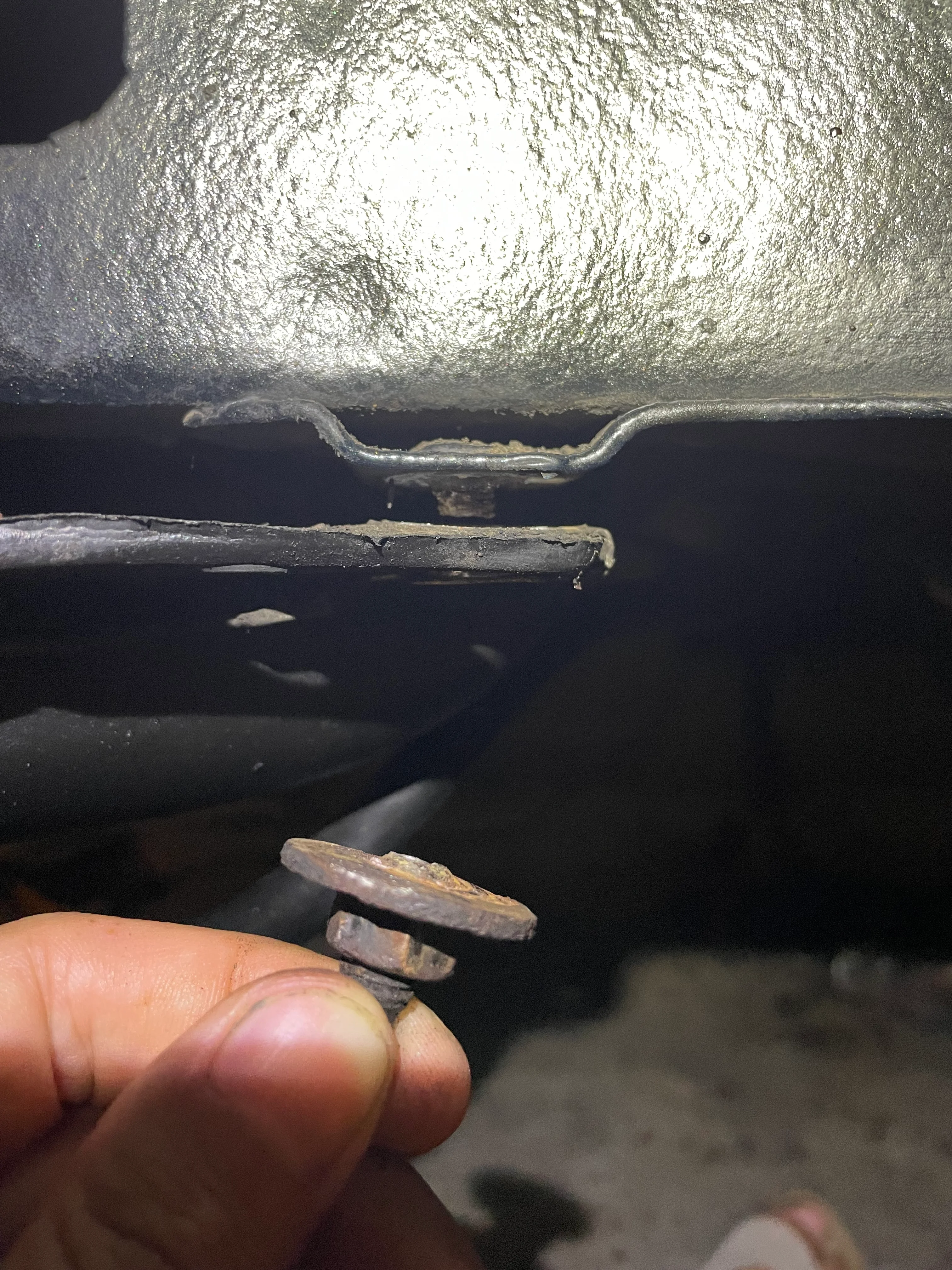

Hi all, I’ve started restoring the rear underbody on my pb Clio 182 and one bolt has snapped — the one holding the fuel filler neck. This is a bolt that appears to be fixed (welded?) to the offside rear chassis beam. I can keep working for now, but I’m unsure how best to fix it when rebuilding. Has anyone had this happen or know a good way to repair the joint?

It looks to be a welded stud. Weld a new one on or drill and rivnut/short bolt
Thanks Brigsy. I was thinking about rivet studs as well, just not sure there would be enough room between the flange and the chassis beam to install one.
