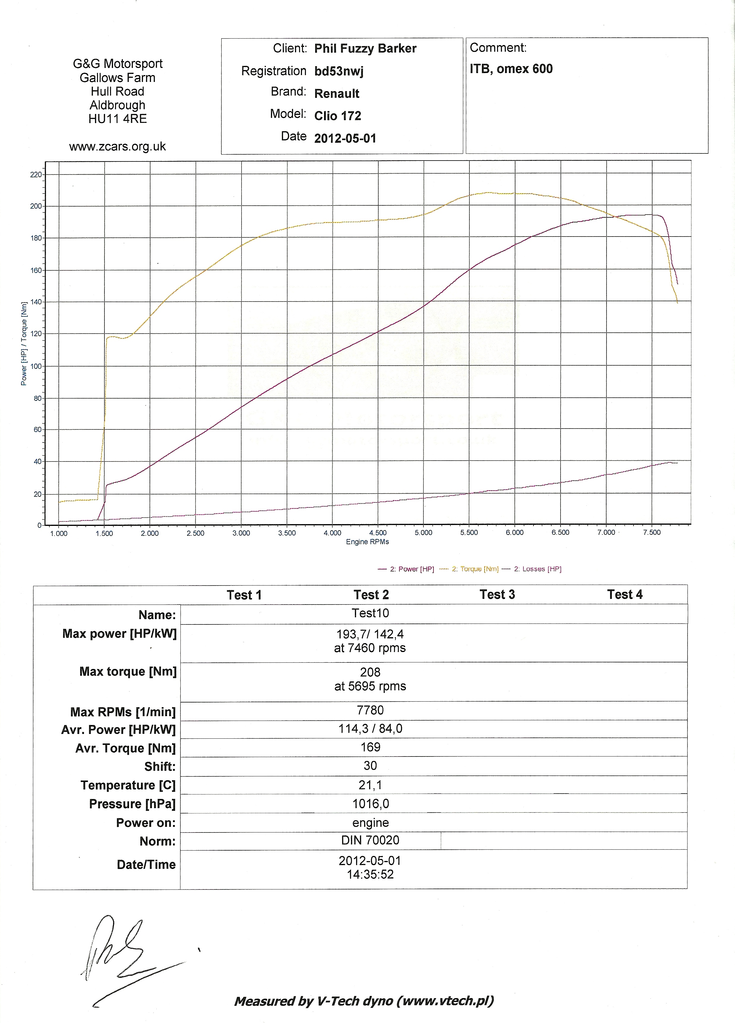

What power does yours make? Really like yours
I didn't have a single dash light on, and my functioning dash and fuel computer showed me 35mpg most of the time
You got a power graph of your car Phil? Interested to see the curve.
Yeah...

Cams do get close to itb numbers, but I wouldn't say 90% - thing is people get so hung up on peak figures they dismiss the massive gain you get at lower revs.
