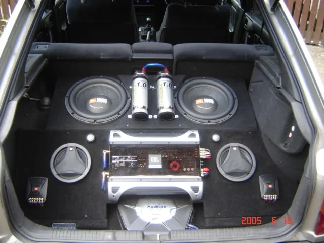

That has to win an award for being the most hideous install i have ever seen!!! PMSL. Who did that??
PS- WALLOP, do you know jonny from BBG??
  1.2 Clio
Looks ok to me, apart from the co-ax's, but at a show open that bad boy up and pull the crowds easily suppose! ;)
As the subs are sealed they already have something to load onto, so can boom with boot open!
  Mk2 172
Yeah its the components in the boot that concern me. and i have to be honest i cant stand when everything is on show. Looks so cluttered!!!
With regards^^; I actually put that together in an afternoon of madness, it has undergone many upgrades over the last few years in respect of kit used but has kept the basic layout....
I don't personally know Johnny from BBG mate....
With regards^^; I'm not one for sticking to rule books or other peoples opinions on whats right or wrong when it comes to my own car stereo....
The stereo in question needs to play with the hatch open for extended periods, hence the need for boot mounted components....
It is also used on a regular basis as a teaching aid for newbies, I find it far easier to give a practical hands on demonstration of each control function than to simply explain and send them on their merry way....Hence the reasoning behind keeping everything on show & accessable....
We can all blabber on about crossover points & roll off slopes or using a 1khz 0dB tone on repeat to set gains, but I can actually demonstrate the difference each adjustment makes....
Xplod amp makes me feel a bit ill

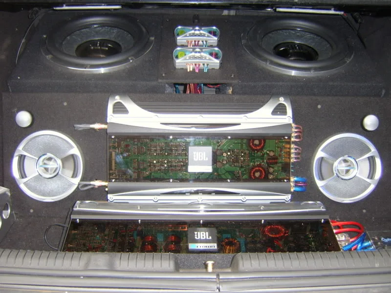

X-Plop amplifier was used for around 2 weeks, then it was replaced by a JBL GTO1201 which was subsequently replaced by a JBL/Crown BPX2200....

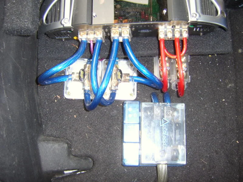

Currently undergoing another upgrade to increase the overall impedance the BPX2200 actually sees from 1.5ohm to 4ohm, (2 GTi subs to 3 GTi subs)....
Most recent pics from last year;
BPX2200 parallel bridged configuration
Boot showing GTi subs, Infinity Kappa components, PX300.4 & BPX2200
Please feel free to diss the design or kit used, I like a little mickey taking, brightens my day.....:cool::rofl:

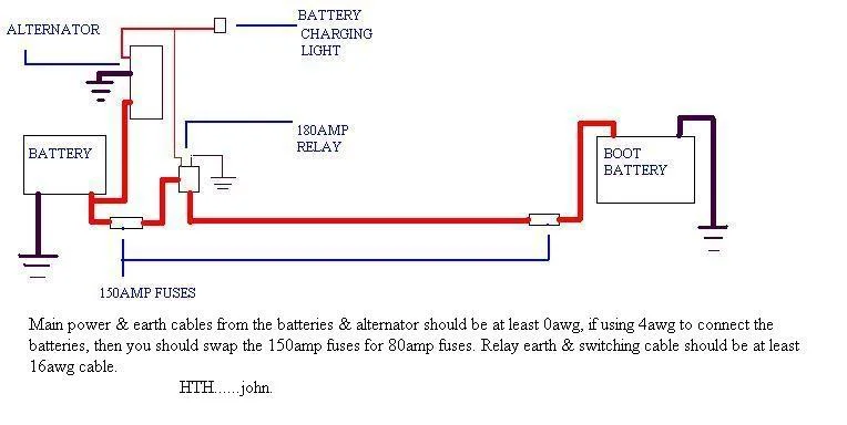

With regards secondary battery wiring;
You have two options;
Connected directly to each other in 'Parallel', which would require batteries of similar type & age, using 0awg cable fused at 200amps....
Use this method if you plan on only using your stereo with the engine running....
Split-charged, this method is best if you plan on running your system for extended periods with the engine off, it is also wise to use this method if different types of battery are being used, (lead acid starter battery with deep cycle gel battery in the boot)....
With regards Amp choice; I personally would want around 2.5kw rms for a single HCCA sub....

Okay so if i wanted a second battery installed i would go for the second option personally. And all i would need is a relay connected between the two batteries and alternator. Do you fancy wiring it all for me haha i could do it the basics but it so much better when someone who knows more then you can help. I have learned alot about car audio but there is still so much i dont know, but thats for another time. Do you really think i will need another battery cant i just get a heavy dutty battery and some caps?
  vaux cavalier
With regards wiring;
The split-charge wiring is extremely simple to do, on most Alternators there are two wires, the larger diameter cable is the charge lead, the smaller diameter is the Batt warning light sense lead, simply remove the connector off this lead & replace with a piggy back connector, (if its a ring terminal then simply use a ring terminal for the relay switching lead), then connect both as normal....
The actual split-charge relay should be located within the cars cabin to protect it from the elements, so you could take the relays switching feed from behind the dash if you find this easier....
