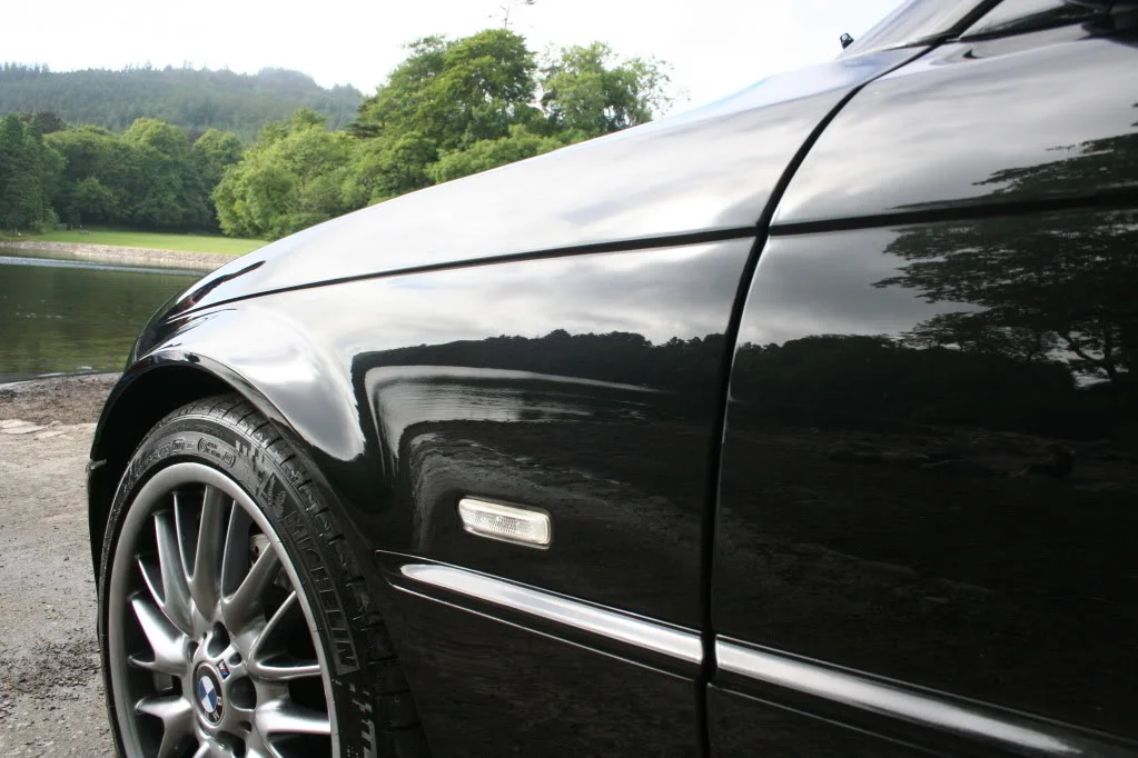

3m Fast Cut + by rotary on a 3m green pad. Then refine with Menzerna! and you get this:

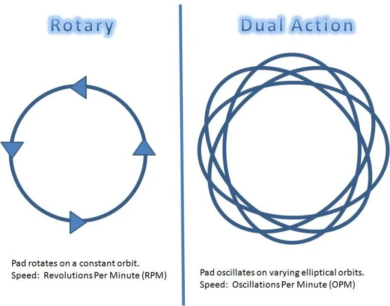

If you do get a Rotary, get some scrap panels to practice on 1st. If you don't learn to use it properly you'll make the paintwork more hologrammy. Or worse still buff through the paint.
  145db Euro'd clio
okay sorry i got confused. its a rotary polisher. are they really that difficult to use? seen people using the and they dont look overly difficult i thought you had to just keep it moving and keep the mop wet/damp to stop you from melting the paint?
  Civic Em1, Civic Eg4
And you dont have to press down on the polisher a huge amount. With a rotary polisher i would definitely step up with different types of pads starting with a softer pad first instead of jumping in the deep end with a aggressive pad and polish with a big cut.
  Megane 225
Start on a very low speed (as low as it goes) to spread the polishe. Build up the speed, I rarely use it above about 2.5/3. Keep it moving so not to rub through. Finish on the slowest speed to burnish/refine the finish to a better shine. Start with a light polish and pad combo and work up until you get 1 that works. A lcc white pad with Menzerna intensive is a good comb, then finish with Final Finish on a lighter pad. The key is to work the polish to break it down. TAKE YOUR TIME. Oh and don't wet the pad.
