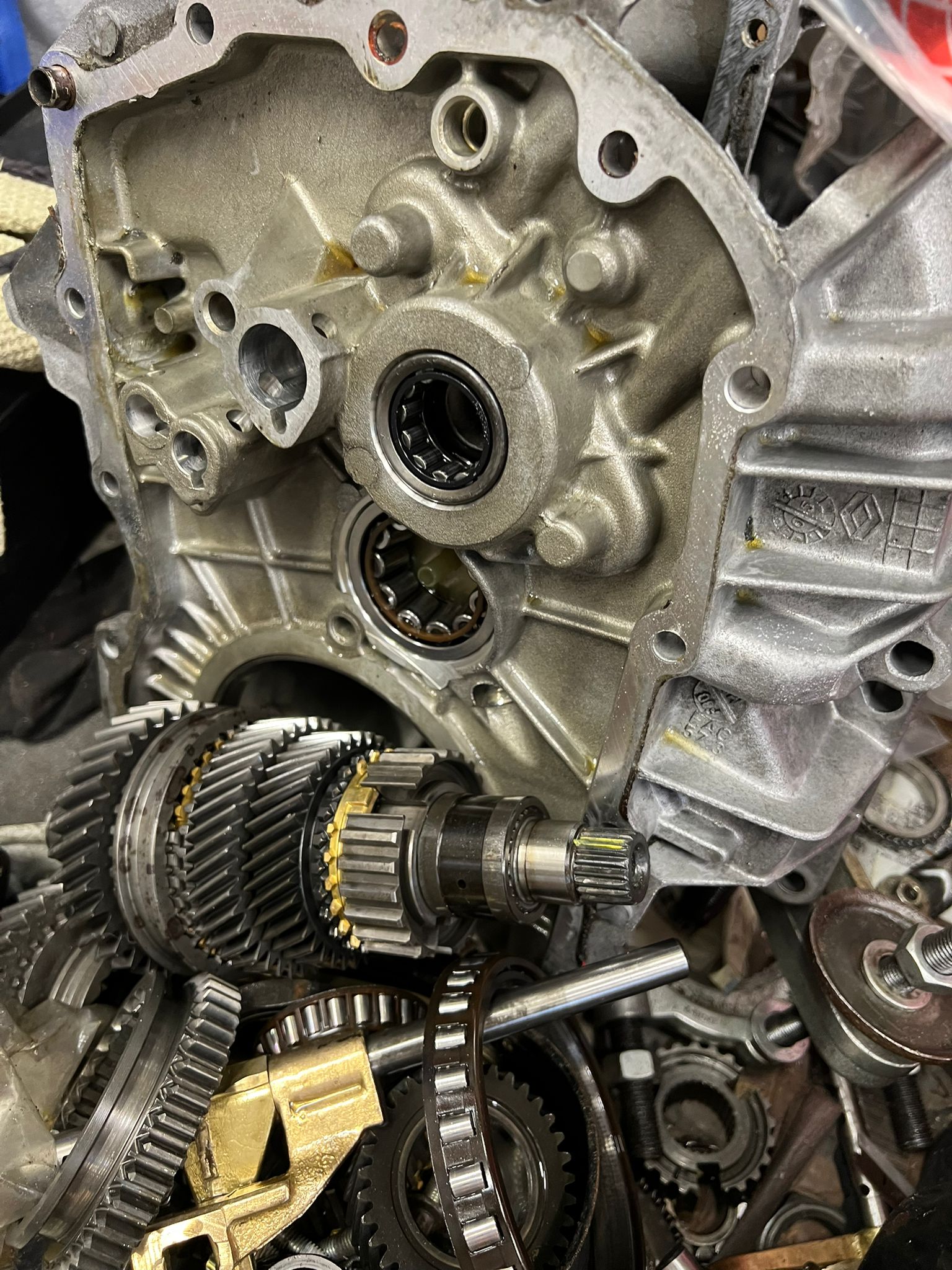

Shafts are definitely different. You might be able to build up some from the renault parts bin though.
I ran a Jr5 modus diesel box in my Twingo.... long but great for big power and top speed runs. Fitment should be the same as the Twingo box though.
Hydraulic clutch actuation and cable shift, shaft fitment is also different, they have the more modern style inputs into the box rather than the bolt in spider gear style of the jc5
Was that with a F4RT block? I cant remember if they are the same bolt pattern as the F4R to mount the box to the block but suppose it wouldn’t be the end of the world to tap a couple of bolt holes as long as it lines up reasonably well.
Theres quite a bit of overlap with the twingo stuff so could maybe use twingo hubs and shafts on the Clio. Or go imaginative and fit the Clio outer CVs on the twingo shafts.
The JC5 I’ve got to fit is a DCi box. The standard 182 ratios are fine for revving the F4R when it’s NA but longer ratios would suit the turbo much better
I modified my f4rt back to the f4r gearbox bolt pattern.
Ah perfect. So in theory then a jr5 should bolt straight onto a 182 block?
If that’s the case it’s just the cable shift (reasonable f**k on), shafts (potentially massive f**k on) and hydro clutch (minimal f**k on)

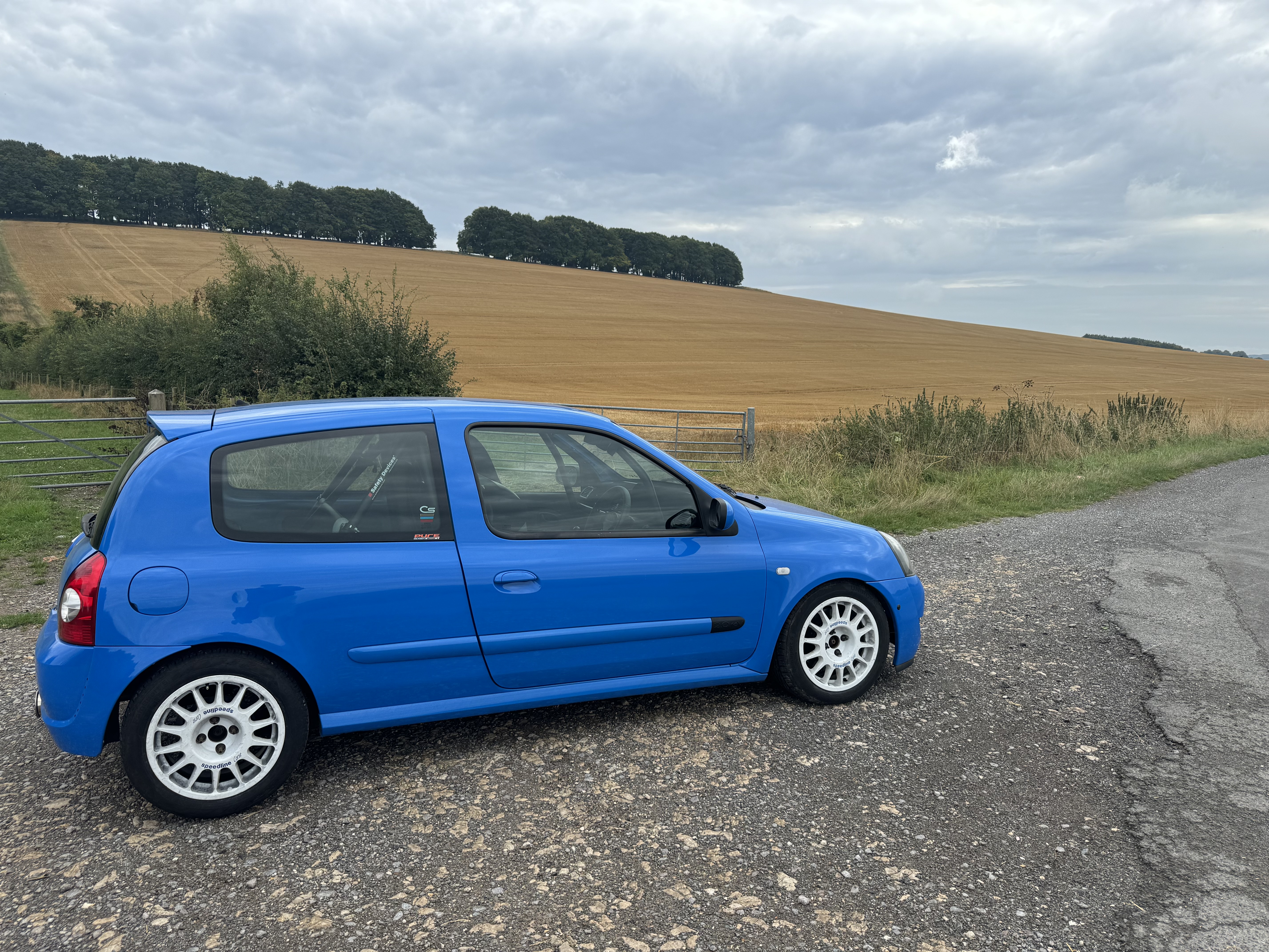

So after my petulant outburst months ago when I thought the gearbox had shat itself again, yesterday I decided to actually look at the car to see if it was indeed knackered.
Taxed it yesterday and drove it up the road, little noise heard but nothing like before very odd. Eventually I came to the conclusion it was a heat shield resonance at certain RPM and certain throttle inputs. Got back to the unit did some adjustments, drove it again silent! (As silent as a track car can be!) not driven it for nearly 5 months because of a heat shield rattle.
Changed the gearbox oil for good measure which wasn’t that bad either.
Took it to west berks car meet at renegade brewery today, did 40 miles no issues at all!
