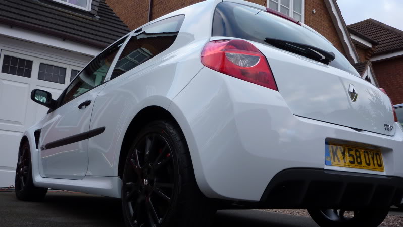

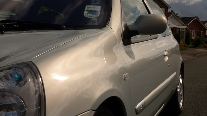

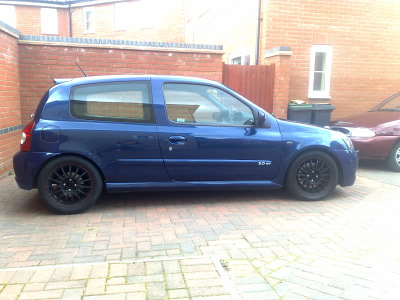

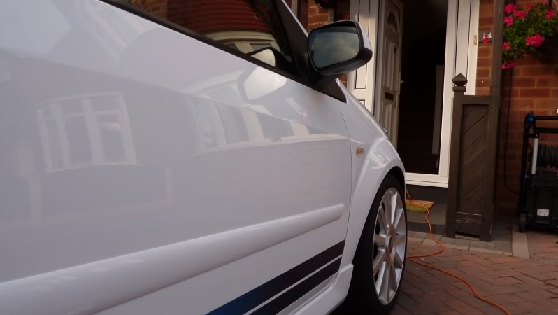

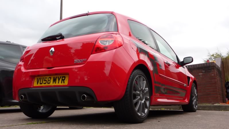

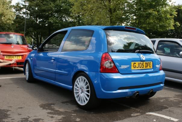

Few pics for you:
- Polished with Menz 203S, then Zymol Vintage
Dodo Lime Prime then Supernatural:
Britemax 4/5/6
Lime Prime and Supernatual:
Lime Prime and Supernatural:
Blackfire Kit
Britemax 4/5/6
Megs 205 > Z HDC > Glasur
Lime Prime and Z Glasur
