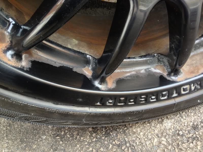

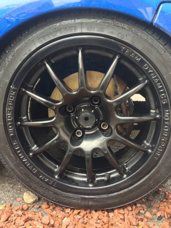

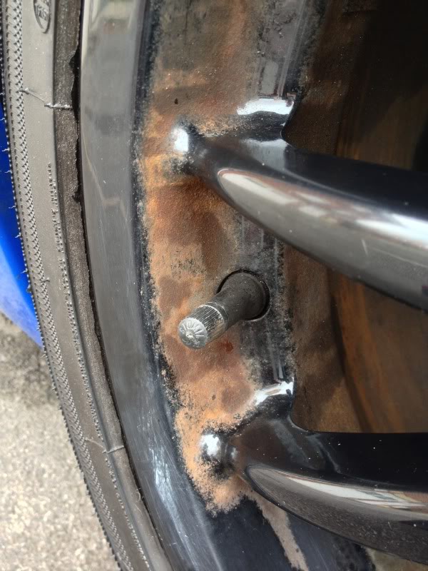

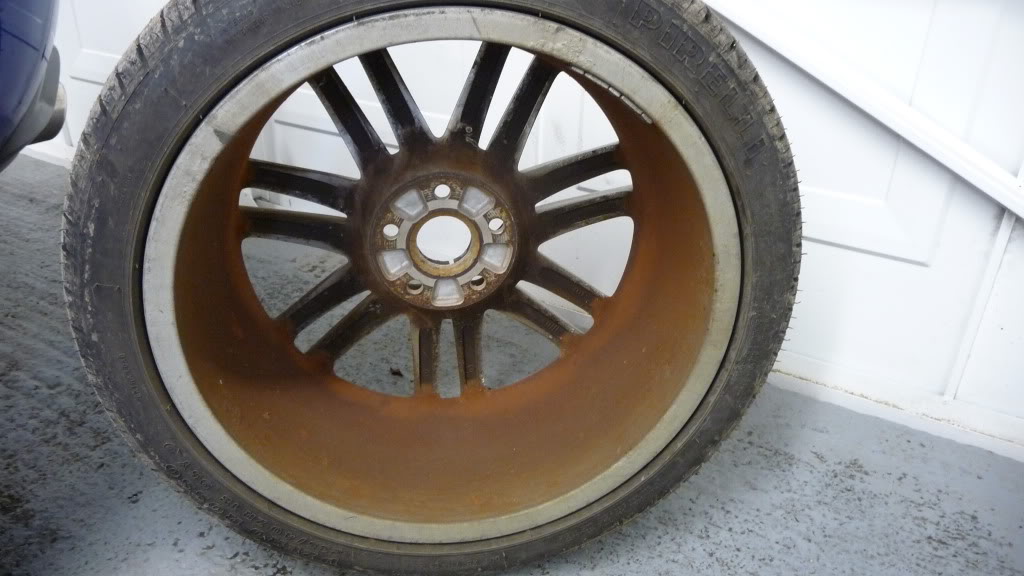

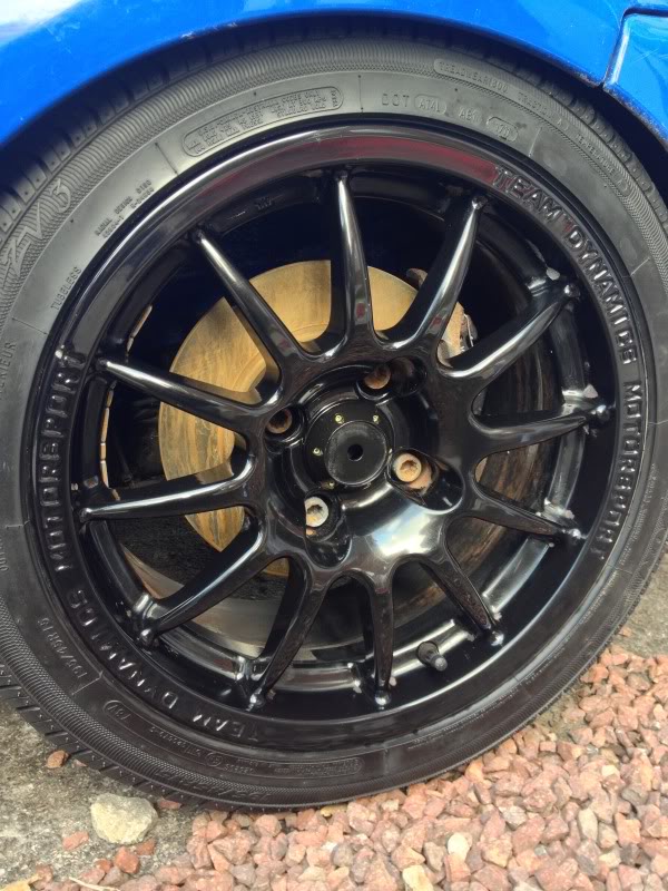

The previous owner of these team dynamics pro race decided to run with no brake pads for a while and as a result this happened;
Any reccomend me a reasonably safe way of getting this stuff off? I've been working at it with the abrasive bit of a kitchen sponge but its taken me nearly an hour to get to this stage;

Iron Cut.
Actually Id go get some of that Wonder wheels (The one thats red in color) that removes fallout.
Lots of it.
Id rather get those refurbed though.
  Fiesta ST-2 Finsport
One of my customers had a seized rear caliper which did the same.

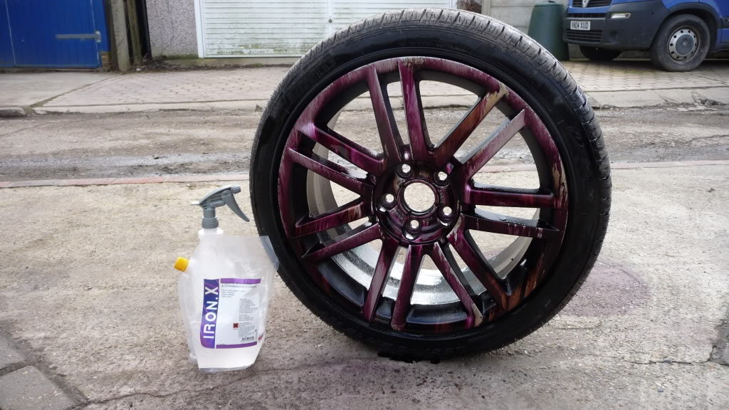

multiple hits of iron x (a whole litre was used and whilst it was massively improved didnt make it mint
i would suggest maybe acid first then iron x, if not its refurb time

It wasn't a bristle style pad and polished up alright as you can see in the pictures.
Iron x it is then!

On a wheel like that I'd reach straight for an acid based wheel cleaner. I wouldn't waste my money using iron x as would need multiple attempts.
Just be warned that acidic wheel cleaners can / will cause damage to the paint if the finish isnt in good condition, ie curbed etc. don't leave it on too long or let it dry and rinse very thoroughly

serious now coca cola works wonders if u can soak it in overnight . dont know how tough this will be though but worth a shot surely ?

As mentioned, I'd be hitting that with some acid. Don't scrub/agitate it though, as you'll scratch the fcuk out of the wheels.

Thanks, I ordered some acid based shizzle so will try that.
As for the Da, are kid actually had one so have been using that and there seems to have been an improvement.....slightly but thanks for the offer.

Get them finished and polished up and seal them properly, and never have to use more than shampoo to remove anything.
Gally
The wheels also look matte black now. Well played.
leeds_182
North Yorkshire & Humber
I knew I should have used the cotton buds and feather duster.
Its still an improvement on rust and like I said was a quick blast so still room for improvement.
