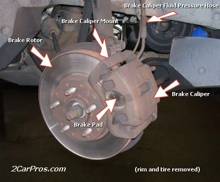

Tried searching for this but no luck, sorry!!! I think my front brake pads need replacing but i'm not 100% it might just be me. What is the best (and easiest) way to see if they are worn and need replacing. Any help would be much appreciated.
Cheers,
Andy
Brake pads look like this, one at the back is new, one at the front is worn away:
The disk brake will look like this
done it and they look like almost new. only had the car 3 monthes its first mot was in april at a renault dealer so no wonder the pads are new! so is it me just used to the brakes now or could it be sometihng else???
