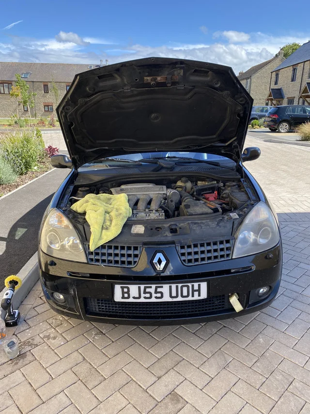

Its a 55 plate, has the hallmarks of both cup packs but I havent measured the bolts into the hub yet! One thing I liked about it was its got a nice service history, people have cared for it over its life. However, it does need work. Mechanically it needs a new exhaust, and the belts doing.

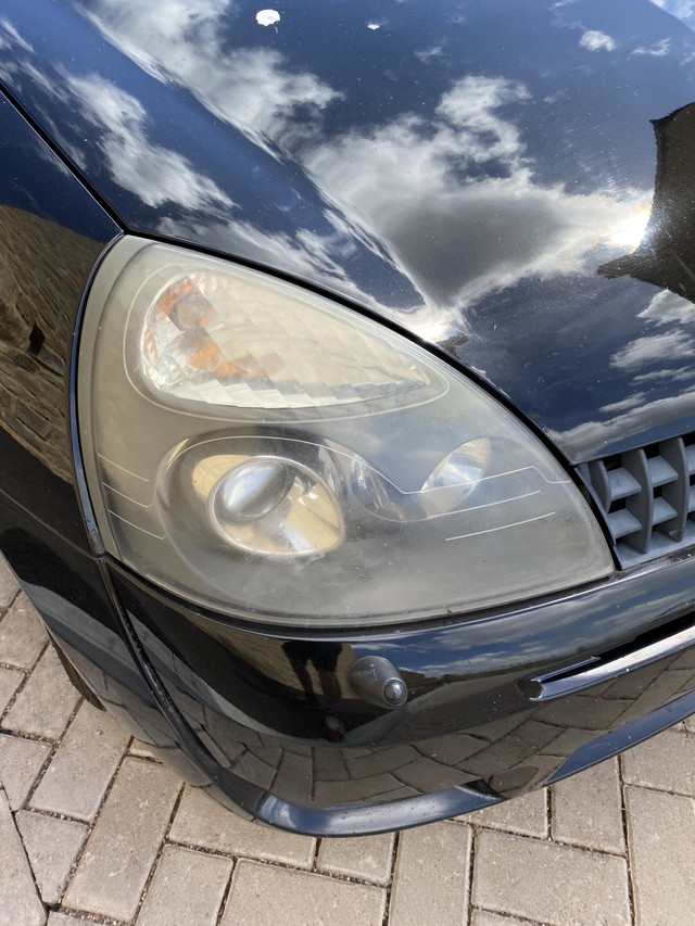

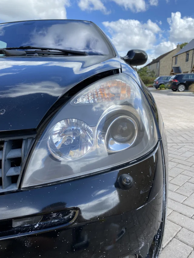

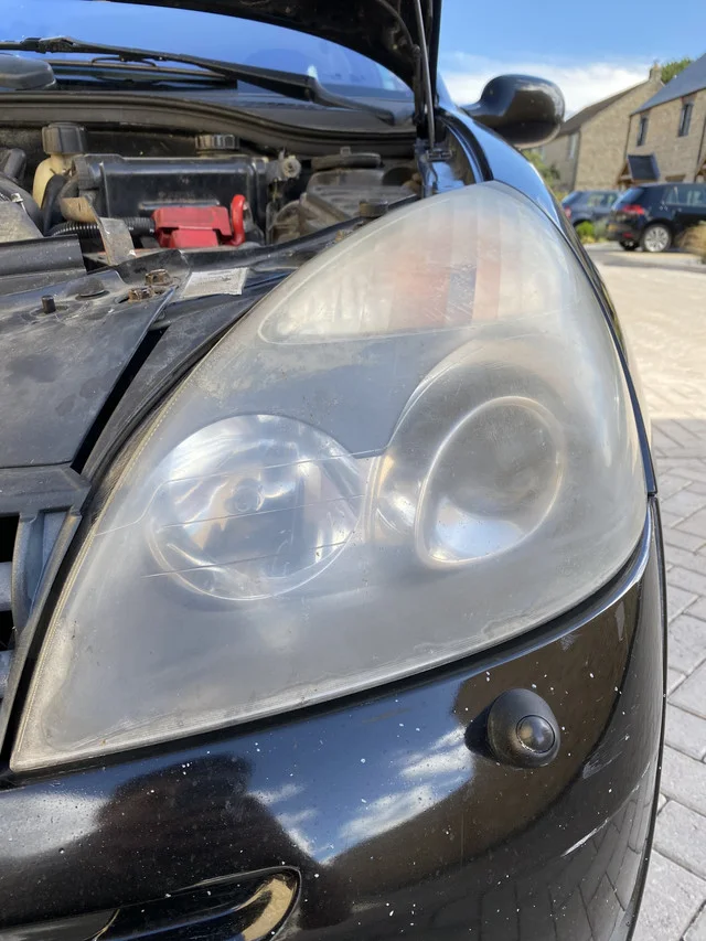

But first, I decided to tackle some of the bodywork. As with a lot of MK2 Clios, the headlights were very cloudy.

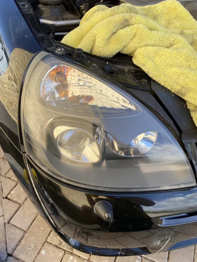

I've used the meguiars kit on a couple other cars (Mazda, Volkswagen). But its never been quite as effective as this, I'm guessing either the plastic is softer on these headlamps, or the hazing doesnt manage to penetrate quite as deep.
Half way:
Finished articles:

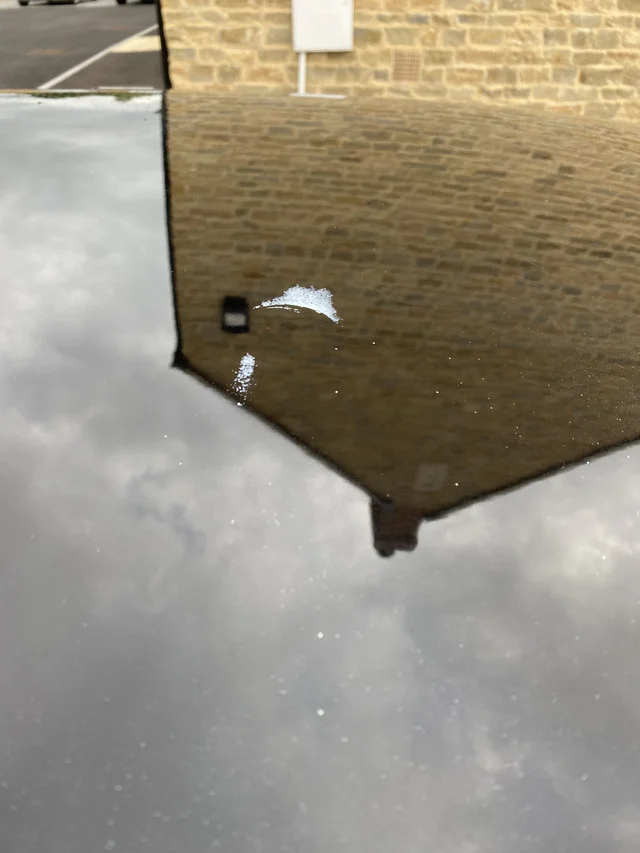

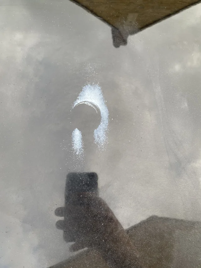

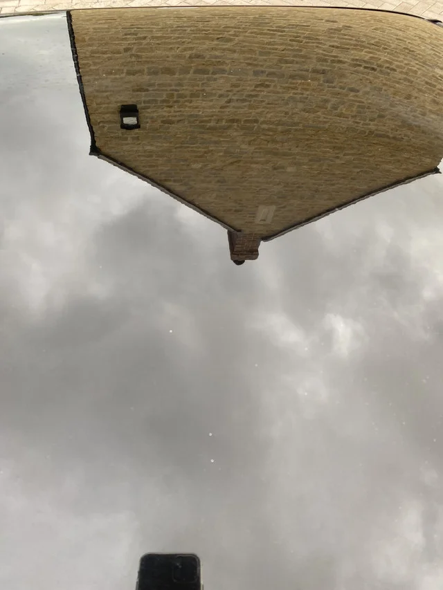

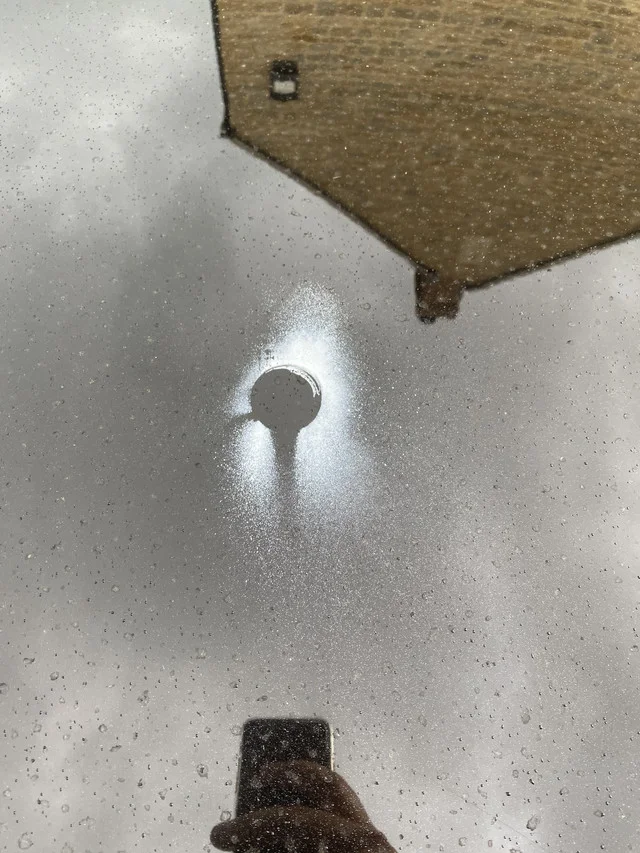

Next job was to sort a defect in the roof. According to the guy I bought it off, there was someone line painting (or something) at a track day. They left a small aerosol of the paint on the roof, and it appears to have burst/leaked all over it.
I started out by claying the area, before trying with my DA Polisher. I used an Orange Hexlogic with a Megs cutting compound. I figured it wouldnt do much, as the paint was flush to the touch.
However, to my amazement, it eventually dissapeared !

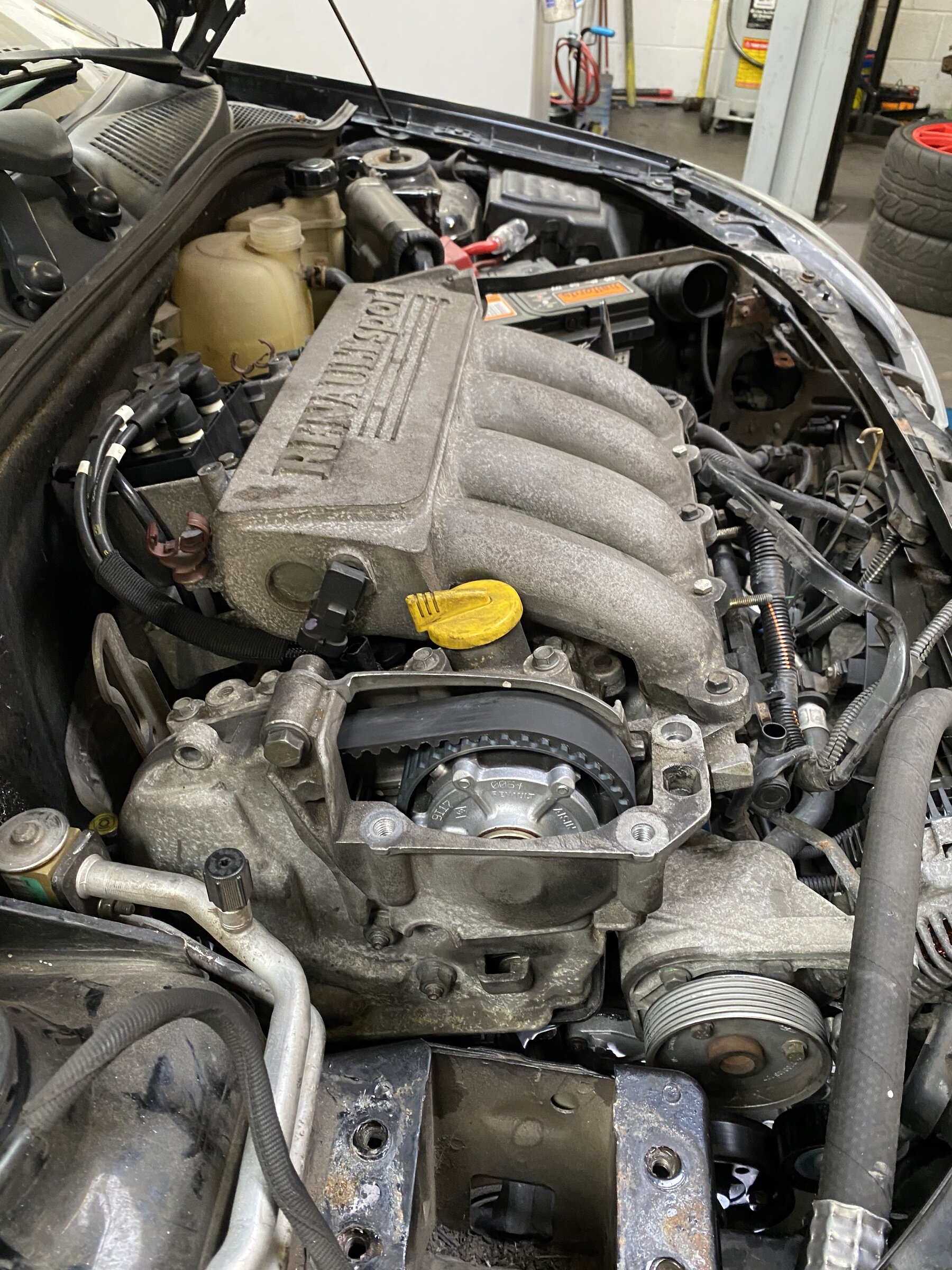

Had Chris at Beaniesport do the belts today! So it’s slightly less likely to start throwing internal engine bits out.
Made a start in the exhaust this evening.Old one is off! Some comedy amount of washers fell on my head, sounded like a f**king winning fruit machine.

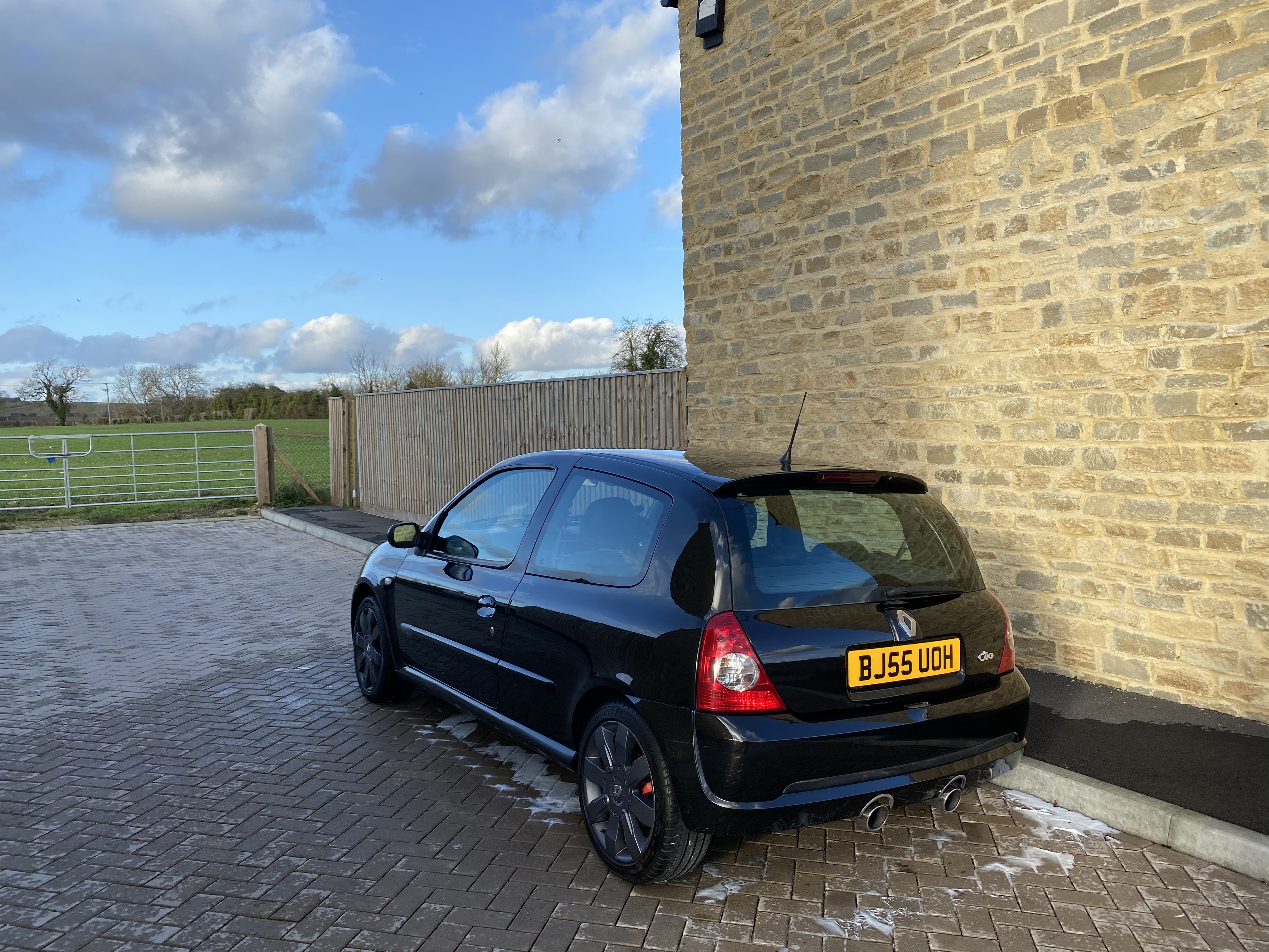

Had a victory getting the stainless exhaust system on last week, so thought I'd contiue the good luck and tackle the wheels...
Auto paint in St. Helens mixed up a tin of the correct wheel colour, spent all weekend getting them sprayed. For a rattle can job it’s okay, but more importantly no more curb marks! And the colour is spot on too.
Also have the obligatory 3/4 front plate, and new front plate to go on soon!

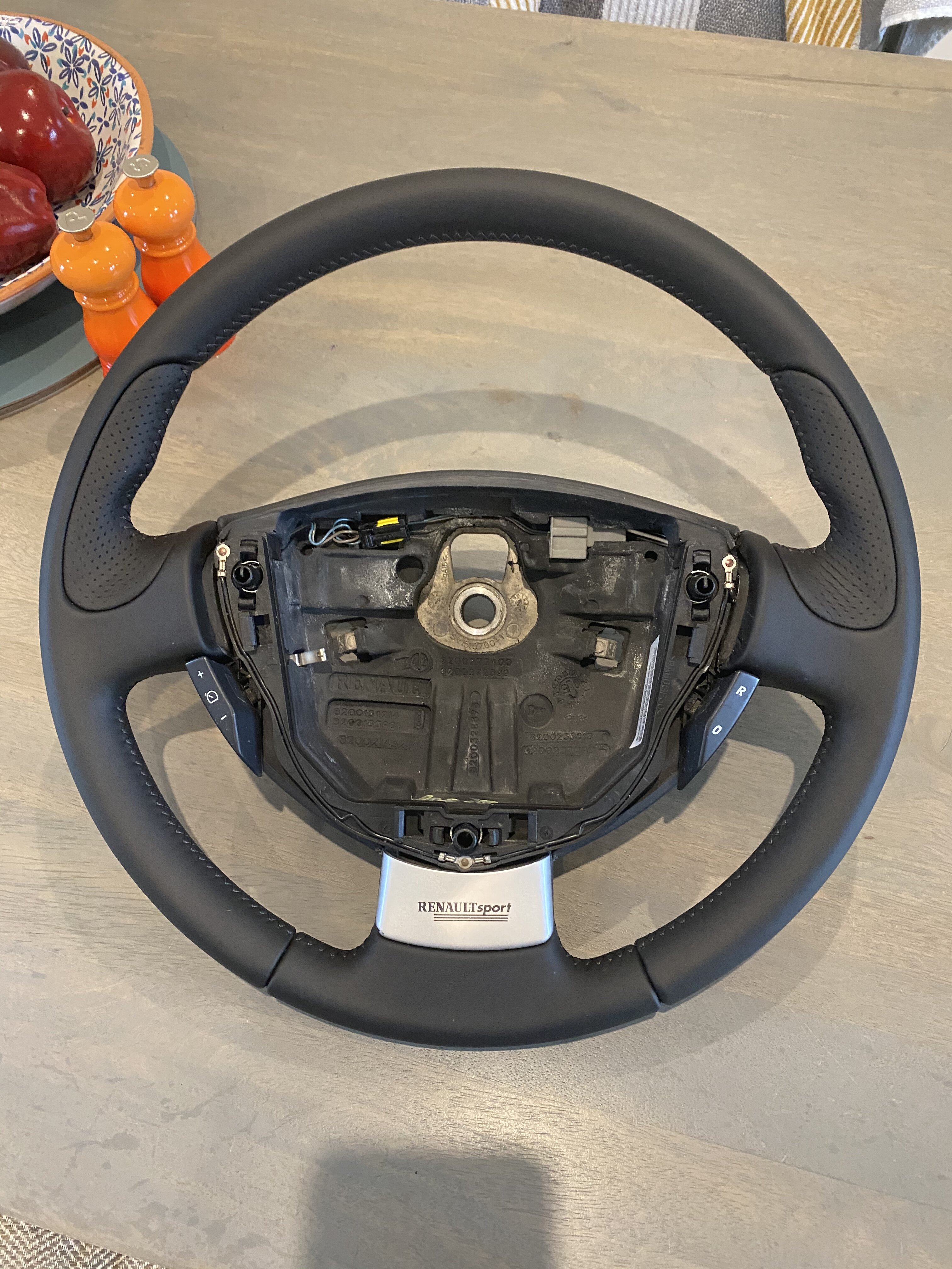

And today, after a bit of a worthwhile wait, my wheel came back from Snappy!

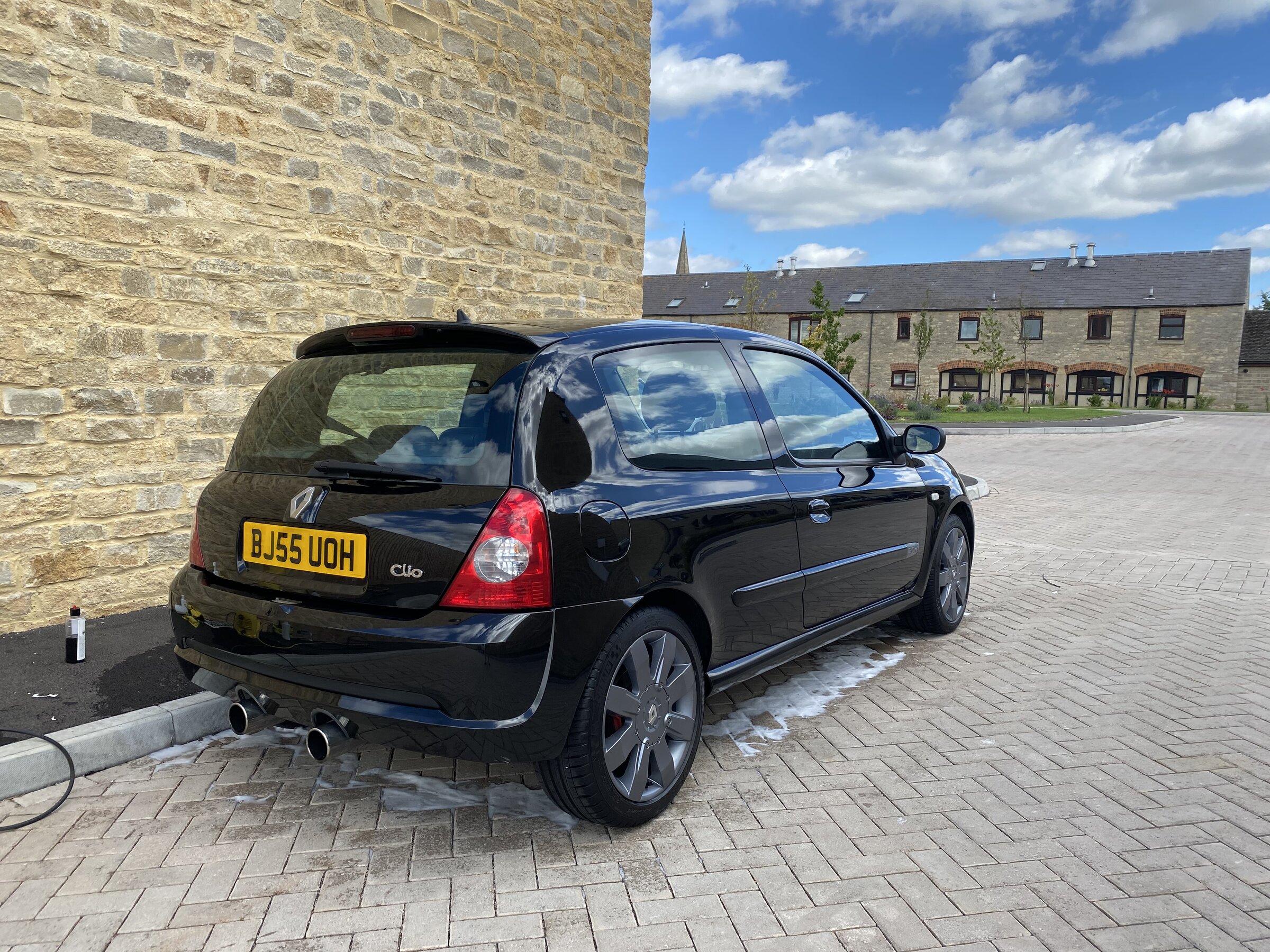

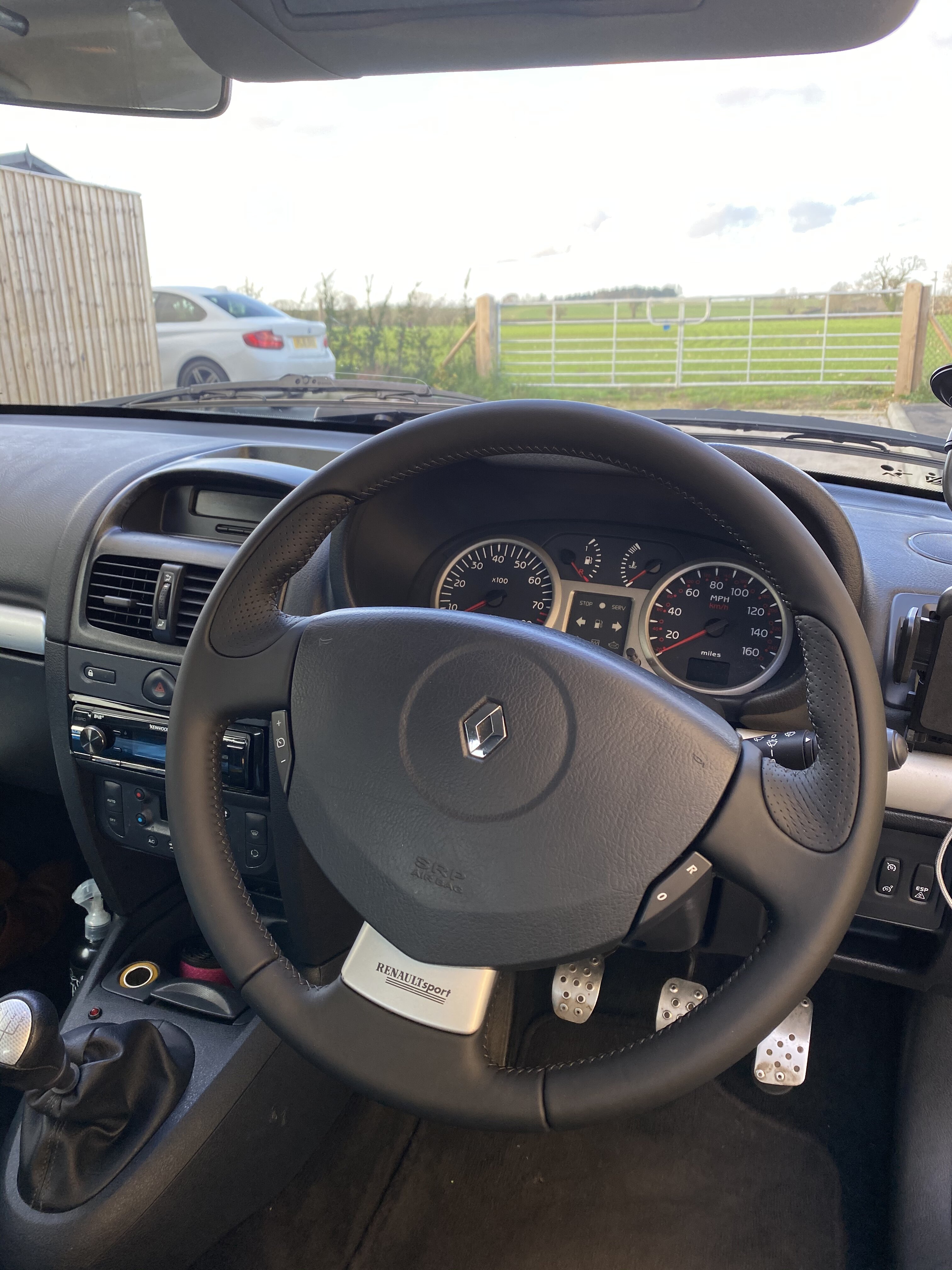

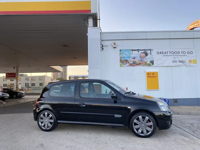

Lots of love this weekend to the Clio.

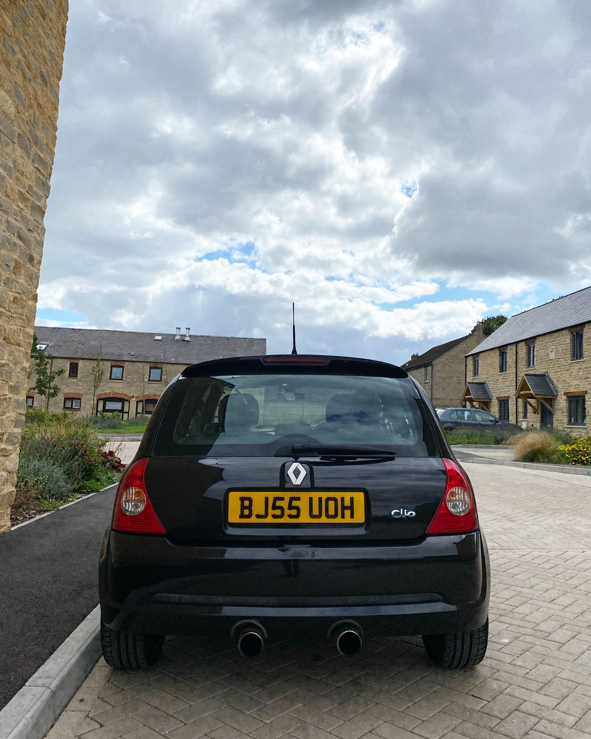

Firstly I fitted the full Milltek system to the car which I’ve had sitting around a couple of months!

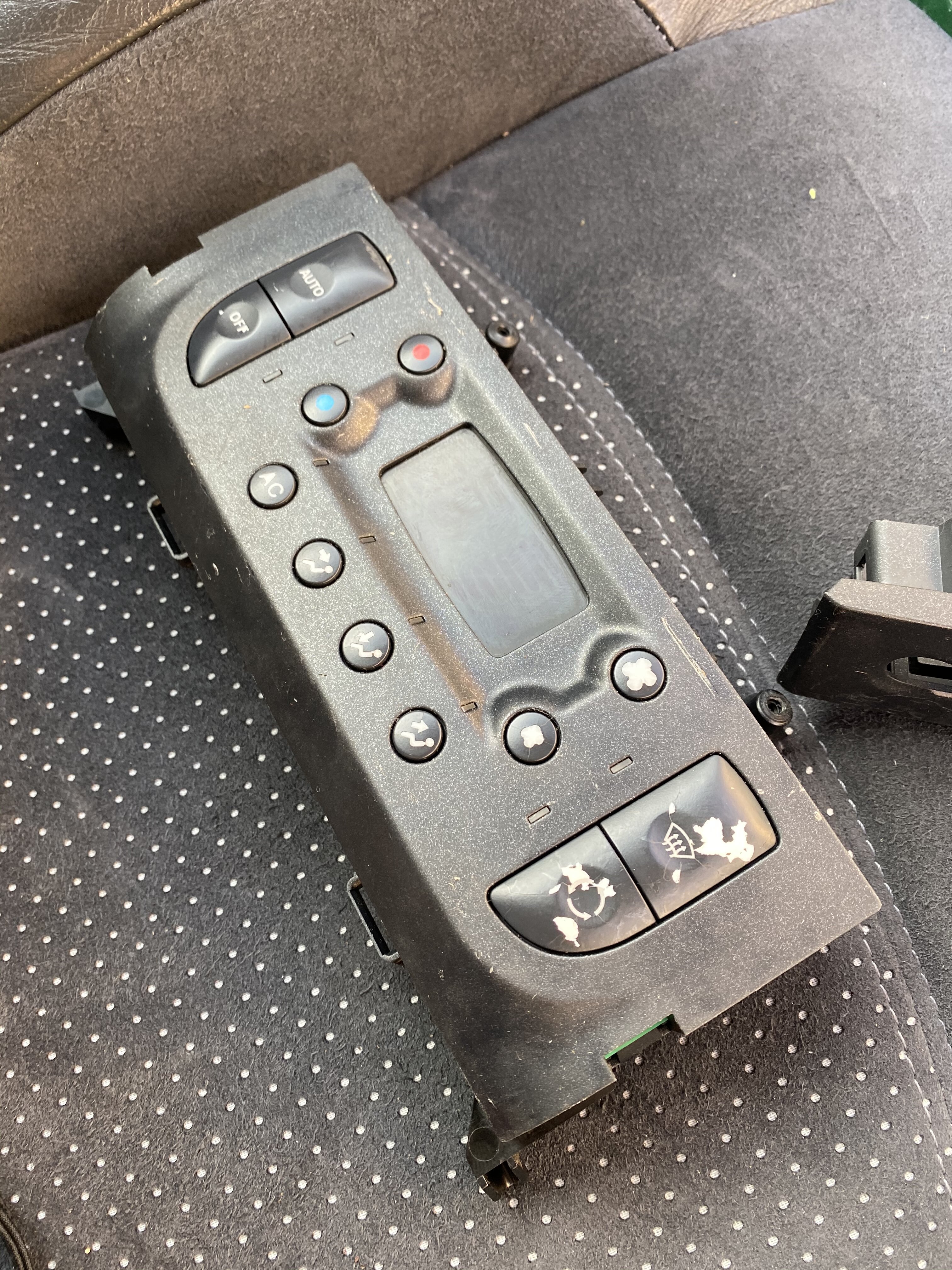

Also fitted Snappy’s lovely work, as well as swapping out the manky climate panel etc for my “de-stickied” spare units.
Finally I swapped the mist washers for standard ones, as the drivers side had clogged completely and it looked odd having a mismatch.
Then a clean!
