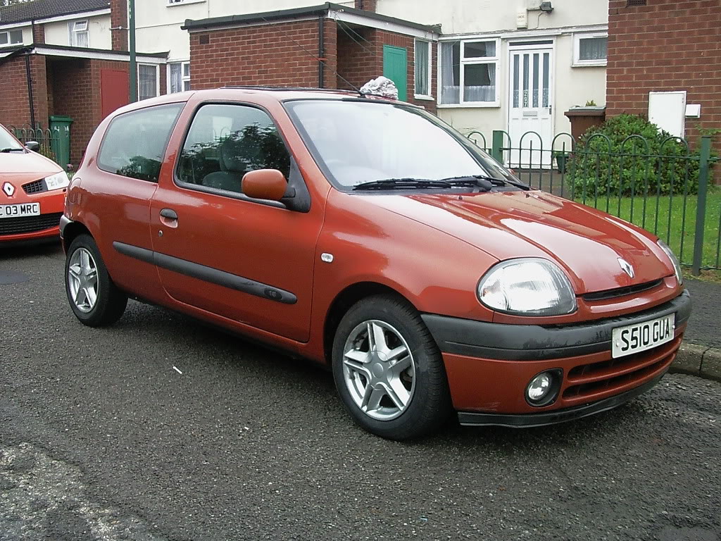

bought the above as a 2nd car / ongoing work in progress - what are the biggest alloys I can get away with - tbh I only want 15" which I assume will fit no probs?? but just wondered what the limits are??
cheers
Rich
you can fit upto 7.5x17's with 205/40 tyres and go up to a 60mm drop with no catching if they are the right off set but they can look too big if your not doing body mods, so most go for 15/16s wich look best imo..........
