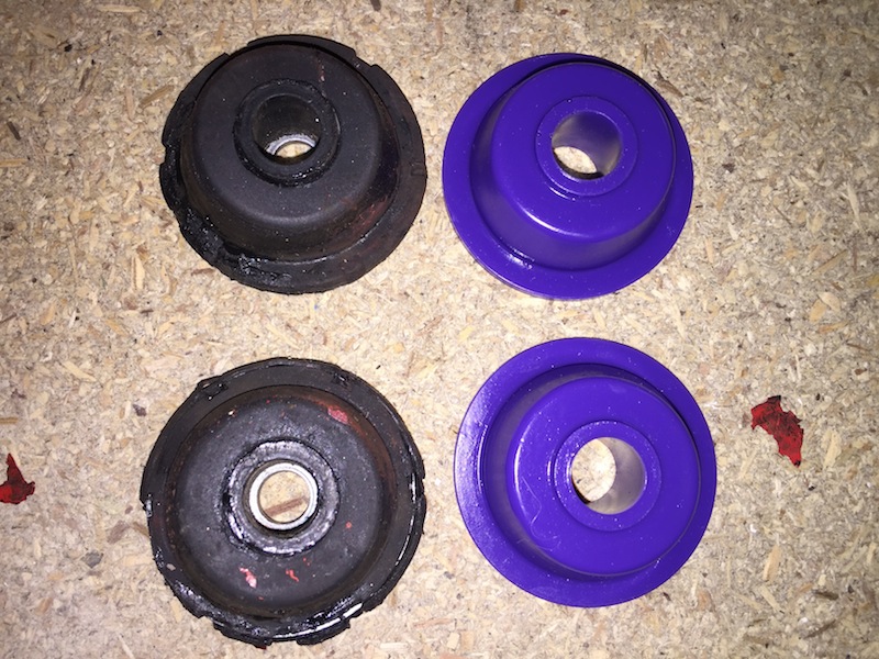

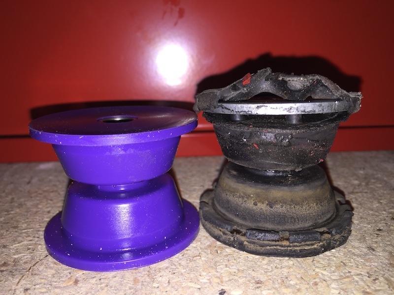

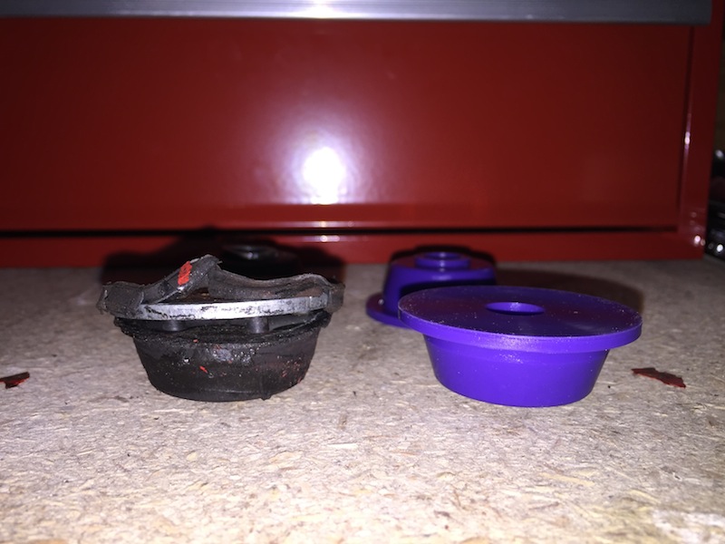

MarcB
  Too Many
@Dr Jekyll well worth changing the upper rear shock bushes.

Jekyll
I did get new genuine ones earlier in the year @MarcB
